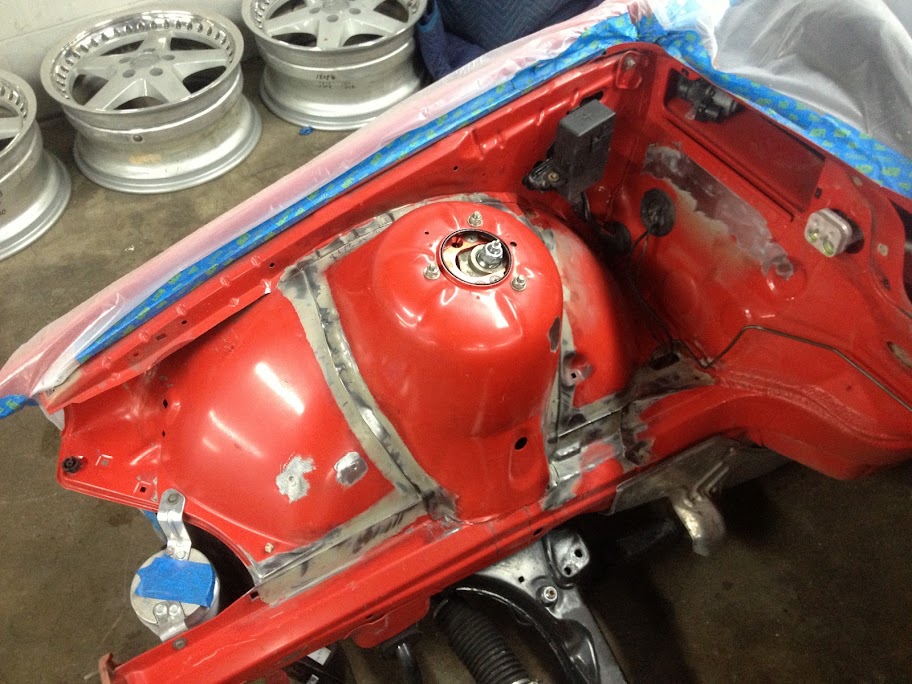

I started by removing all seam sealer, cutting off all tabs, removing the real shelf that the secondary air pump sat on, and all wiring, grommets, and pieces that would interfere with the new paint.
Wiring rats nest that BMW stuffs in the fusebox
Wiring that was not needed was cut out.
All prepped at this point

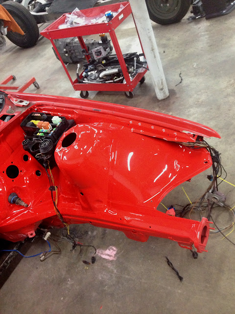

I started on getting the fusebox and wiring back in the car. I ran the wiring that run on the core support through the fenderwell out of the side of the fusebox. No wiring cluttering the bay here.
