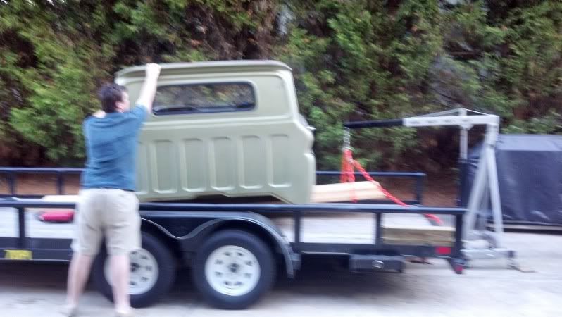

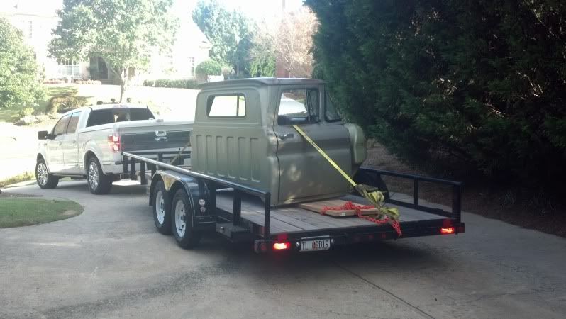

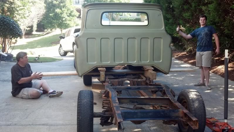

                        Finally got to spend my first weekend working on it since school started. I got the cab off the truck and it was a pain. Also took some ghetto engineering:
                        You can see we lifted the cab up and slid some 2x10s under it. Held one side up with the engine hoist and had to lift it until it would clear the chassis. Once it was high enough we rolled the frame out. The other side was on the trailer with a creeper under it, then we just backed the truck up until it was on. We only had 3 people and it weighs about 600lbs so we had to get creative.

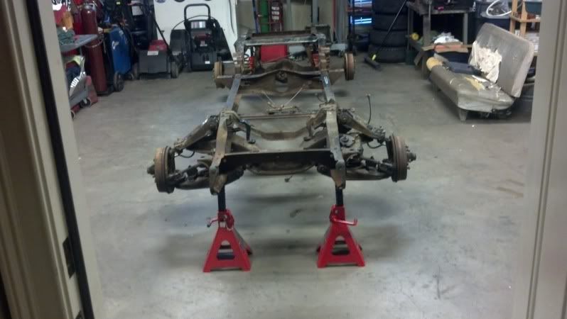

                        Degreased and pressure washed the frame and ready for surgery:
                        Should be notching the frame potentially next weekend. If not, it will definitely be done by the weekend after. Swoop
