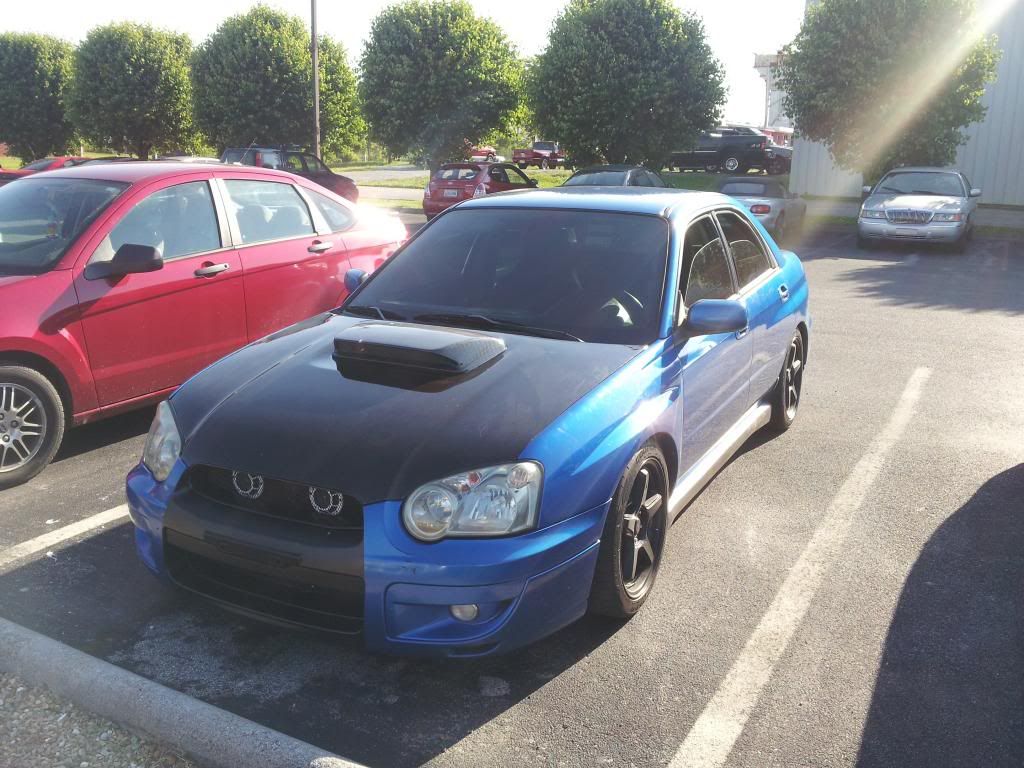

    This is how she looked the day I bought her.
    I,know, I know. Its been modified. "build it, dont buy it"
    Im all to aware lol but for the price, I made no argument.

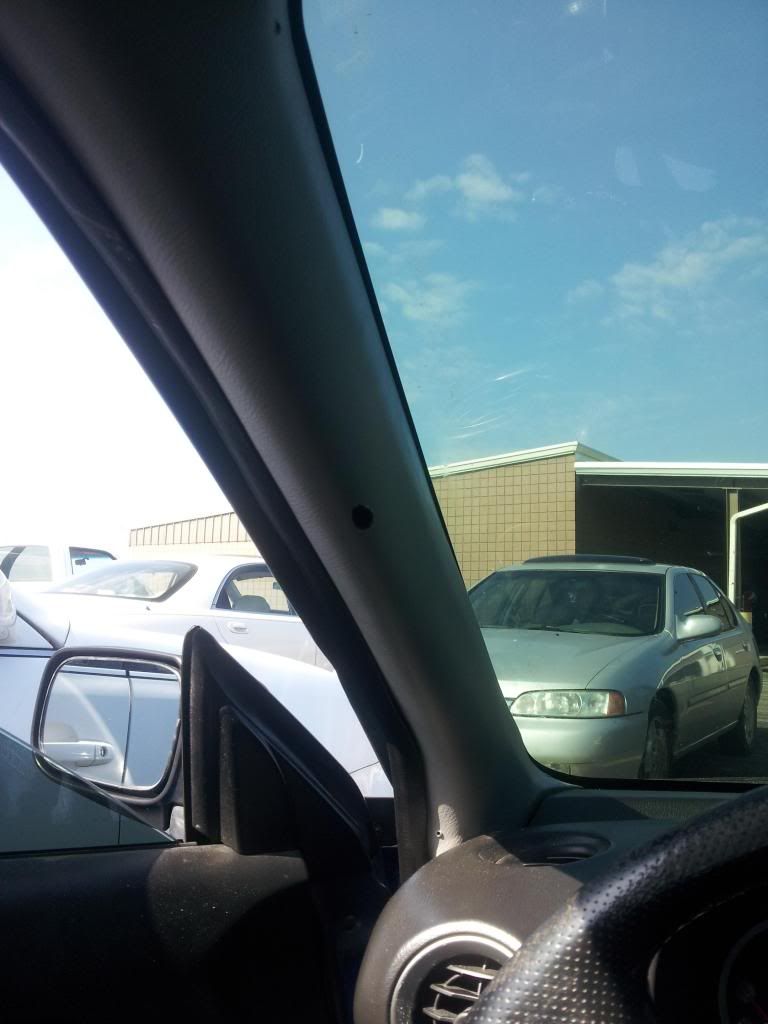

    nice A pillar gauges, that someone never installed right

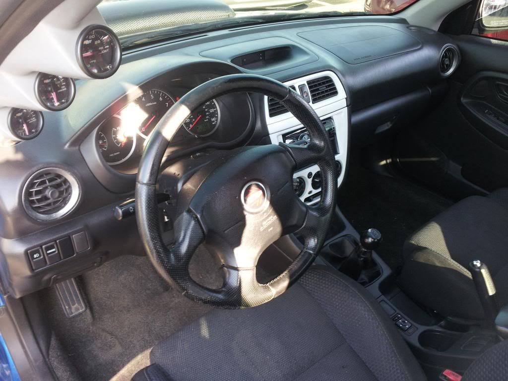

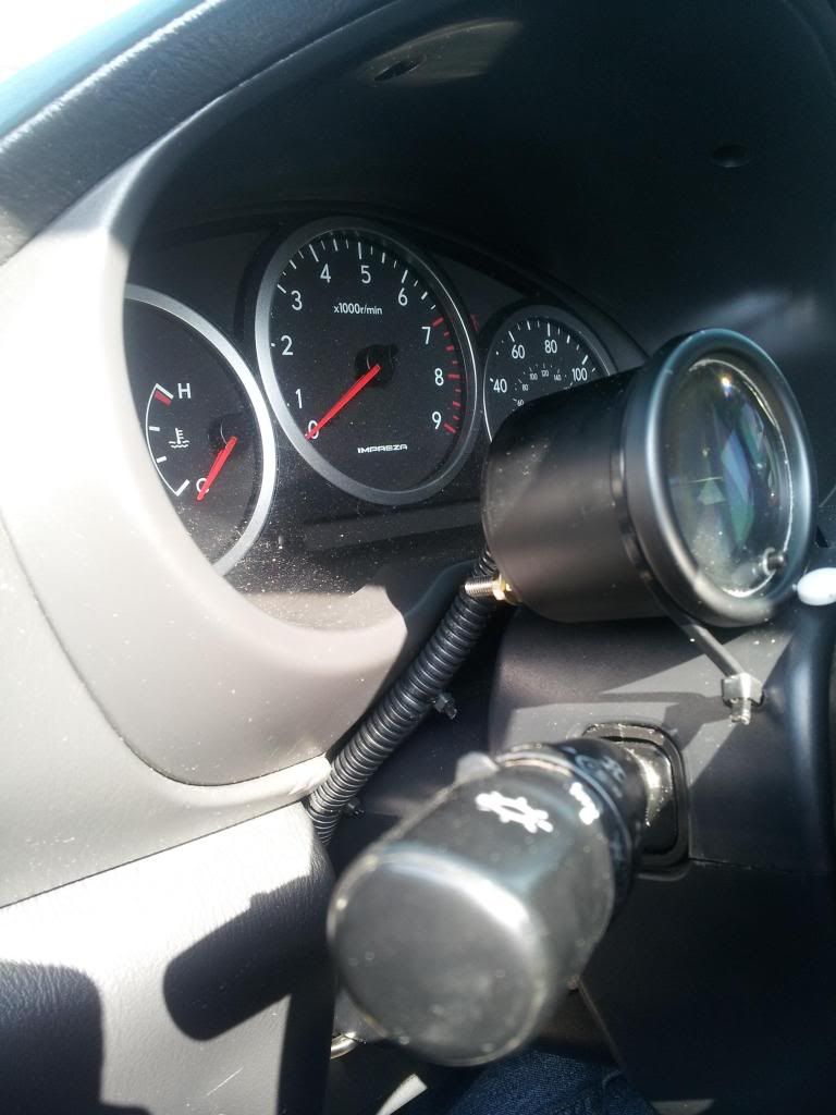

    Second: remove gauges till proper one can be ordered/installed correctly.
    Then, jerry-rig/zip tie the functioning boost gauge to steering column.
    Yea, I know, thats way too cool right?

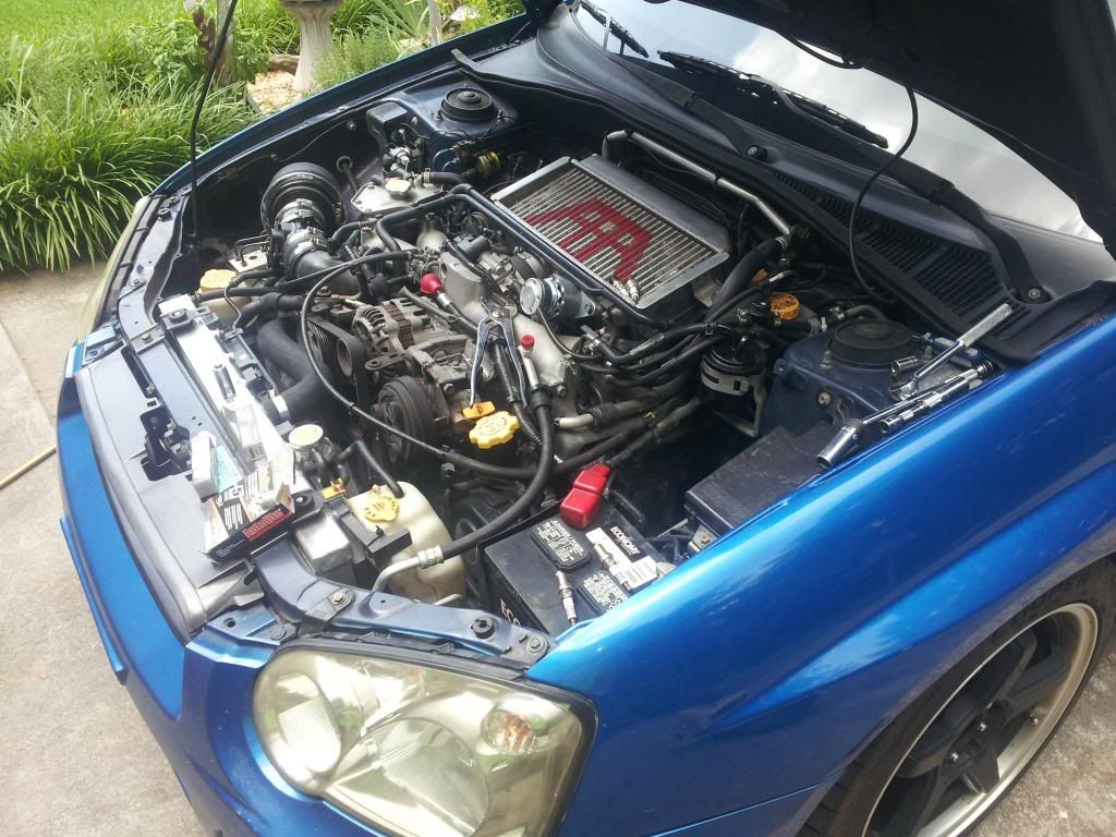

    Even took the time before maintenance to pressure wash this dirty f*****'s engine.
    Also adding the obligatory ABA to my filthy top mount.

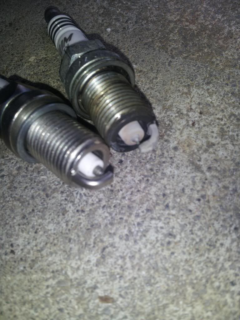

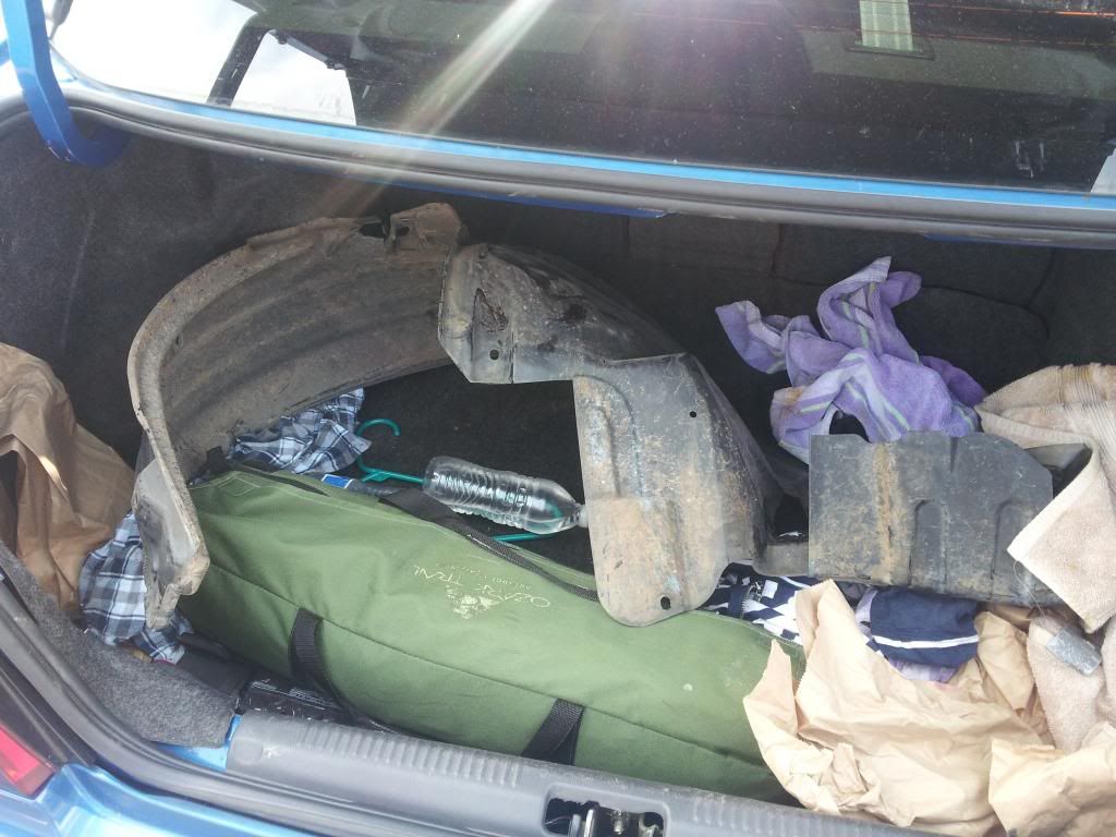

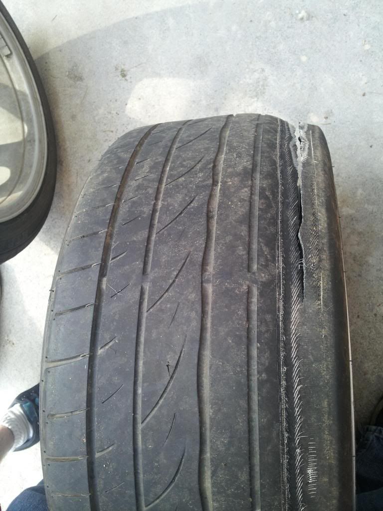

                  So this happened. I think all fender liners are absolute S***. Good thing it happened when I wasnt on the interstate.

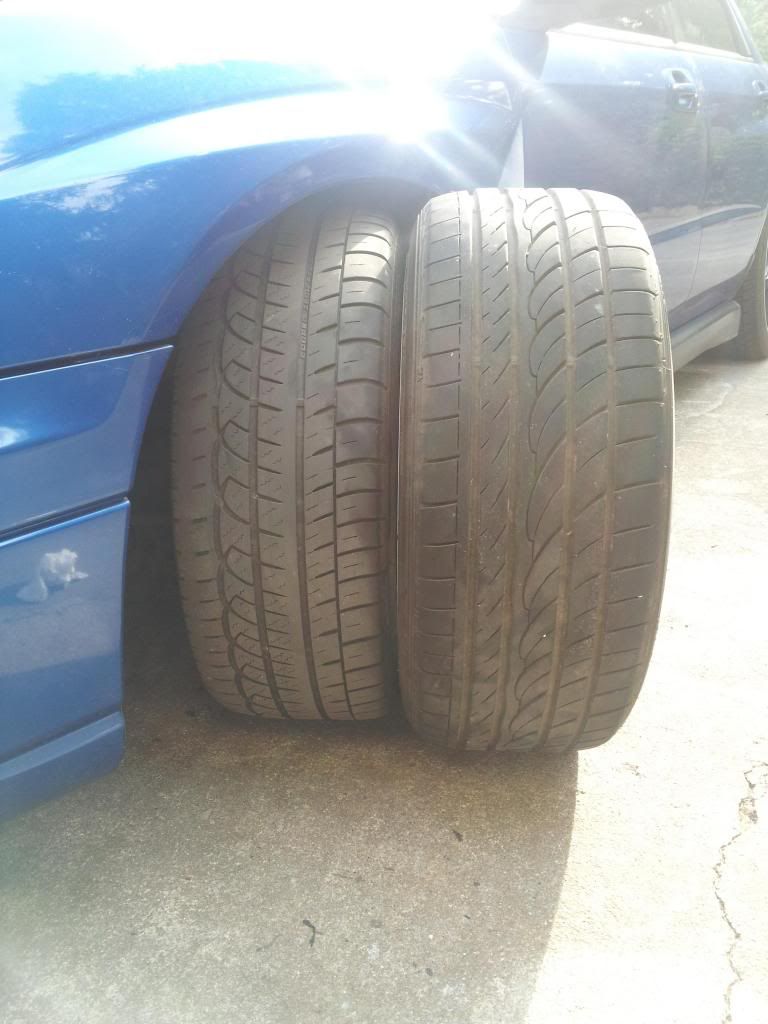

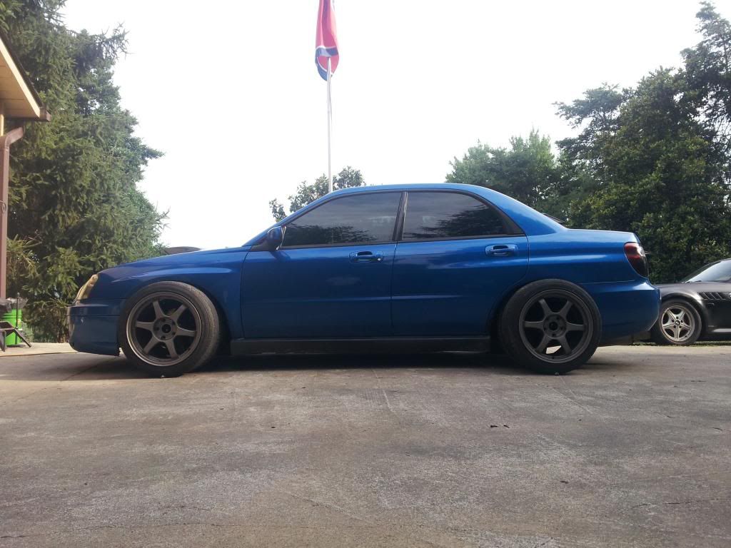

                  These here are the reps. Yes reps. REPS. figured id get that out of the way. I caught a lot of s*** for those. (edit from earlier, they are 17x8.5)
                  They once were on the Z and it had..well...a bit of camber.
                  They are a bit meatier. I like. This is the front wheel of the Z.
                  Need this. Have to get 5x100 to 5x120 adapters. The 20mm aren't expensive atleast.
                  Think I might have these painted copper.
                  And the Z peekin.

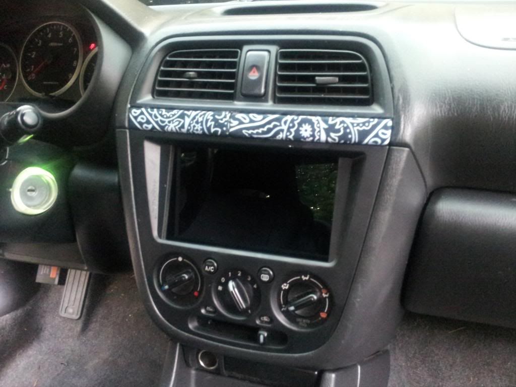

                            So besides being drenched and sweating like a whore in church, I went mental with glue and bandana.

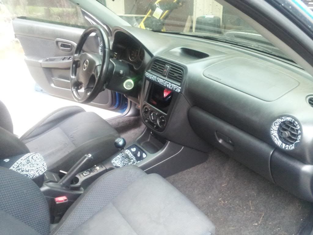

                            Fitted the Nexus in its new home. Touch screen goodnessssssss.

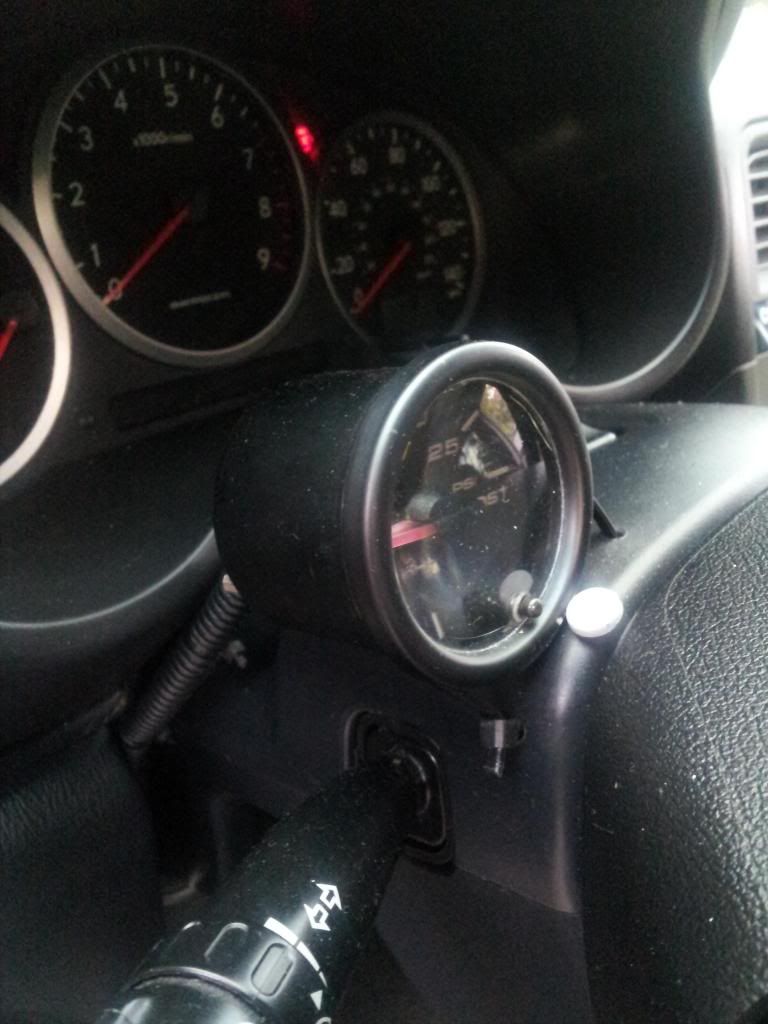

                            and thought I'd tout my killer boost gauge/zip tie job lol
