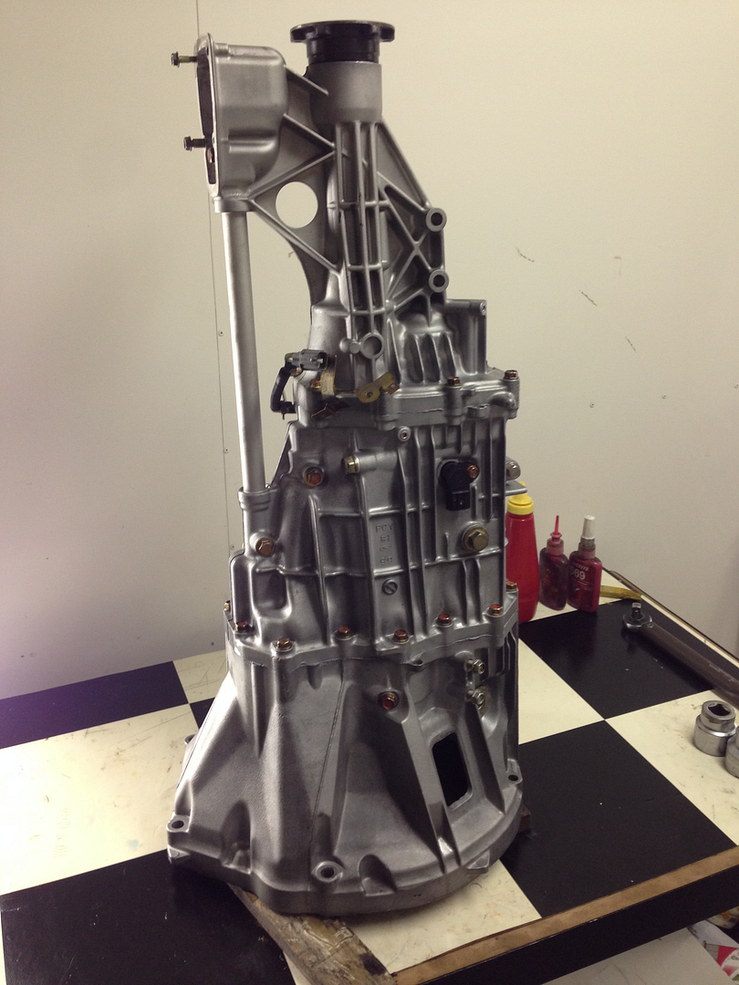

  • ievaq8
    replied
    ok...
    gearbox is all finished and done...
    so here is the gear box on its way back home with my bros b-series box...
    rough idea on wat was carried out...
    ppg synchro gear set was installed and shimmed
    all brand new OEM bearings and sleeves
    brand new OEM oil pump gears
    brand new OEM selector forks
    now everything OEM was shot peened
    and everything copped the ISF treatment...

    got some more news from SAM (Neat GearBoxes)
    After all the cleaning, Sam spent some time gouging out small broken gear particles from the aluminium.
    He found about 10 chunks like this by running a magnet around the case.
    The last thing we would want is these little bits running through our new gear set or oil pump.
    Here’s the assembled gear sets.
    and setting up the bearing clearances.
    Leave a comment:

    these are Sam's exact words...
    Such quality. PPG set Just pulled out of the ISF machine.

    cheers for all the positive comments guys
    some more pics from SAM:
    S2k AUX gears, all shot peened and polished...
