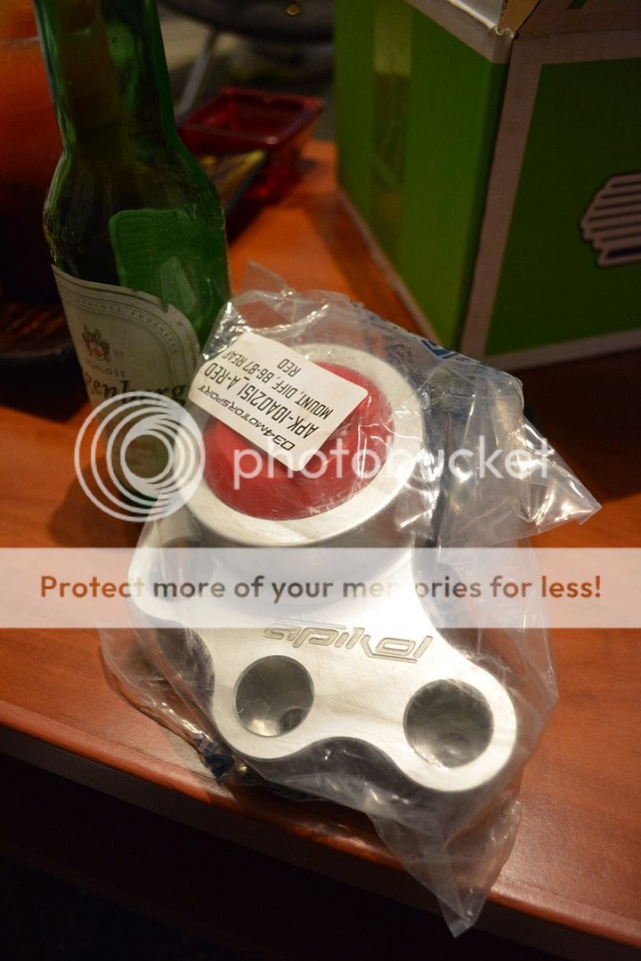

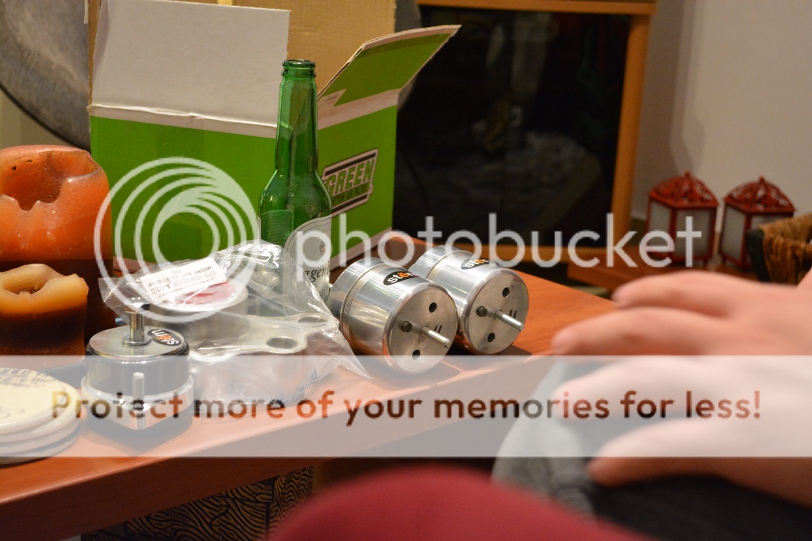

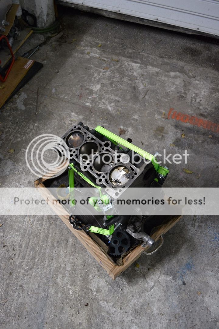

Bought these

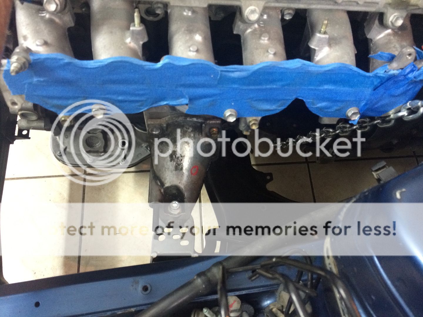

To pick up from where we left, and play with engine mounts

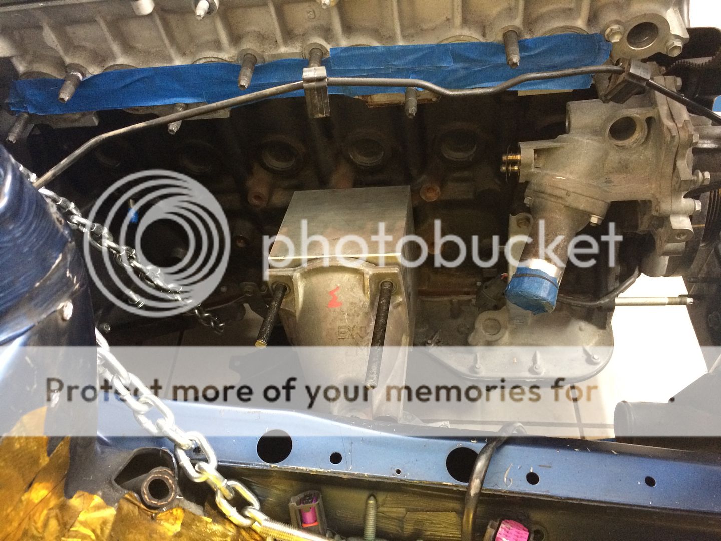

The idea, to remind you, and me too, was to use some custom billet spacers between the engine block and engine mounts.

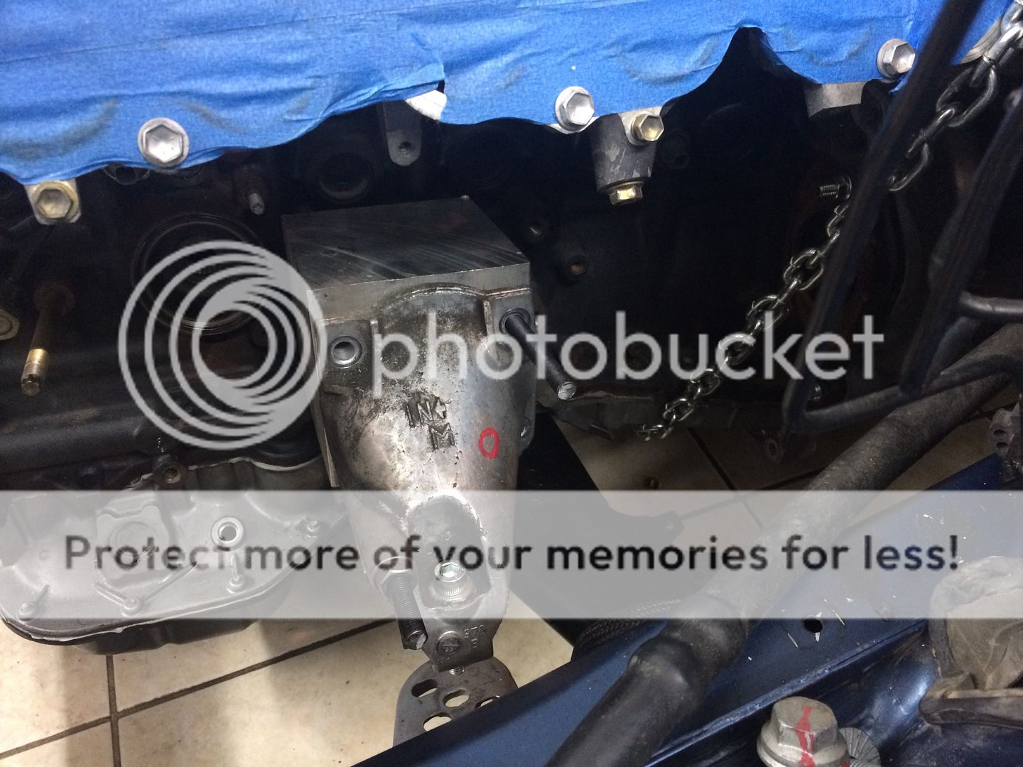

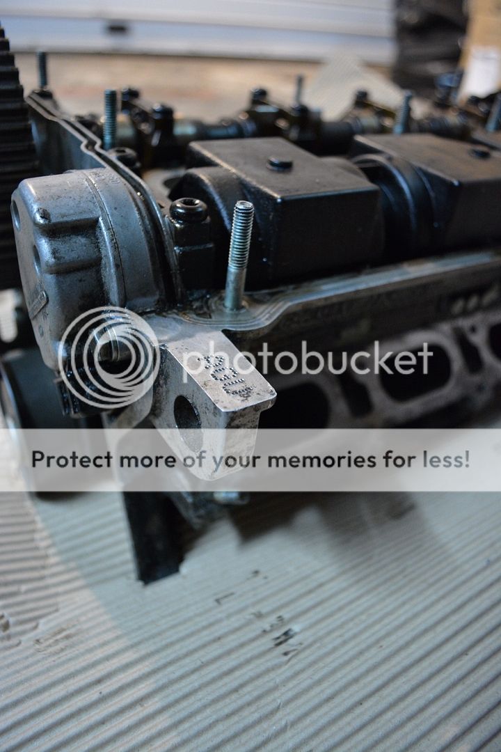

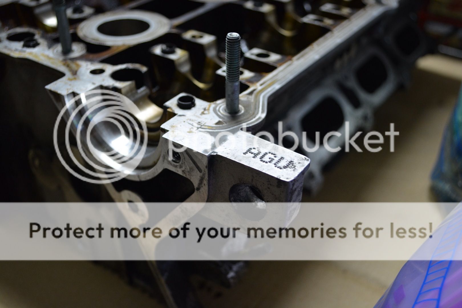

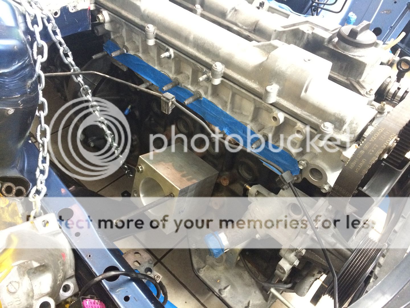

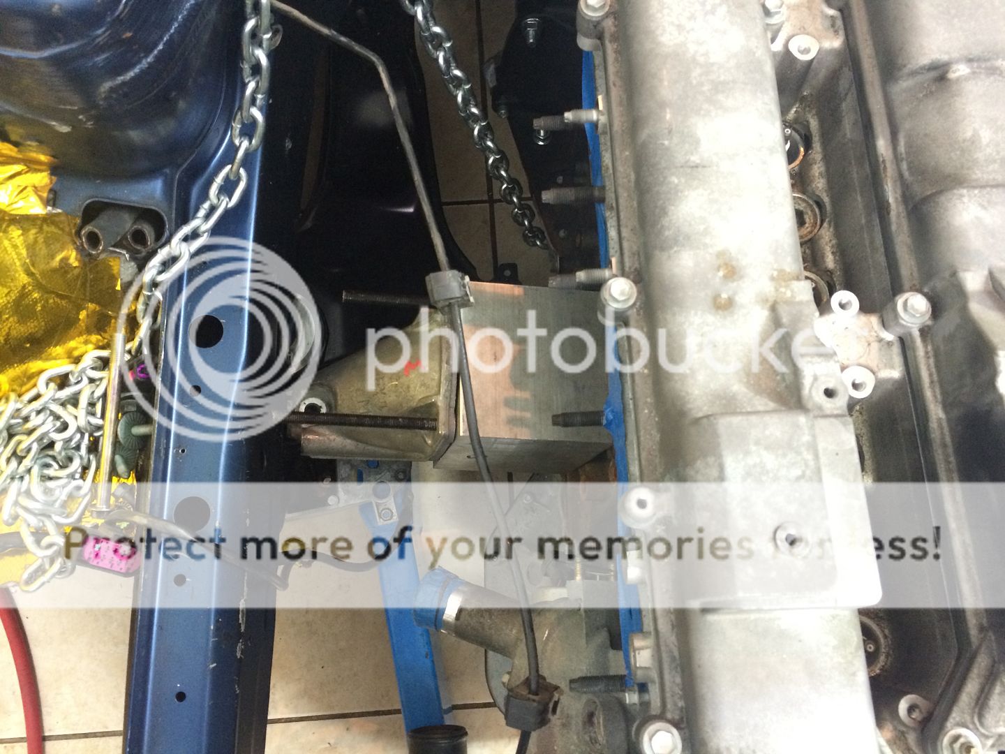

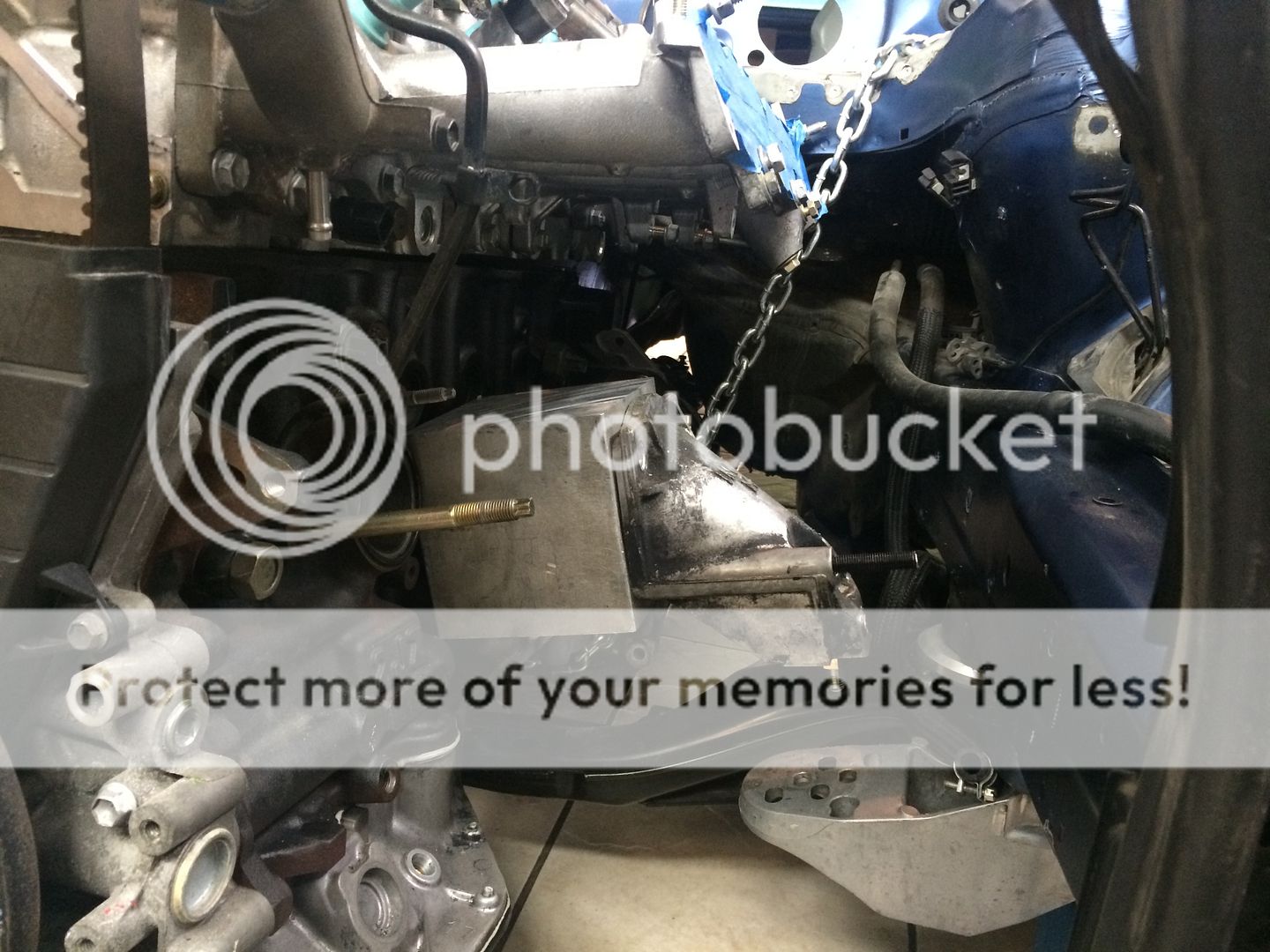

Bolted down the studs, in 10x1,25 pattern and started test fitting for the first time

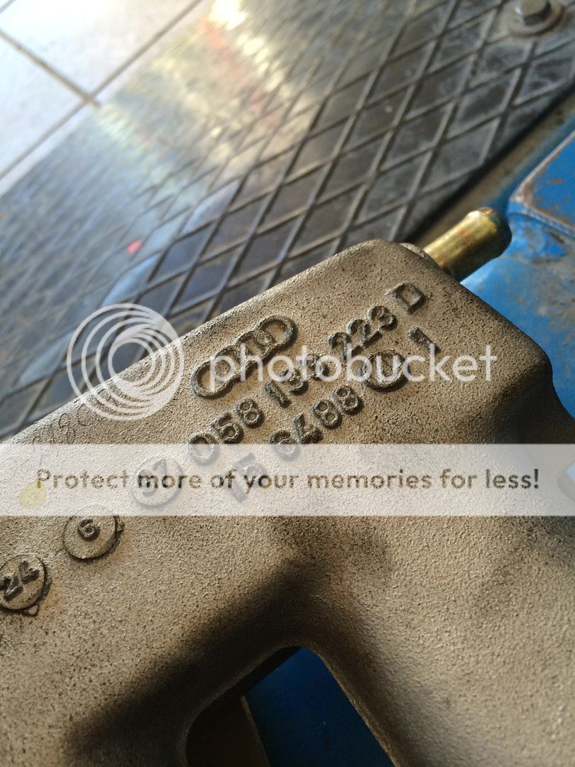

Not so far off the lower OEM audi place that the engine mount bolted onto

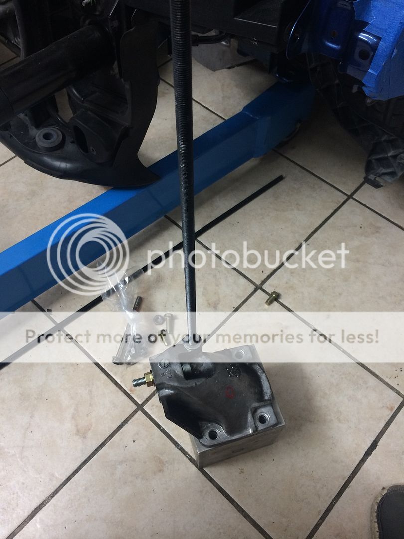

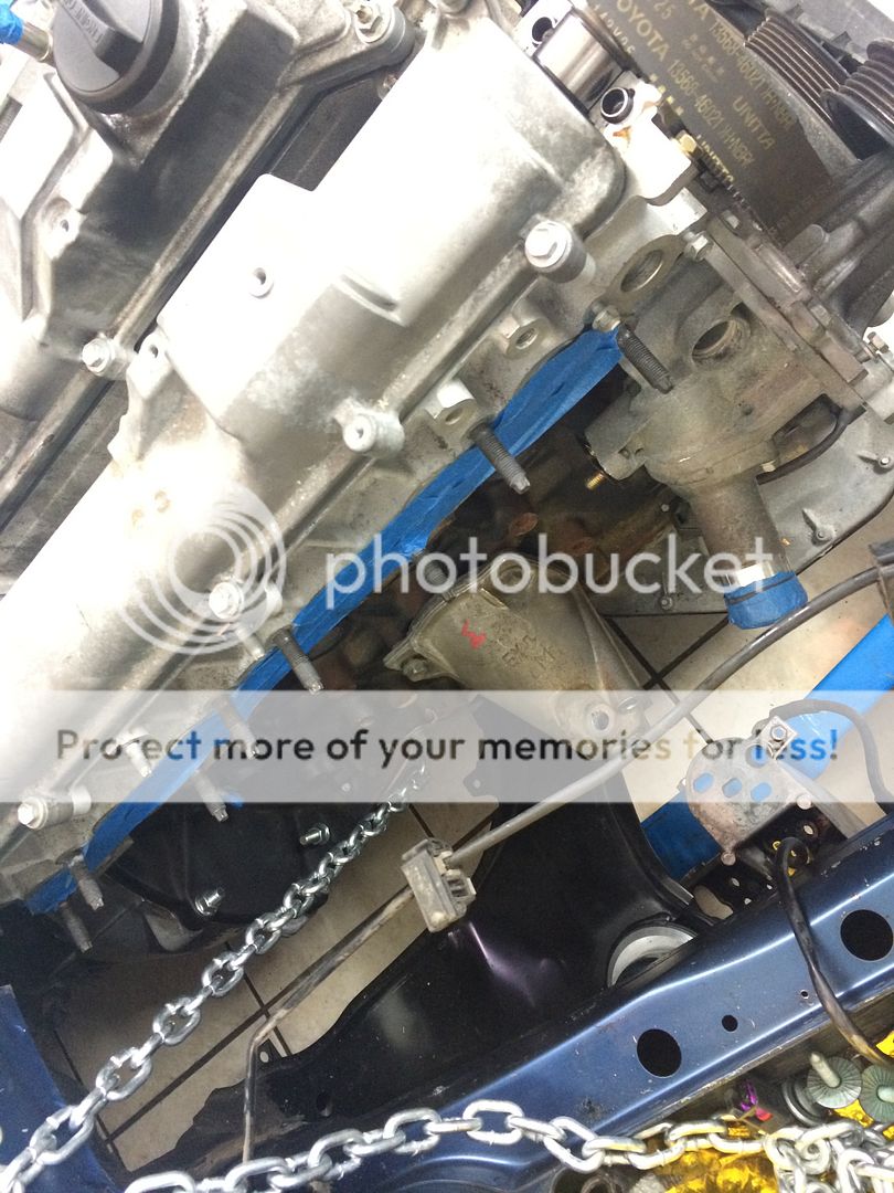

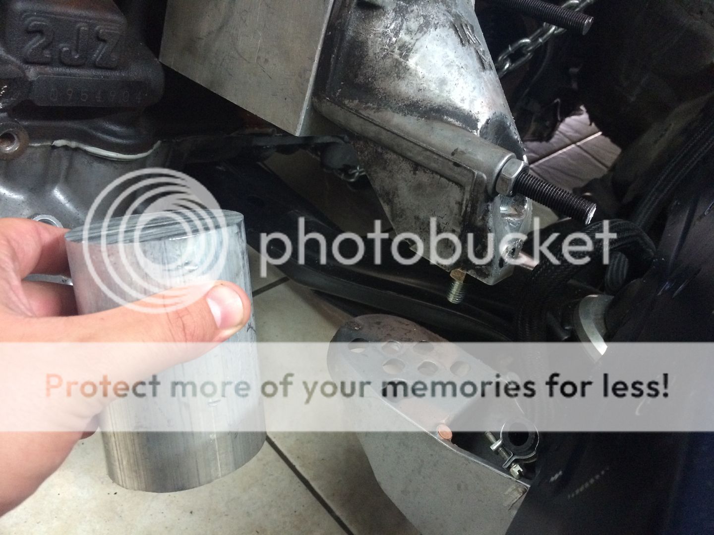

We can use this piece of aluminum, to join the two sides, and also put some teflon in the mid area to give some ability to the engine to have some play - lol

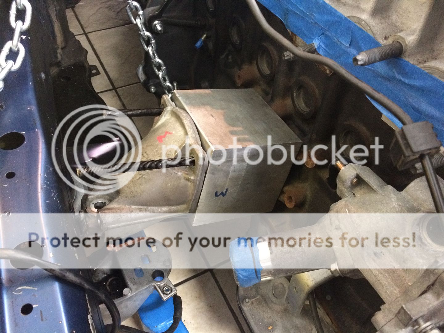

Passenger's side
oem engine mount
Spacer on (not its final shape or weight obviously)
Seems like more cutting to be done on this side
Need to finalise the engine position, and then go from there
