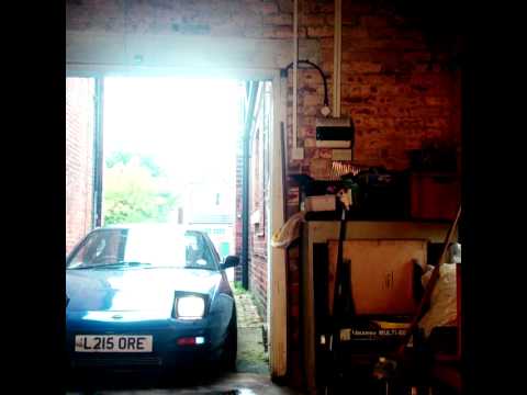

All these things will be done whenever I get time to, she's currently at my parents so I can work on it with all the tools and space I need.
So I'll leave you with a few pictures until my next update when I get to do some work on it again.
Looking sad not wanting to leave Lincoln
Looking even sadder at being left behind and being filthy
