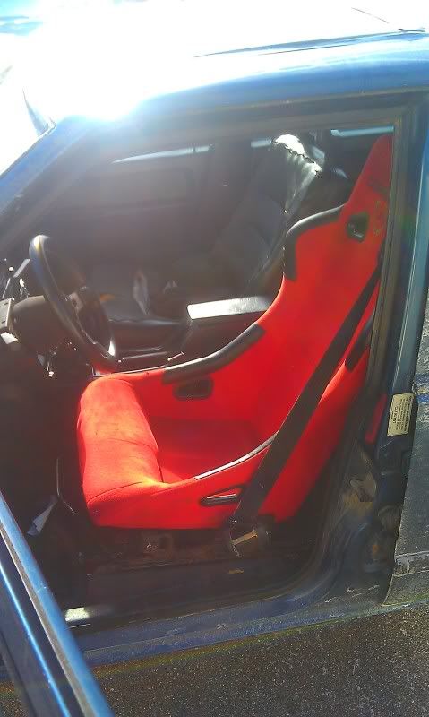

    seats in. what a pain in the ass. volvo has the widest seat rails ever. took some work but end result was worth it.
    driving position is perfect now.

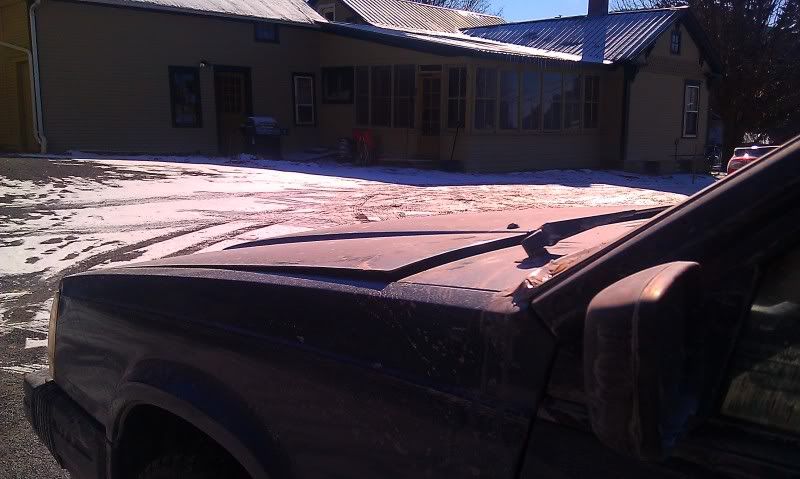

              hood has risen.
              not a huge difference, but noticable.

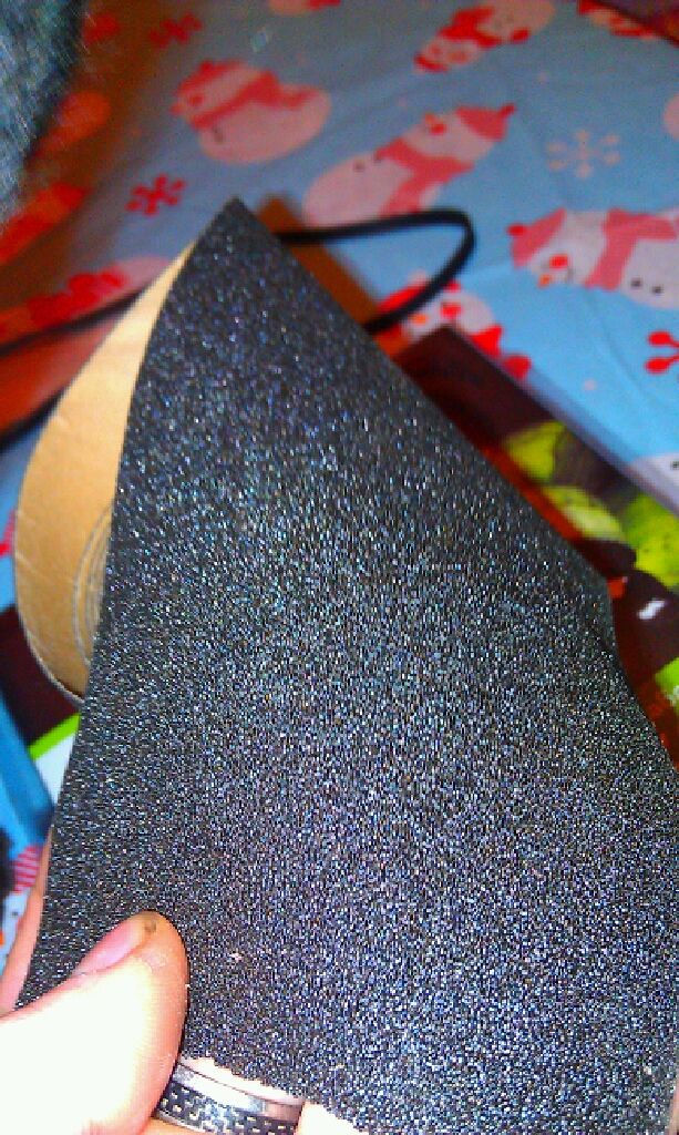

              found some 3m griptape that will replace the shitty worn out rubber pedal covers.

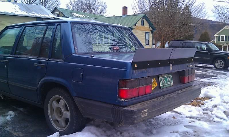

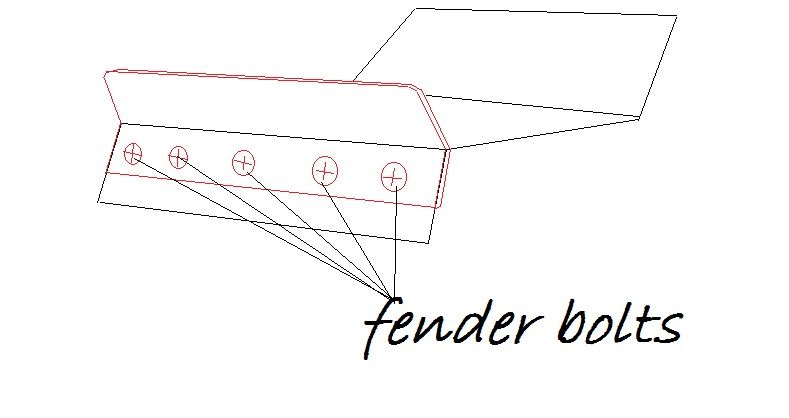

              also had to re-think the spoiler. currently my design was complex and was going to cost well over 150 bucks to make. so i changed to a single piece of 1/8th inch aluminum, 57"long by 8" wide, with a 45* bend at 3" in. itll be bolted to the rear of the trunk with fender bolts. hopefully itll hang on. if not ill re-inforce it with some 2" stock bent into "L" brackets for front support.

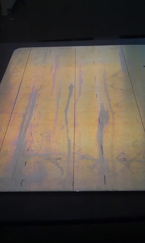

                    i was trying to sleep last night and couldnt, i kept thinking of what i could use to make a center console plate for switches and a killswitch etc. i recalled my old rx7 had an aluminum street sign cut up and bent to fit the dash area, then it hit me.
                    i have about 5 or 6 old street signs laying around, that are 1/8th inch aluminum, and FREE!
                    spoiler project was on.
                    traced out the pattern.
                    tried it on for fitment.
                    then after final finish work, and some aircraft grade paint remover:
                    very happy with the outcome. now that the spoiler is done im going to make a rear lip/diffuser, and try to locate a 760gle front lip without fog light holes.

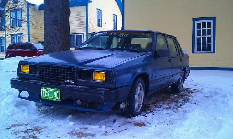

                          UPDATE:
                          got bored and had some free time, so i took the headlight units out and smoked the turns and side markers, deleted the high beams, yellowed out the mains, and ran a duct to the intake.
                          obviously the haggard intake tube isnt staying, i will be refining it once i get an actual cone filter in there. something that doesnt looks so ghetto.

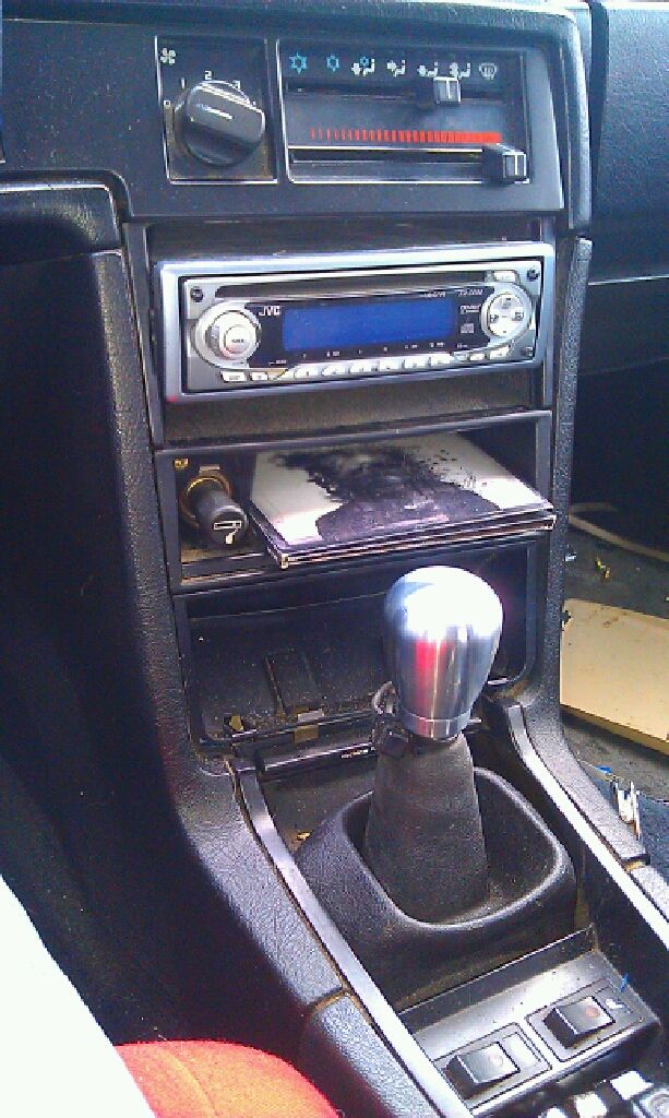

                                cut the huge 18 wheeler shifter down

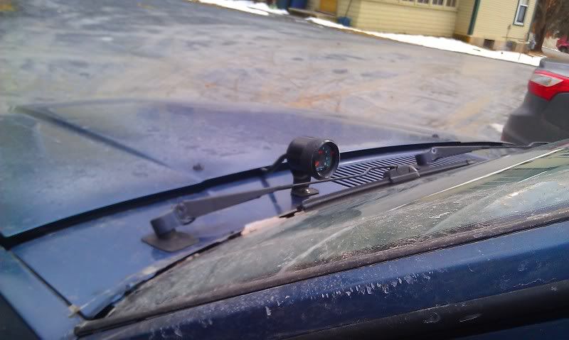

                                Mounted an old tach on the cowl. much easier to keep an eye on the rpm's this way, and looks badass.
