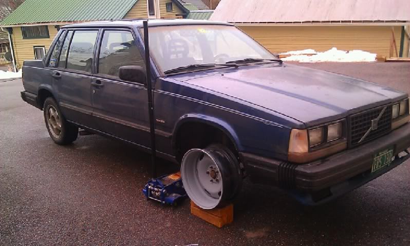

    Step 1 was to figure out a wheel and tire setup. volvo has the stupidest 5x108 bolt pattern, so wheel options are slim. i know i wanted deep dish, wide wheels, but again, this is a super cheap budget build.
    so i went wiiiitthhhh:
    16x7 Volvo factory xc90 steelies. nabbed em for 75 bucks for the set. et 48 on these just wouldnt do.
    a few hours later...
    centers cut out, cleaned up, flipped around, and...
    primered and awaiting final truing and welding. final offset is -1.
