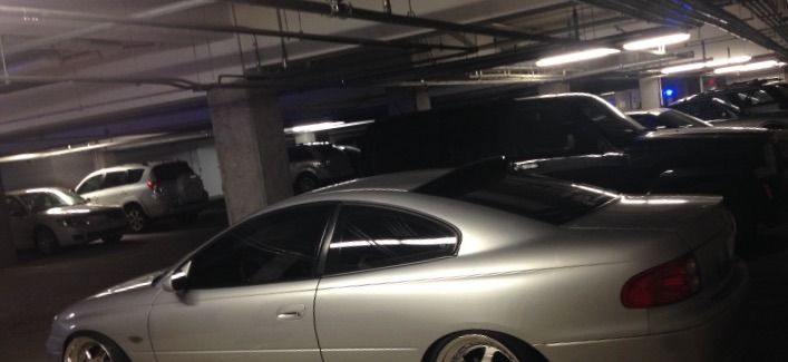

    • So I got a test fit done.
      So the rears are catching on fender lips so I either need to cut them out or roll them flat:
      Here's the whole side:
      Then the front:
      So I figured I'd need spacers to clear my bags. I actually was clearing my bags inflated with a 20 offset. It looked like it would hit otherwise so I threw on 7mm spacers to get a 13 offset like I had on my m-parallels. And it took the fender to tire fitment back to business card clearance. Once I get camber adjustable top mounts the car will drop enough to tuck with the top mount size difference and the clearance will be fine with the fender:
      And I will leave you with this pic until emanyankee uploads his nice photos from the night
      Oh and one of my front tires debeaded chilling in my apartment So I need to have it remounted. I think this tire had a slightly torn bead so I may grab another 215/35/18 FK453 since I saw them for $80 shipped
