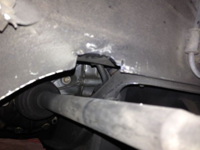

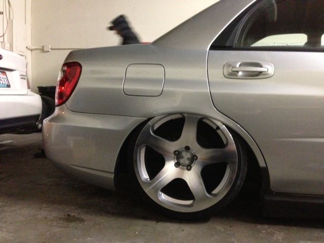

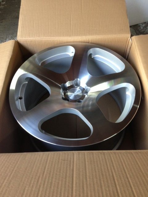

                        So I got a call from brandon at Unlimited autocraft telling me my rotiforms were finally ready to be picked up so I rushed over there and saw these beauties fresh out of getting drilled...sizing is 18x9.5 +25
                        I went to 714 tires and picked up a set of 215/35/18 and had them throw them on. with camber maxed out on the camber bolts and the camber plates the rears fit like a glove with the rear fender airing down right onto the top of the face of the rim.
                        the front on the other hand wouldnt go low at all, so we had to take the wheels off and see where the clearance issues were...we found two
                        1. was on the top of the fender well so that was fixed by maxing the camber all the way negative in the front
                        2. the axles were hitting the frame when trying to air down, so we got out the angle grinder and tried notching the frame as much as we could with what we had, only got about 3/4" but it actually made a big difference
                        Sorry the picture is upside down
                        painted the stock sideskirts today..heres how everything sits currently...front still isnt sitting low enough but it will do for now
                        thanks for everyones comments...feel free to leave feedback or suggestions, they are always appreciated!
