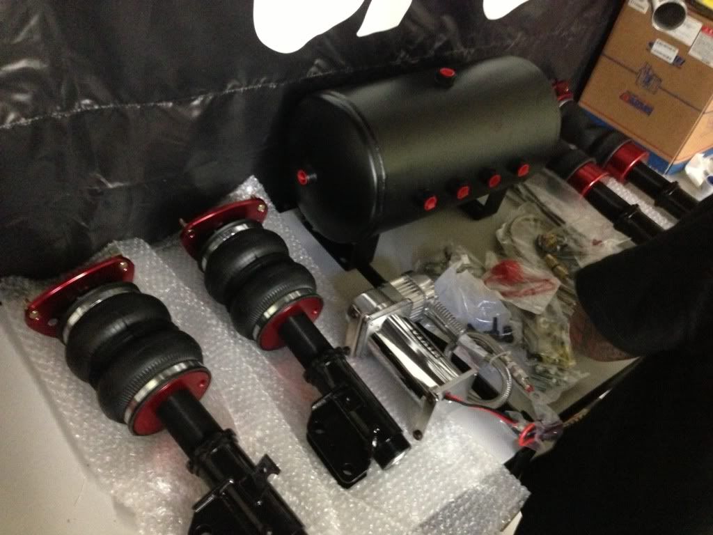

        heres the kit with everything it came with (digital controller not in pic)
        4 struts
        alot of airline
        wiring harness
        5 gallon steel tank
        compressor
        controller
        all fittings/relays necessary
        manifold

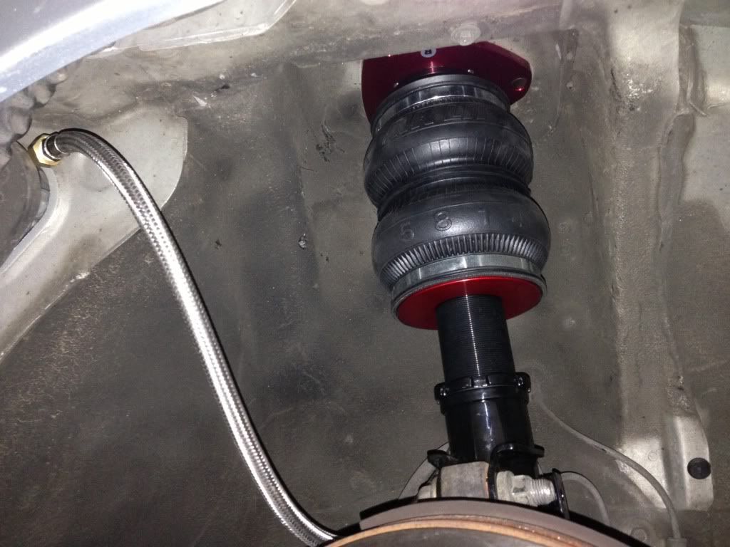

          so the install was pretty straight forward.
          1. removed stock struts

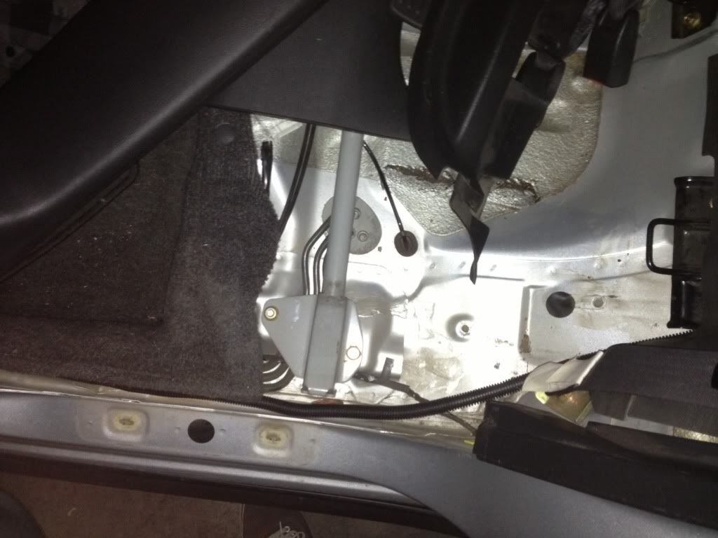

          2.started removing all necessary interior panels to access rear strut towers and to get under carpet to tuck wiring/airlines
          3. Use a heavy amount of teflon tape to ensure there is no leaks (learned the hard way) I even used thread sealing grease over the teflon tape just to be safe with all air fittings
          4. install new airlift struts and runs the air lines through firewall and under carpet all the way back to the trunk (rears were run through hole in bottom of trunk)
          5. after all hardware was installed I ran wiring harness from manifold in the trunk to fuse box and to compressor (all easy and plug and play)
          6. I then ran the lines to tank, manifold, and compressor and bolted it all to a thin piece of plywood (temporary) until I take the time to do a real trunk setup
          7. then had the pain in the ass of putting everything back together

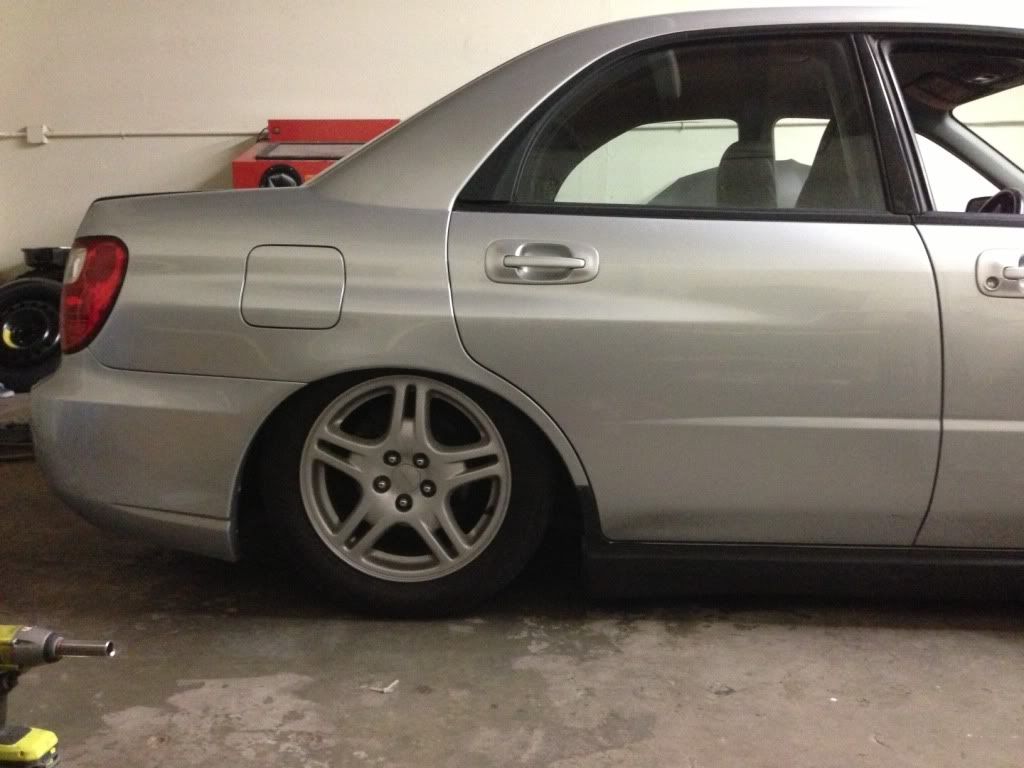

          while putting everything back together I realized the bag is really close to hitting the tire due to high offset stock wheels and huge sidewalls but I talked to rotiform and hopefully Im gonna pick up a set of NUE's this week as some temporary wheels until I make up my mind on a gangster wheel setup
          8. air down muh fukaah
          now that the air is compete I will be picking up some wheels hopefully this week, I will roll/pull fenders before wheels go on also....pics will follow
          thats all for now
            Looks great man. Make sure to watch out for the screws on the inner passenger side fender well. They caused me some trouble.
              If you have any questions about clearancing or anything feel free to PM me.
              In 4 wheels.
              they caused you trouble when aired up or when down?

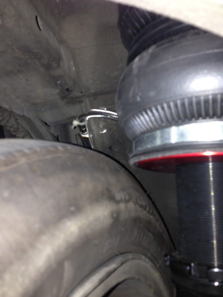

                        I had my camber plates maxed out in the front, an those screws rubbed against the bag and cut it. a Real pain in the ass.
                        And if you wanna get really low up front you have to cut some stuff out as well. lol
