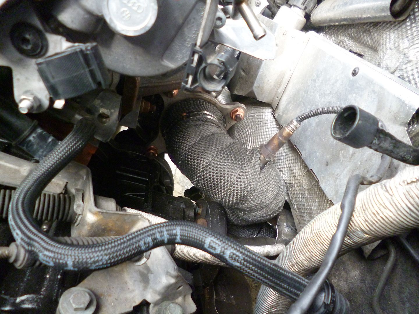

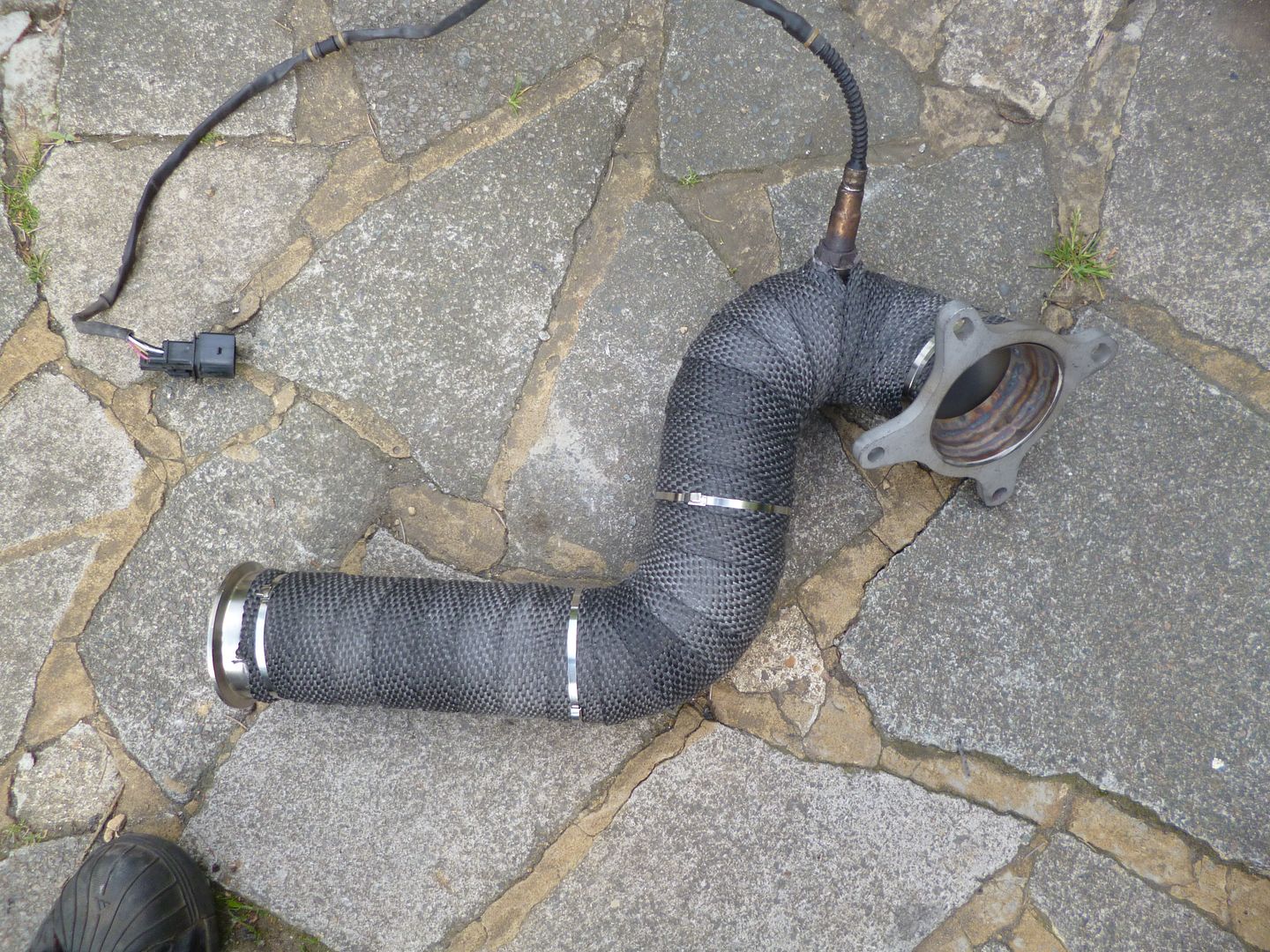

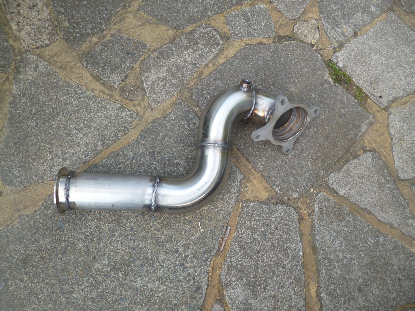

got home from work today and set about finishing the dp, welded the vband to a section of pipe and tacked it to the DP and checked clearances
tfsidownpipecustom by Muhammad Hamidi, on Flickr
all looked good so welded it up and welded lambda boss in
then heatwrapped it
fitted it up with new gasket and nuts

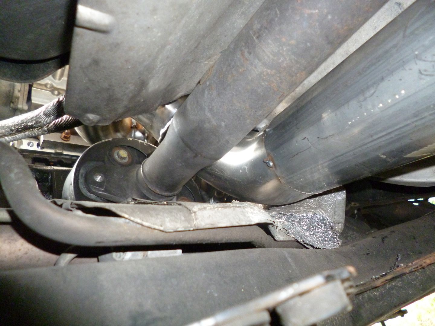

next was to mock up a mid section, trimmed the 45* to the correct angle / length and welded on the v band and flexi joint
then mated it to the existing system
fitted
then heatwrapped it
fitted

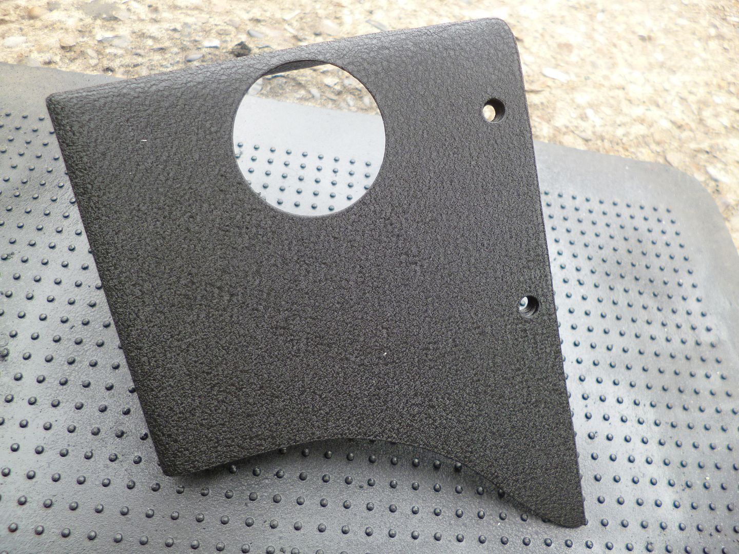

first was to mount the adjustable pressure regulator, personally i **** the look of them. the carbon cannister left a convinient place to mount it so decided to knock something up to mount it and hide it away

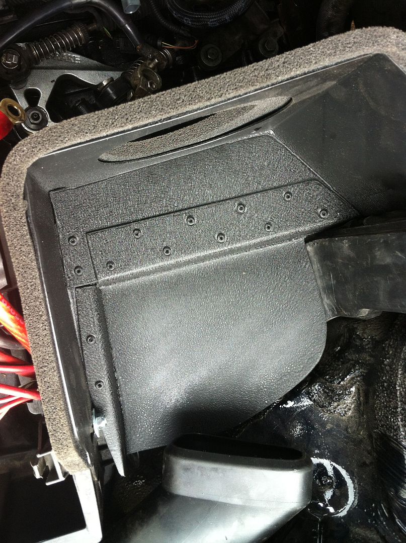

next was the air intake shroud, for modified revo intake pipe.
tfsi revo intake mock up by Muhammad Hamidi, on Flickr
i shaped and trimmed the mk5 item that came with the kit then made up a new section to suit the mk4

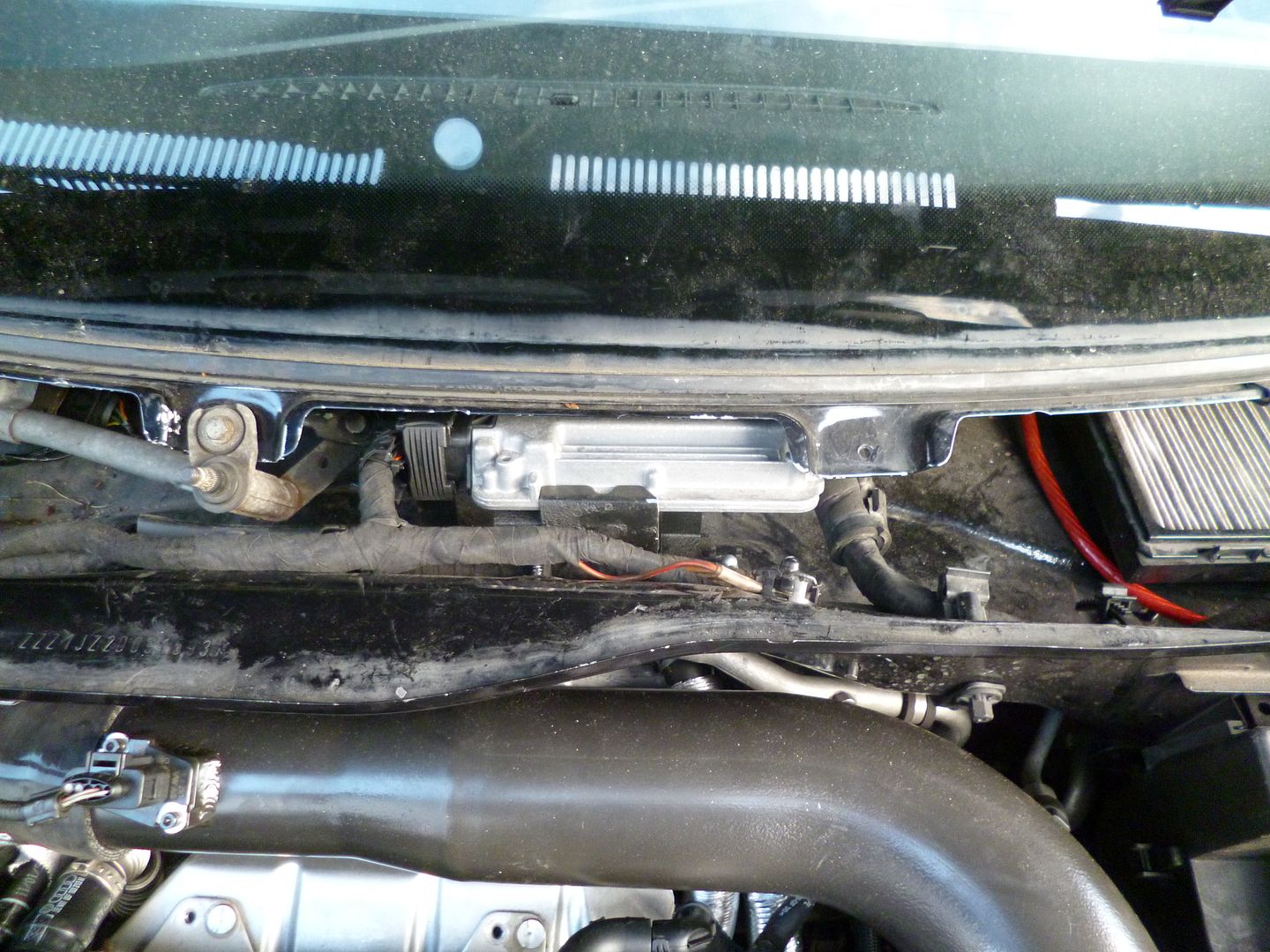

also had to do something i was putting off and mount the ecu, the TFSI ecu is longer than the mk4 ecu and the run of qpeng loom meant it needed mounting sideways, i modified the mk4 ecu bracket
painted
fitted

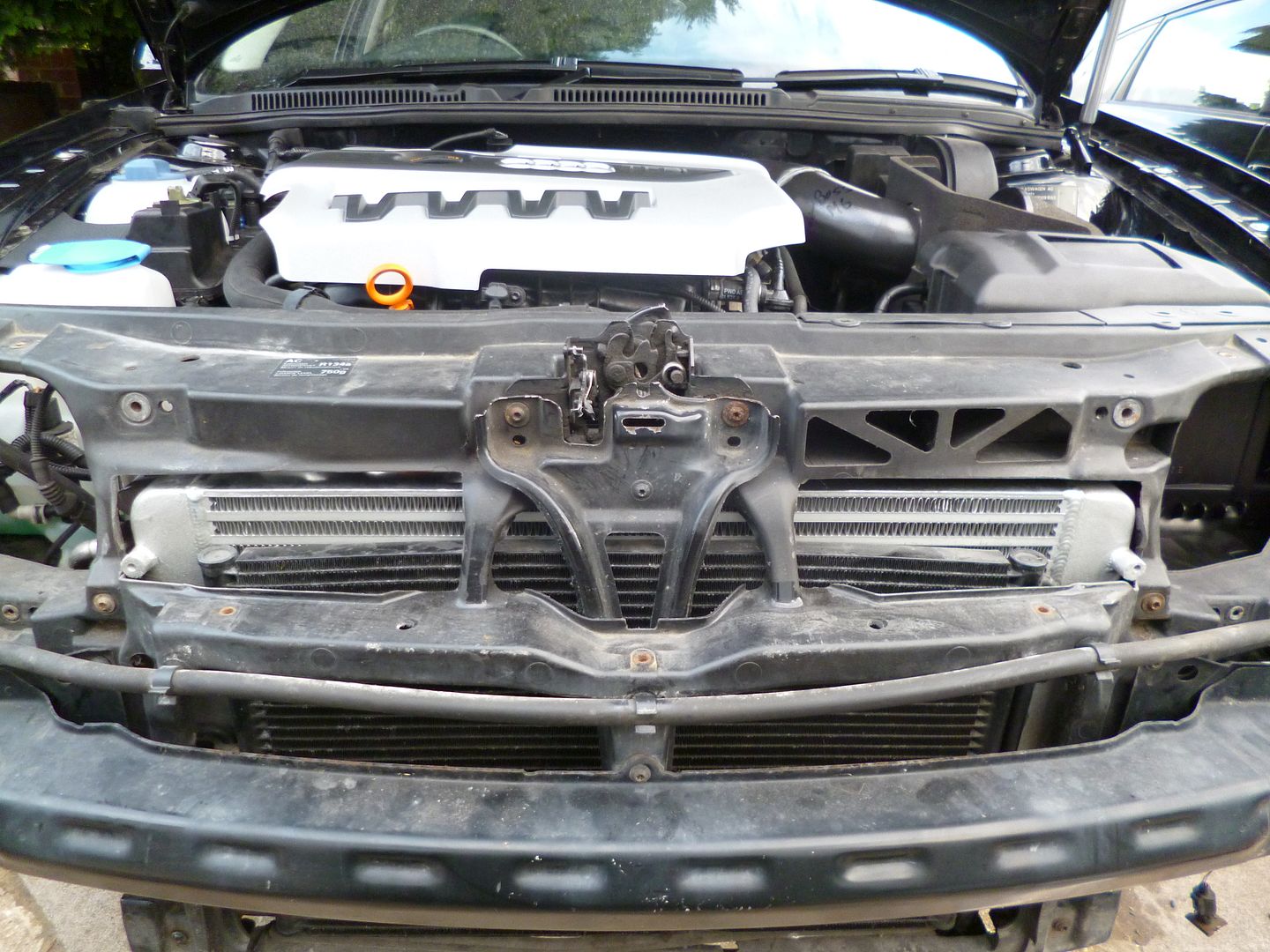

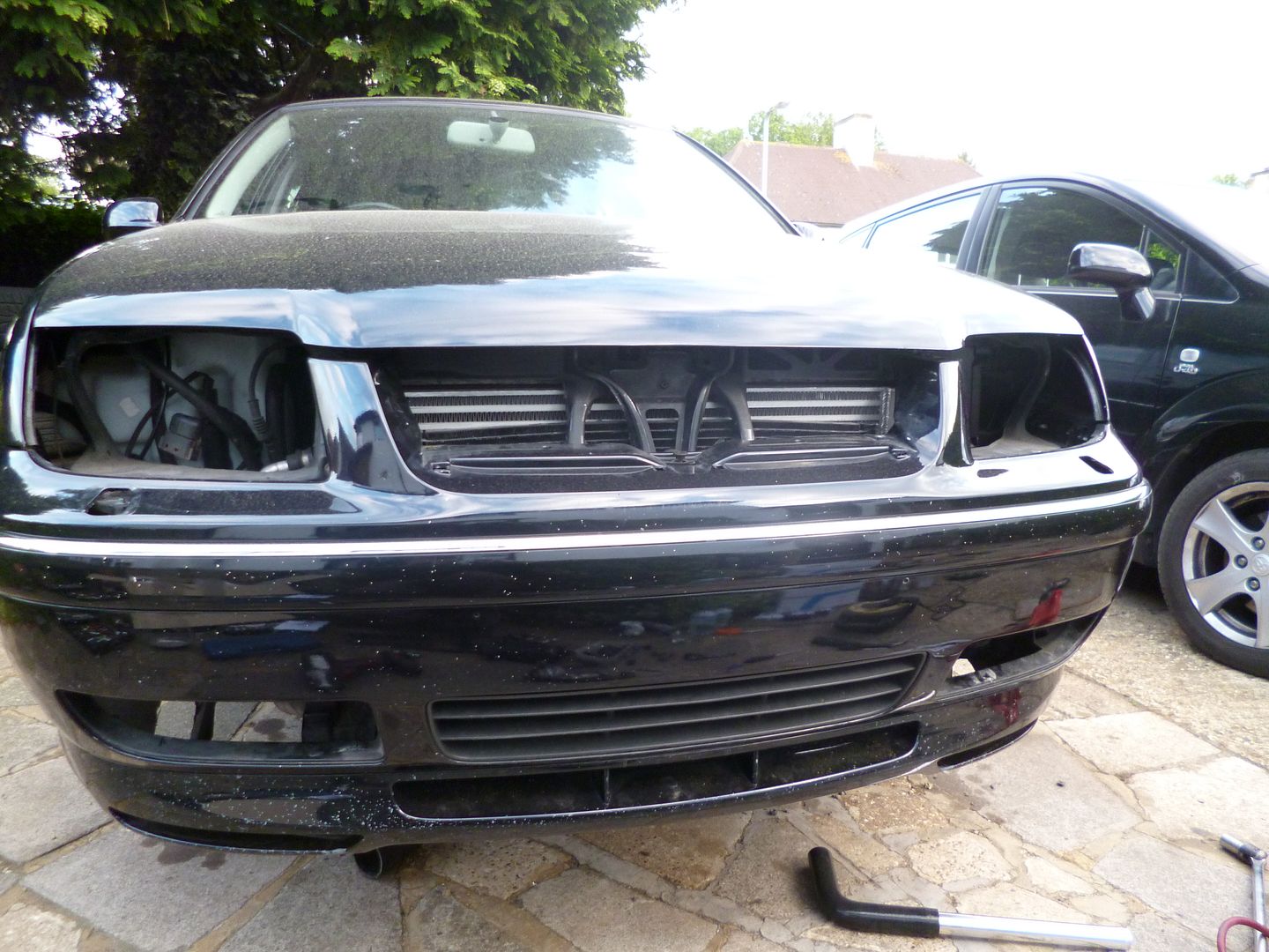

also decided to open out the front panel a little to give more exposure to the FMIC
couple more bits left, hoses to make, inatake to be painted and little bits and bobs before it's ready to run but made some good progres today

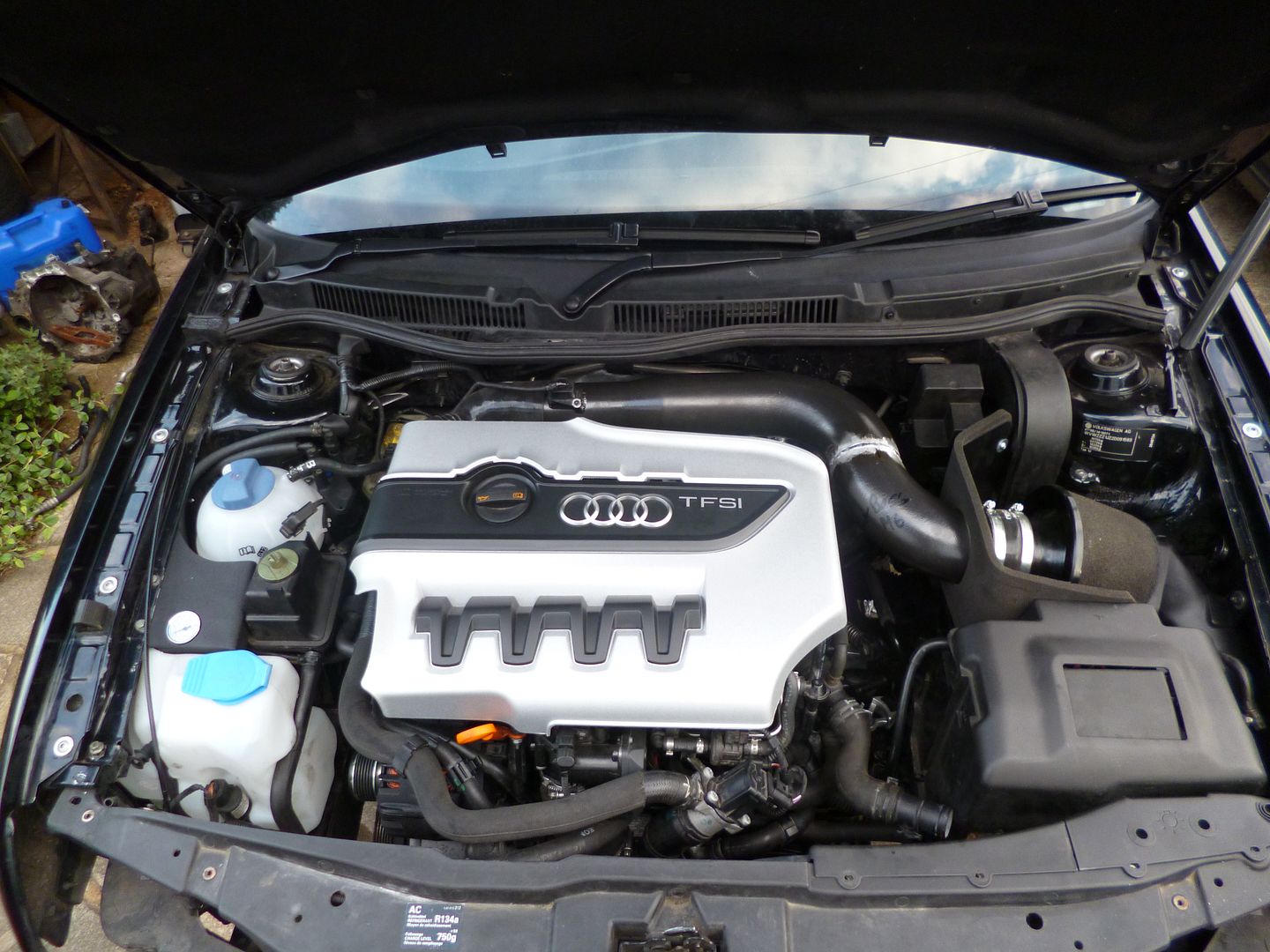

once that was in the battery box etc could be refiited
painted
fitted
scuttle refitted with wipers etc

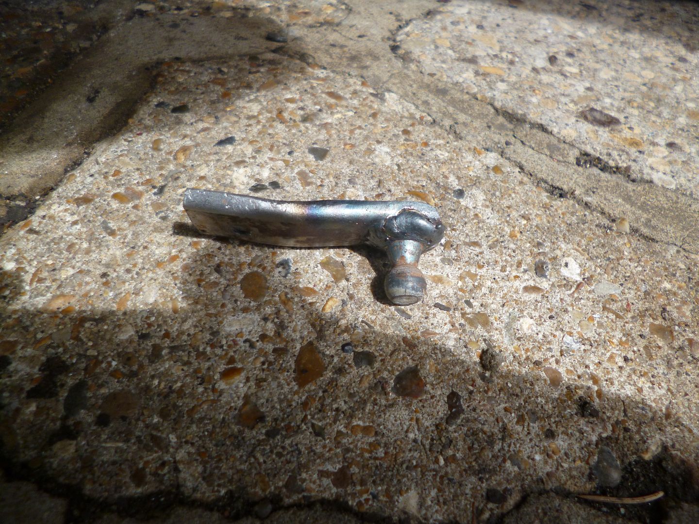

well sunday evening it was an hour or so away from the first start, after speking with HammerD monday it was decided to remove the engine and fit an uprated clutch and single mass fly
so got home from work monday and this happened

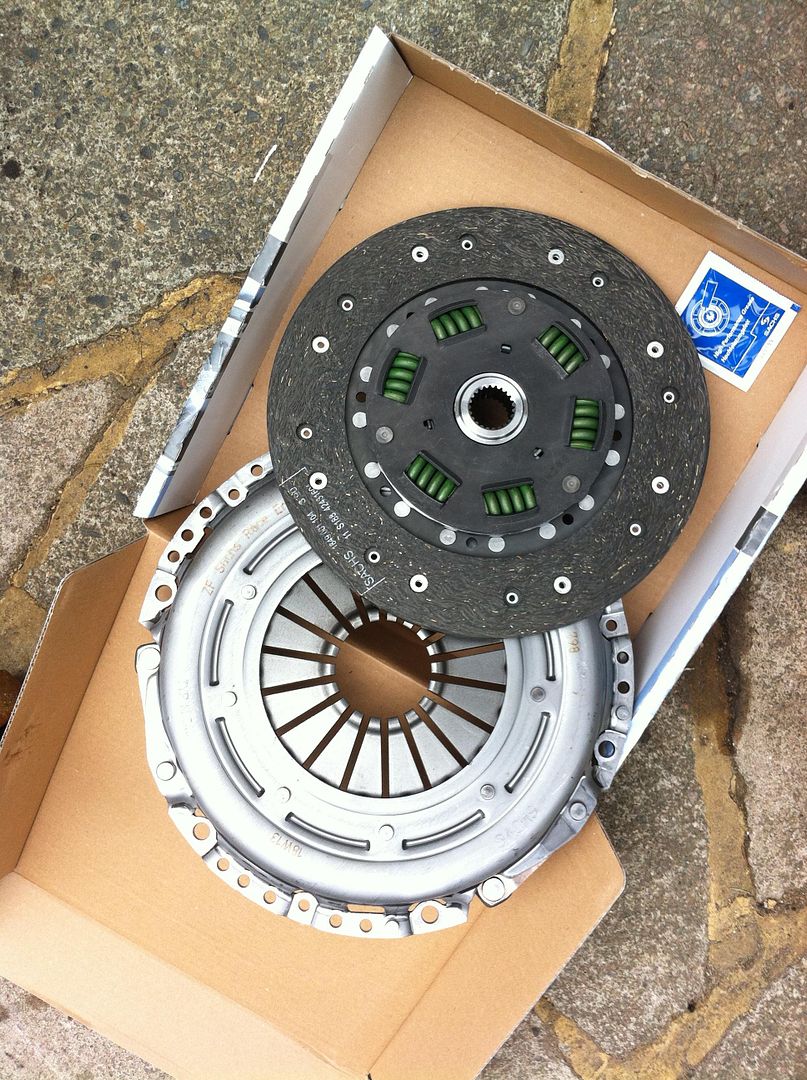

Hamz did everything he could to lay his hands on a decent uprated set up, found one in stock (from my least favourite company) and paid in full + some for next day delivery, unfortunately they didn't deliver until mid day wednesday. Hamz arrived in usual fasion long after dark on wednesday night with clutch set up.
so got home from work today, split the box off the lump and fitted the new item.
and refitted the box, then fitted the engine in the car and hoked up the basics for a test start

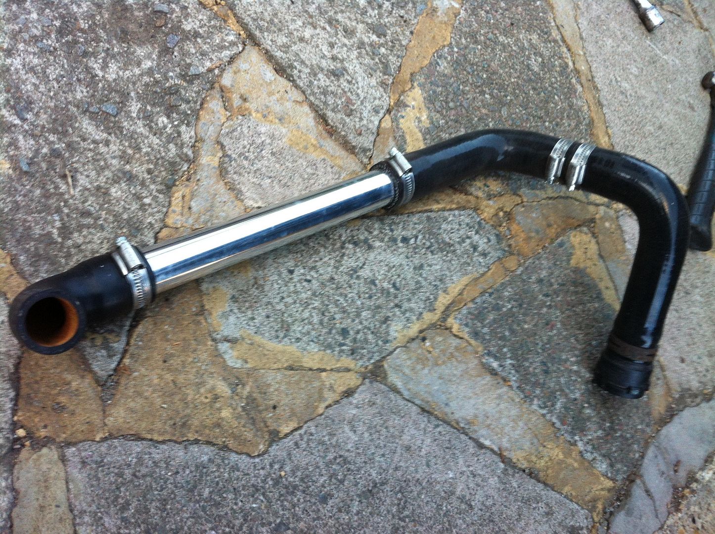

all was good so refitted scuttle, wipers, front panel etc etc etc. a couple of silicon pipes ordered arrived tuesday so could now cut them to size and make up the rad hoses

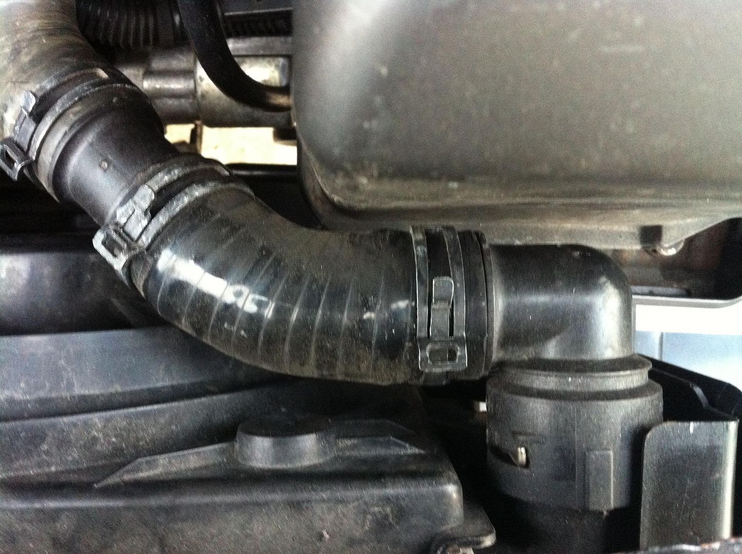

top one was easy, rotated OE hose slightly and used the centre portion of a 45* bend
the lower one is a little more involved, trimmed down a couple of 90* bends and rotated to the correct path coiple to a beaded section of ally, waiting on another ally coupler to complete the run

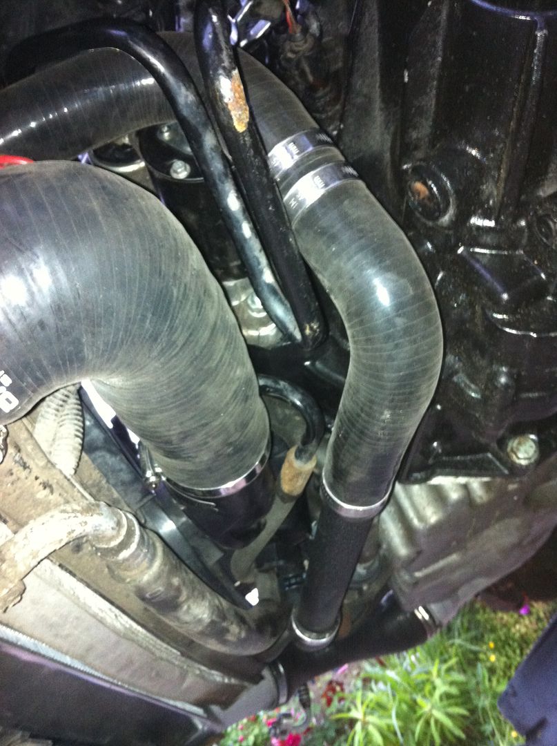

got home from work and the ally coupler had arrived so set to finishing off the lower rad hose
painted ally
fitted
next i wasn't happy with the fit of the lower boost hose so decided to revise the bracket i made, welded some spacers to it, welded a strip between the spacers, fitted riv nuts into spacers and mounted a rubber foot to sit against the sump
test fit
painted
fitted
now the front was all bolted on, rad hoses made and mounted i filled the fluids, p/s, coolant etc and ran it up to temp for the first time, all went well runs fine, no dash lights or fluid leaks.

i'll lay some paint on the intake and brace tomorrow, then the big push to get the last bits done and fingers crossed go for it's maiden voyage

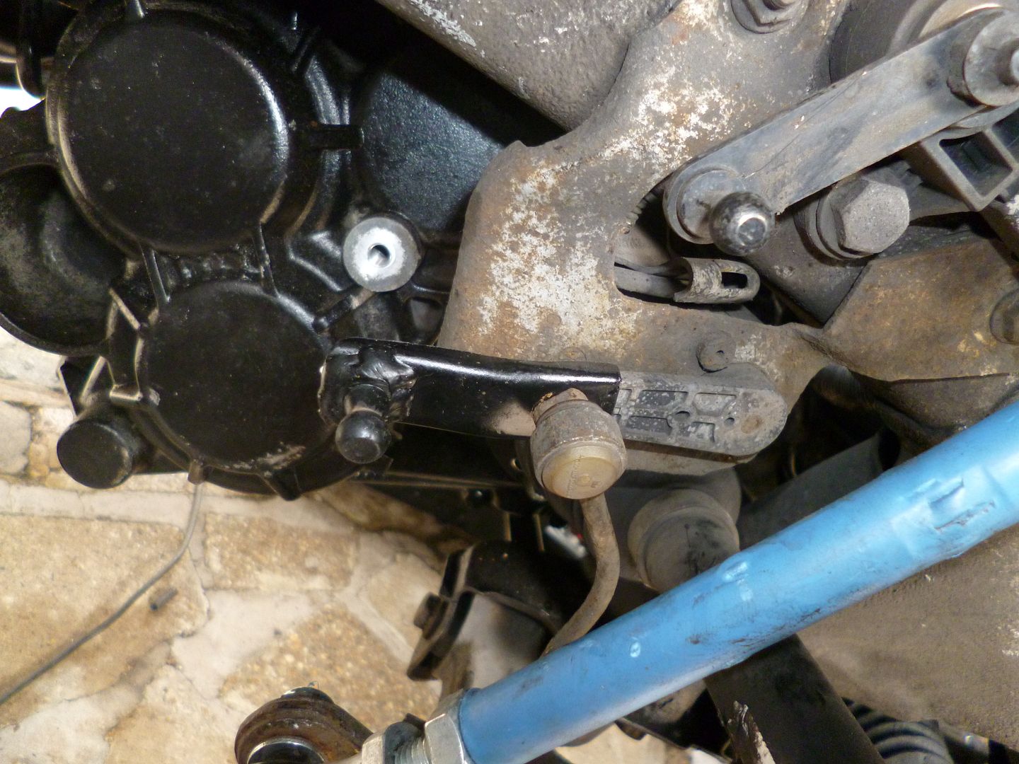

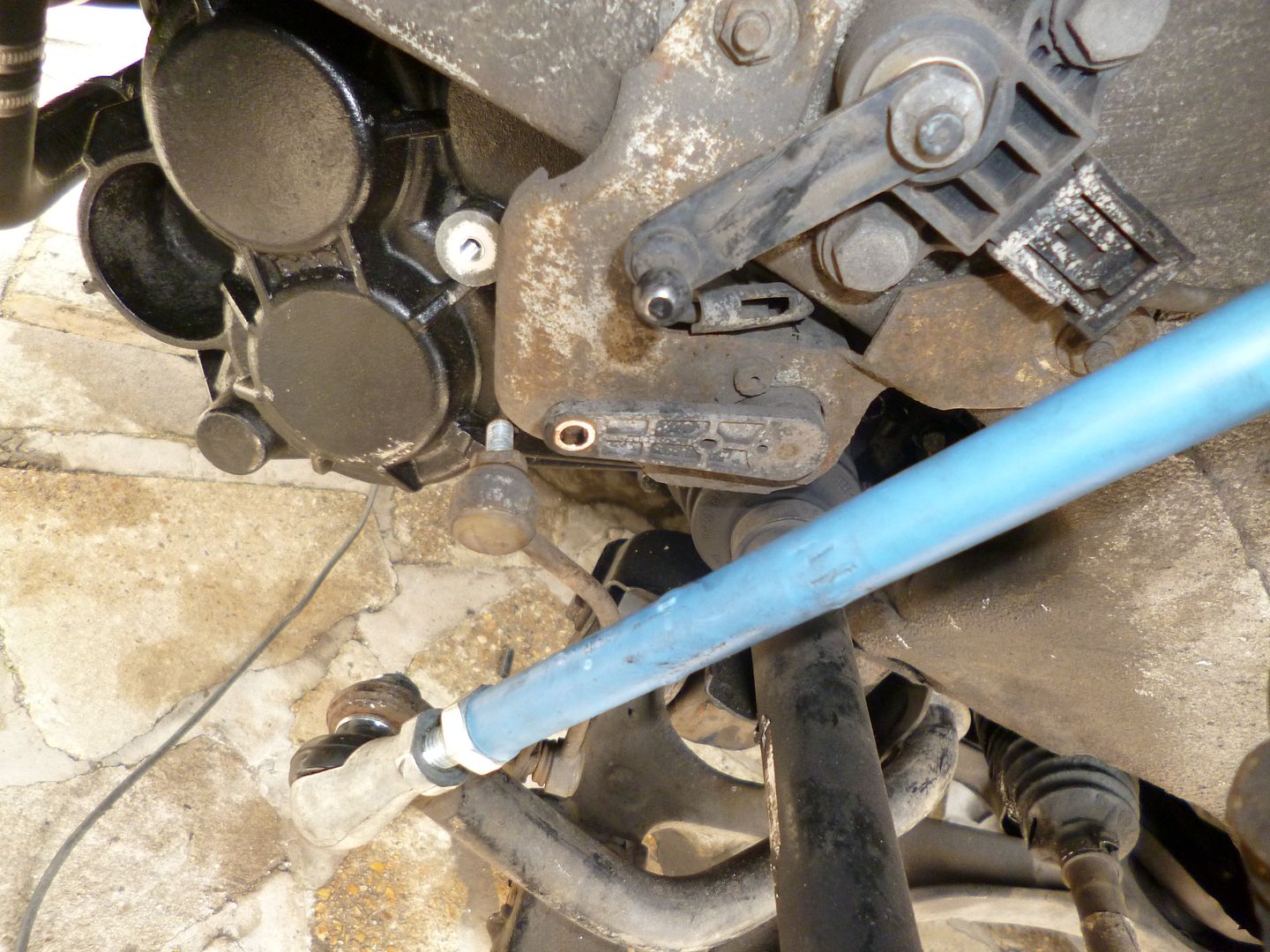

once that was bolted in it was time to figure out a way to run an ARB with the bagyards, the problem is from factory the bagyards that are built with arb mounts have relocated lines. so sourced some short custom drop links and made some brackets
worked out the best place to mount them
started by tacking in place, bolted up drop link and ran through aired out to max height and lock to lock to ensure no contact or issues. once that was fine, welded in place.
dropped some paint on and bolted up droplink

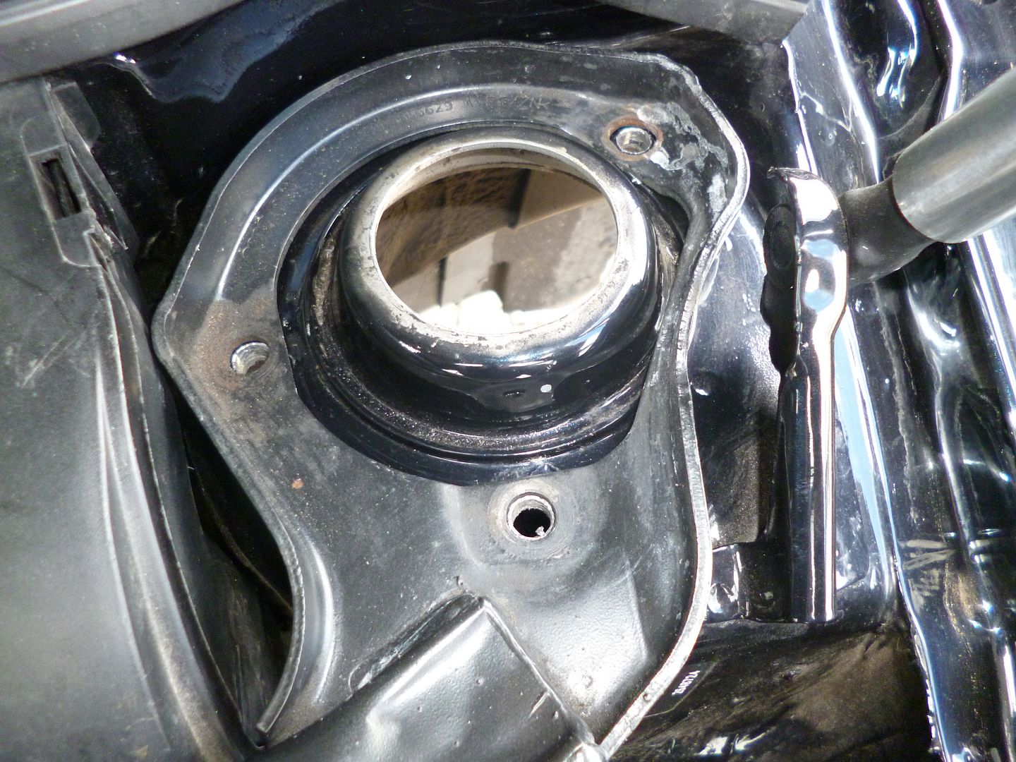

woke up this morning, switched the fuel pressure sensor on the rail and the one on top of the HPFP, scanned it at idle and fault had gone - took it for a drive and it definately felt like the quoted 300bhp. came back and rescanned and the fault had return so suspect intank pump is weak.
hamz is at work today but still managed to source a replacement he should be bringing down tonight, in the meantime with nothing left to do i gave the bay a once over and recalibrated the accuair management

Now, to many of you's it may not be alot but this is the most powerful car ive owned. Ive driven/ragged out more powerful cars from mates and rentals but this one i own is so far the most powerful one yet. the 300bhp is most definately more than enough on roads we drive on, and its funny that its so easy to break the law/speed limit.
you put your foot down.....aaaand you're there.
you see a gap to over take..... aaaand you've now overtaken.
and obviously with the 4wd kicking in its just that more crazy! Prior to olly fitting the new diff, the wheel spin was abit... fun! the car would go mental trying to get to grips with things (get it?! TRYING TO GET TO GRIPS!! .... :laugh::laugh: ) and it was abit amusing to see peoples faces trying to hear where all the tyre screaching was coming from. It most definately scares a few passengers ive had in the car, but im glad its not 2wd, that way the animal is tamed and on a leash
a few things to mention also. Im glad i fitted the front ARB again and went with the upper and lower S3 braces. It aint no track car thats for sure, but it sure as hell feels better with it than without. the Brembos too, im VERY glad i got those haha!
ive been dreaming of this conversion for a long long time and was planning to have it for my old golf but didnt want to do it in a fwd car so i waited for this car.
The wait has been worth it :heart:
(car booked in for more custom software and dyno in mid august... hoping to make the most of this engine, hopefully around 360bhp)
