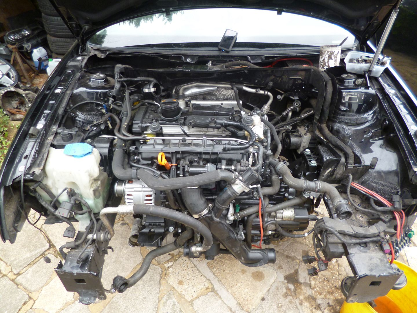

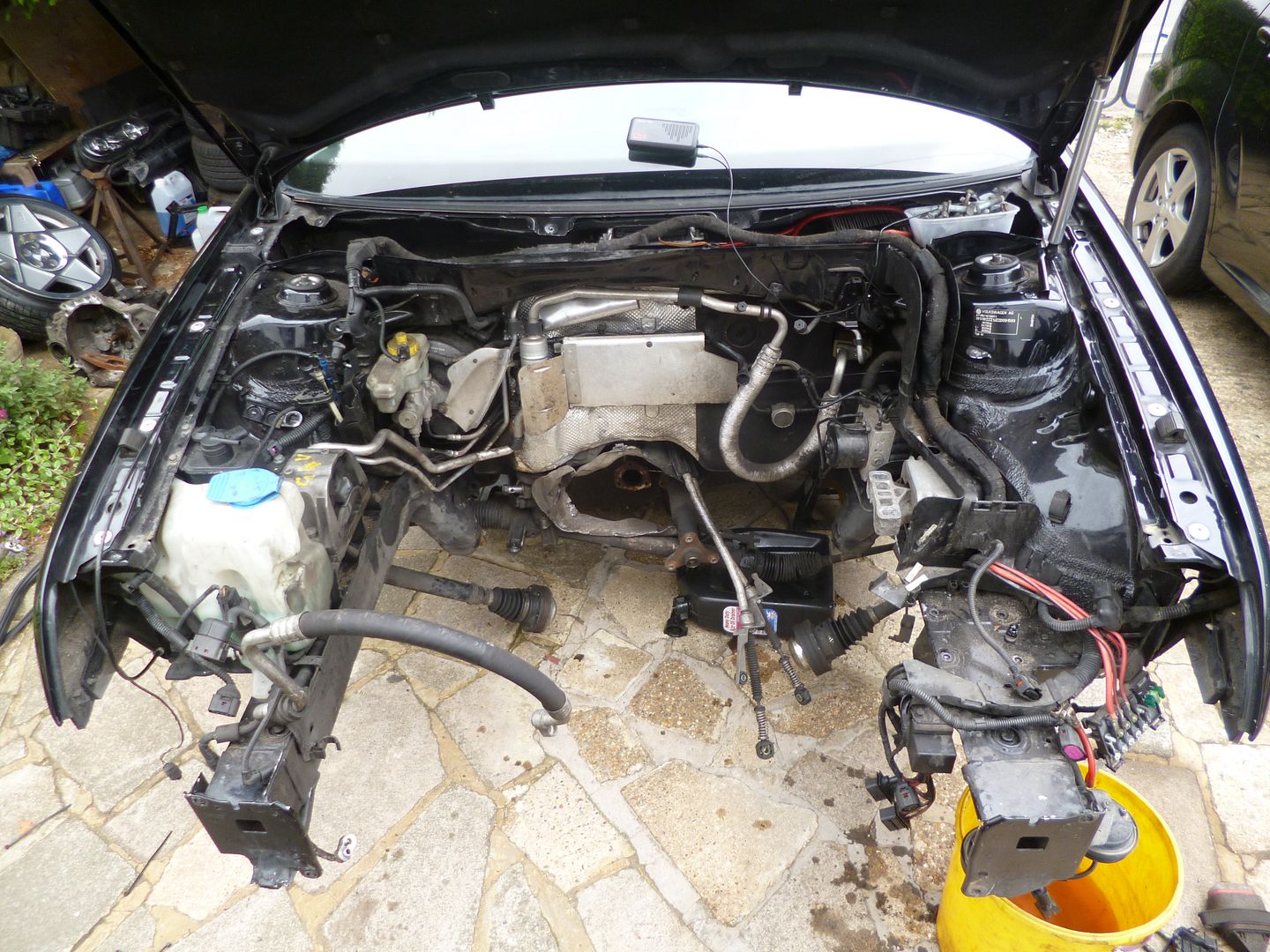

sadly no, although the engine and ancilliarues is all fitted in. theres all the custom downpipe and intercooler piping that we dont/didnt have when i dropped the car off as the only way to find out what parts we'd need is to mock the new engine up in the bay first. so all that is being done now.Originally posted by pjurisprudencia View Postcar back from the swap?!
that, and the fact that the work is being done by a mate of mine, on his restricted driveway after he gets home from work. so no fancy tools or workshop. not even a roof over the car lol

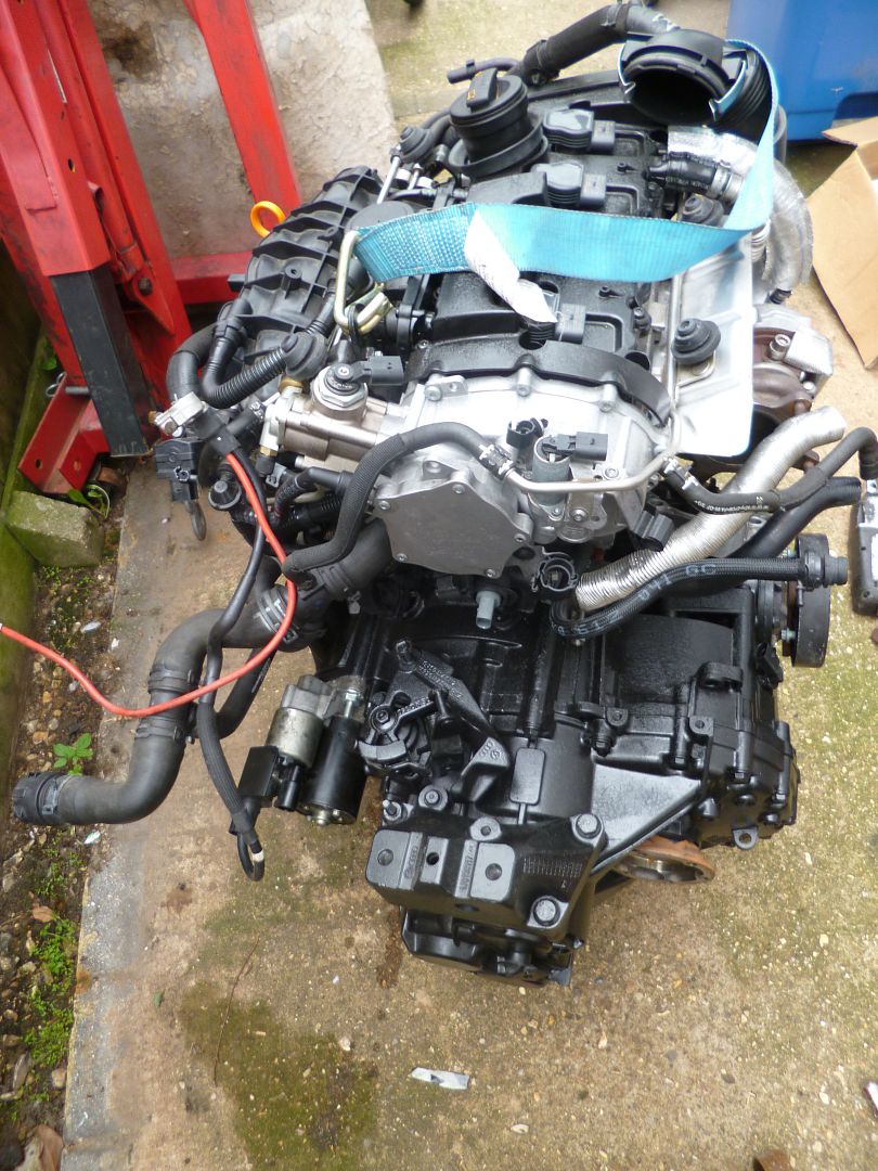

out

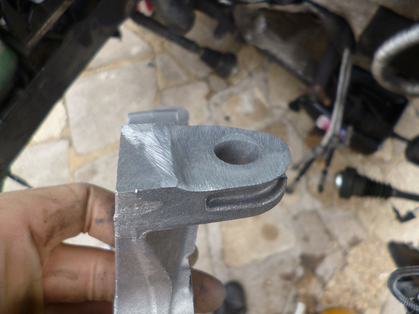

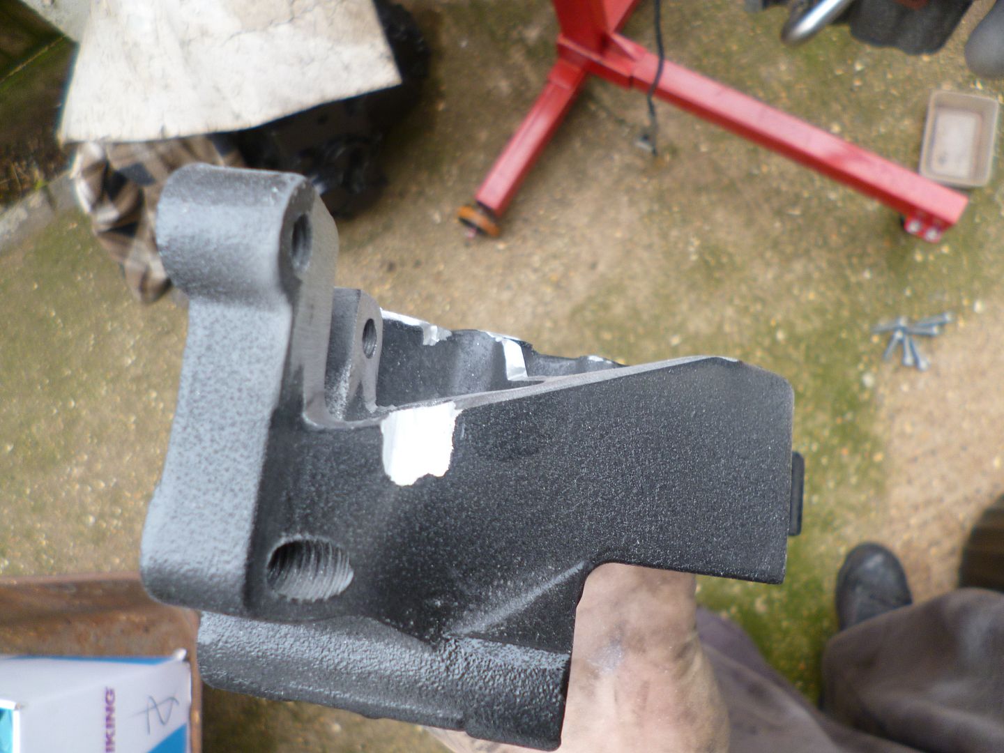

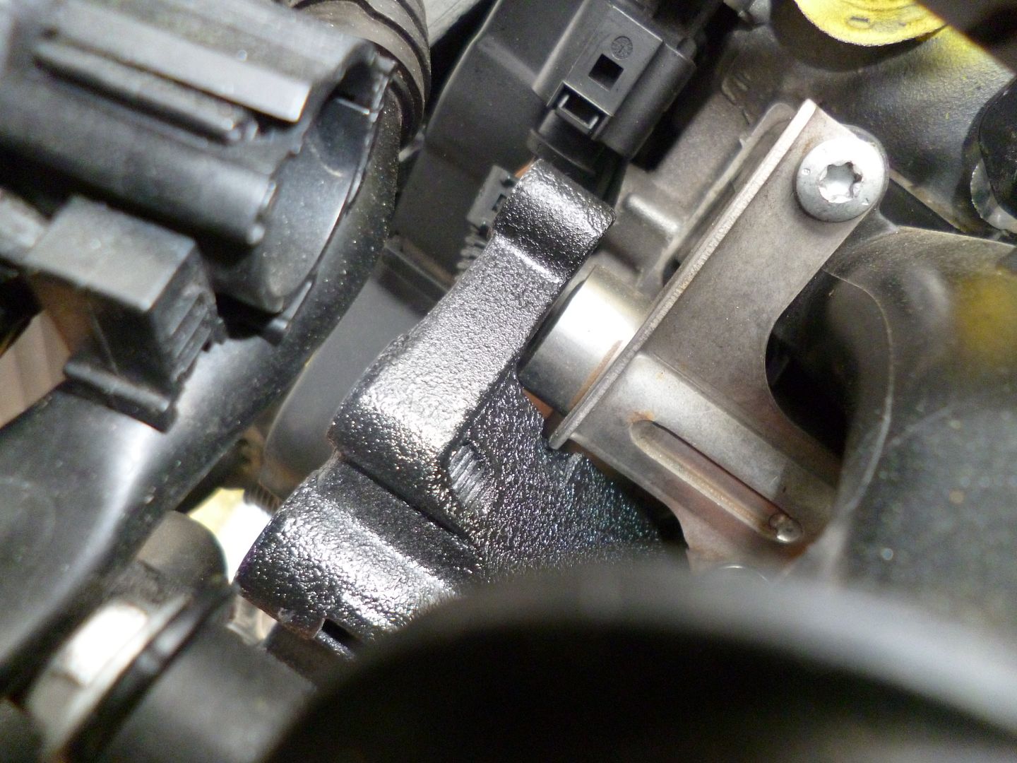

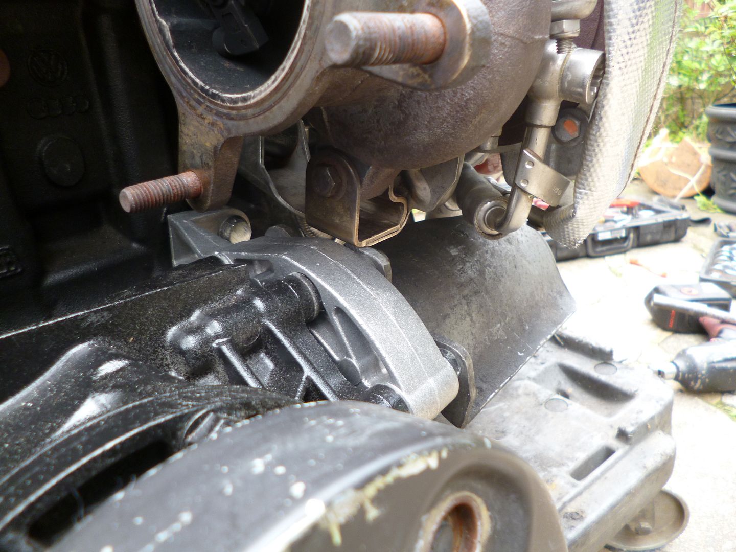

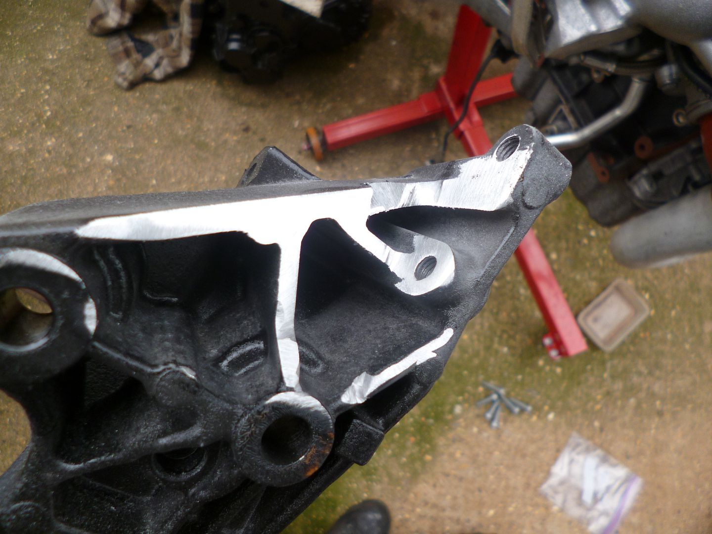

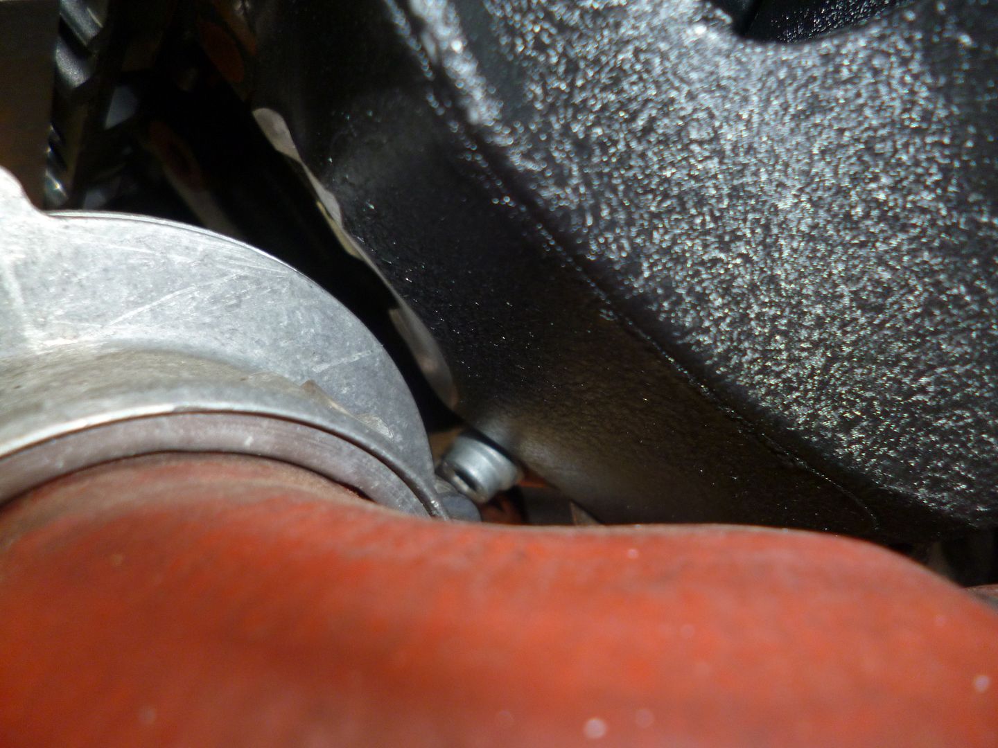

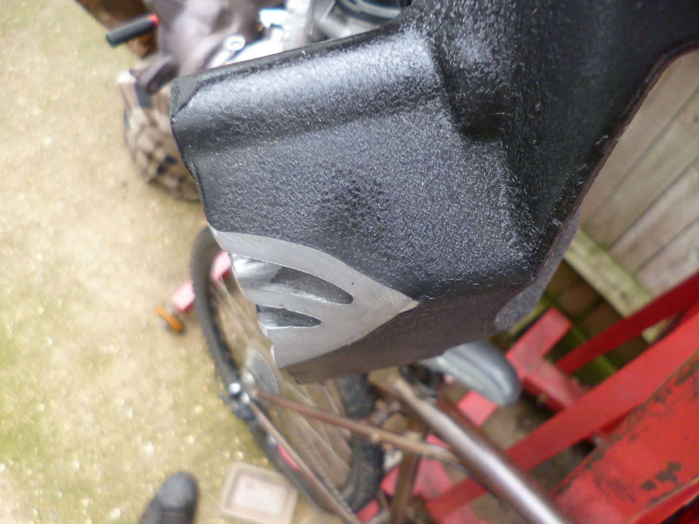

modifying mounts to fit the TFSI
wrinkled
audi tt box on
slight mod to transfer bracket
close
perched

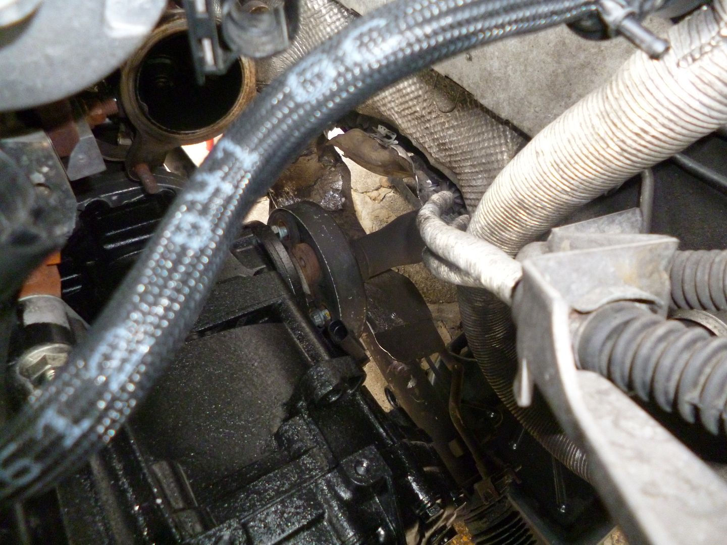

first look at turbo exit and sizing up downpipe route....

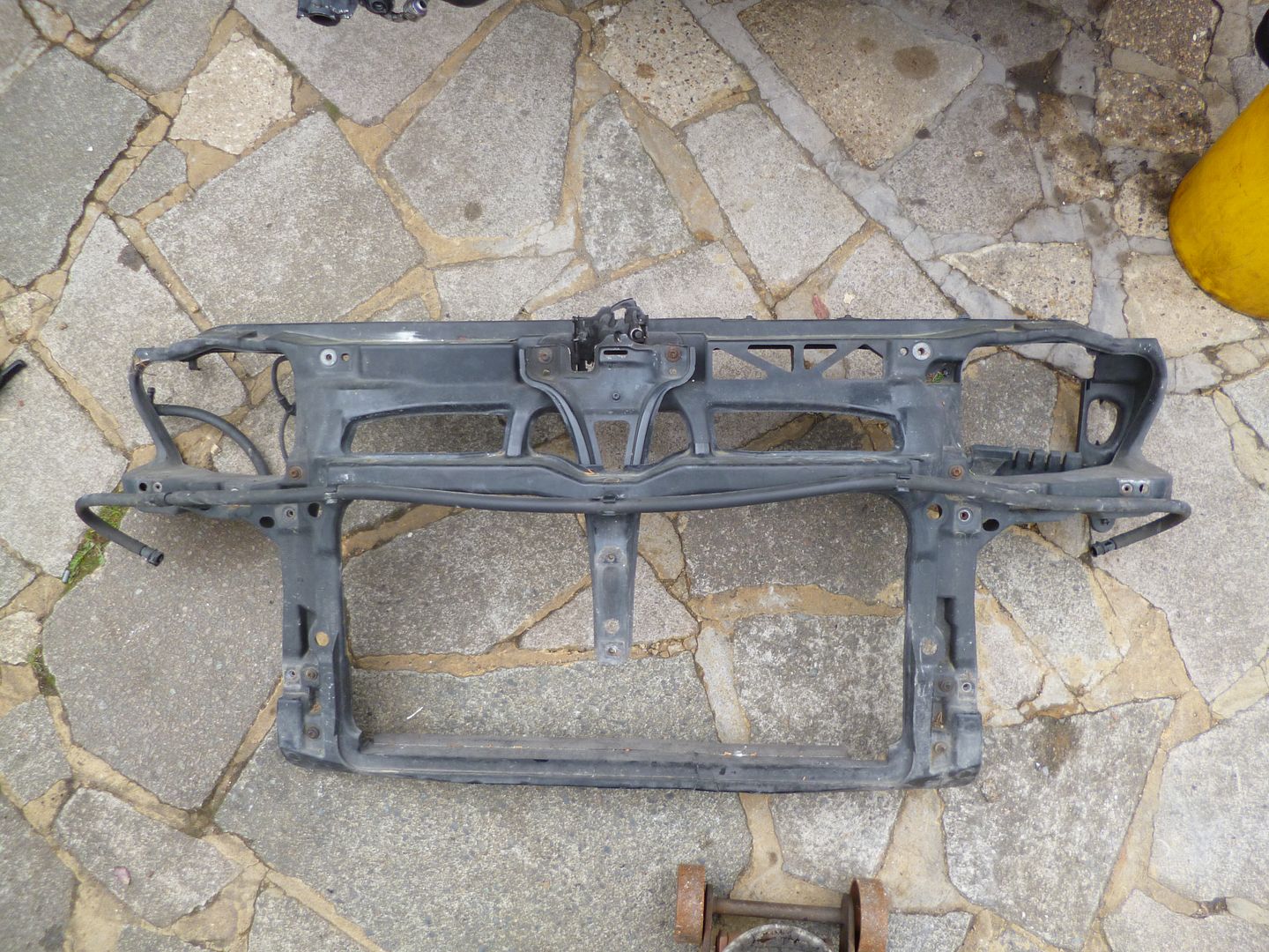

now after i sold my bora and been working on a lot more TFSI cars doing turbo conversions etc i had a little idea

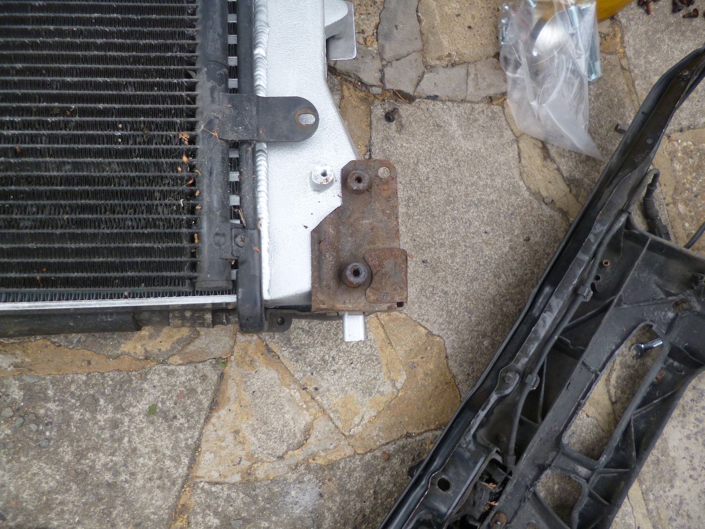

PD150 front panel off a mk4 diesel

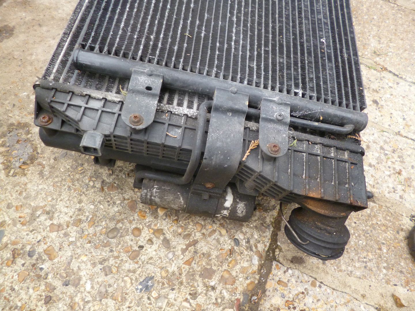

Rad pack

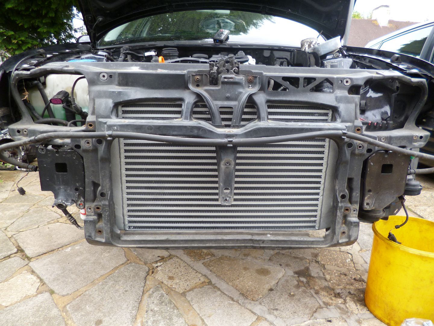

THS S3 TFSI FMIC (revo edition)

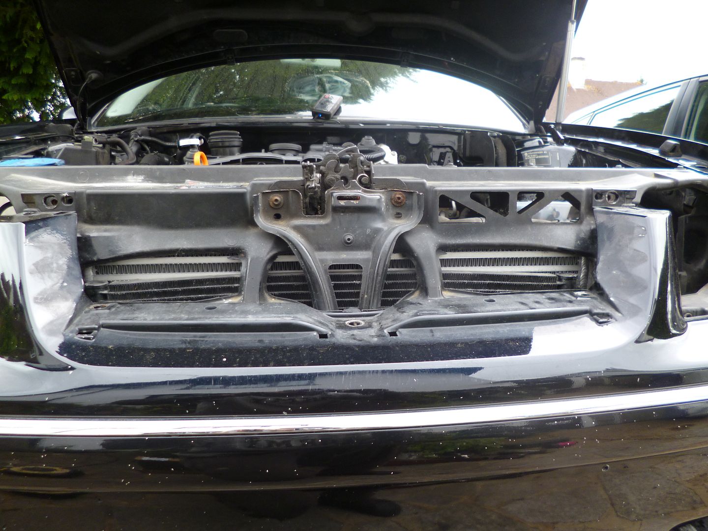

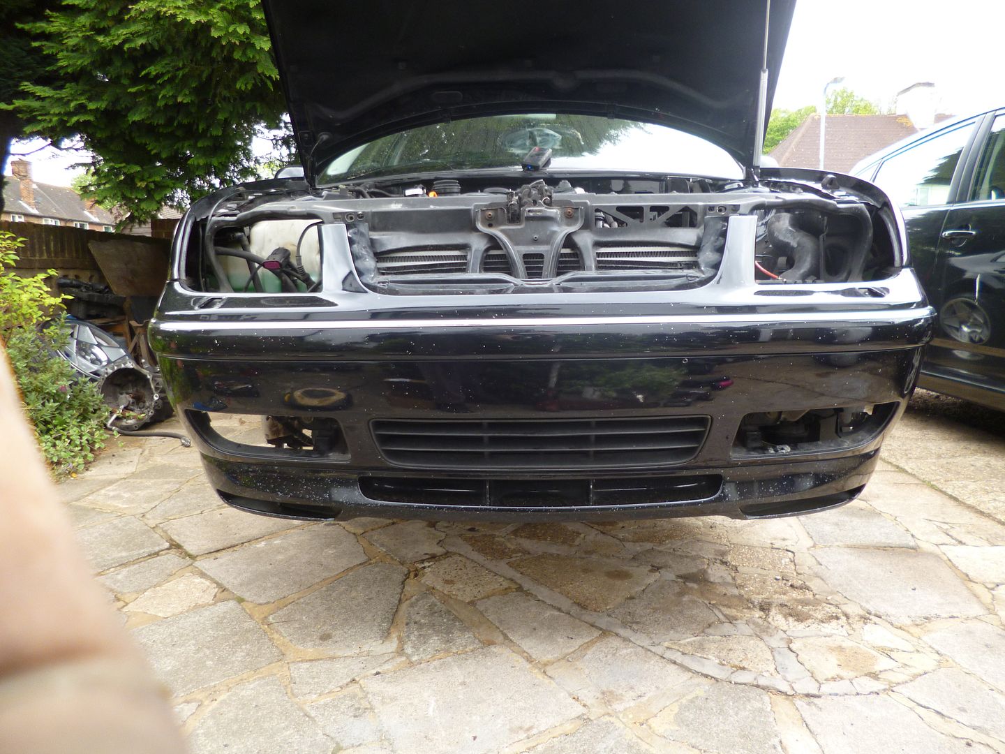

mounted PD a/c rad and trimmed mounts
mounted and trial fit bumper
(check out the stone chips!!)

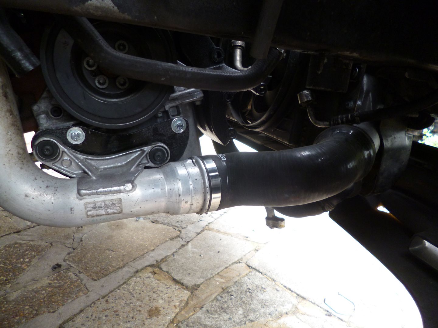

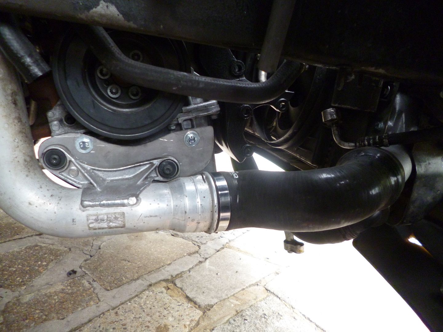

bracket to relocate hard pipe and make it possible to use TFSI silicon FMIC pipe

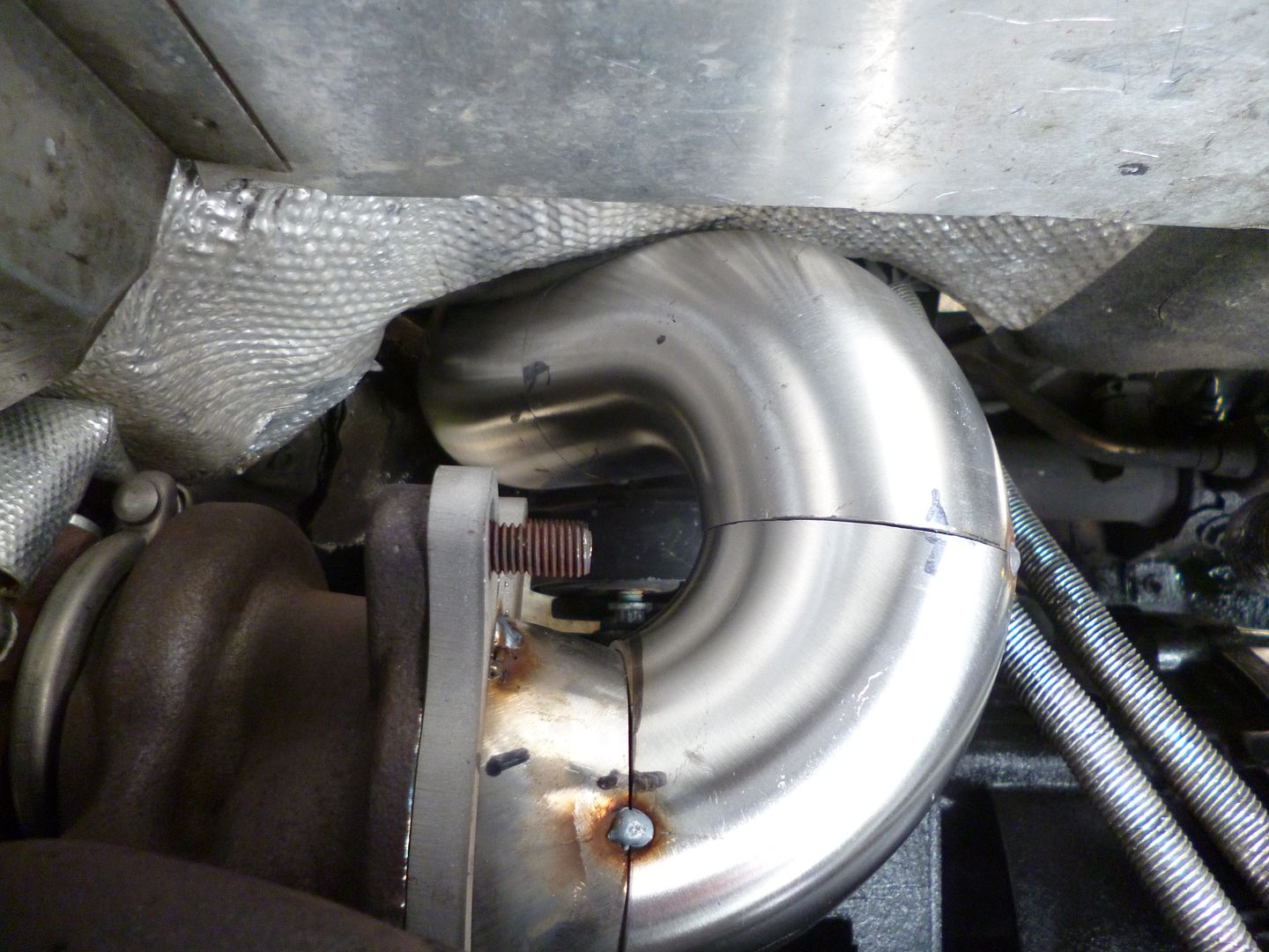

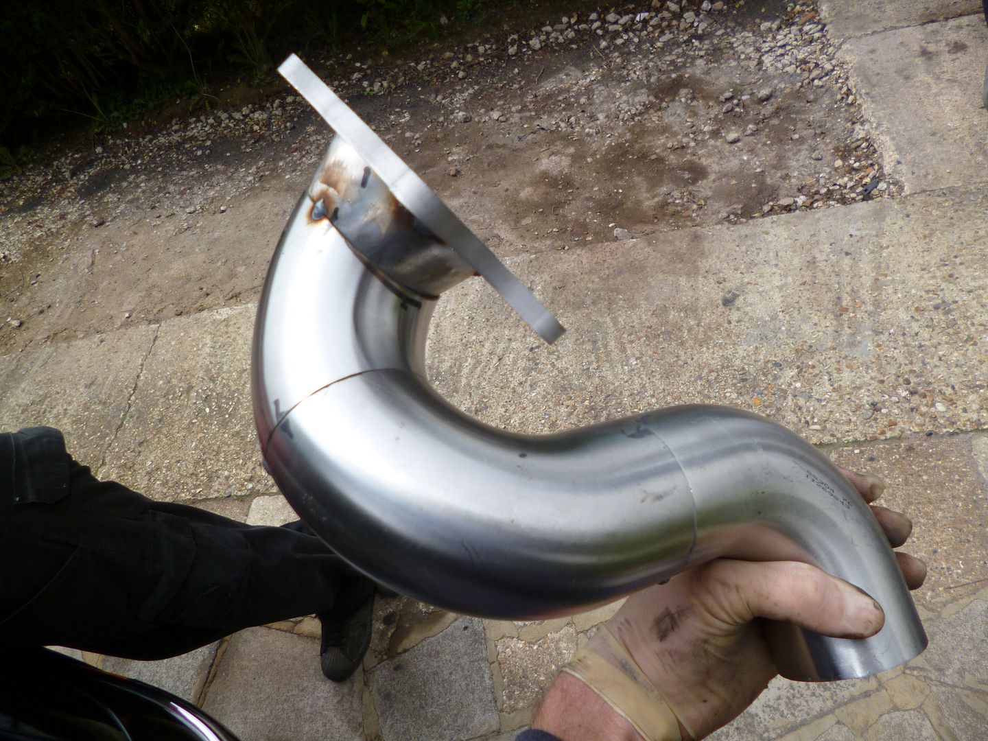

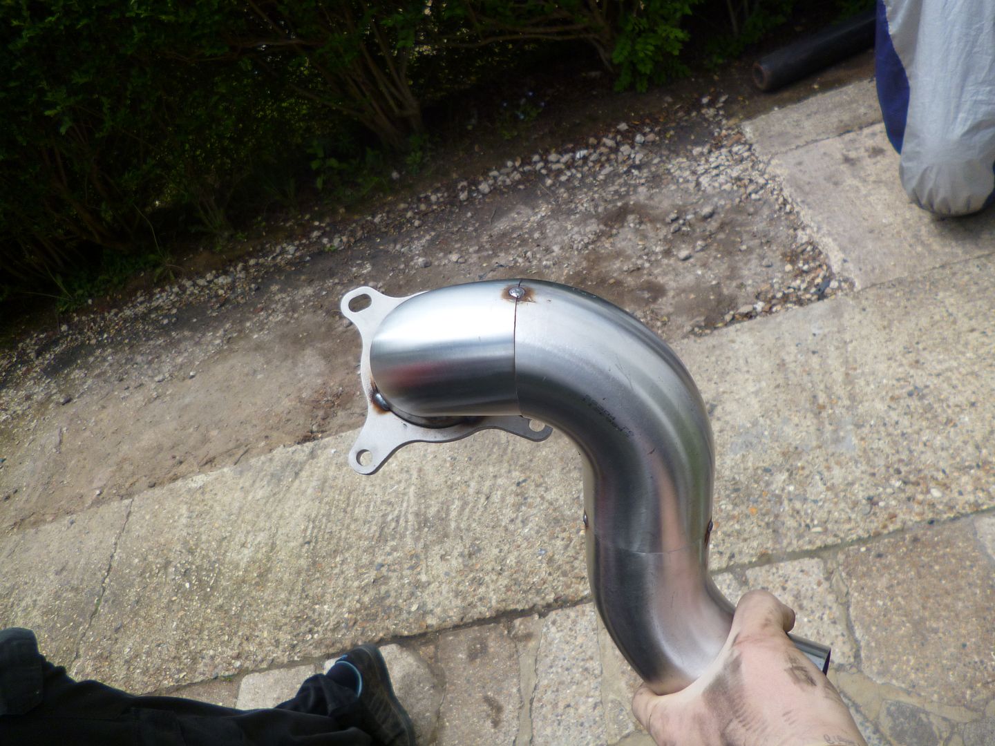

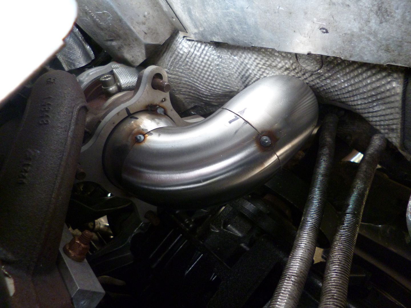

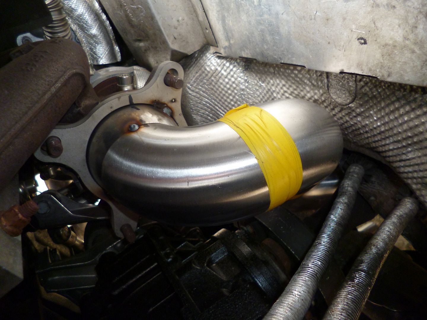

now the bit that has had me a little concerned after Qpeng reported problems fabing a DP, once the lump was in i refitted the
subframe so i could see what sort of piping would be needed to fab a 3" DP run
3 x 90* 76mm
1 x 45* 76mm
1 x K04 flange
1 x 4" long 76mm flexi joint
2 x stainless lambda bosses

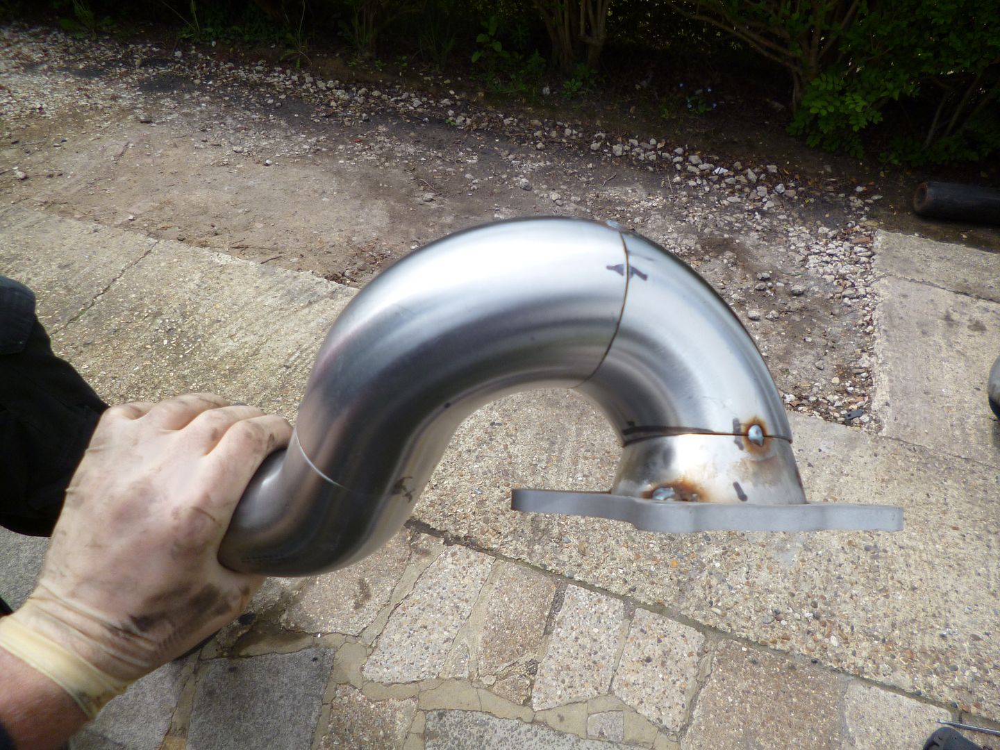

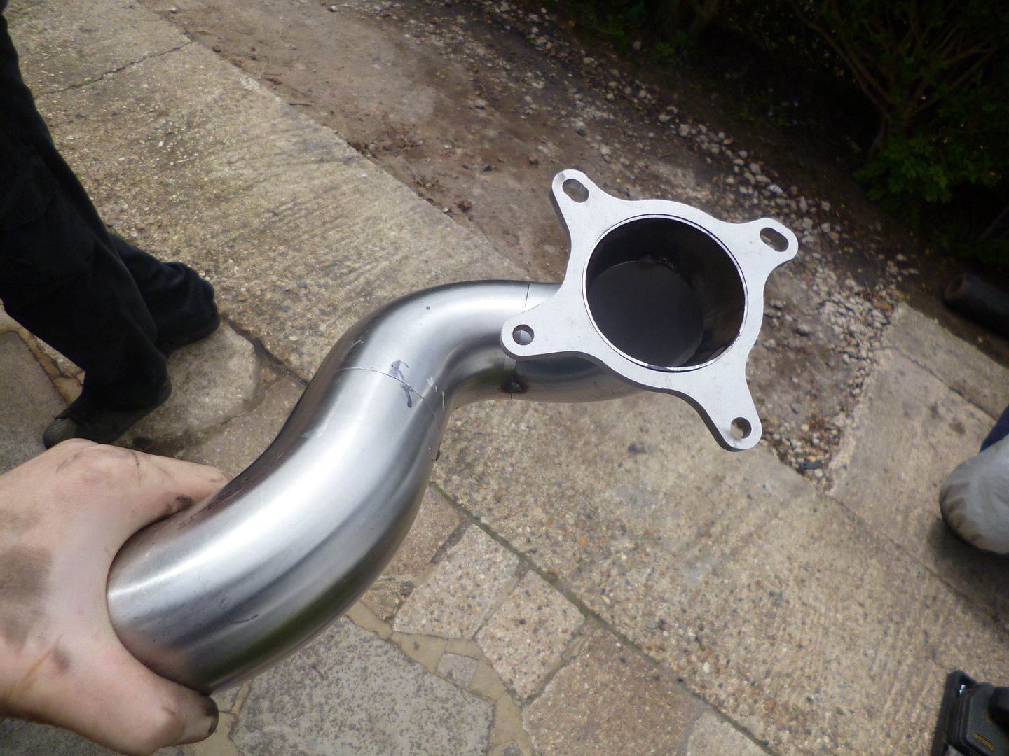

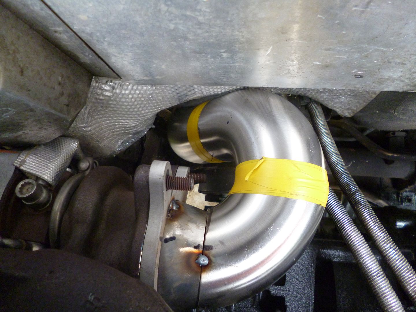

parts arrived friday so set about mocking up a route, trimmed the 90* down to the correct lengths, rotated to the correct angles,
marked and taped to test fit
once i was happy with the run, spot welded it and tried again
and looks like this
welded it up, need to add in the lambda bosses, add 3" on the bottom then fit the 76mm V band connector thats has been ordered, once thats on make a small section with the flexi on to join to the centre section.
