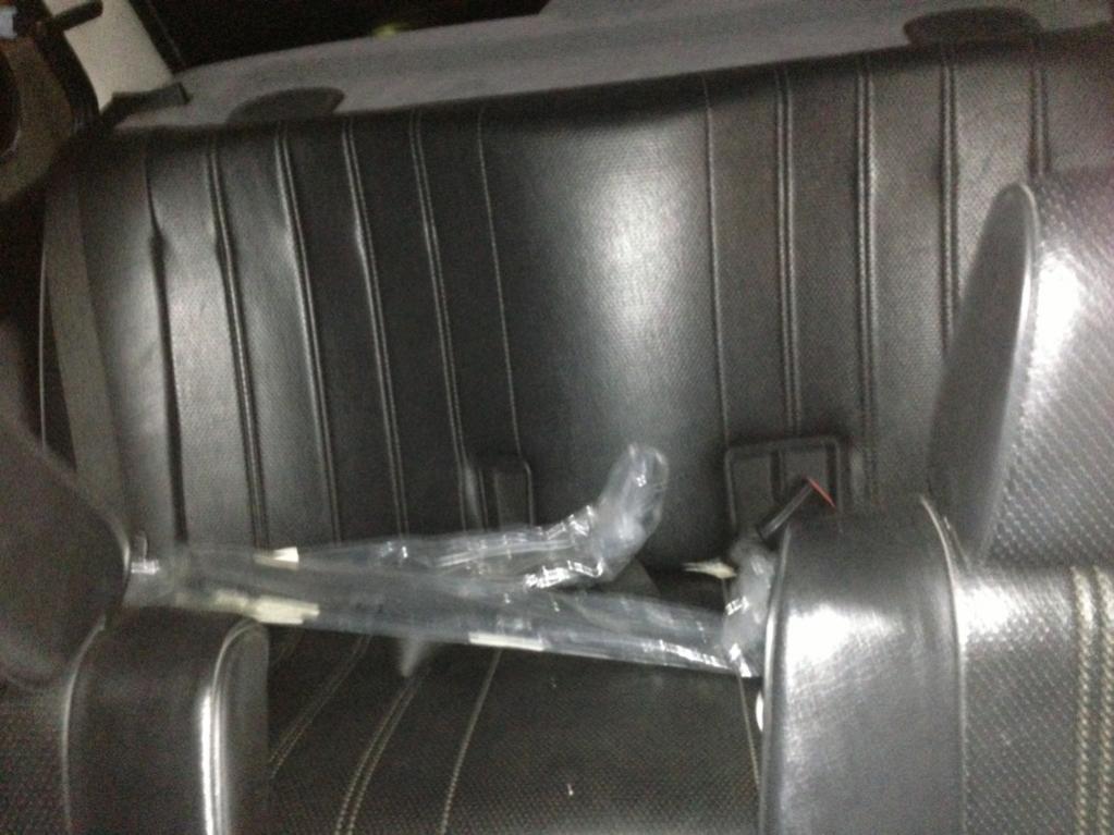

      Test Fit the Rear Seats...good, but not perfect, bottom was just not quite right and had mounting issues, So I took the old bench and this bench to the upholster to have him recover the old foam with this material...

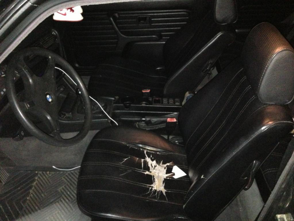

        I had also picked up another set of Recaro Trophies, this time Electrics and ordered my brackets...

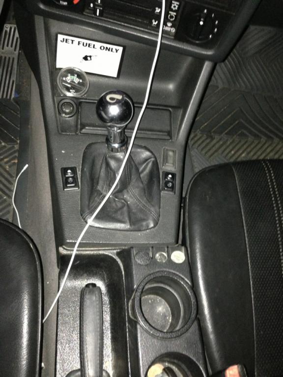

        Anything was better than the sloppy 325i long shifter...and that damn center console had to be replaced
        You can see the PO with their einstein engineering skills drilled that damn hole with it still in the car...what a mess, anyway
        Old center console vs new
        Trey (Yert315) came by and helped me out, (I couldnt get the bitch clip off a few nights ago) and we got the bitch in...Will say this, while it is a great quickshifter, all the threads were super freakin tight and are nearly imposible with a crescent wrench to tighten, and the seated bolts made it difficult to work with because the notches on the plate were larger than the seated bolt square, but we made it work...
        Quickshifter in, and cleaned up the interior to install the new center console...

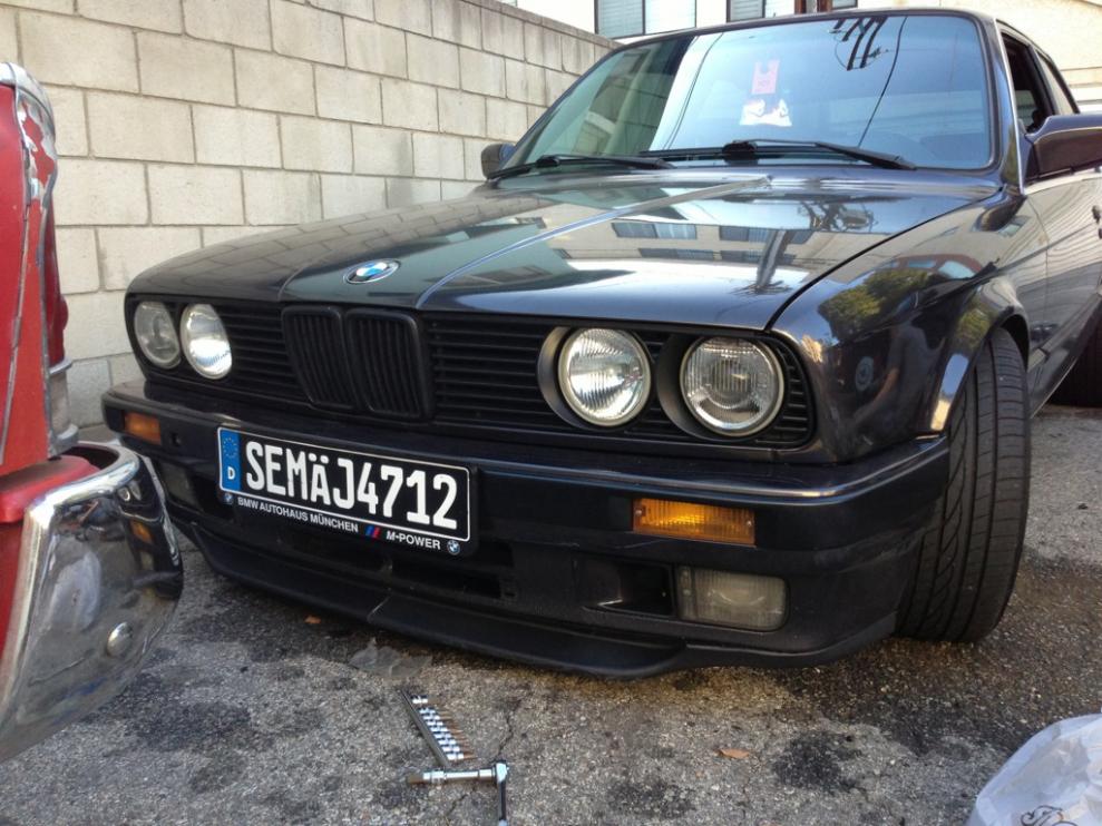

              Holy shit, this is going to be absolutely amazing
                I got in a package from an old VW friend...
                Passat B3 Duck Bill front valence...
                I really like the look of the IS lip and IS lip with splitter, but also I am still very partial to the old VW Duck bills...and saw this and thought it would be a nice idea to try it since I could get one for a steal
                Here it is unmolested
                Side by side with the modified one...the side was shaved by about an inch and a half...the front had to be shaved 4 inches (2 on each side) all the forward tabs shaved off, and then holes drilled for bolts and zip ties...
                Truthfully ended up going on pretty easy and pretty happy with the way it works...
                I mean for essentially costing me 10 bucks, it looks really good...but I am not very happy with this, part of this I did, hense the hole and too much shaving of tabs...but it sticks out a little bit, which doesnt bother me, but being able to see what I shaved does...open to ideas on how to fill this back in, Plastic filler??

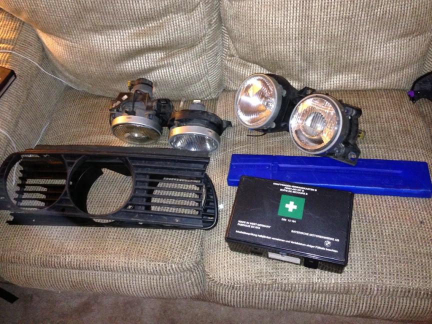

                Then santa brought some goodies from Germany
                Installed
