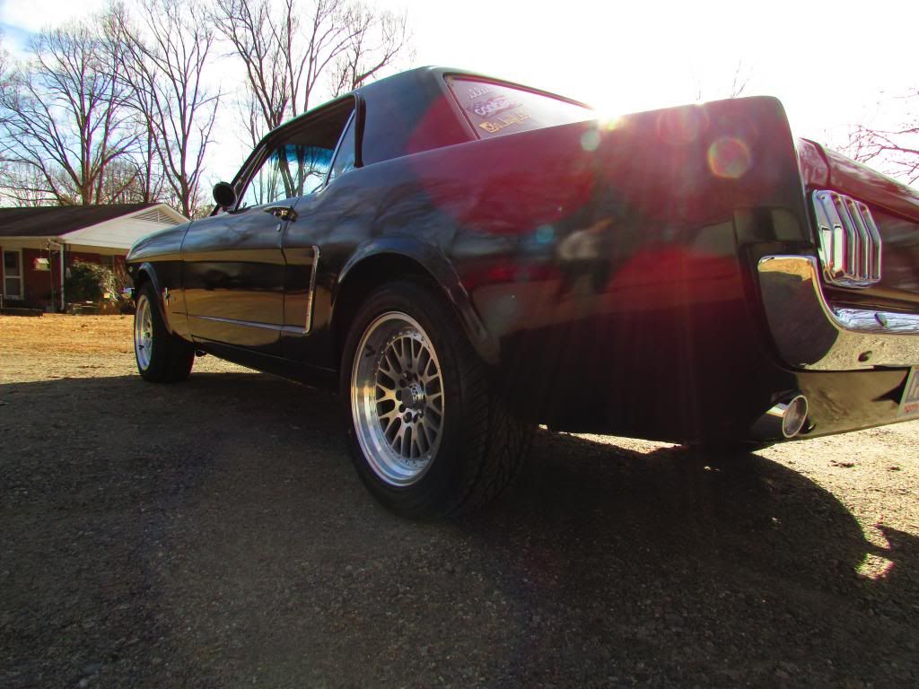

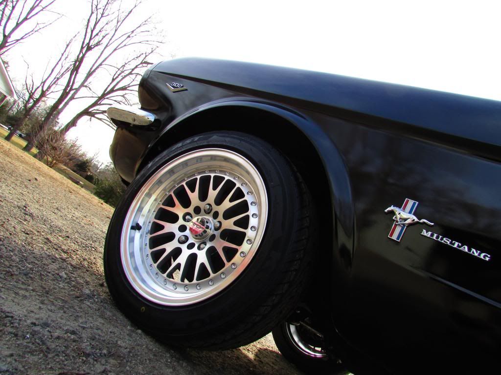

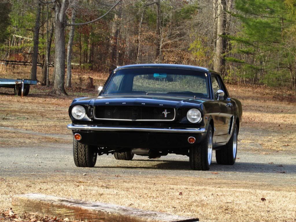

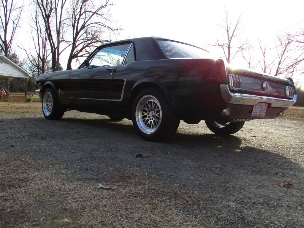

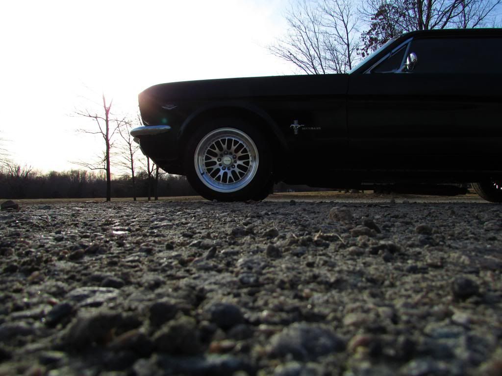

    UPDATE!!!
    BAM!!!

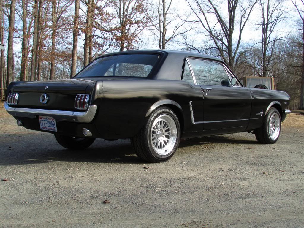

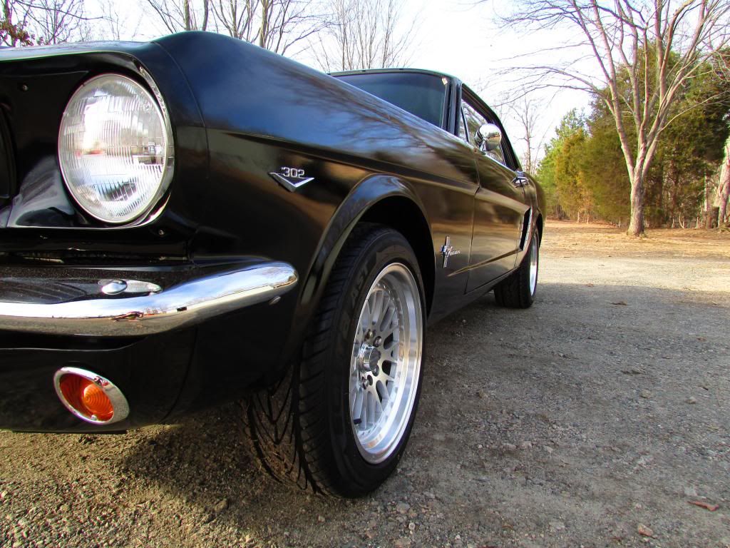

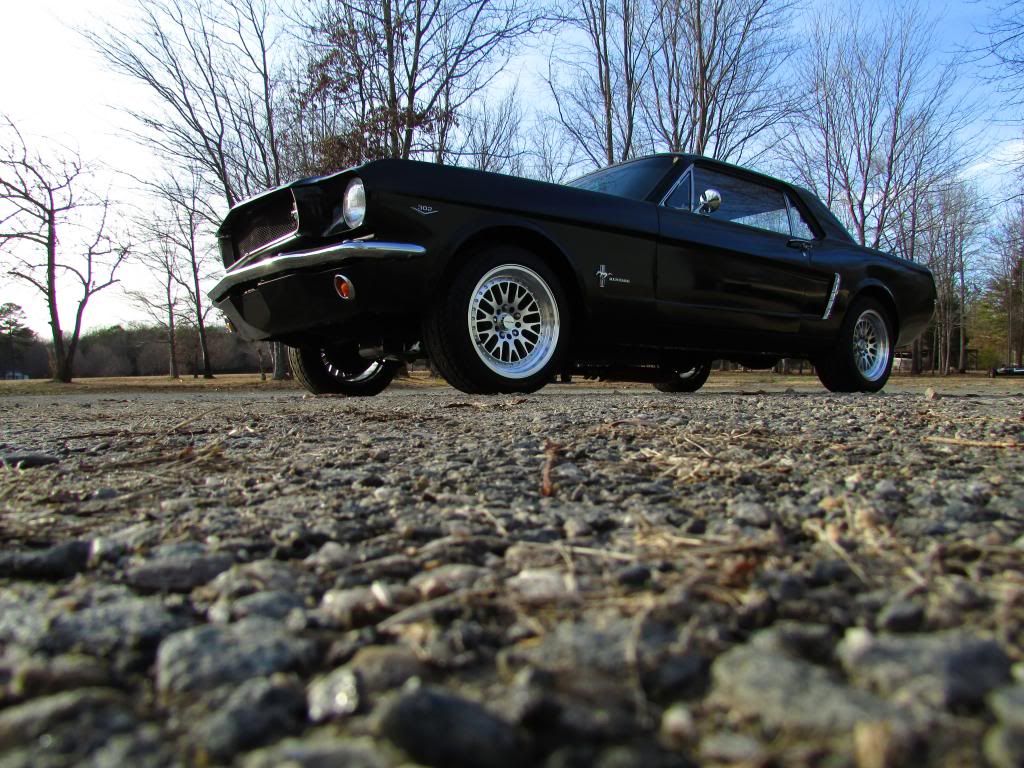

    1" inch spacers on the front 1/4" spacers in the rear. Rear could use more but the brake kit Im looking at moves the hub out another 1/4" so Im going to wait til then and see what needs to be done. This is about the only progress other than a new carb which has yet to be setup because I am waiting on a new throttle linkage to get here. Once I get the engine running Im going to take it to have the alignment and exhaust put on.
    As for lows I'll probably cut a coil or a little more off the front, that should get it sorta low for now. Still need to roll the fenders before I get too low.
    The wheels are Varrstoen V3s 16x8 et25 with 205 50 and 225 50 Kumho ecstas. The fronts have a slight stretch.
    Here are some more photos I took today.
    No Im not a photographer my pics probably show it I do enjoy taking pictures of the car.
    Hopefully more updates soon.

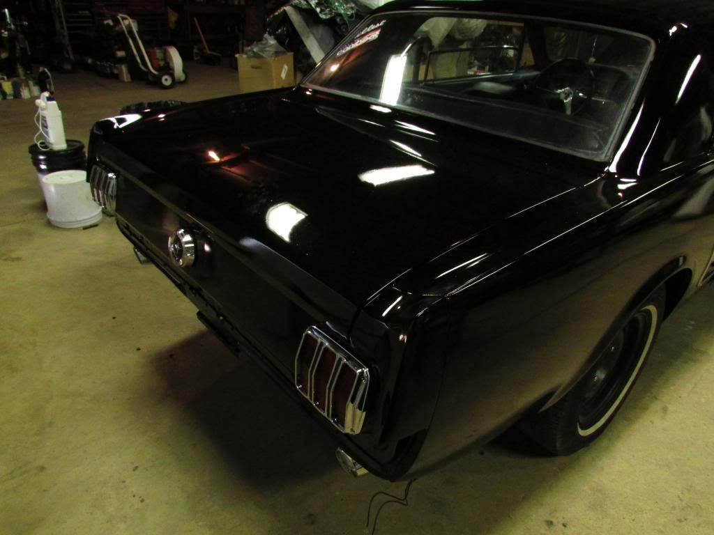

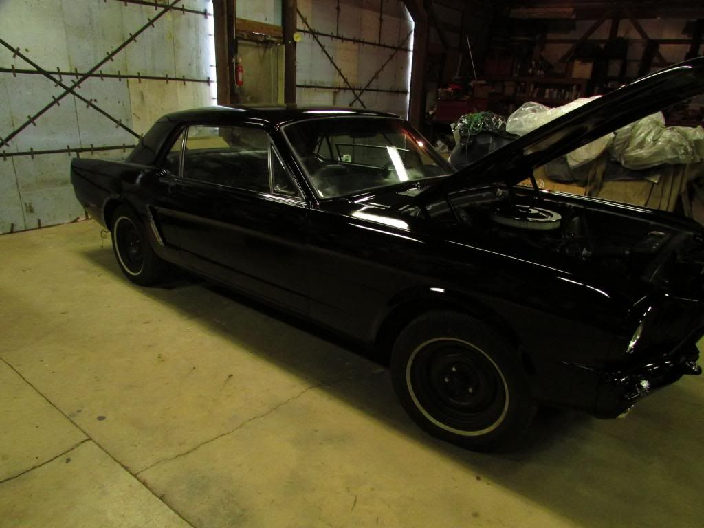

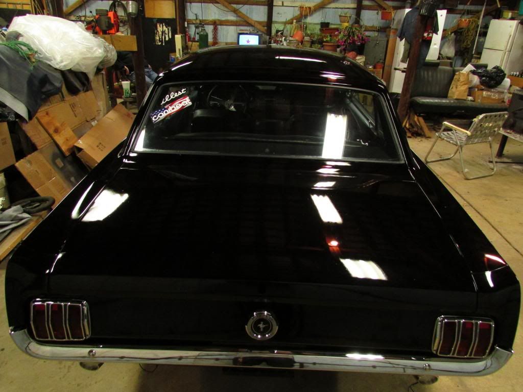

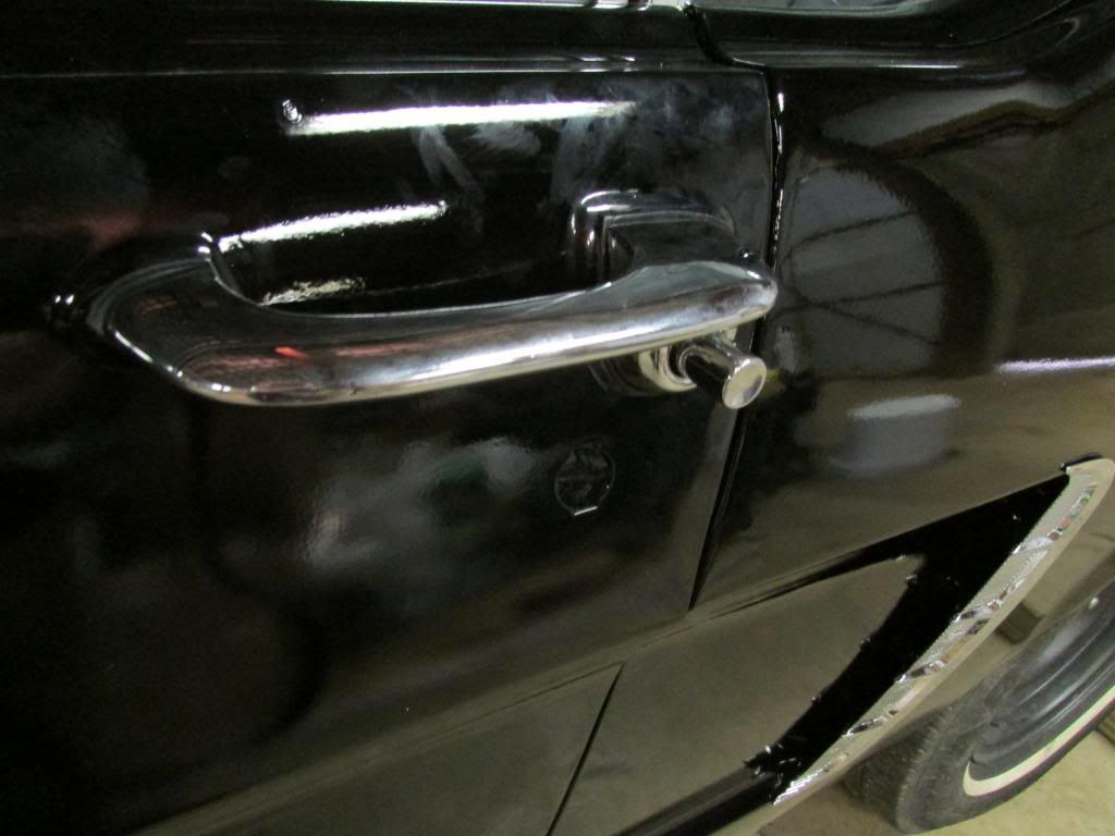

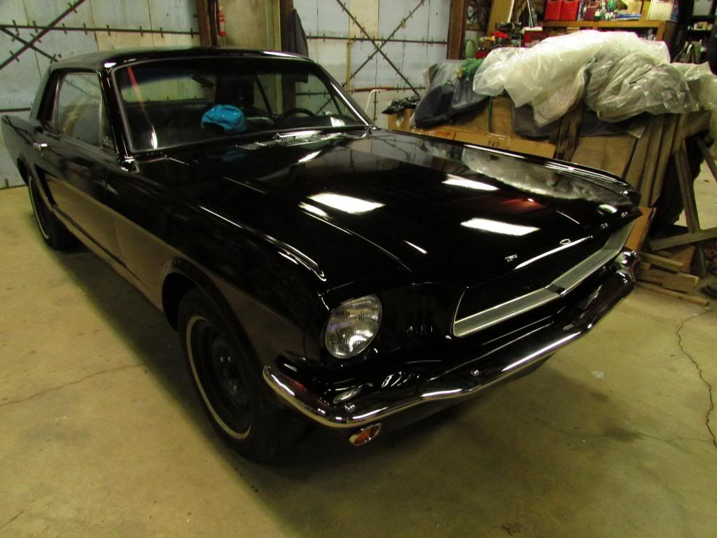

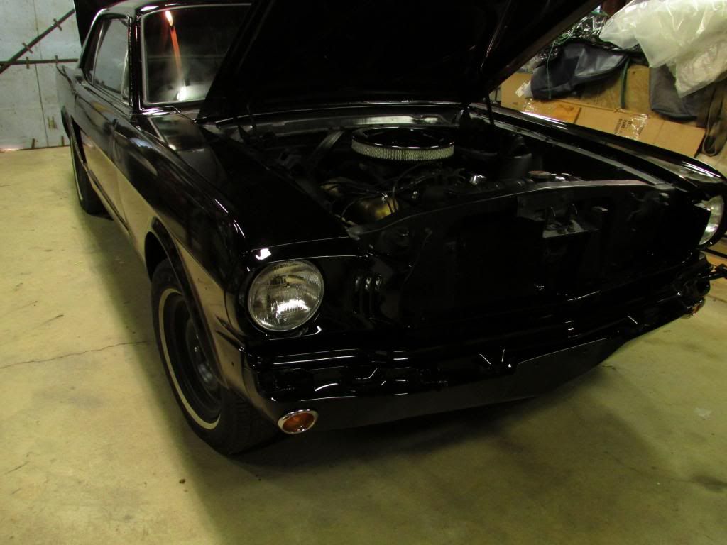

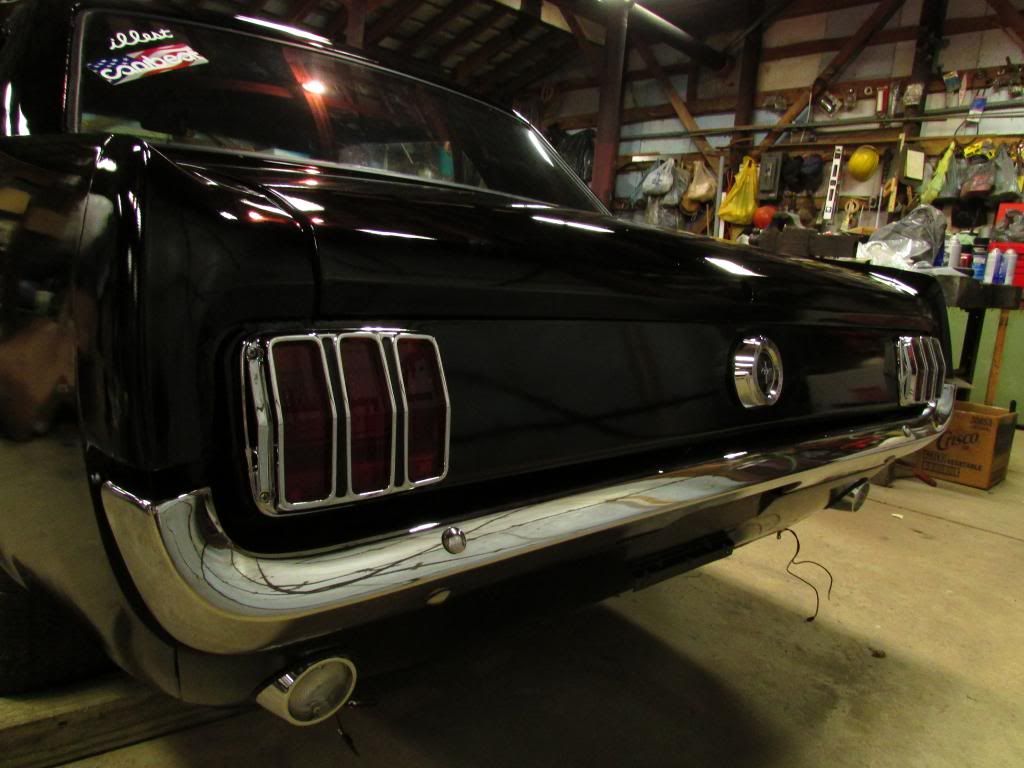

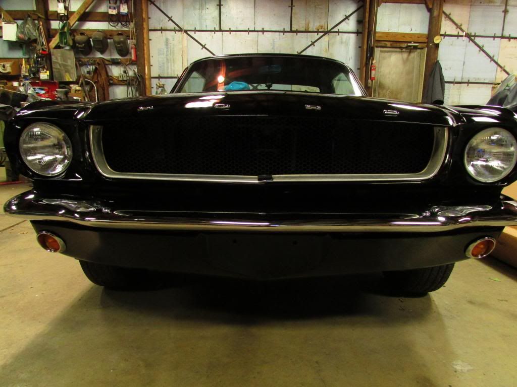

    UPDATE!!!
    Got the car out of the paint building and back in the main shop. Time to get this bitch finished!
    Headlights and turn signals
    Tail lights, gas cap and filler neck, and backup lights. Need to redrill the whole where the backup light wire grommet goes to get them wired up and working.
    Also the side trim thingys behind the doors. Didnt get a close up of them
    Them door handles!
    Old door seals.
    New door seals
    Rear bumper. Still needs some shimming to make it fit flusher to the body.
    Front bumper and stuck the old grill trim in for the hell of it.
    And just a few before and after shots.
    [URL=http://s1293.photobucket.com/user/Huffy704/media/IMG_1284_zps1929ae59.jpg.html]
    Still not finished but its almost driveable and Im extremely excited. Started looking at wheels also and Im thinking 16x8s for now. I know most of you **** reps but xxr 521s are probably going to be the ones for a while. The only LM style wheel I can find in 16x8 5x114.3 at a price that will allow me to afford to do other things to the car. Later on Ill probably purchase some CCWs classics or something similar from them.
