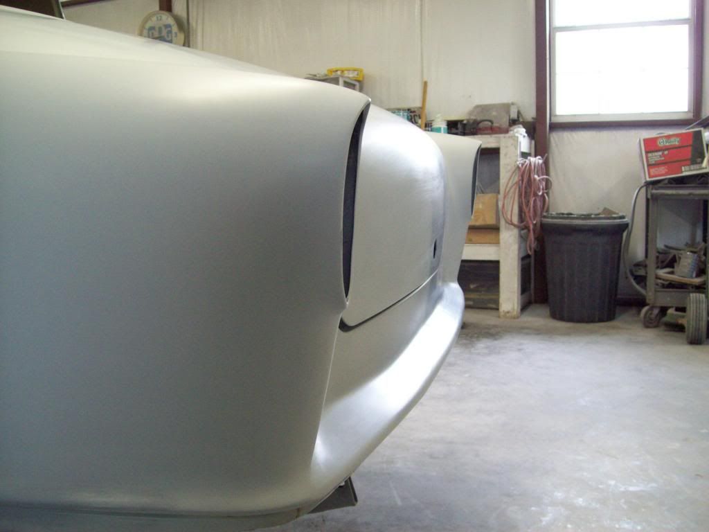

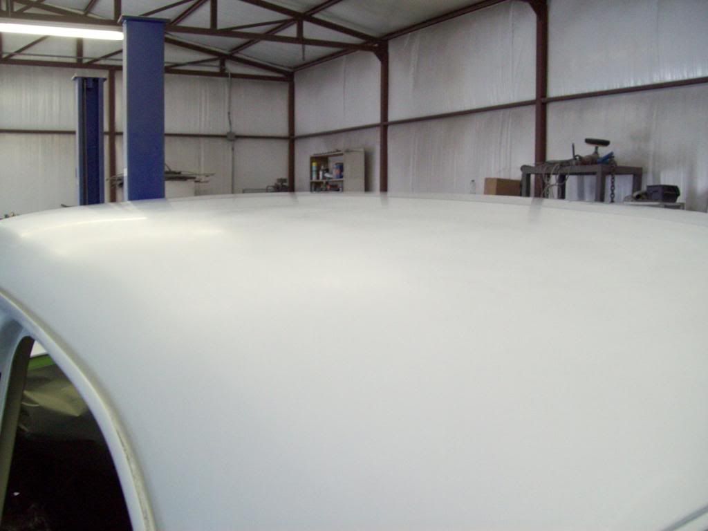

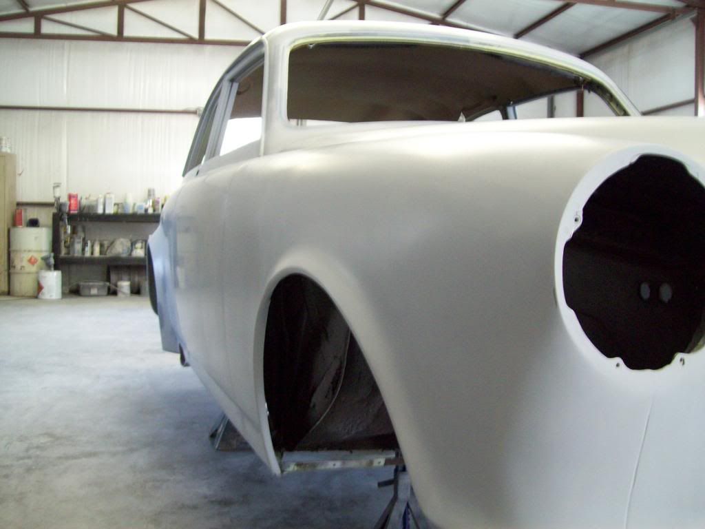

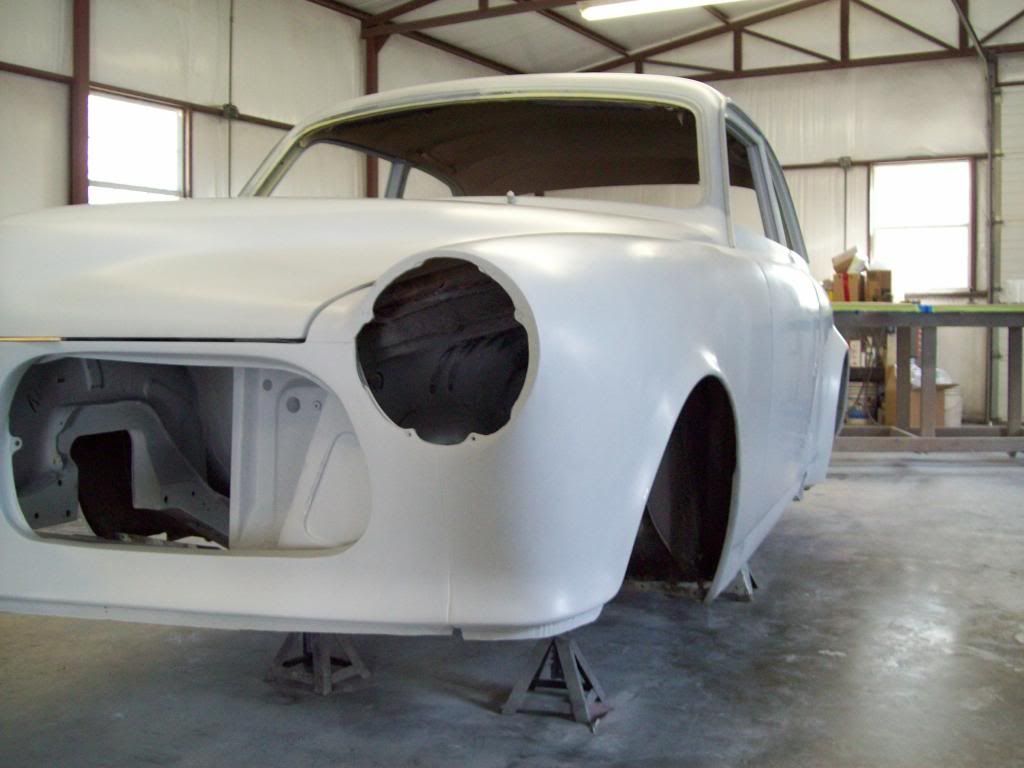

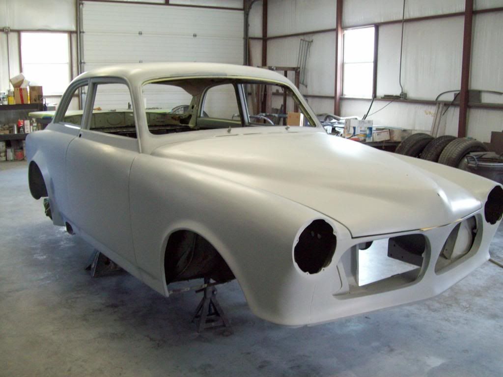

        • Here are some Volvo X updates, and it looks like the car is finally getting some color on it next week.. It has been blocked sanded about 10 times already, and the results really look great, although it is really hard to show it in these pics. We have settled on the paint application process, and we will be painting the assembled exterior of the car first, and then exploding the car back to pieces again, so we can then achieve completely overspray free jambs and engine bay.

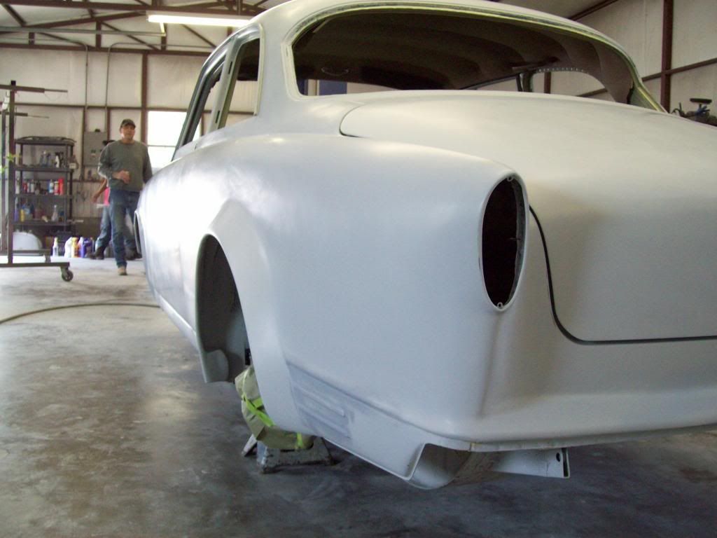

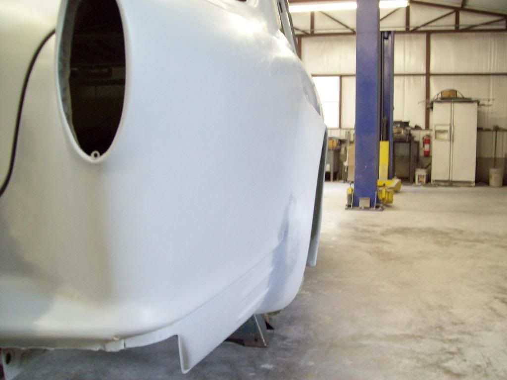

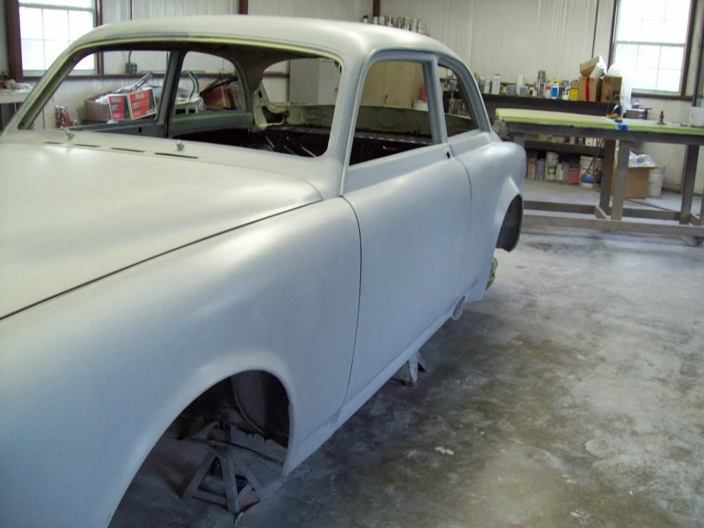

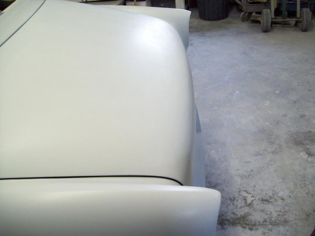

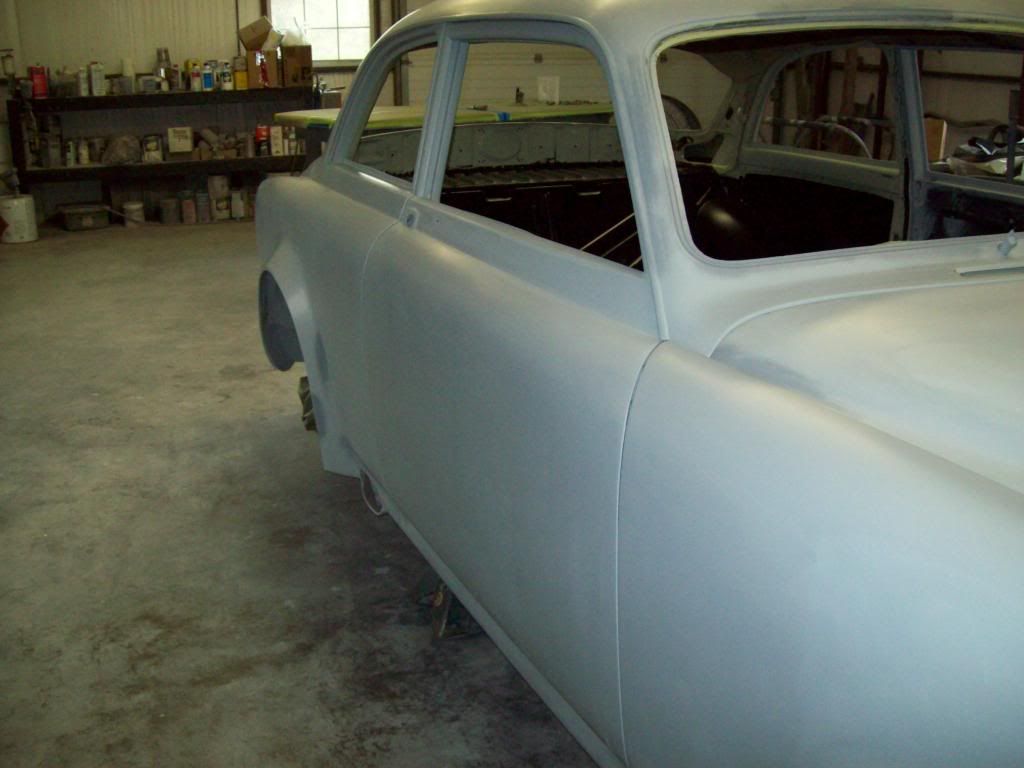

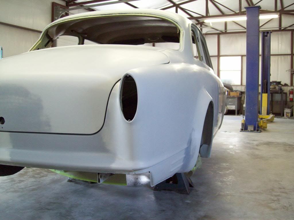

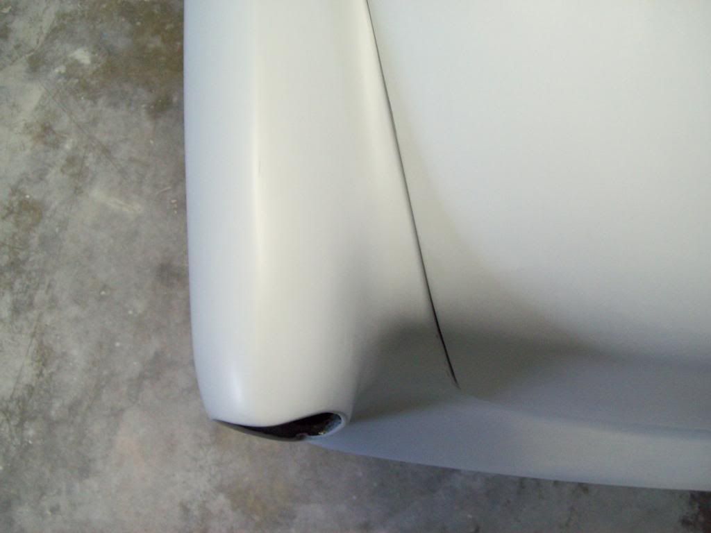

            • Well I was hoping to get some color on the car today, but it doesnt look like the weather is going to work with us, because we have some major storms and winds over the next two days.. Here in rural Southern Oklahoma, we have to take this into consideration, because there would be nothing worse than the power going out (Which happens alot during our storms) in the middle of spraying, so we will have to wait till Friday morning to start the paint process..
              As of right now, we have the car basically bolted together so we can get the exterior painted, and as I had explained earlier, we will take the car back apart after the exterior is paint, so we can then paint under the hood and jamb the car out. I just thought I would post a few pictures of how some of the body looks all together before paint, along with how the body mods came out in the primer stages also, so we can really see the difference after paint..

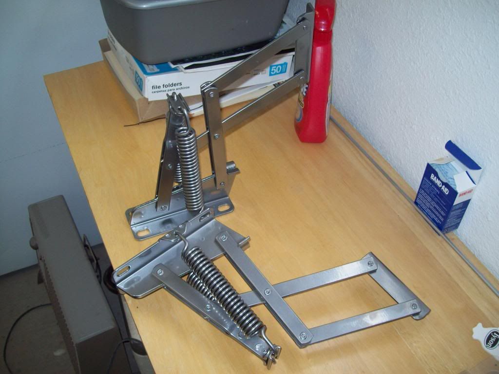

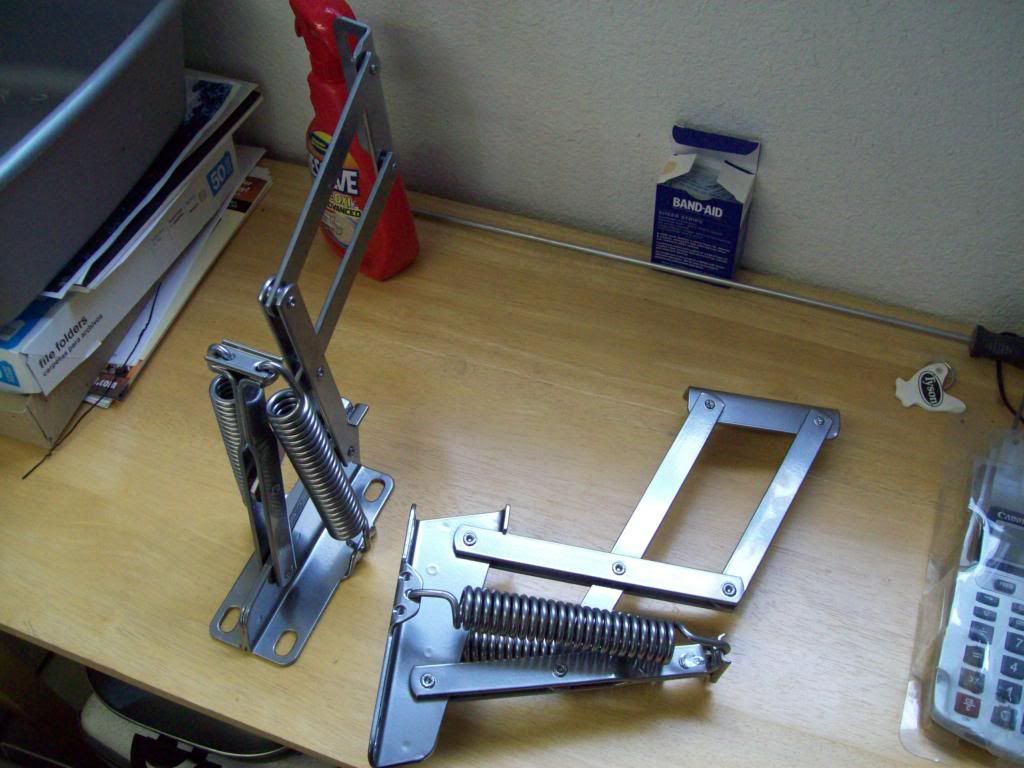

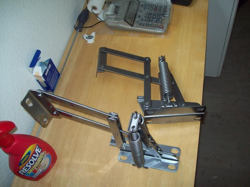

              • Here are some pics of the hood hinges after my powder coating, and I think they came out quite nice, and will be a pretty close to body color.. I figure I would try powder coating one set of hinges to a fairly close color, because I wanted them to be durable, and hopefully they would look good enough to keep.. I will have another set painted body color, but painted hinges dont look too good for very long, so I figured this was worth a shot..
                If they look good, I will also be powder coating the hood latch, door checks, door latches, ect, ect..
