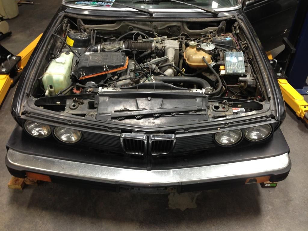

The engine bay way gross too.

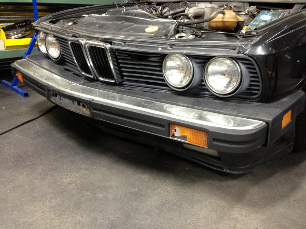

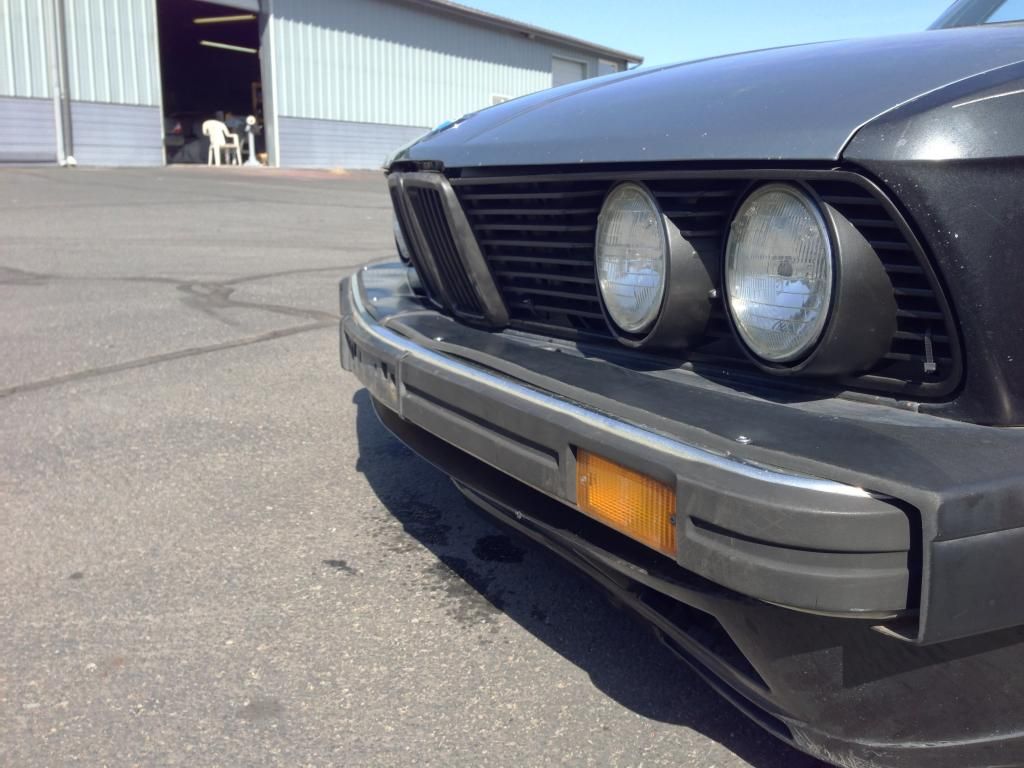

My grilles were broken as well as the kidneys and indicator lights on the bumper

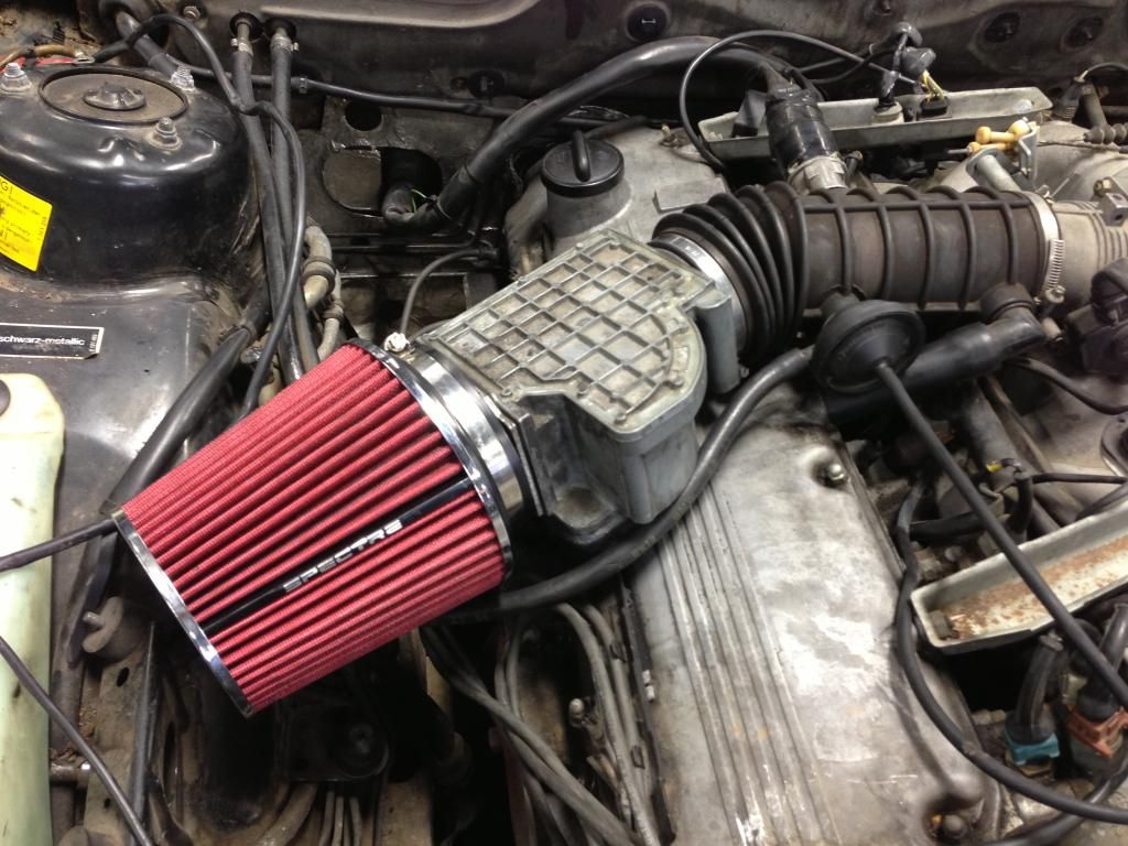

So I put on a spectre air filter to suck in nice warm air for the time being until I could find another quality stock airbox.

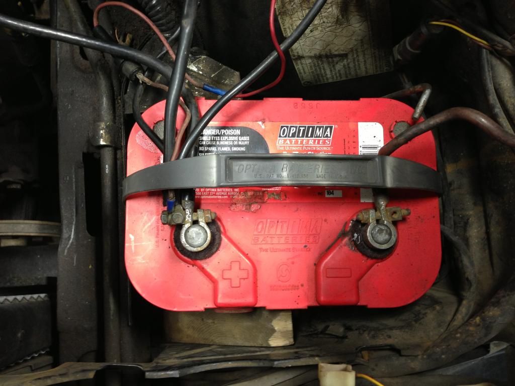

Got a nice optima battery too for real cheap.

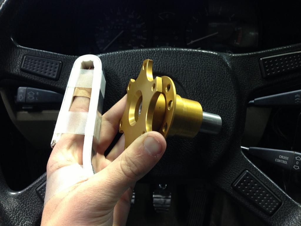

Also found this quick release leftover form my racekor. This will be installed soon.

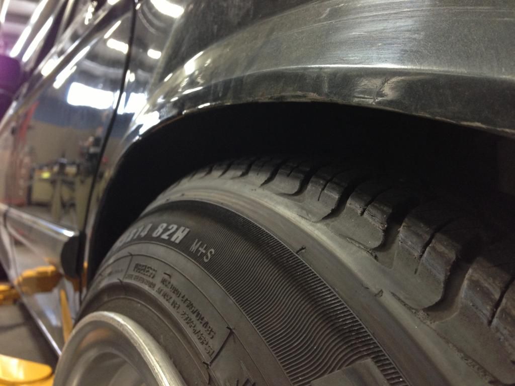

I couldn't drive anywhere because I was rubbing too bad so I had Sean at the FitGarage come over and roll me fenders.
Better.

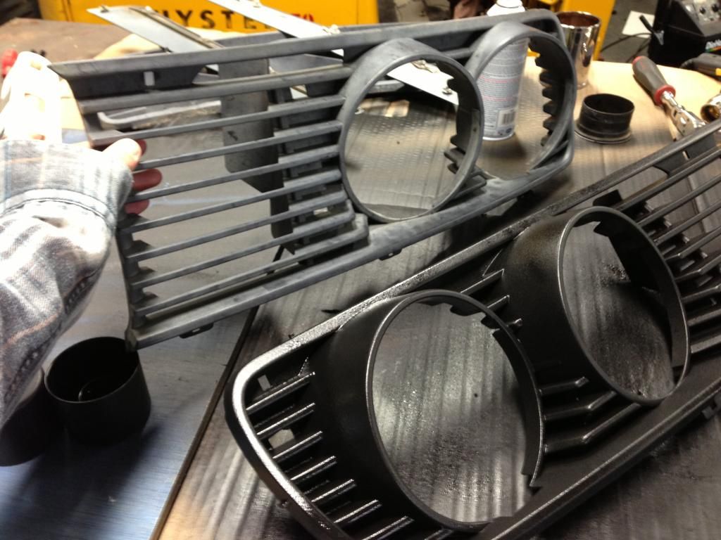

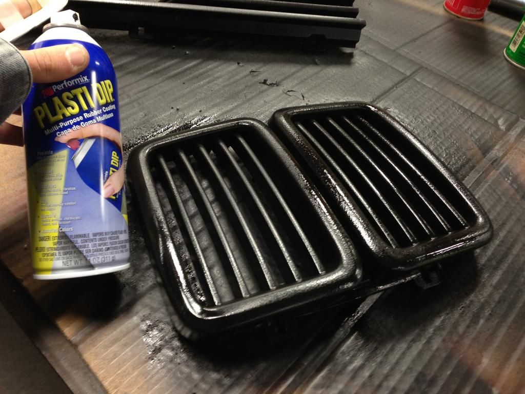

My fren Wyatt got a parts car and gave me the nice grilles off it and also a new hood that doesn't have a big wiener keyed into it

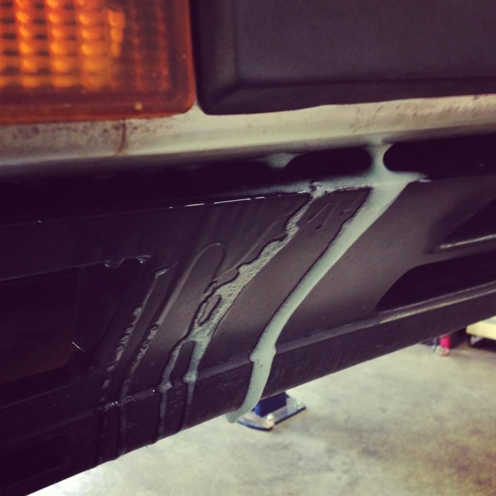

SO I plasti-dipped the grilles and kidneys

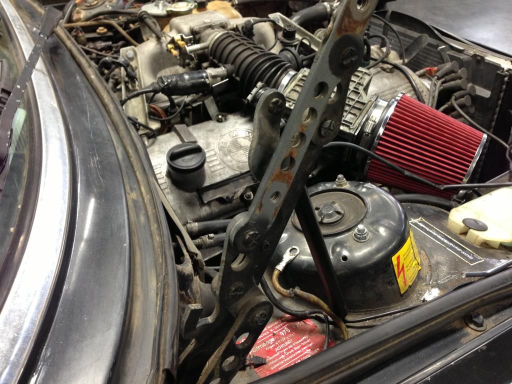

Went to go install the new hood but then this happened
JAWS

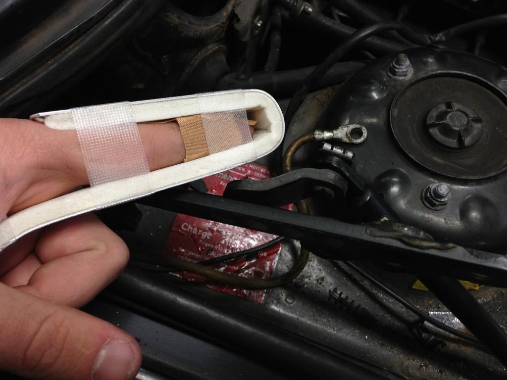

I went to pull up the hood mount not really thinking and it snapped up because there was no load and pinched my index finger between the 4th hole down and that little tab. Luckily I had a friend there who was able to cut the hood strut with a sawzall and free my mangled finger.
My finger was stuck between the bar and that little tab. Looked completely like a pancake when it was stuck and I could feel the metal pushing against the bone. Gnarly.
I definitely thought it was broken so I let him drive my R to the hospital.
It wasn't broken it was just super bruised and damaged my nerves, because of the nerve damage though I didn't feel a thing when they were cleaning the wounds.

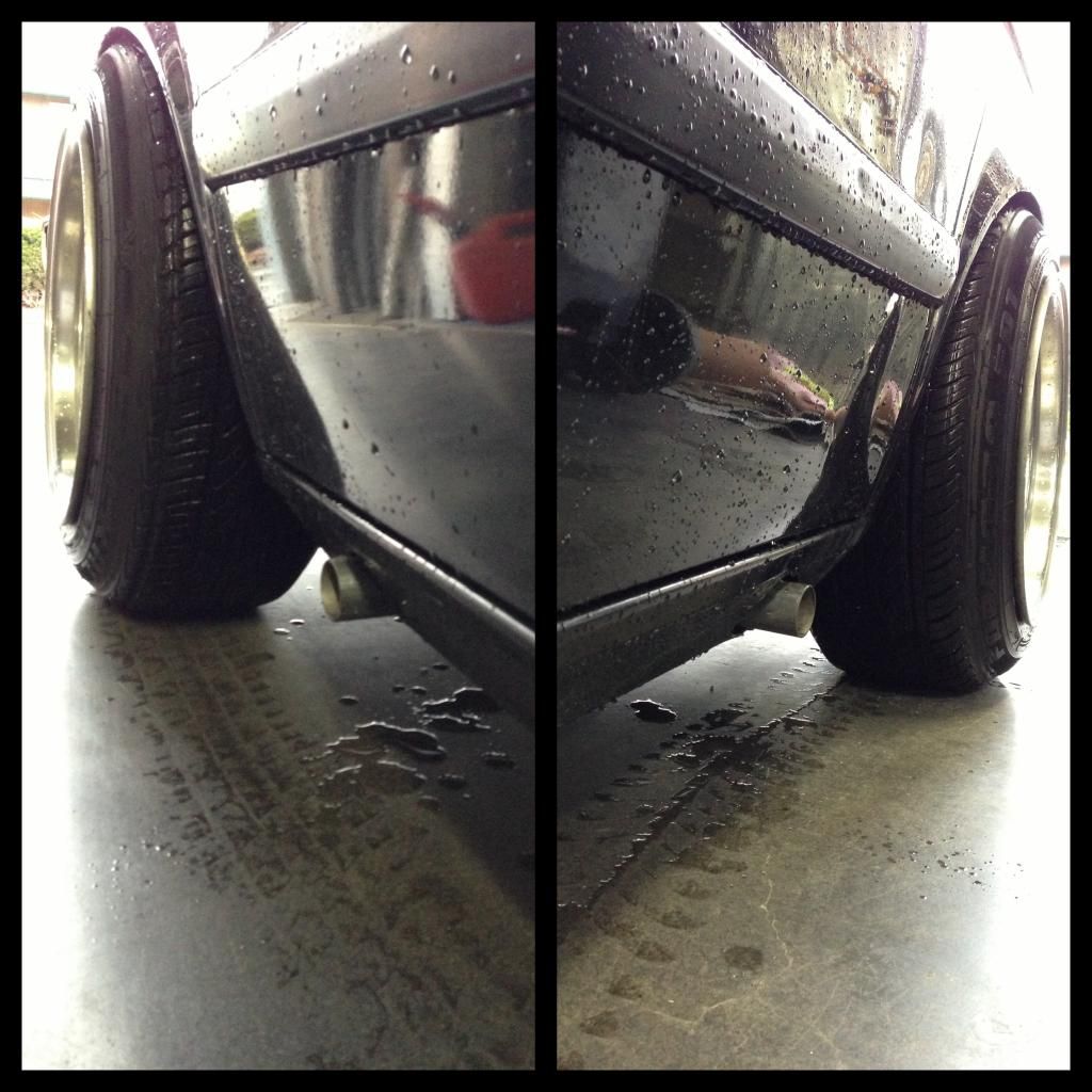

Gross idiot welds held my exhaust together and they finally gave out.
So I started thinking...

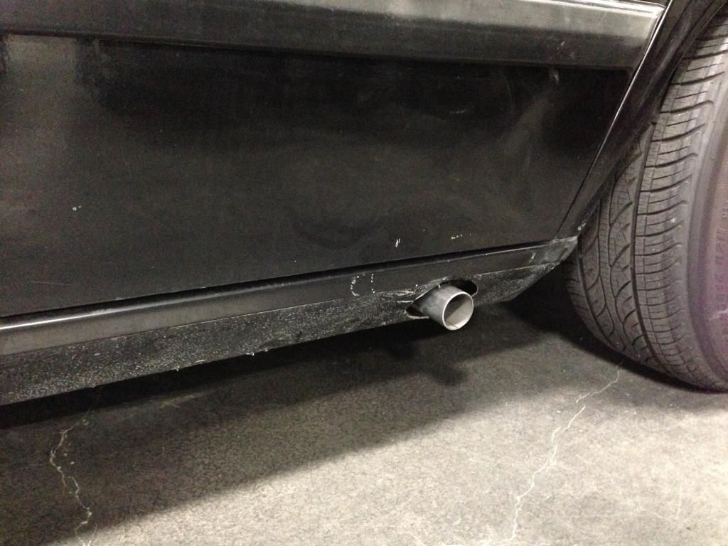

With a snap crackle and pop I had dual side exits that were straight from the headers back.
It's the loudest thing.
Pipes are too cute though so I'm planning on making some racecar style tips or housings or something so it looks a little bit more testosteroney.

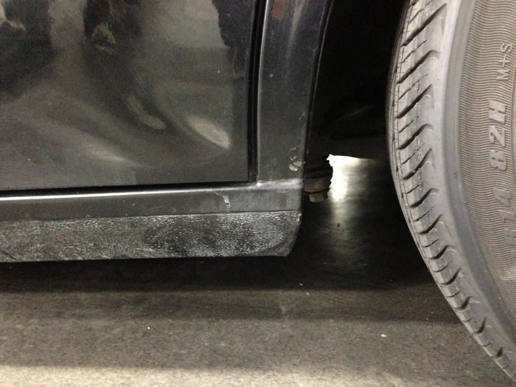

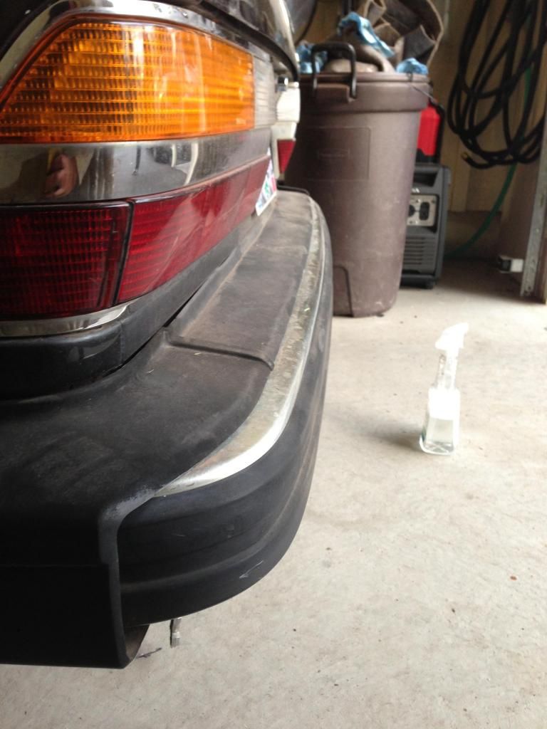

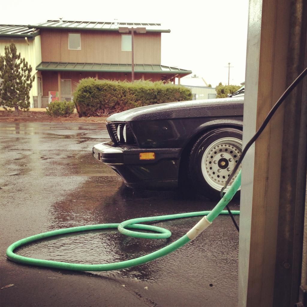

Gave the car a bath then realized that I needed to do a tuckjob. Maybe a little rub'n'tuck.
Did the tuckjob

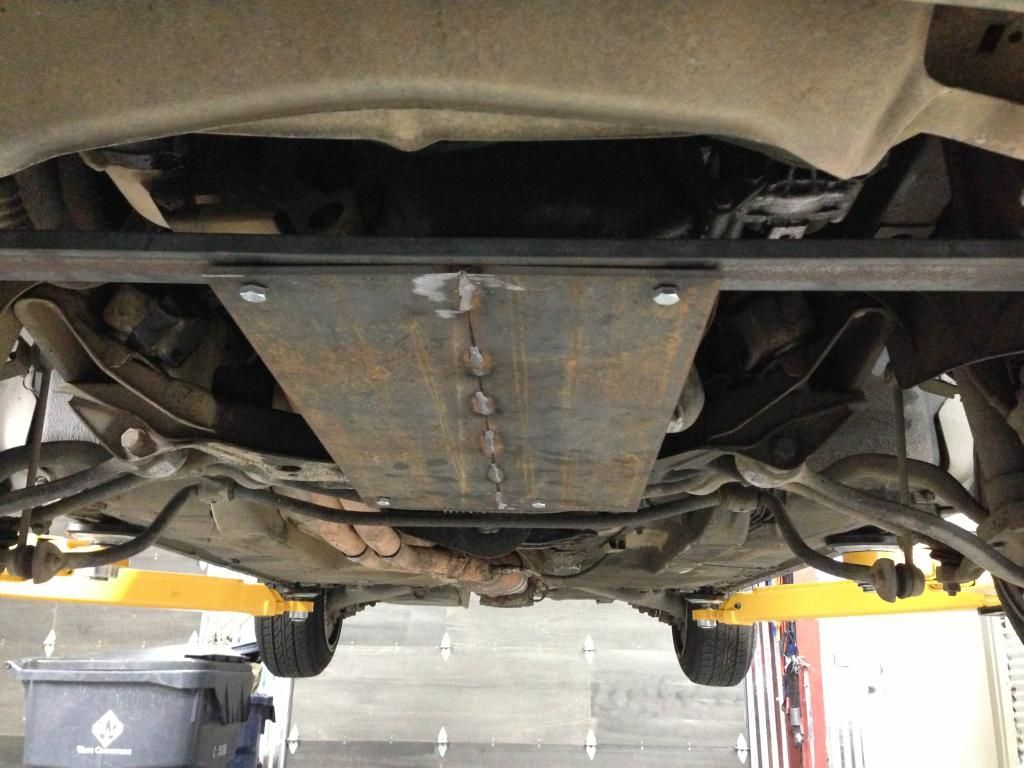

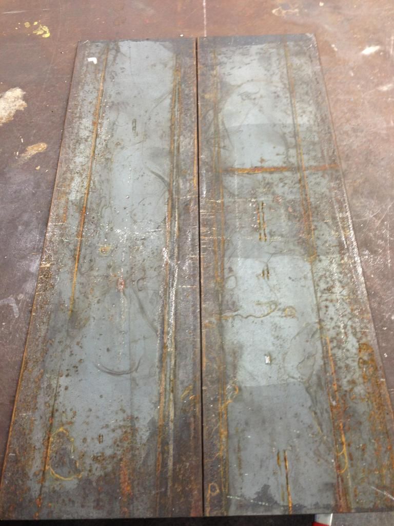

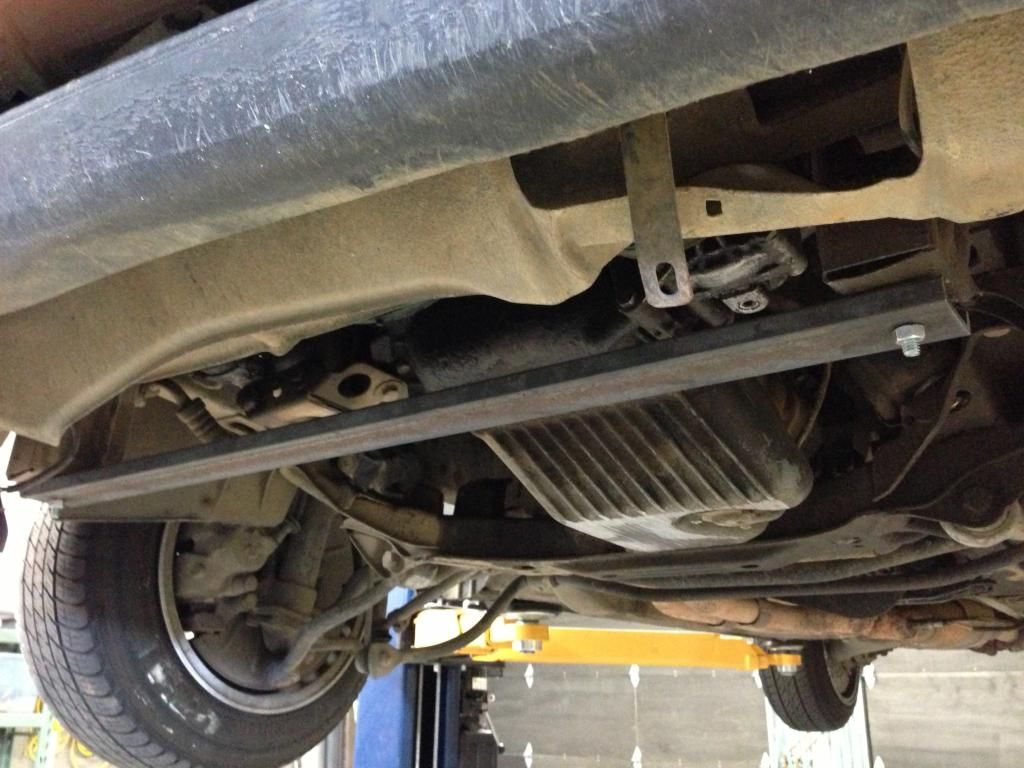

The car was far too low to drive around central oregon comfortably with our mongo ruts in the road so I built myself a skitplate.

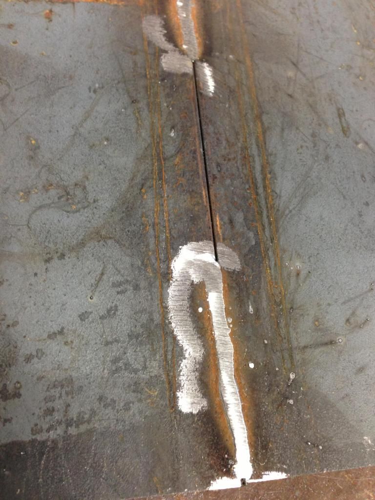

Runt welds needed grinding
Skitplate MK1 all mounted up
1/4" thick steel should do the trick protecting me from all the evil in the world.
Eventually the bolt heads just ground clean off so I made the seat in the skidplate conical and recessed the new bolts inside of it so they wouldn't get ground clean off.
Tires were low too so that's why I'm only a half inch off of the ground. Normally I'm about an inch off the ground.

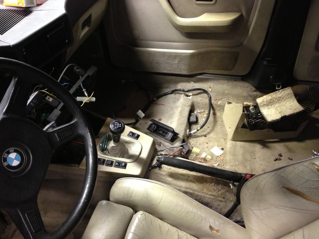

Drive around for a while without a passenger seat because the hinges and every single motor were broken so I chucked it and decided to just run seatless.
After a while that got old so my pal willis said he had a parts car with a comfort passedger seat with motors that worked(!)
I took it

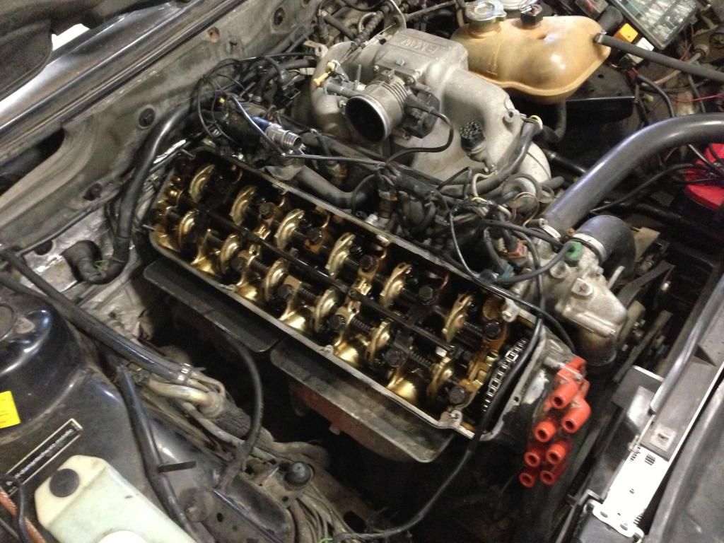

I rode in my friend wyatt's car and his was way faster than mine and also had more valve noise so I decided something was wrong with my car. My valves are too quiet and I have no low-end power and lots of stuttering after checking all the vaccum lines and various sensors and determining that thay were good.

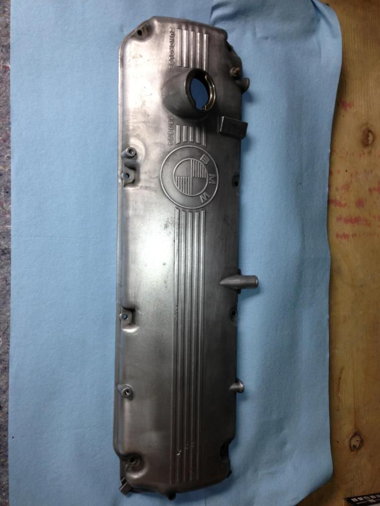

SO valvejob.

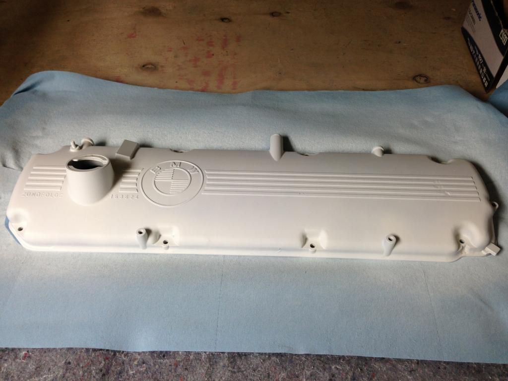

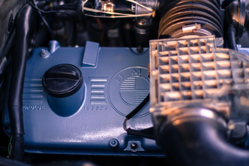

And to be a trendy e28 owner and paint my valve cover:

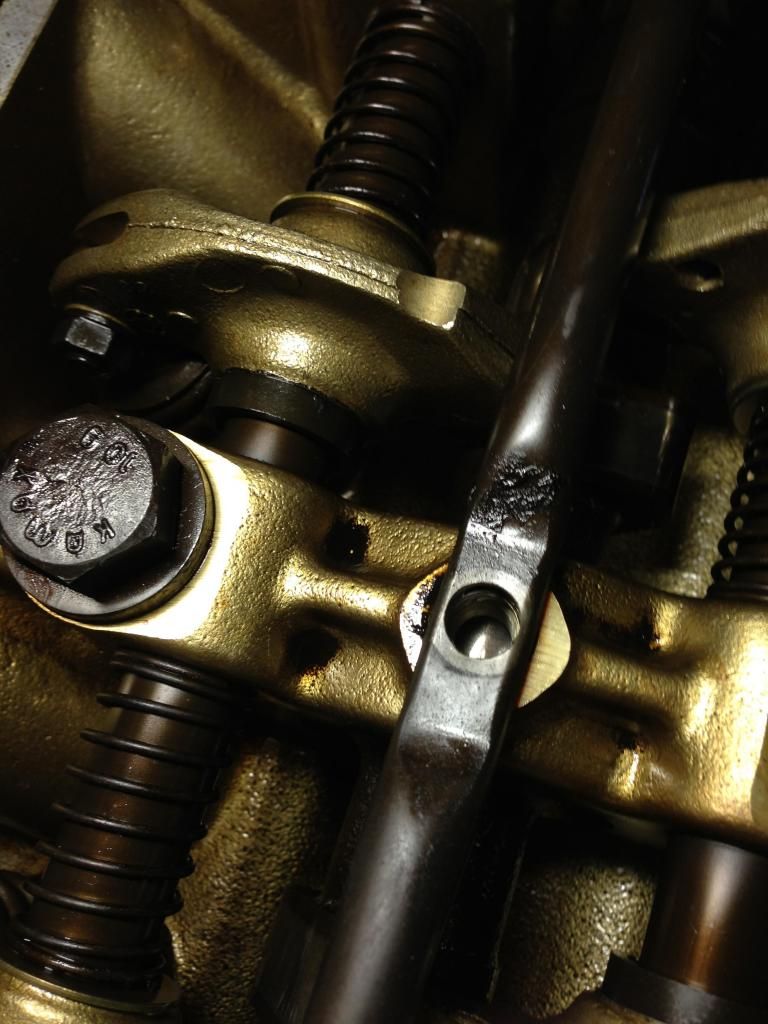

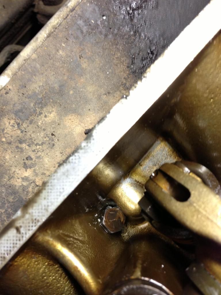

It was a good thing I did the valvejob because I found this.
Missing banjo bolt!
Found it here
It was lodged in the oil return hole and I was not too happy. I managed to free it and replaced it with a new one and loctite'd it so that it wouldn't happen again.

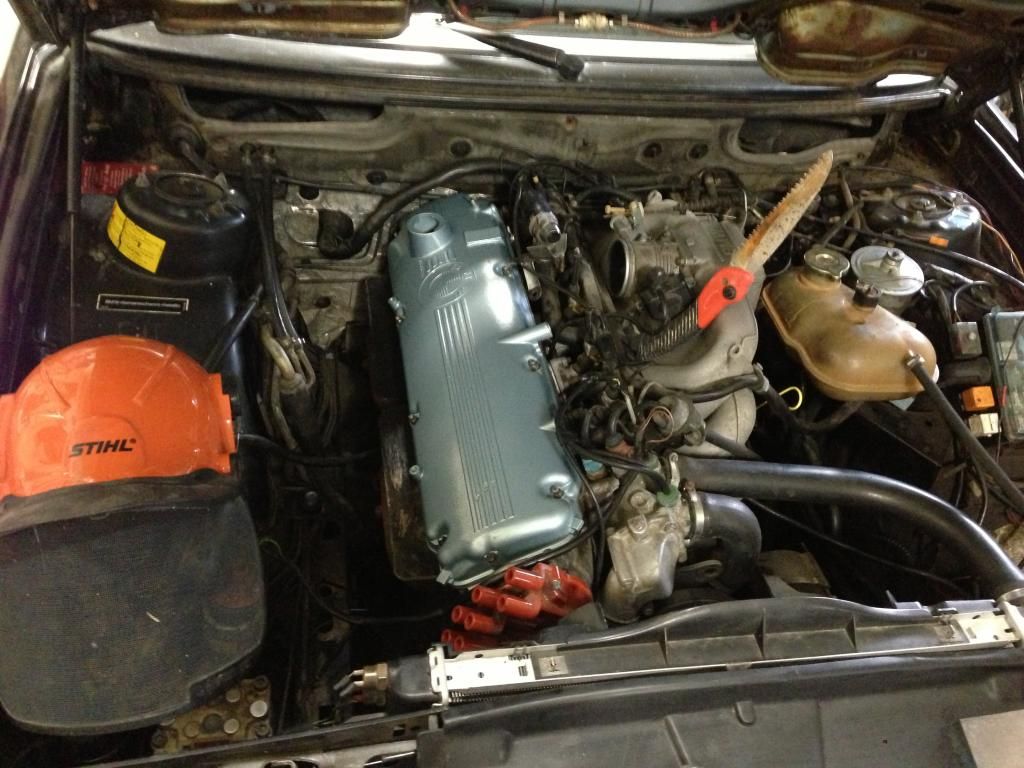

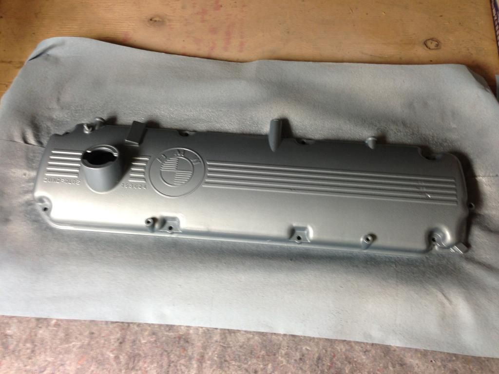

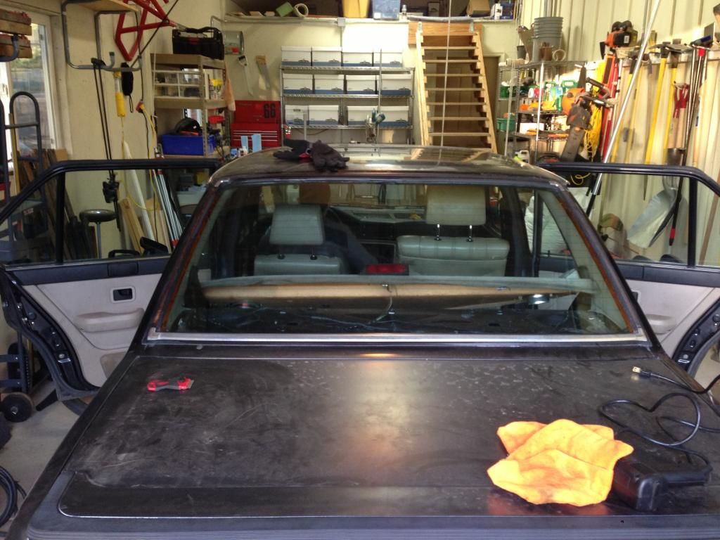

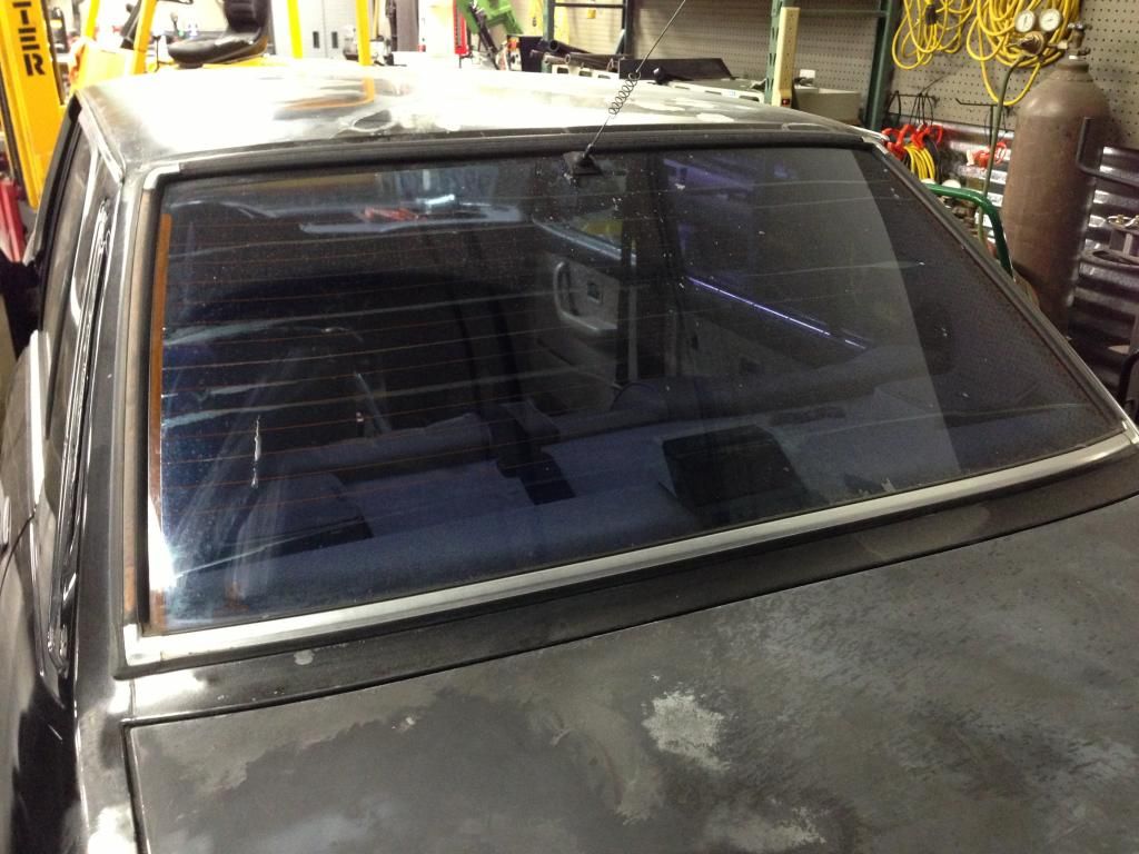

I sanded and primed the valvecover while my friends took off my tint
after 89039409208534056893548349573489057348573 hours we got the tint off
and I painted my valve cover the same color as my hood
only STIHL tools allowed don't settle for less.
I re-assembled everything and forgot to take photos and then started the car up.
Everything is so smooth now, more low-end power and no terrible stuttering under acceleration. All the valves were way too tight, there's more noise now but more POWARRRR.
Better.

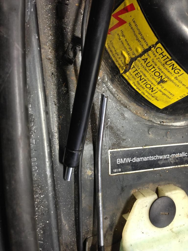

'JAWS
