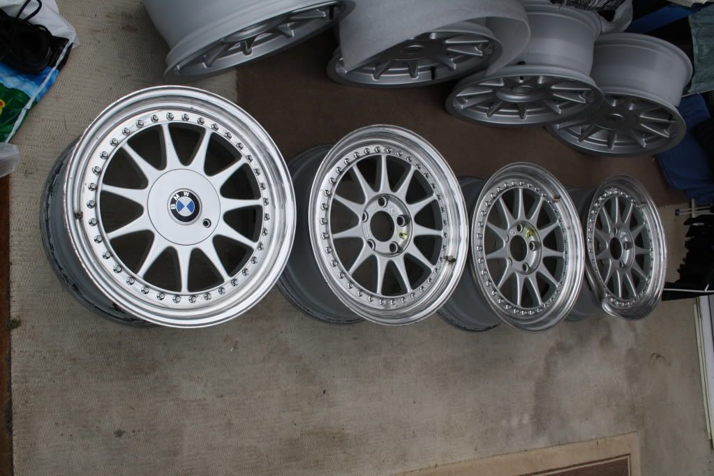

Todays action, picked up the Hartges, tyres on and now it's started to p1ss down :roll: .
All I need now is to go fill her up, give her a quick wash, and away in the morning to the German car show.
Excuse the 4x4 ride height, but tha'll be sorted out next week.
