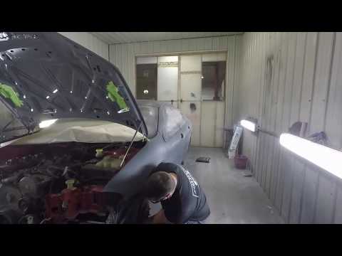

          • Hey, it worked!! Check out the latest in video format, still working on this thing. Next step is rebuild the transmission and finish building the intake plenum, I think that will be this next week. just a little bit more wiring to complete as well
