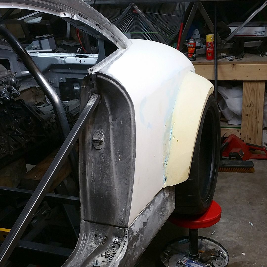

I also widened the flare more. I wanted to increase the track width to 66" with a 315, so this will allow that to happen.
A comparison shot of the original widened arch and quarter, to the extra wide arch and widened quarter.
These are now 6.25" wider, per side, than the factory TT's quarter panels.
