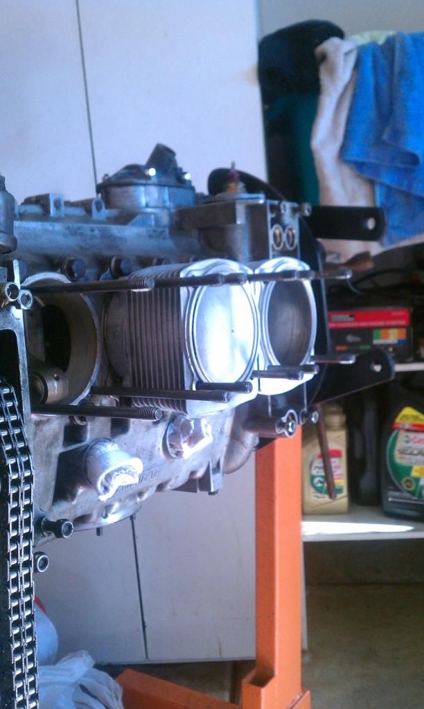

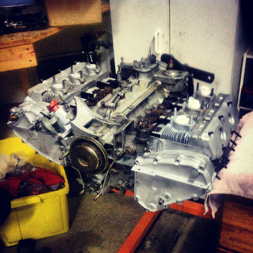

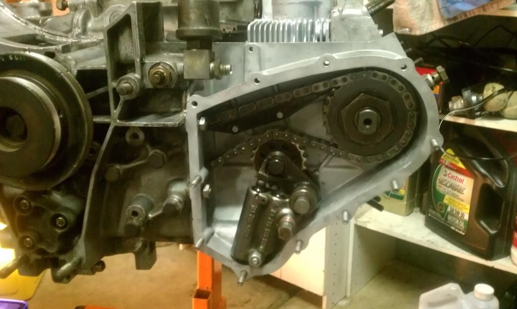

              I’ve gotten 17+ hours in this weekend on da Porsche. I'm too excited
              In my free time, I like to enrich America's youth by teaching them how to paint dinosaurs
              I wish I would have taken some pictures of how you do the timing, but my phone was dead. But you physically rotate the camshaft and rocker and put a pin through this little hole between the camshaft and timing chain I guess “sprocket”
              Get to to TDC on firing stroke of cylinder 1
              Set the clearance on #1 to 0.005 inches and attach this little micrometer to the top of the valve
              Turn the engine over and see the the cam turns the rocker again at tdc without the thousandths of an inch in change.
              The put a pin through this seemingly infinite combination of timing values and tighten it to something lik 150m foot pounds.
              Then repeat for #4
              Gotta clean up the intake manifold system. Lots of shit in there. Waiting on the alternator in the mail, and tha's all for now

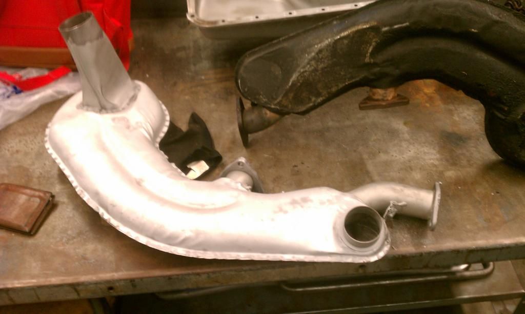

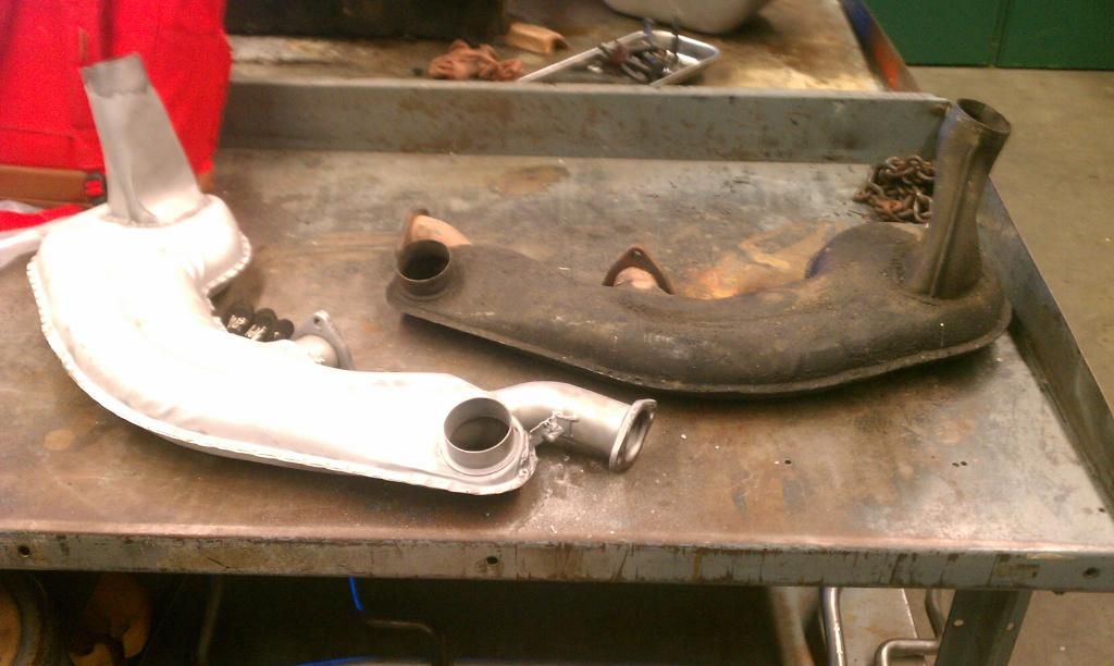

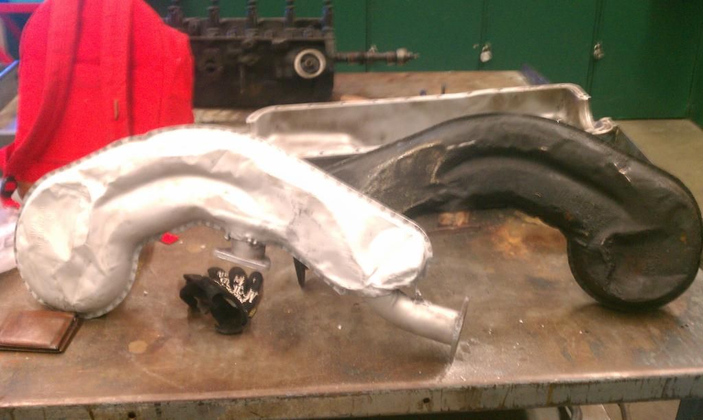

              • #82
                Couple of hours after school, got these all cleaned up
                They were all caked up on the inside

                    Anyways, since the problem before was smoke, I wanted to get the oil chunks off of the heater box, because when I get the car running, they would cause it to smoke and give me a false sense of failure, so I got these cleaned up and need to hit some of the metal with high heat paint later.
                    They're both done, I just forgot to snap a pic.
