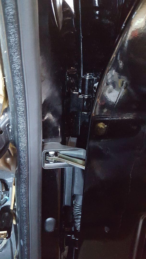

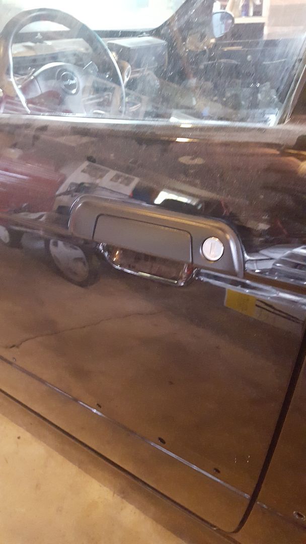

My passenger side door handle was hanging up on its frame like my drivers side so I removed it and remedied that.

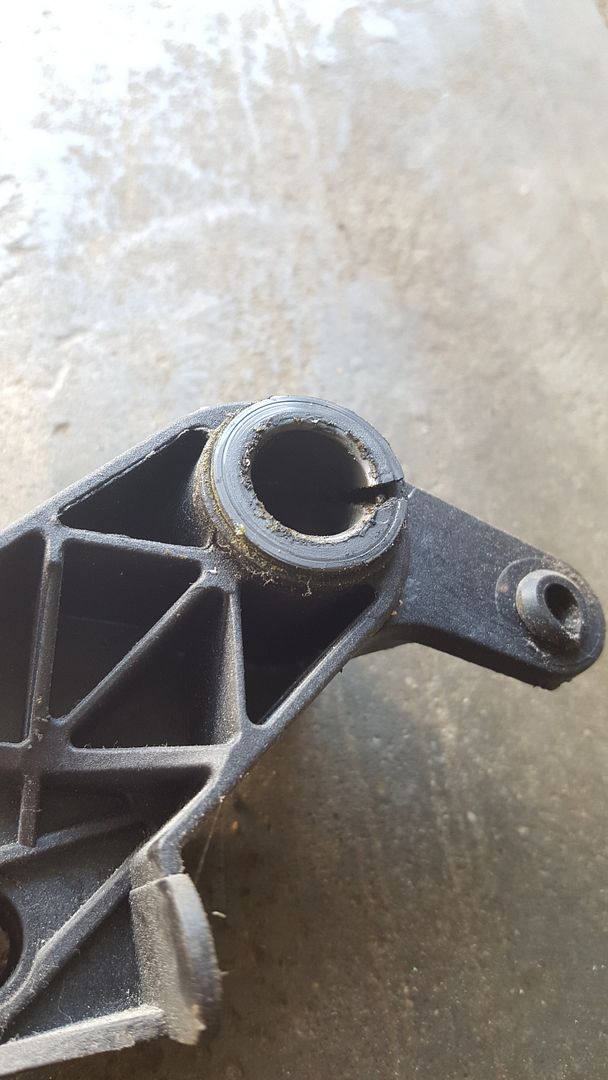

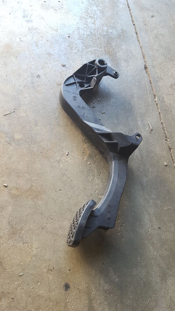

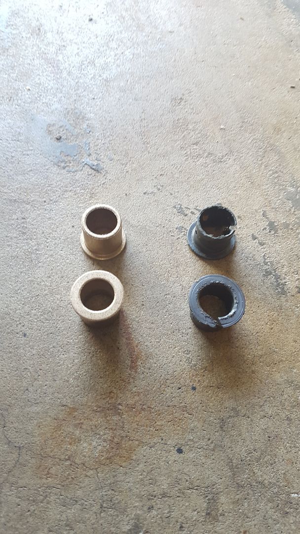

I also removed my brake pedal and added the oilite bronze bushings
The modified brake pedal went in after that as well.

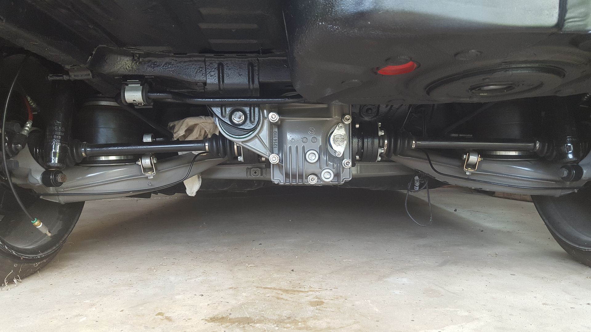

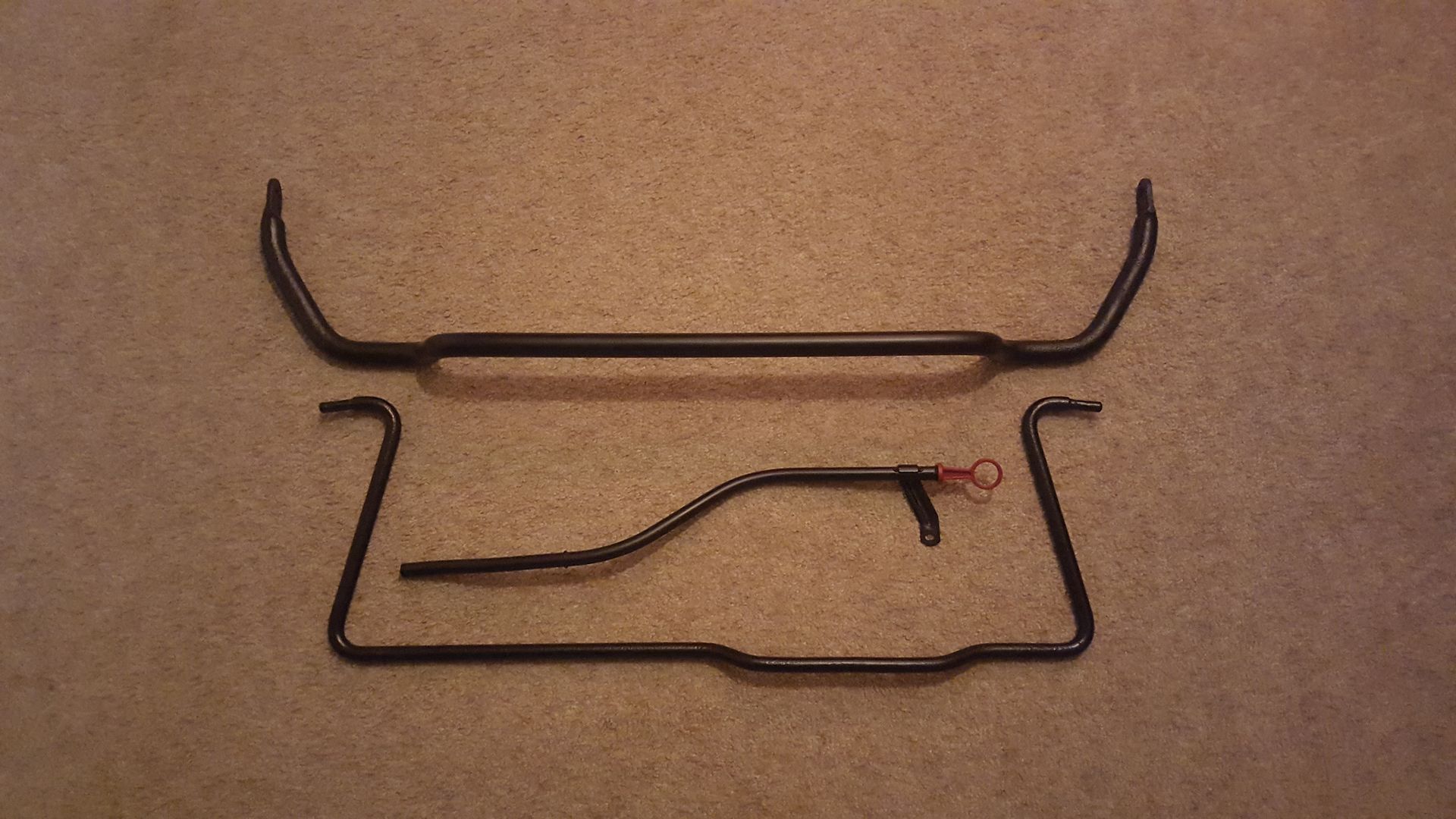

Installed the rear sway bar. I just aired the car up and installed it. I got my excercise for the day trying to get the brackets situated to bolt them on=P

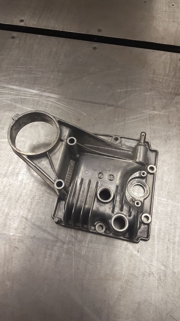

I ended up finding a diff cover without any broken fins and installed that yesterday. I painted it and installed new drain plugs while I was at it. I also got an Ireland Engineering rear diff mount instead of using the Silver Project one in my old cover.
I need to get new washers, a speed sensor bracket, and a diff mount bolt because they ended up getting corroded when I prepped my diff with the KBS BLAST for the KBS Rust Seal.
You can also see the passenger trailing arm paint was damaged when I installed the subframe. I sanded that down and primed it yesterday. I will be painting it again today.

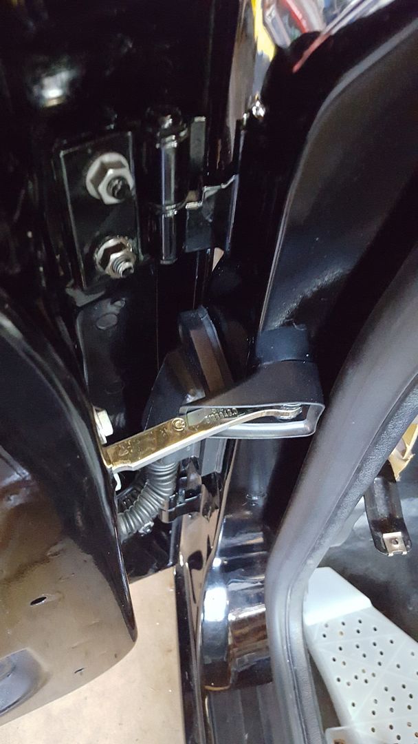

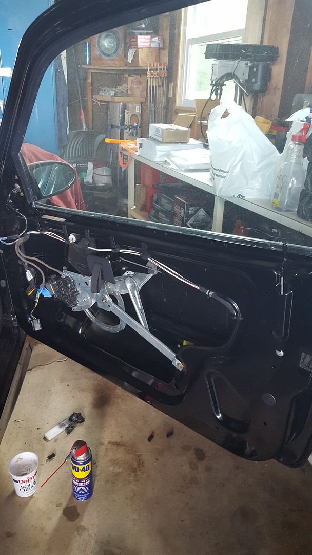

I properly connected the door brakes and installed new boots/covers now too.

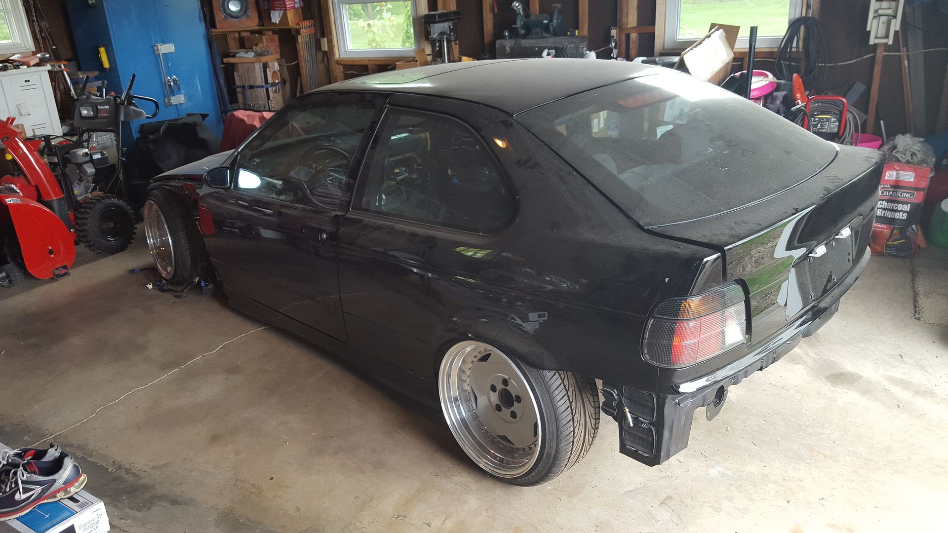

Nothing new. Finally getting back to work on it after fixing up a coupe I bought to replace my e34. That got backed into and totalled a few months ago. The coupe needed a full front suspension refresh and some other maintenance. I'll post some pics of that soon
