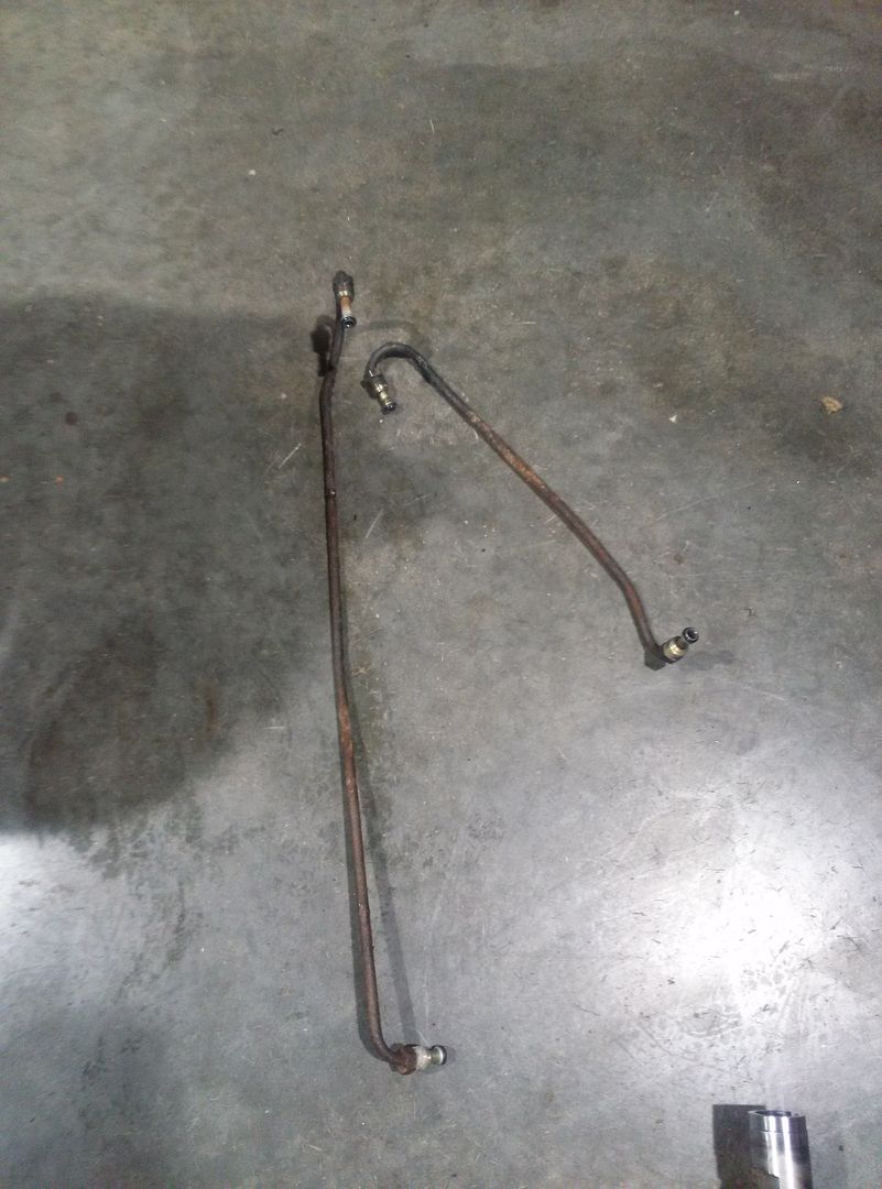

We removed the tie rods from my rack and cleaned it up a bit.
I found where it was leaking right away. One of the lines rotted through.
I removed them and will be capping them off since I deleted power steering.
