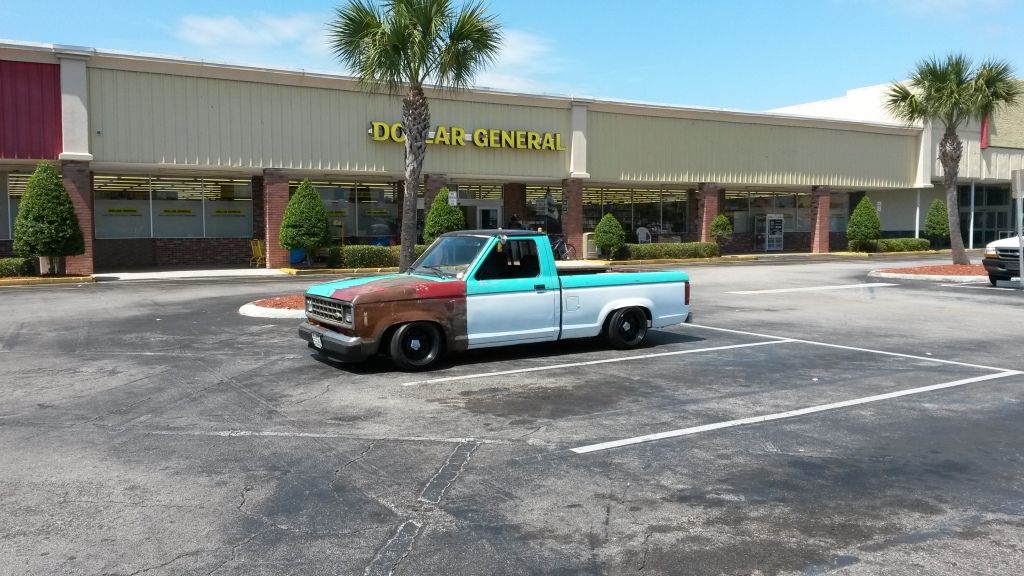

And went and took a couple pictures, but I'm only going to leave one.

Photobucket finally uploaded the rest of the pictures, here are the other pictures I took yesterday.
