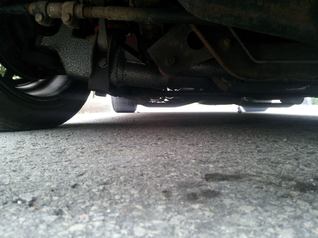

Here are pics of the raised radius arm xmember.. I did keep the bar in between for frame ridgidity.. It's not scraping anymore from there=) Total installation time was around 2 hours but I had trouble to align the bolts to the stock bolt holes.. It's not really that hard, but it needs aligment now. If I were you I'd keep the bar too if you plan anytime to slam more power under the hood.. My next step is tranny xmember.
Sorry you can't see much on the pic but I had around 1, 1.5 inch max of ground clearance, not a problem anymore as you can see.
