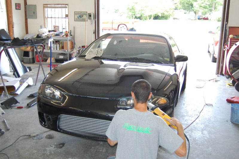

    Wetsanding on the hood began and I took off the front wheels to fit my screwdriver to take off the old endcap
    Hood has been buffed over with rubbing compound
    And now the bumper
