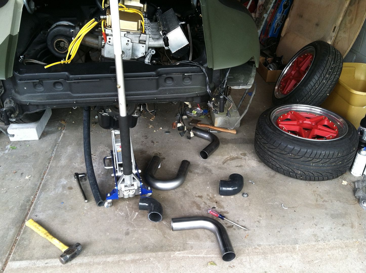

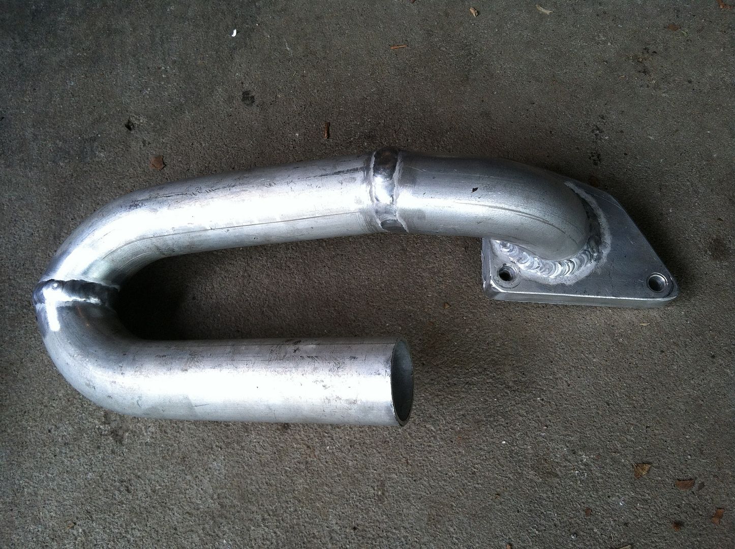

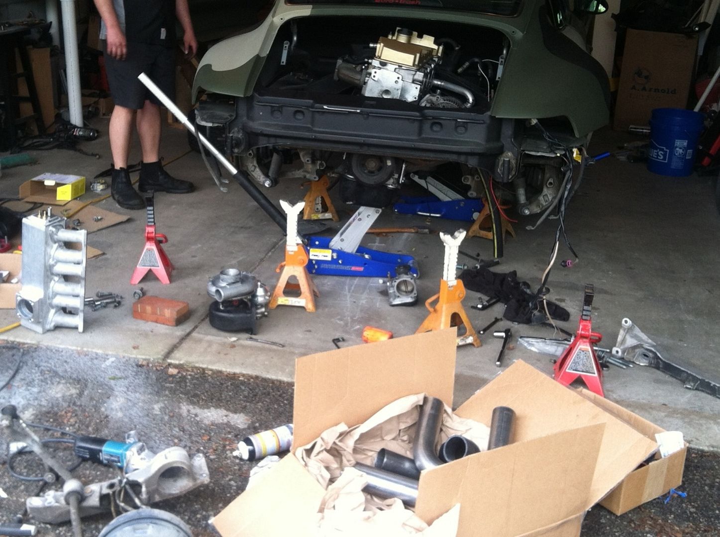

  • Hit some snags today. Motor is in and bolted up which is the good news. The bolts they sent me for shift linkage isn't the right one. The turbo housing hits the wastegate so i need to order a couple flanges and some tubing and move that out some. Next the alternator hits the throttle body when turned the way i need it. Easiest solution is to move the tb to the center of the intake instead of trying to drop the alternator down a bit. Hopefully tomorrow goes better.

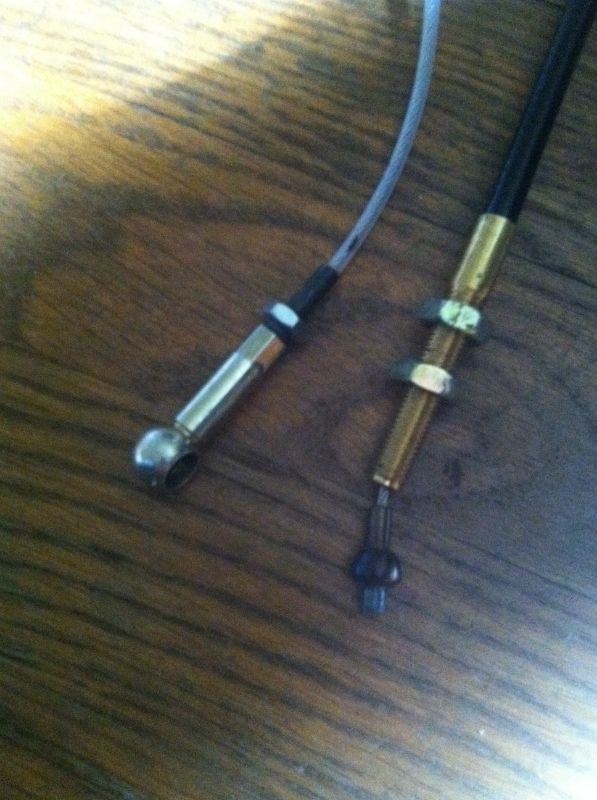

                  • My pride and joy. Porsche pedal to vr throttle body 1 piece cable.

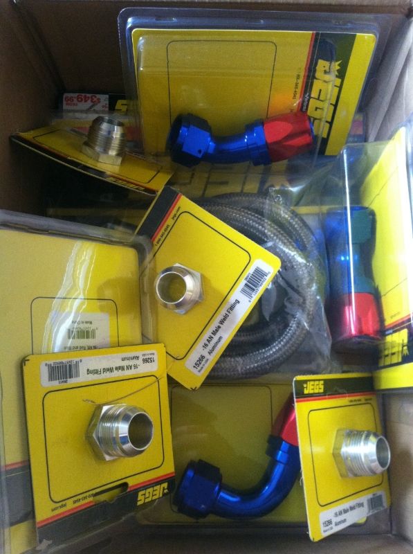

                    • Also changing up the coolant system to AN fittings and steel hose instead of that aluminum tubing.

                              Working on plumbing now

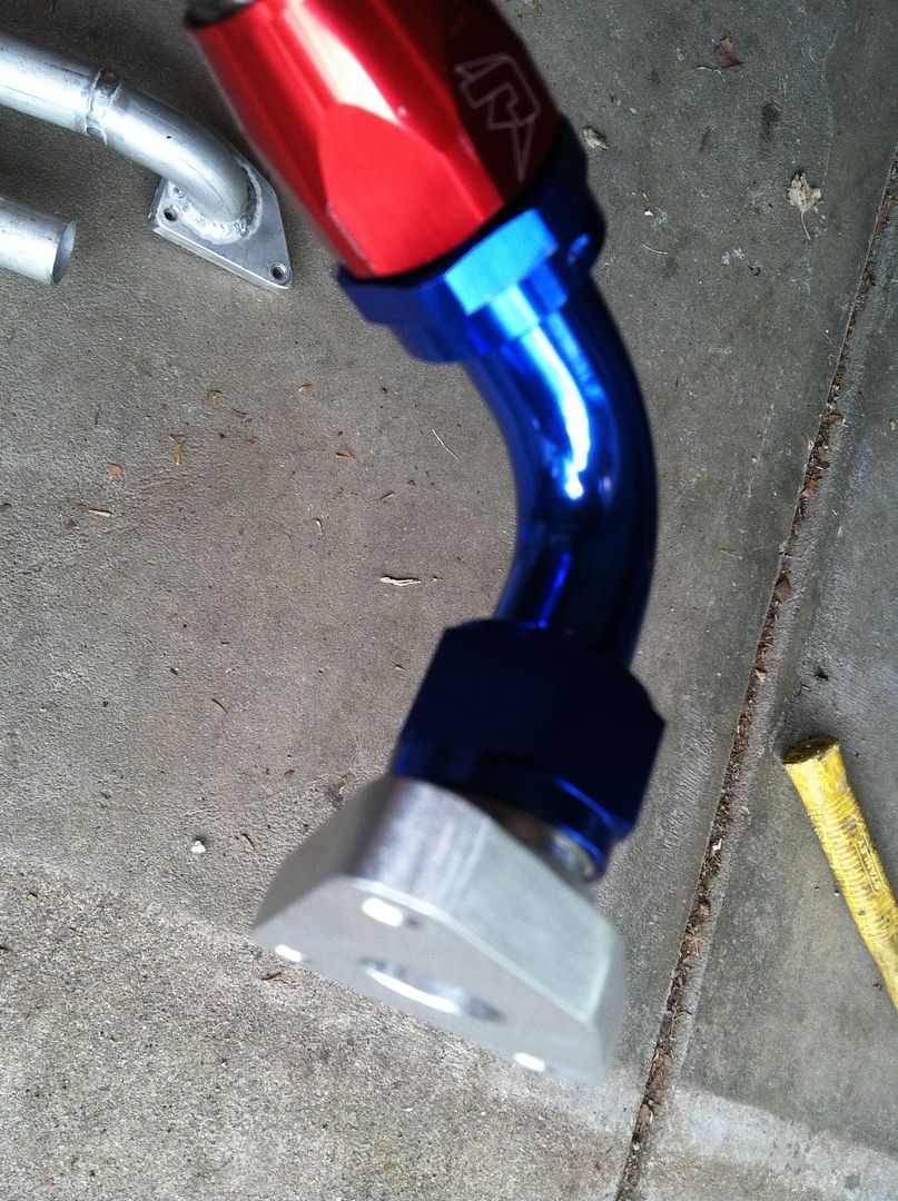

                              Replaced the goofy home brew coolant pipe with a 90 AN. Now i dont need to worry about that breaking.
                              Made some block off plates.
                              Starting putting door trim on.
