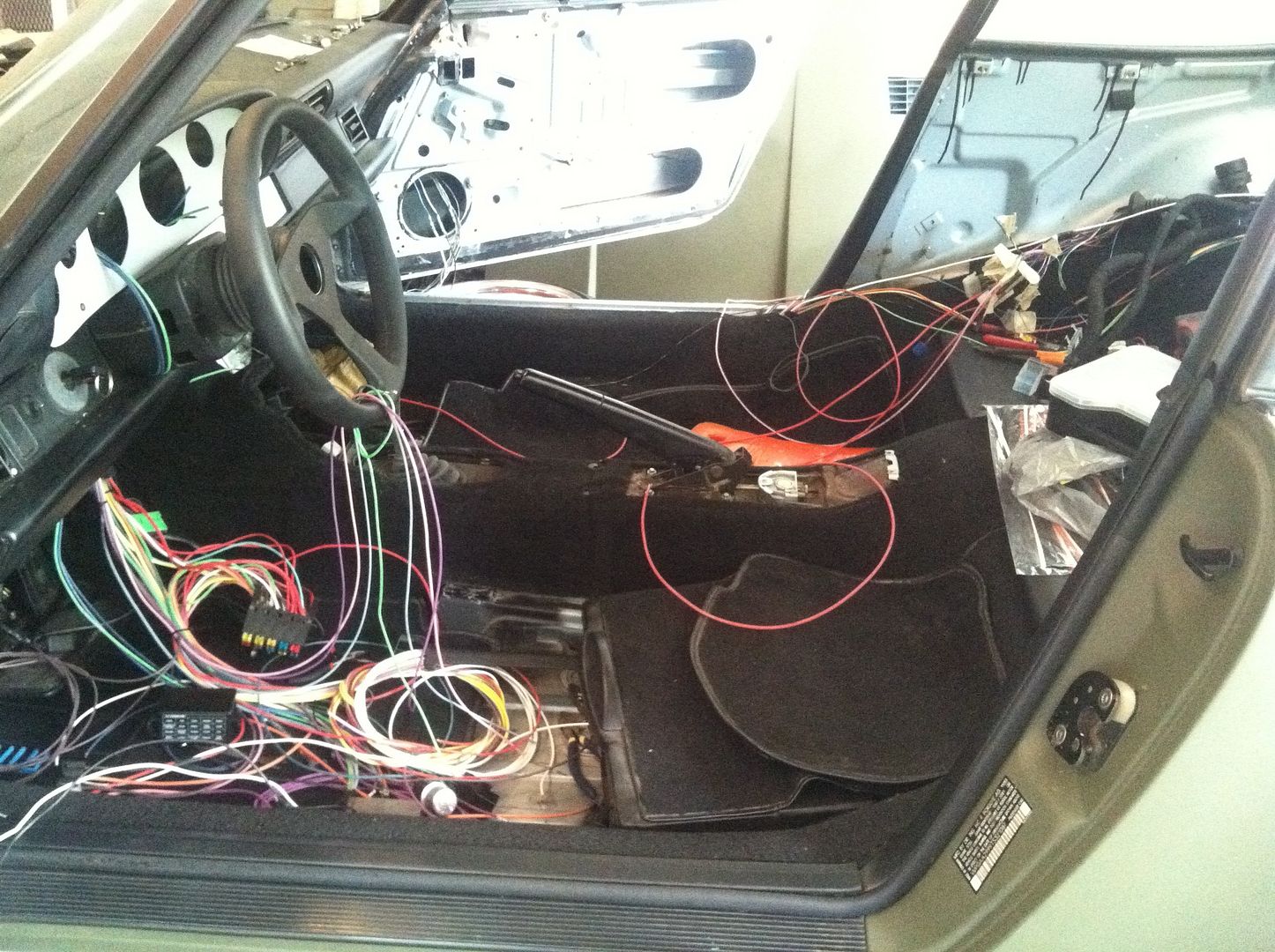

  • Still on that wiring game.

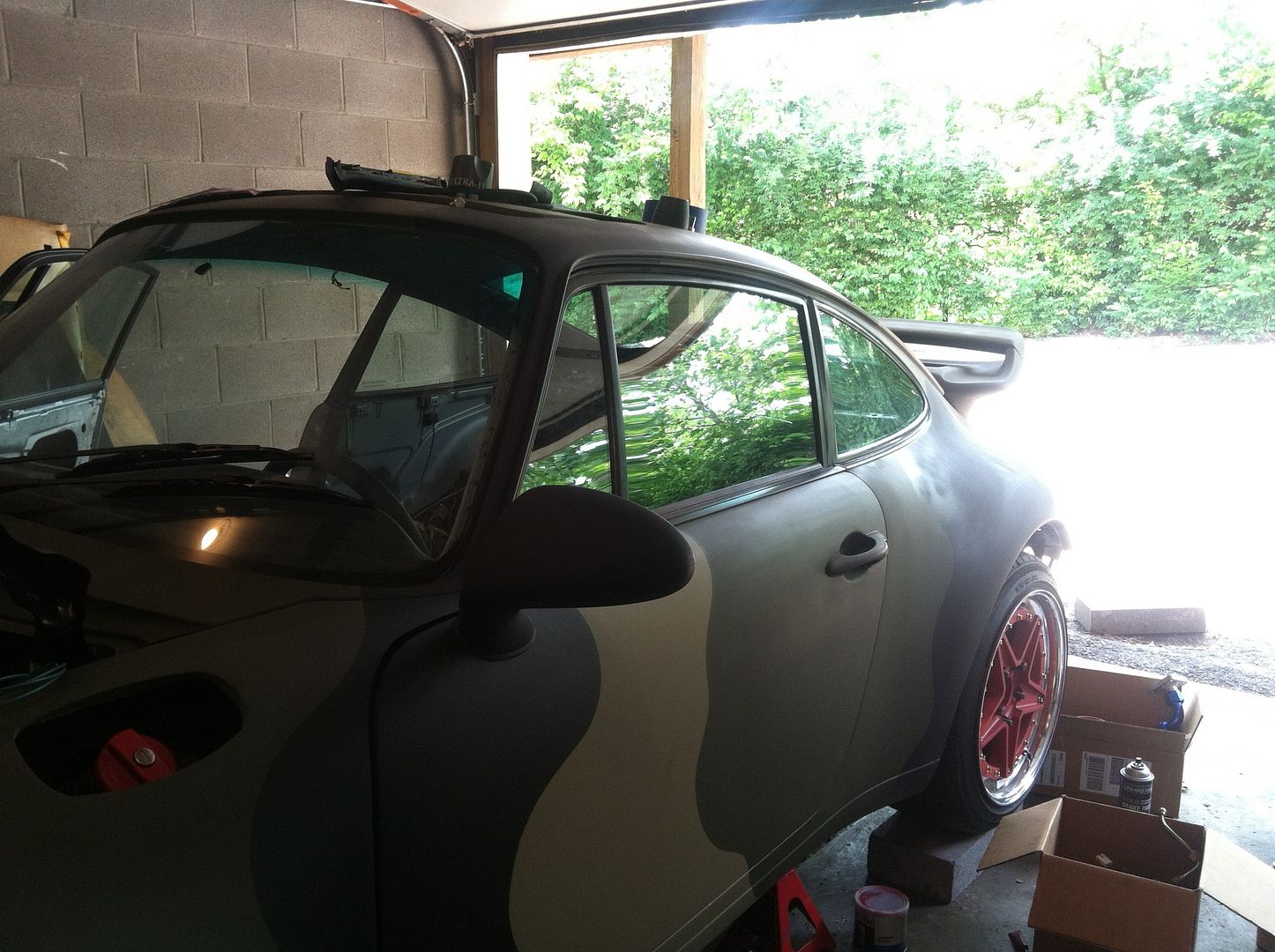

    Finally got the 10 little screws i needed to finish putting the rear glass in. Gonna try windshield tomorrow.

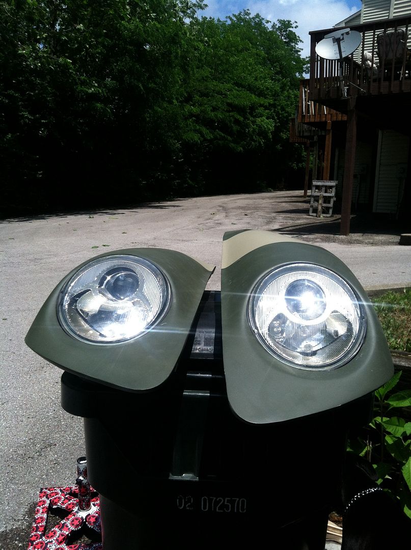

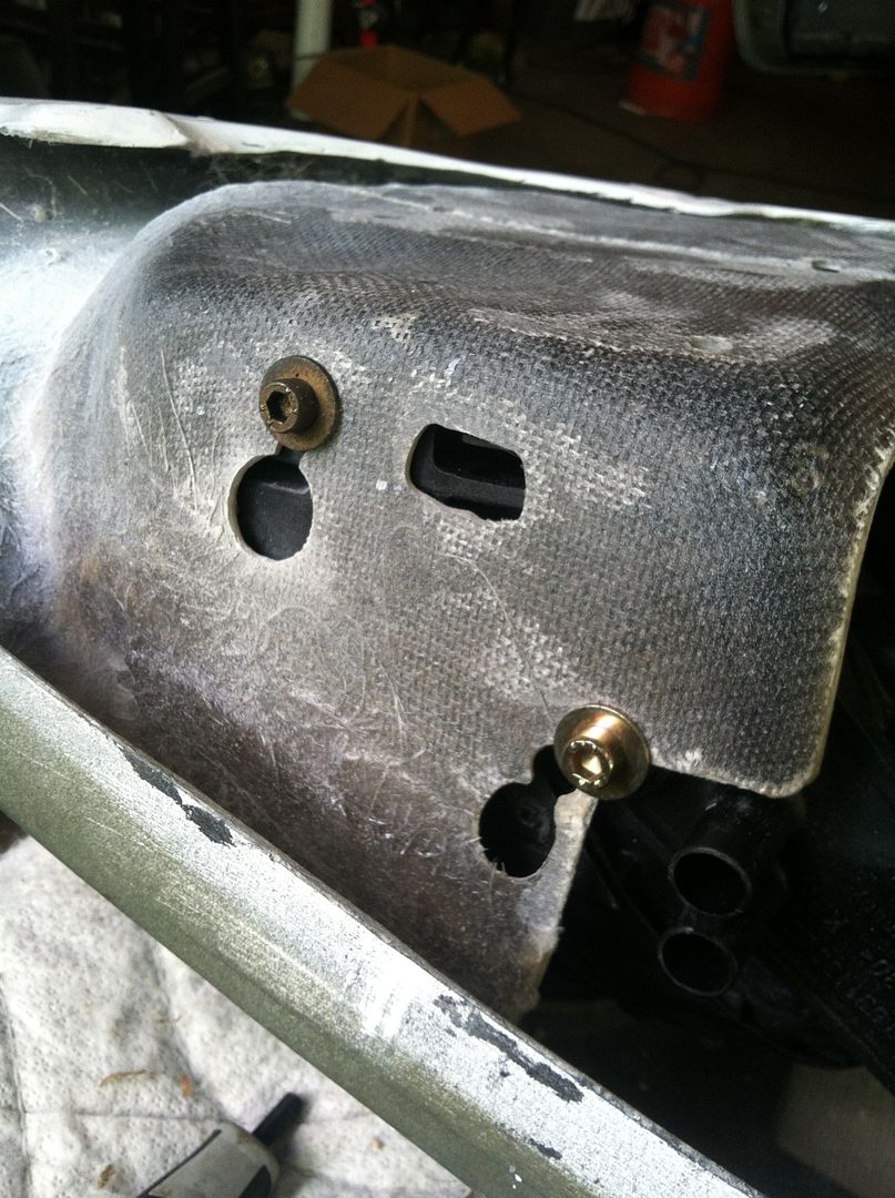

    • With the wiring getting near the front i needed to fit the headlights and brackets. i've basically put it off due to how bad the fiberglass mounts were upon test fitting the lights months ago. You can see how far this side was off and it was the best side. i had to split the bucket to get everything to fit.
      fitted.

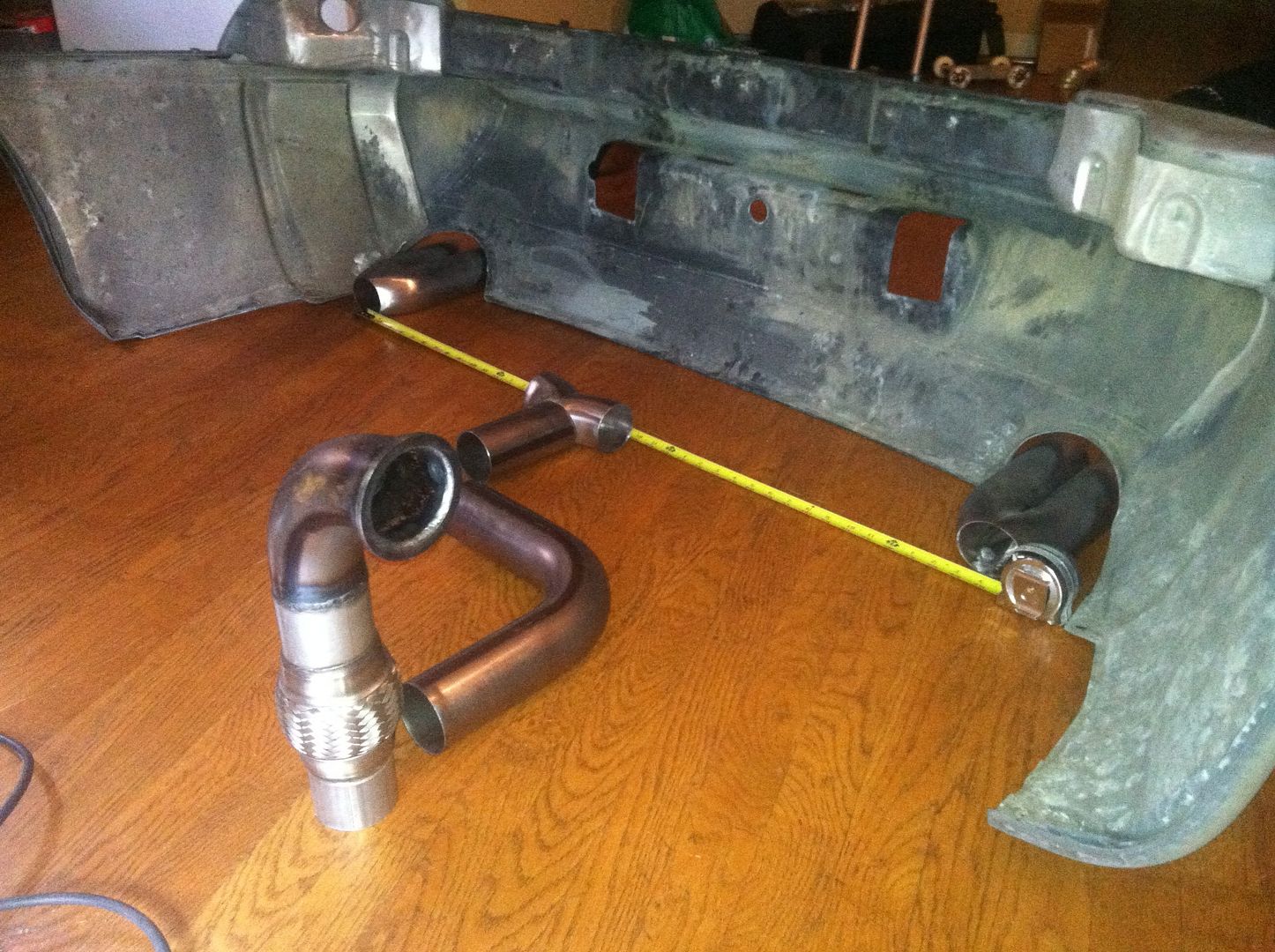

            Start of exhaust

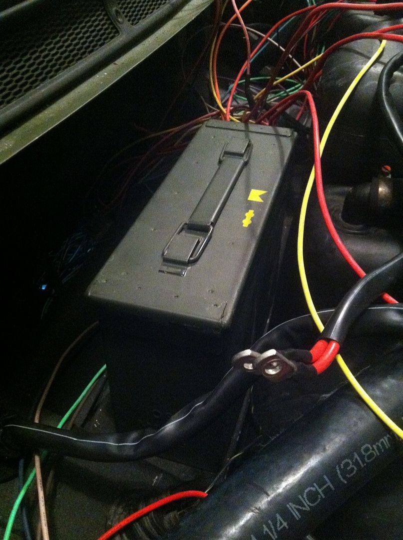

            • Needed a waterproof box to protect my relays and fuse box so i picked up an old ammo box. fits in there perfect.

                  • you never drive thru on a good day haha thanks man. hope i can drive it up for that. ive been having to buy little bits here and there that are small things i overlooked and its more shipping time holding things up. wiring has one more weekend so trying to get everything else complete so when the key turns, technically it could be ready to drive. interior is at loves so i'll be pushing that time frame as well.

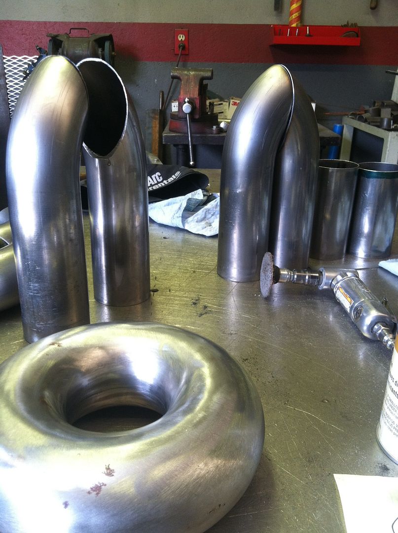

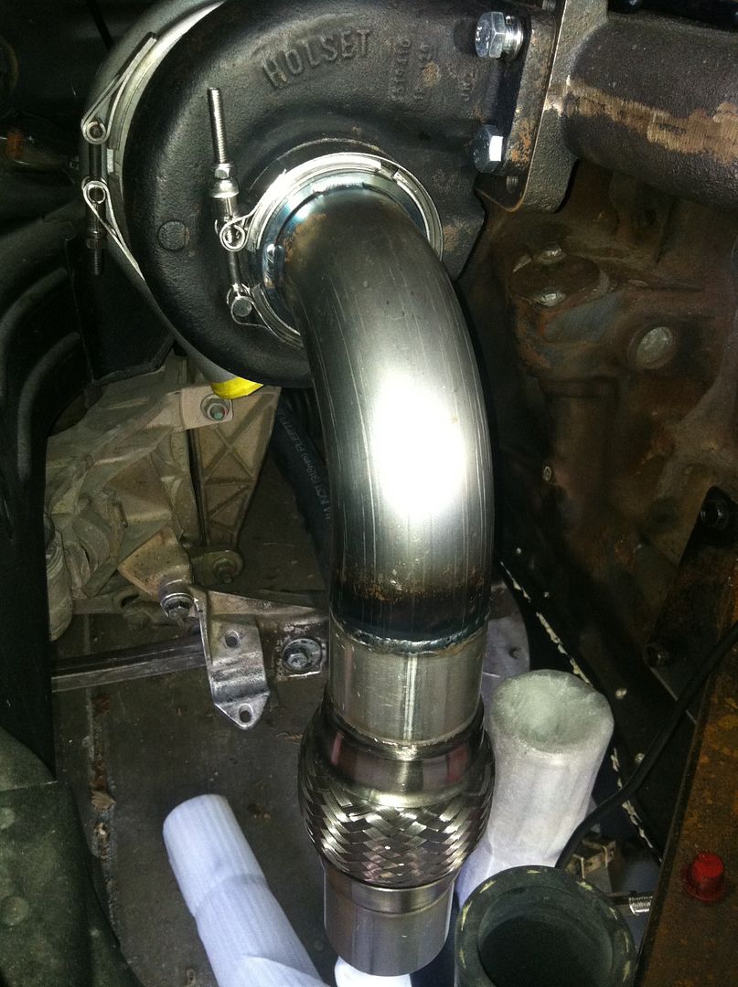

                    • Had my buddy Stanley weld up some tips, dual 2.5" pipe and made me a smooth 2 into 1 transition. just need to cut a couple more tight 90's and exhaust is done. I'll get some oil and gas in it this weekend and see what happens.
                      58'' from turbo to tip. should be rowdy

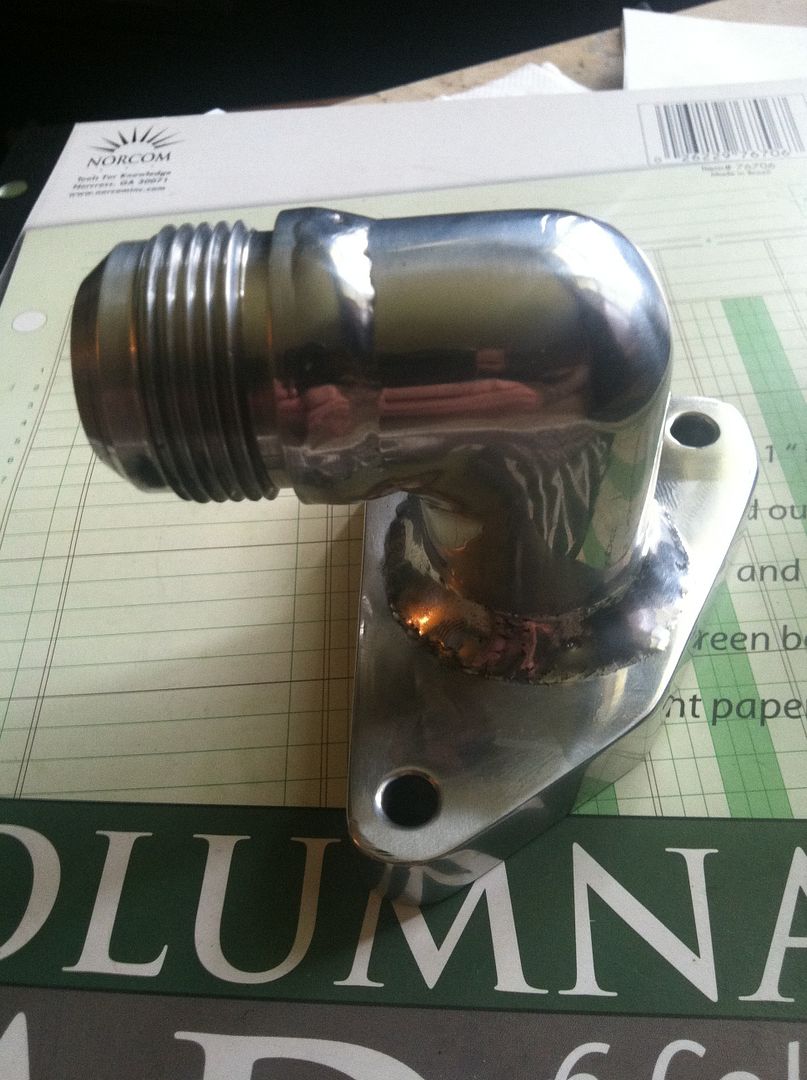

                            • Ok so if you've been reading you know the water neck has been an issue without wanting to chop into the factory metal. Well after switching to a 90 AN it was still to tight. Ordered a tight 90, no dice. So im proud to present version 4.0 lol. I had to change out the fitting on the coolant hose but now i have a nice tight 90 coming off the block and i used a 90 swivel AN to go back the other way.
