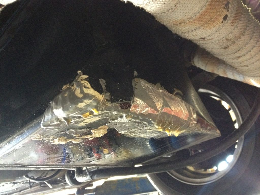

    Originally posted by Byron View Post
    He had the E30V8 pan before I believe, does yours have kick-outs on the sides? This is the only picture I have of his old one, he had smacked it quite a bit at this point and it dumped all 8 quarts all over my shop floor overnight.
    His car is pretty much all E30V8 parts, so I'm sure yours would sit the same if you used the same pan as us. I had to cut his pickup tube and raise it 7/8", but it still hung below the pump itself so there's plenty of clearance there. It still holds 6.5qts too.
    And I'm totally copying your exhaust setup for his car btw haha
    Whaaaaaaaaaa, no. That looks like a road race pan or something. Mine is like this, but modified to fit around the steering rack as you said.
    I may have to get a road race pan, like this one
    And oh yeah
    I'm continuing out the front valance too, when I get the chance.
    Leave a comment:
  • Byron
    replied
    Tried to modify a stock pan, didn't work so well. So bought one from e30v8.com(same pan, pre modified). And wait, the lowest part of the pan sits that high? There's no way.
    And that was the plan, but I need to run a hard line for oil pressure, figure out why the alt doesn't always charge, various other things and have the cage built before the second semester of school(when I'm bringing it with me) so I don't think it's happening this year :/
