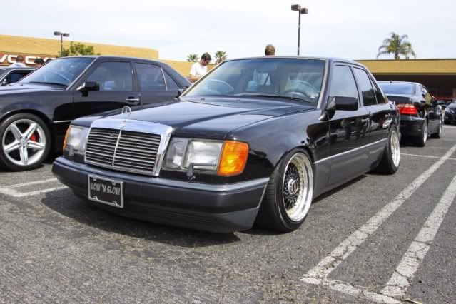

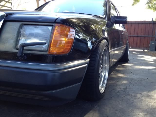

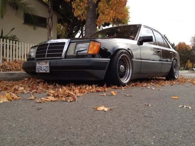

    Chassis: 1990 4dr w124 e300
    Suspension: H&R springs & Bilstein Struts
    Wheels: BBS RS with 2.5in lips all round 16x8.5 +17
    wish list:
    1. take out 25mm spacer out back and add a 3.5 in lip
    2. new front lip that sits lower and more aggressive
    3. coilovers or bags to adjust ride height
    4. new paint job

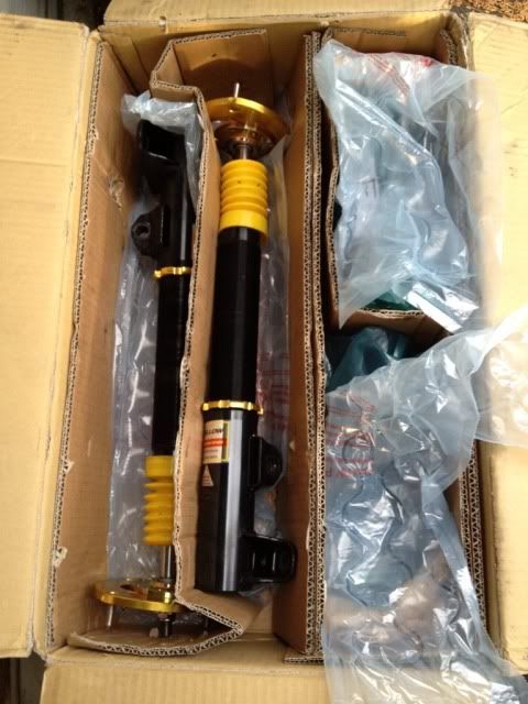

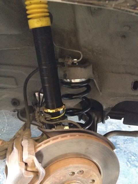

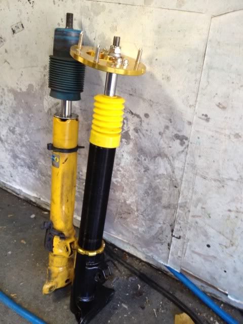

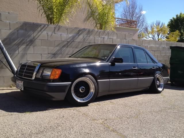

    Update:

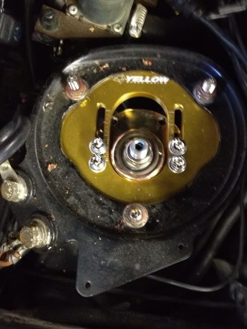

    yellow speed racing suspension kit
    height adjustable with front camber plates

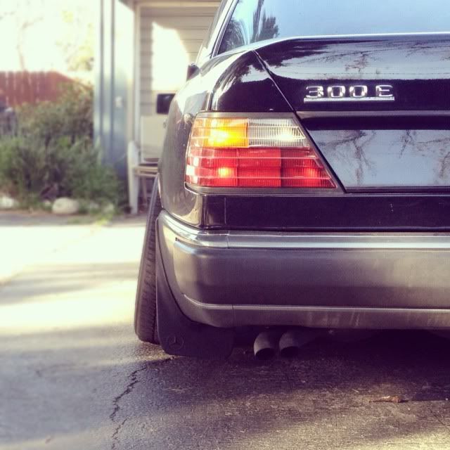

    rears slammed, but totally undriveable for a daily

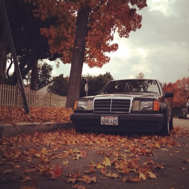

    raised her up a bit:
    needs more poke... thinking of 10mm front spacers and adjust less camber in the rear

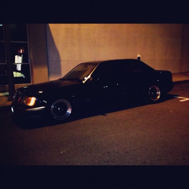

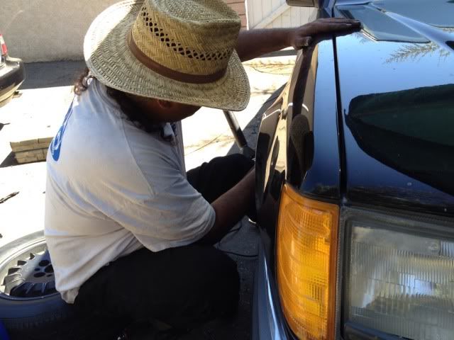

    new phone pic and mr. tony doing some fender work:

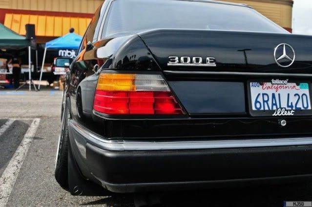

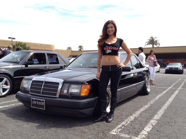

    Update: some pics from a local mercedes meet

    Needs more wheel and less sidewall
      ^ And less camber..
        looks good
          Originally posted by Jorge View Post
          ^ And less camber..
          I think the camber looks kinda nice.
            Smaller tyres and lower at the front, looks good otherwise

              I like the camber and the meaty fitment, from your plans you seem to know what your doing so keep it up.
                The camber also gets the car lower in the rear without having to cut another coil

                        Thanks bro! I'm currently using 195/50 for the fronts (for better fender clearance) and 205/50 for the rears. I cut a 1.5 coils up front and one in the rear with the H&R springs. On the third pic it shows my old front setup (205/50)
