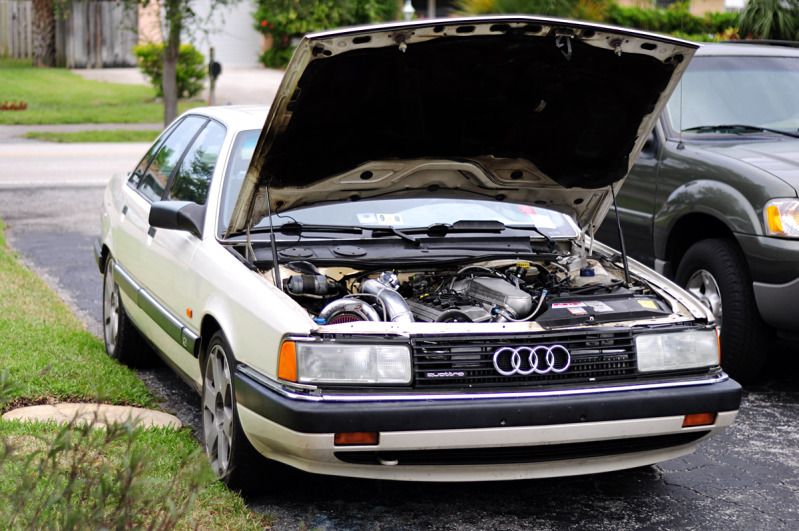

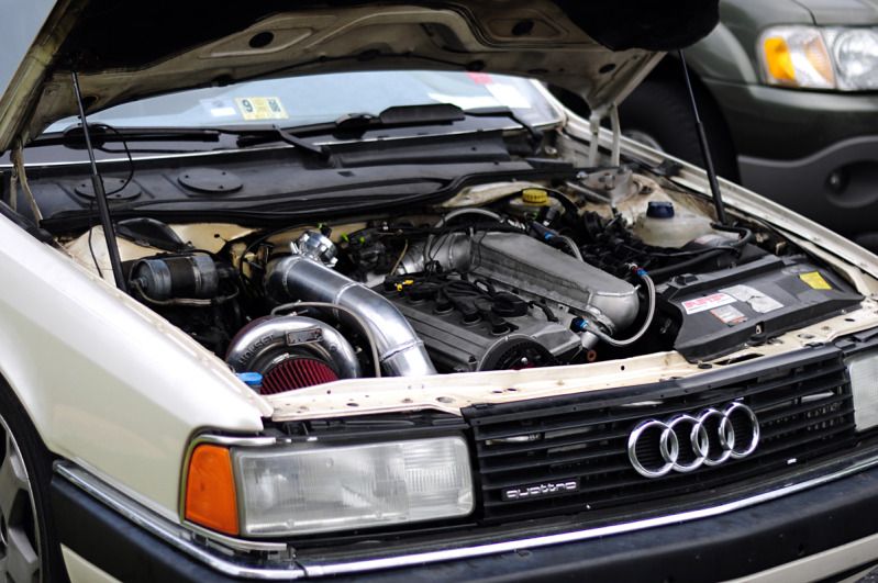

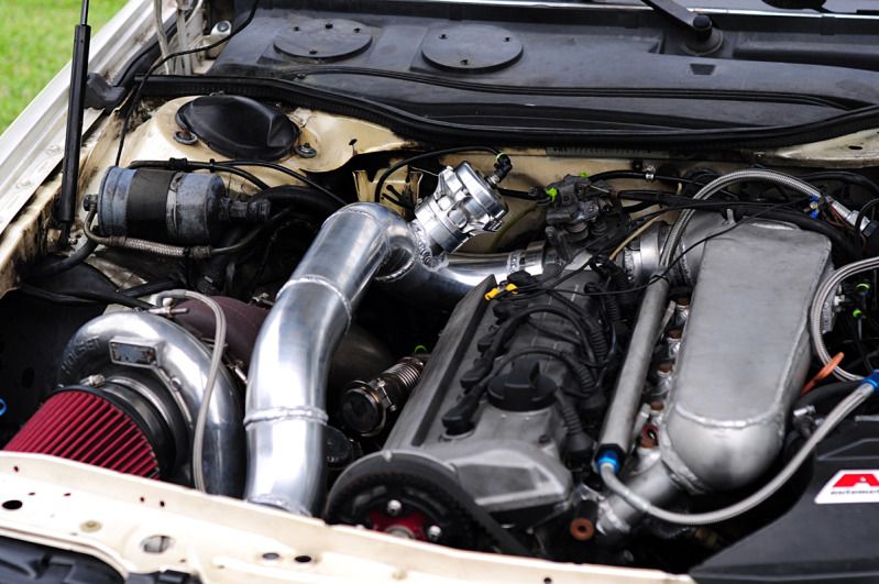

Update: the car is on the street again for the first time in a year. I wanted to get it rolling again before I leave for Saudi Arabia next month. That required converting to vacuum brake assist and fabricating some new piping.

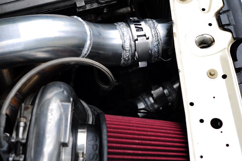

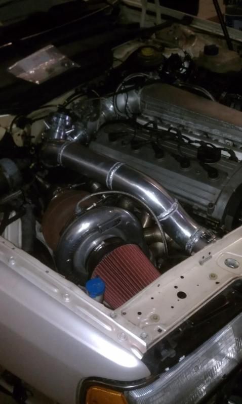

The IC piping was completed with no silicone which makes the system that much more robust. I'm using two Hargett couplers (no longer made :'( ) and three Vibrant Vanjens couplers. I like them both a lot.
What you can't see is the 4" downpipe and transition to my old 3" exhaust which was done in stainless.
