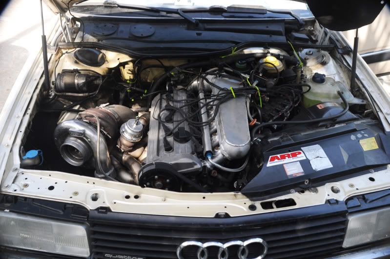

    I'll be going home this week to get the ole' girl running again with these new goodies attached.
    and...
    moAr!!

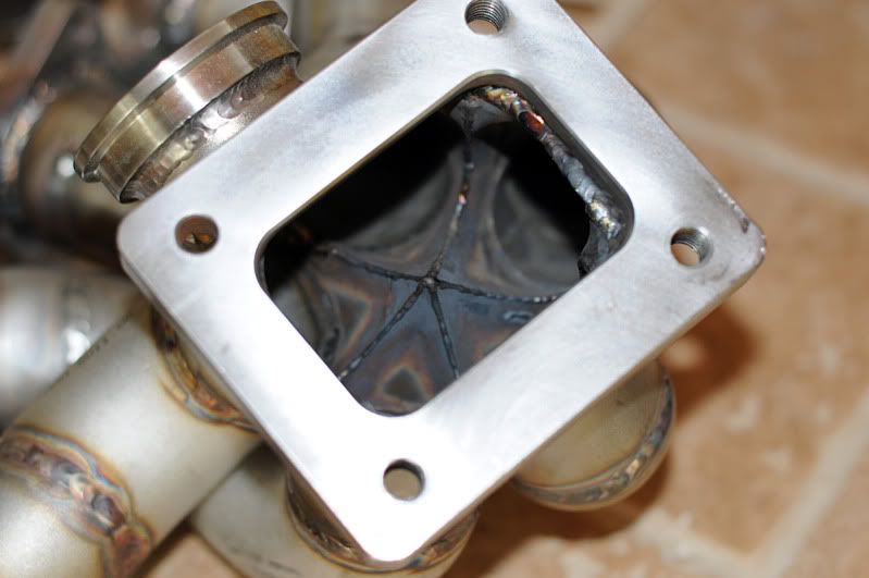

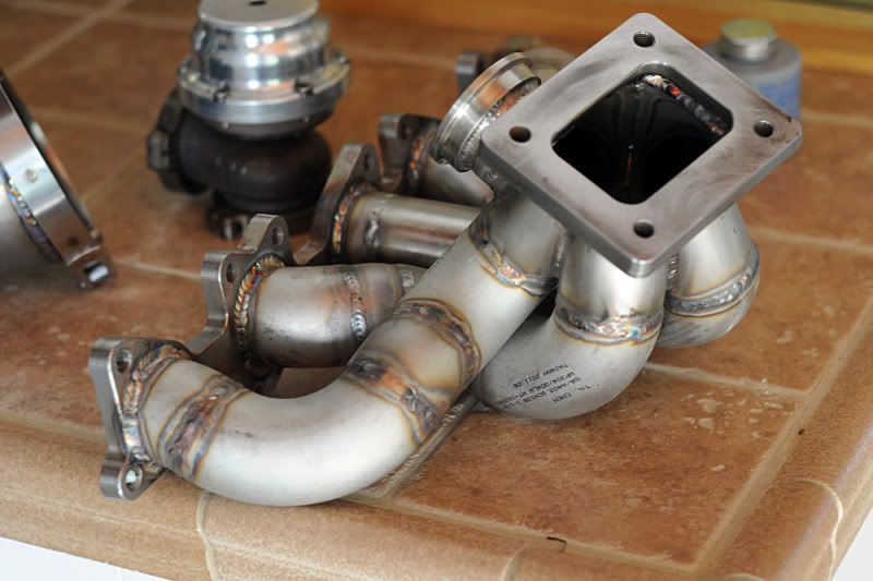

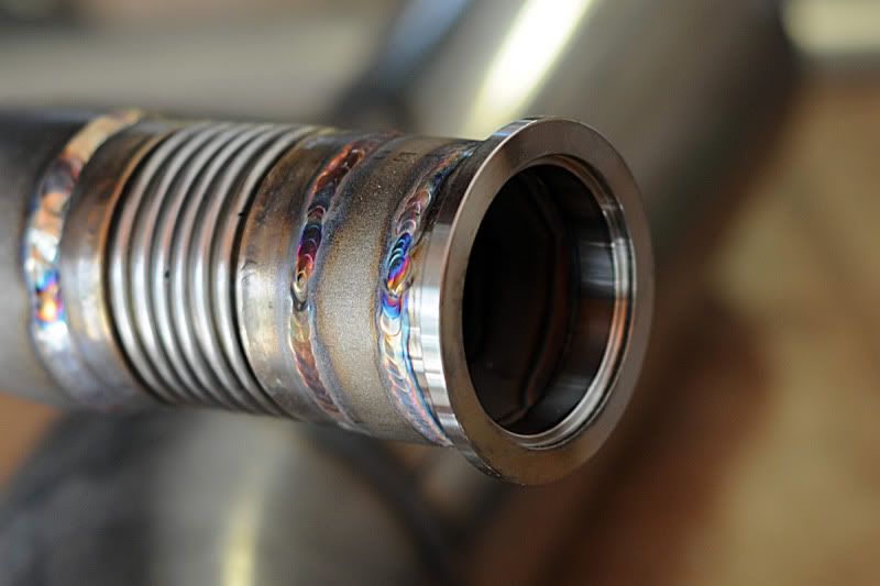

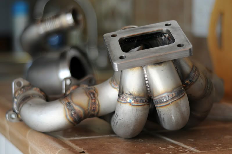

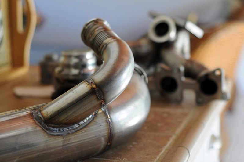

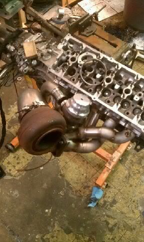

    Mr. Hank Iroz is who has been welding all of this awesome stuff for me. Maybe one day I'll have enough space and time/$$ to get myself a good TIG and try to match his amazing skills.

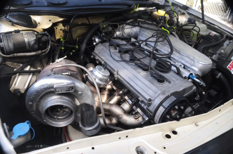

    Should be interesting getting that 4" dp to clear my subframe and axle lol. For now I think its just going to have to be open downpipe dump. I am really, really determined to plumb it into my existing 3" exhaust for when I want to be "stealth" though! The wategate re-route was mandatory as well because I wanted to hear nothing by my normal exhaust note and the sweet, sweet sounds of the HX52 monster (when its plumbed into the exhaust). Obviously for max power it might need to be disconnected.
    I'm very excited to get back home and get this thing running again with all of the new goodies. Its been way too long!

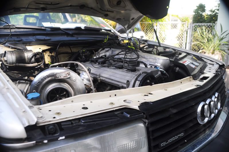

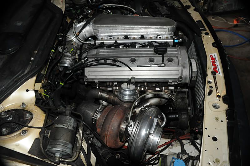

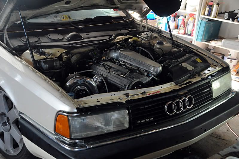

                              • Thanks again all.
                                I finally got to edit some pics

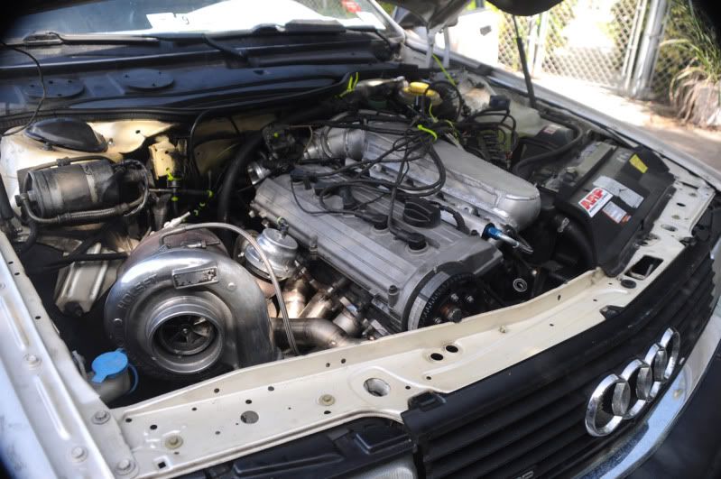

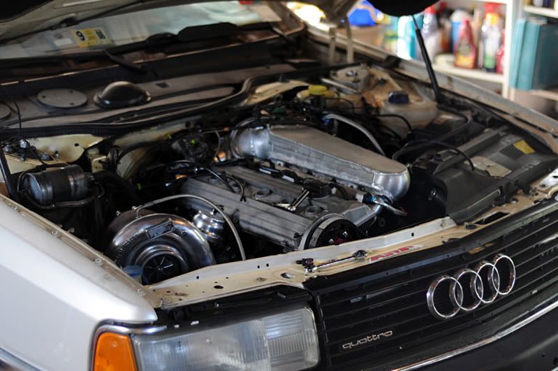

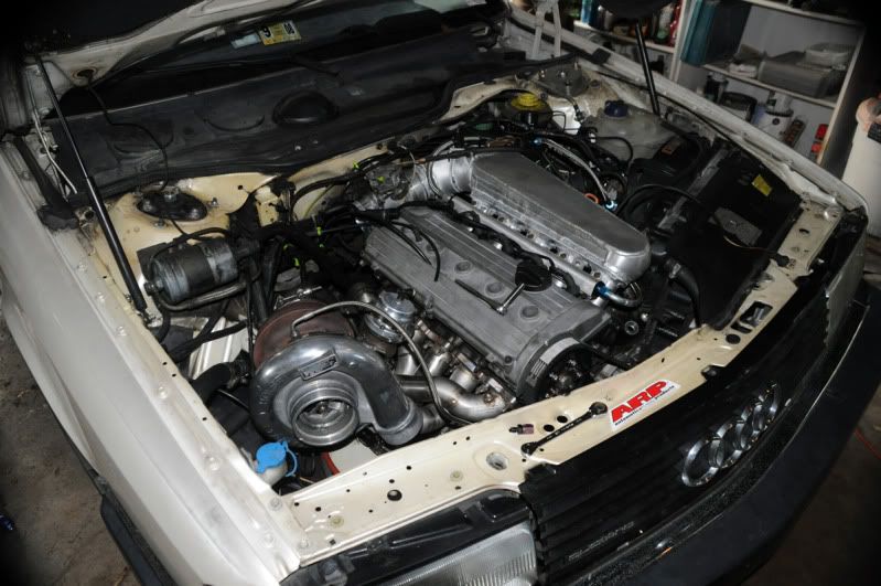

                                Its going to be a little while until its running on boost. I don't have the time to make the intercooler pipes and integrate the downpipe into my exhaust until the summer.
                                I do have some pics and vids (just of it running) of the new setup though
                                finally got a chance to edit some pictures
                                I cannot wait to clean this car up once I have more time and a better place to do it!
                                and the vids (my mom is awesome lol)
