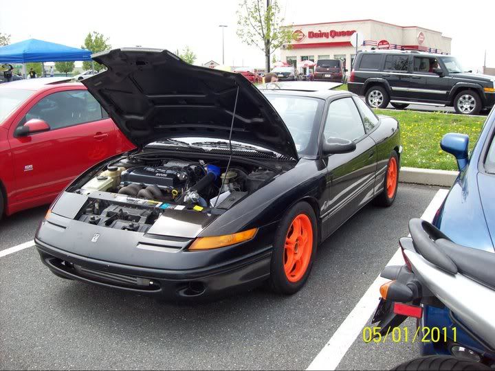

    Had to remove the intake, but I got it running like this where it made 202whp @ only 5psi
    Made it to the big yearly Sonic meet in PA.

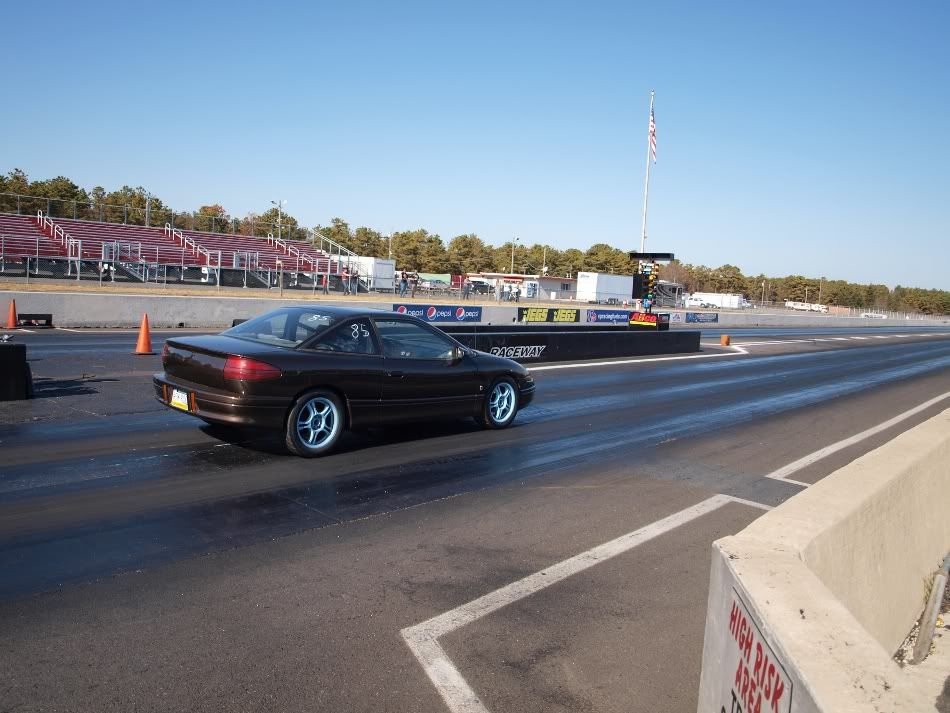

    Made it to the track and ran a 13.4 @ 107. Not bad for first time and on street tires. All of this on the stock motor @11psi.

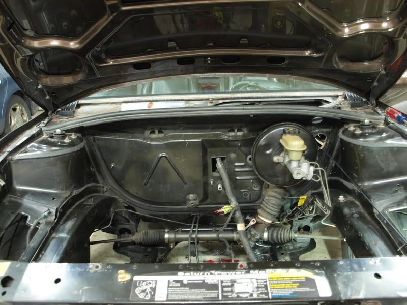

    It's currently torn down and I'm doing a full wire tuck and shaving/painting the bay and then installing the new built motor.

          curious as to where you are tucking the wires and what your doing with the resevoirs and such? could you post up some pics of the bay in progress?

            Random: check out my build thread on 6S. I have more pictures up there. Basically the headlight harness is run through the fender well, fuse box is under the dash and the rest of the wiring pulled through where the A/C would normally run on the firewall. I should be finishing the wiring and starting on sanding the bay next week (I hope!).

                Been a bit since I visited. Yes that is my car in the dyno vid. I painted the wheels the bright orange right before the dyno day lol.

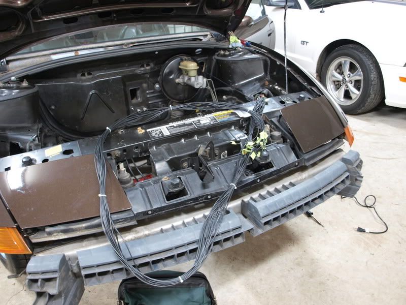

                    Figure since I'm not getting too much done I could post some pics of the wire tuck.

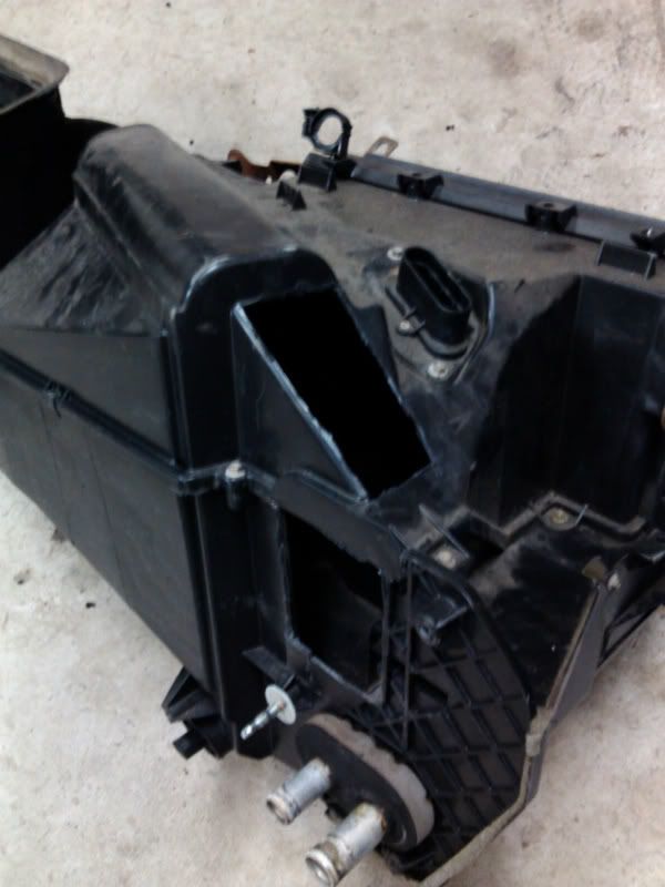

                    Cut some of the heater box up. The A/C stuff is yanked out so that's where the hole in the back of the box came from. Just had to cut it open a little bigger.
                    Harness pulled through the firewall. Still need to update this.

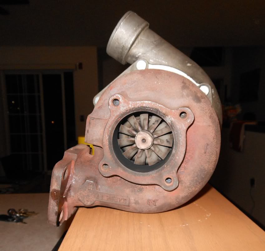

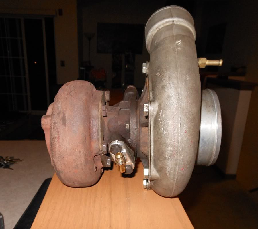

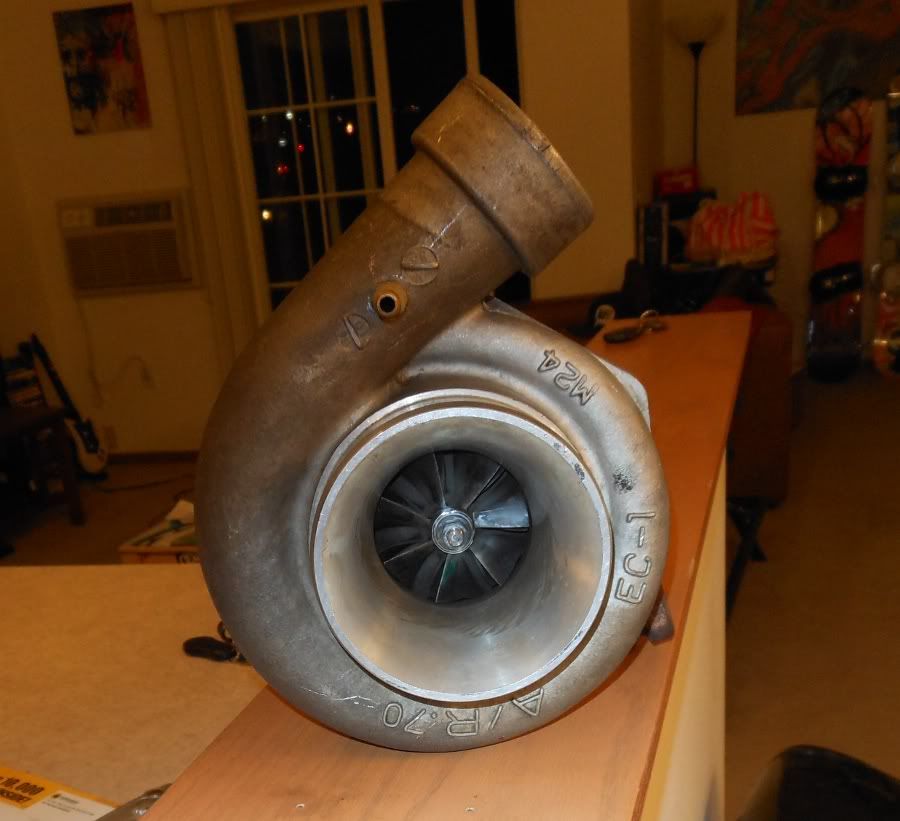

                              I don't have any big updates as I actually broke my pelvis riding bmx around 3 weeks ago. I have to stay off of my left leg for the next 2 months so until then I can't do any real work to the car, but I'm going to try and get some minor work done here real soon. I did finally purchase a REAL turbo. Went with a big boy Garrett t3/t4 60-1. Sucker will flow enough to make 550whp (which is about 100 more hp then my goal). It should be pretty retarded on 20psi.
