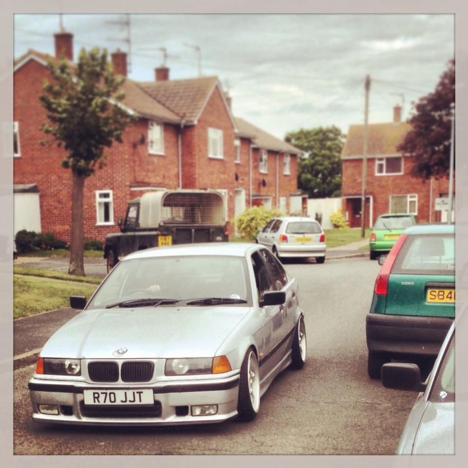

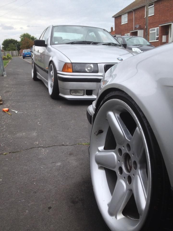

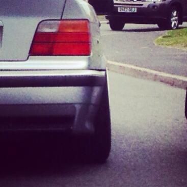

            • Massive thanks to kevin,stuey and aaron reeve performance today. cheers guys for all your help in getting these rims on inc all the running around changing tyres over for me i really appreciate all your help.fitment is insane in the flesh but some camber issues and the rears need to come up 10mm as drivers side is catching on the rear bumper bracket so need to work out some details.fronts may need a slight tweak and considering ripping all the inner liner out right at the top as after rolling the fronts its not staying put as well as i like.bit of tweaking here and there and fitment will be nailed ready for santa pod
              • Looks sweet now Andy
                Some camber and you're there. give me a ring if want any help mate

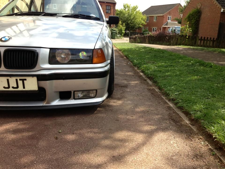

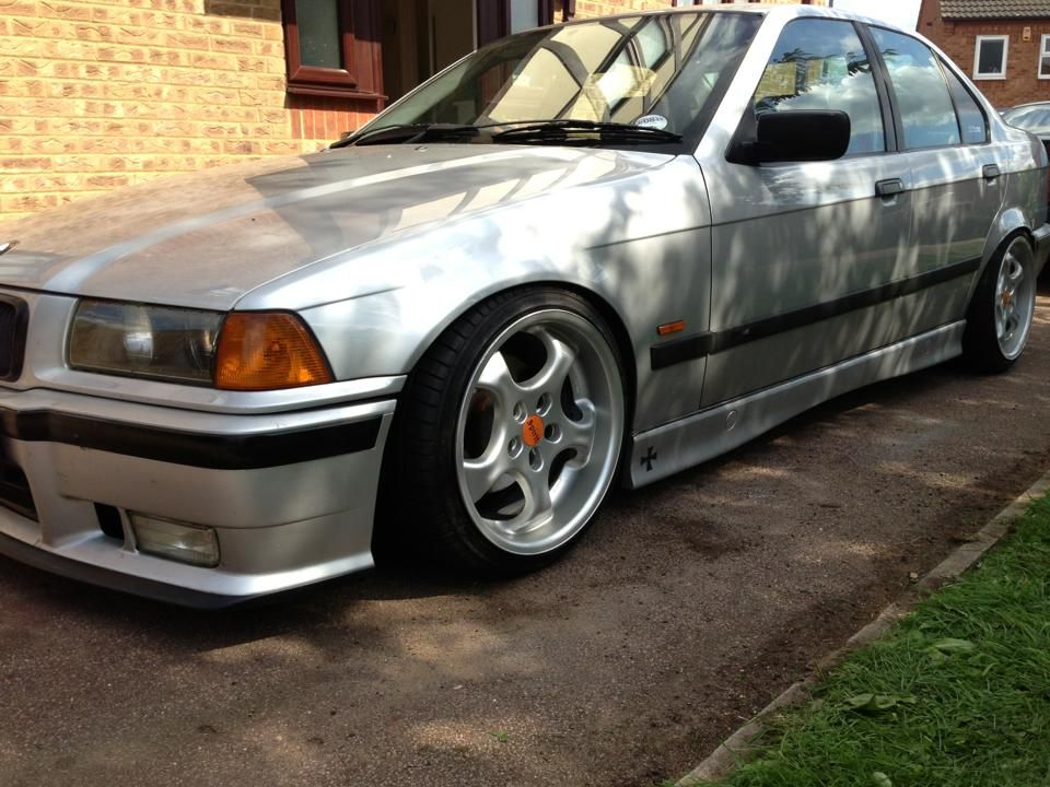

                  • Well another day another update so here goes with many many thanks to disco stu on this one so here goes with it and pics all down to stu as my phone ended up in the shitter recenly........long story
                    camber day:thumbsup:thumbsup:thumbsup

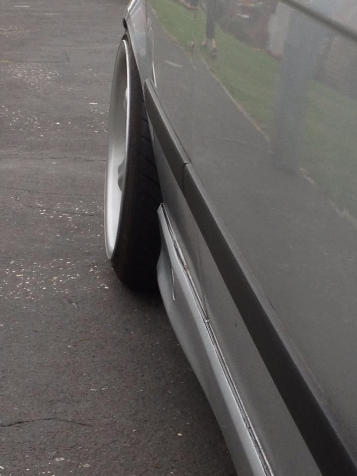

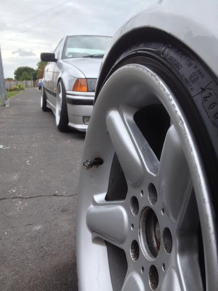

                    well its alright having nice and wide rims but even with rolled and flared arches to within an inch of their lives its no use without camber to nail the point home and of course save my arches from oblivion so today we reverse mounted the evo top mounts up front to gain neg 3 deg camber which really has pulled the fronts in now much nicer and the rears are fully adjusted to max on stock arms and tbh enough for me and makes a big big visual difference now.
                    coilovers down another 10 mm from before with 10/15mm to go
                    let the pics make the point

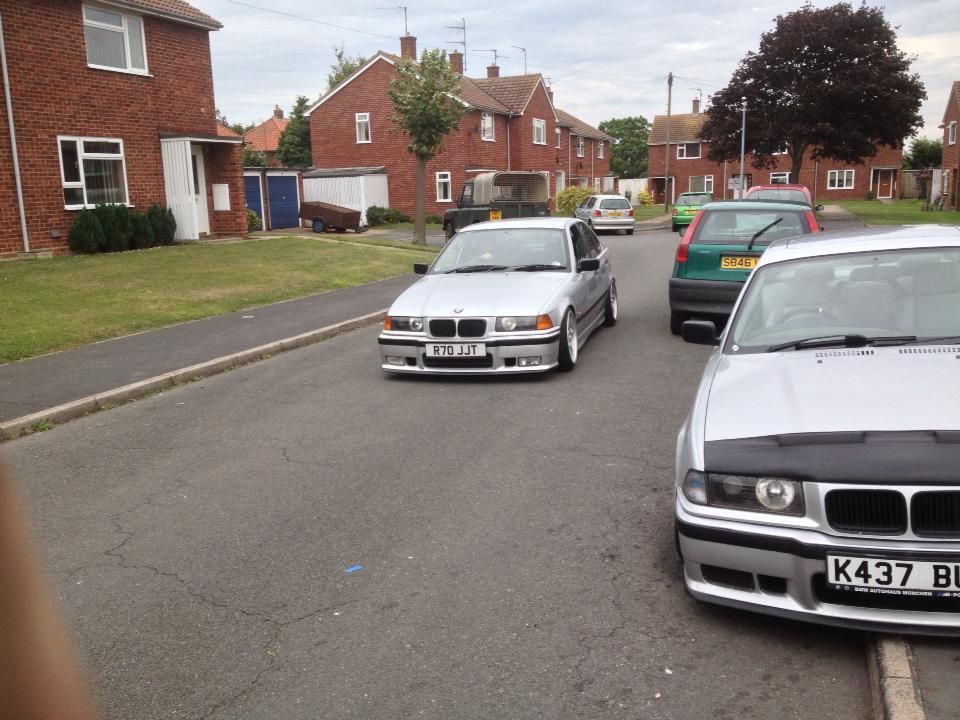

                    need to take some location shots really but thats all folks see you at santa pod:thumbsup:thumbsup:thumbsup

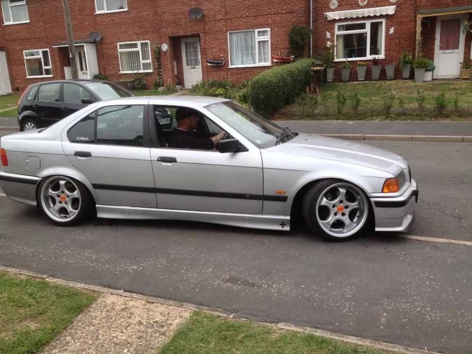

                    • Well better update so here goes...

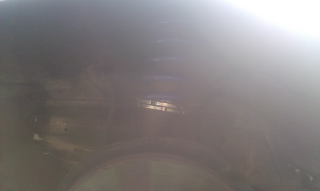

                      Rear passenger brake back plate shit its dummy and gave me grief as the spring shit itself and made an exit through the rusty back plate and left debris in its wake...cue cataclysm to the rescue to get it back in shape for me.

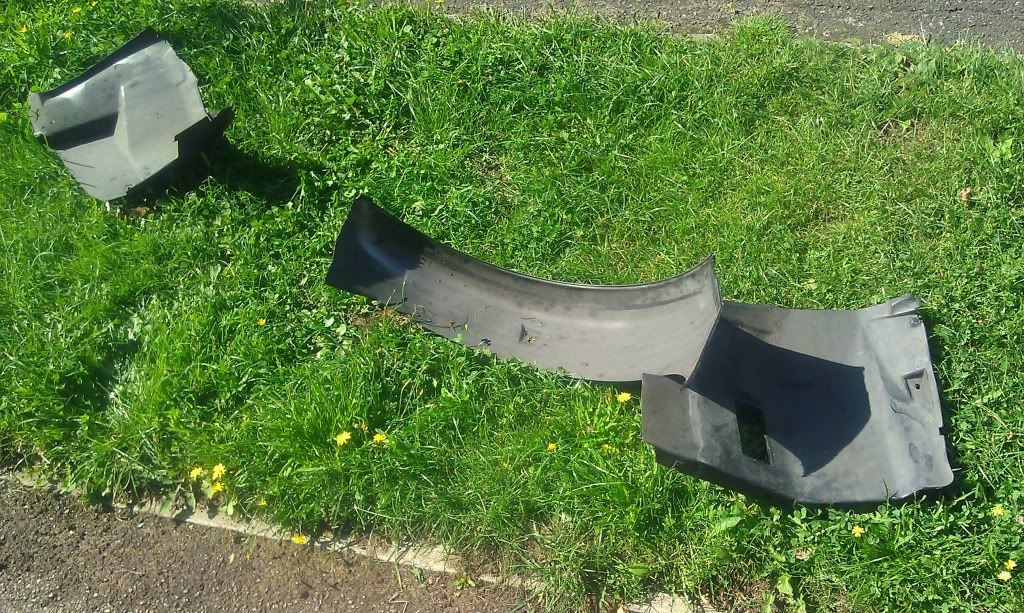

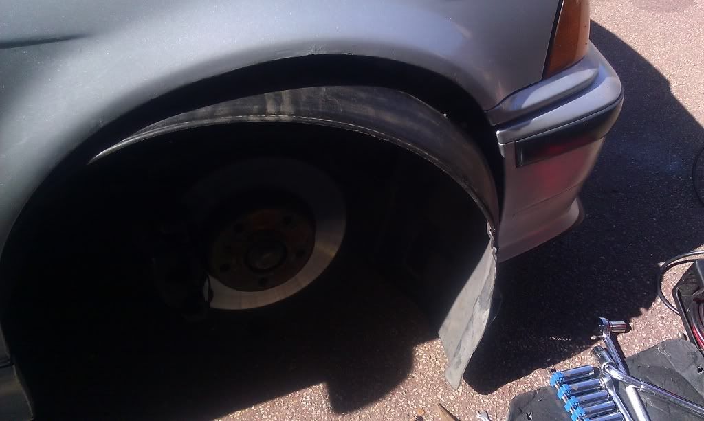

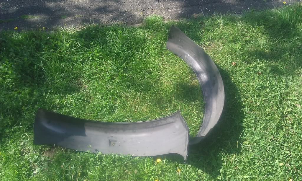

                      Alright being low but do it right so me being me and not afraid to get shit done to stop any hint of front arches hitting even with camber .I have said santa pod I will be at a much lower height so I needed to do something many wouldn't and that's mod the arch liner.since I rolled the fronts its not stayed right anyway so basically took it all out and cut the entire top arch section out and refitted the sides again.
                      Gained 5 mm extra clearance just doing that.
                      arch took a hammering when it was rolled with some filler making a bid for freedom but will be fixed soon so excuse its condition in the pic
                      Then coilvers got shoved south to the max minus helper springs
                      Pics of final look to come but boys I think I've nailed it and happy

                        • Specs here of suspension/wheel setup if anyone is interested
                          Blue tuning art coilovers.fronts have helper springs removed and max drop passenger side and 2 spins left drivers side to correct e36 lean with m3 evo top mounts reverse mounted for max camber.
                          Rears have adjusters in with max drop passenger side and drivers one has collar lifted 10 mm again to correct lean all e36 have towards drivers side.camber maxed out in std arms rear.
                          Tyres are 205/40/17 fronts with arch liners chopped off on top parts and rubber removed.arches rolled
                          Rears are 215/40/17 with sealant ground out and rolled n flaired arches.meyle hd topmounts
                          Wheel specs are
                          17 inch Brock b2 s et13 all round 8.5 x4
                          Centre bore 74.1 so used spigot rings to get 72.6 e36 fitment.
                          Andy

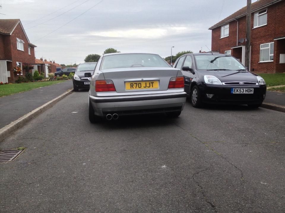

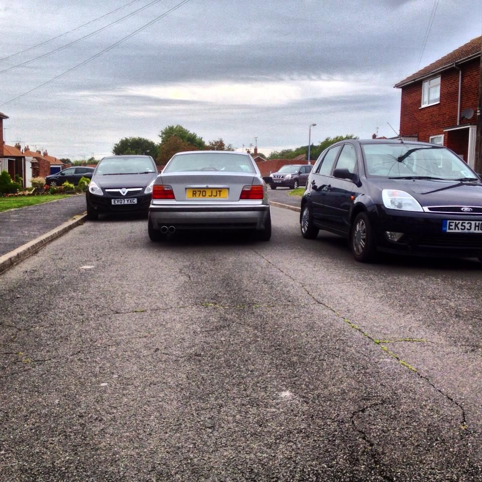

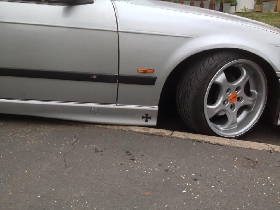

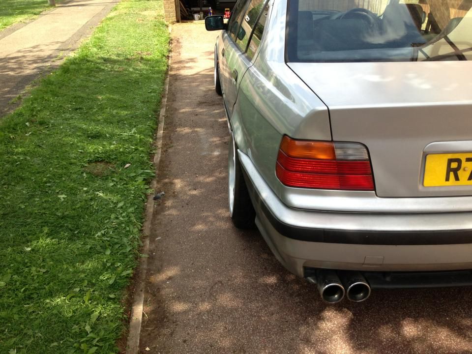

                              • Decided to raise the rear and try 15mm spacers on the rear wheels
                                215/40/17 et13 8.5 started with and pics of it fitted now with spacers fitted.
                                So et minus 2 or et 0 10 j if I'm right?????? And yes drivers side is slightly rubbing still even at this height:banghead::banghead::banghead::banghead:
                                Will work it out
