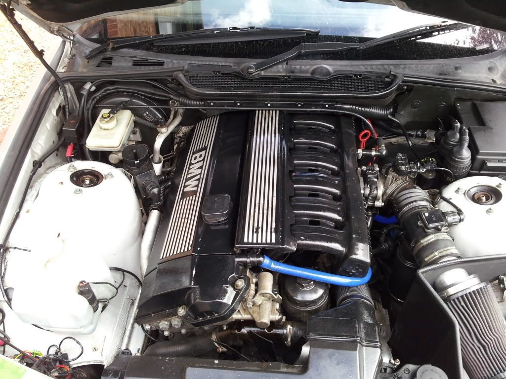

    M50 finally unleashed and remap done today.bbtb still to fit money permitting but even with a slipping clutch the car feels like a beast unleashed now and amazing through the gears now and very happy with it.
    I love what you did with the car man, it looks very clean!
    I was always interested in upgrading my 2.8 engine from m52 to m50 with BBTB but was not sure about the extra power that the engine will gain.. Can you feel the mod or is just something minor?

      Guess in the uk its a miles more popular mod than the usa or elsewhere and regardless what anyone says you do loose some low down torque until you remap the car in which case its like a different car again and pulls really well especially with an aggressive map i run...my rev limit i set to 7k as any more is pointless due to no extra power gained.
      the mod on its own is very very good especially after 4k but the remap really benefits it more as you loose all flat spots and the car pulls much much better and mine idles better now than before anyway.
      Basically the 2.8 and 2.5 m52 lump is the same bar displacement size and the m50 really brings the engine alive and worth the expense as long as the fitting kit is good.
      Regarding the bbtb ive driven james 328 at 260 bhp with remap,m50,us cams,bbtb and didnt like it it felt a bit jumpy on the throttle in traffic but good on the open road as it feels more urgent but imo i think well overpriced and over-hyped for what it is and wont be putting one on mine any time soon.
      best power gain-m50 inlet manifold and remap/chipbut be careful its a genuine m50 one off a 325 not the 320 engine as many in the uk have been caught out by this before

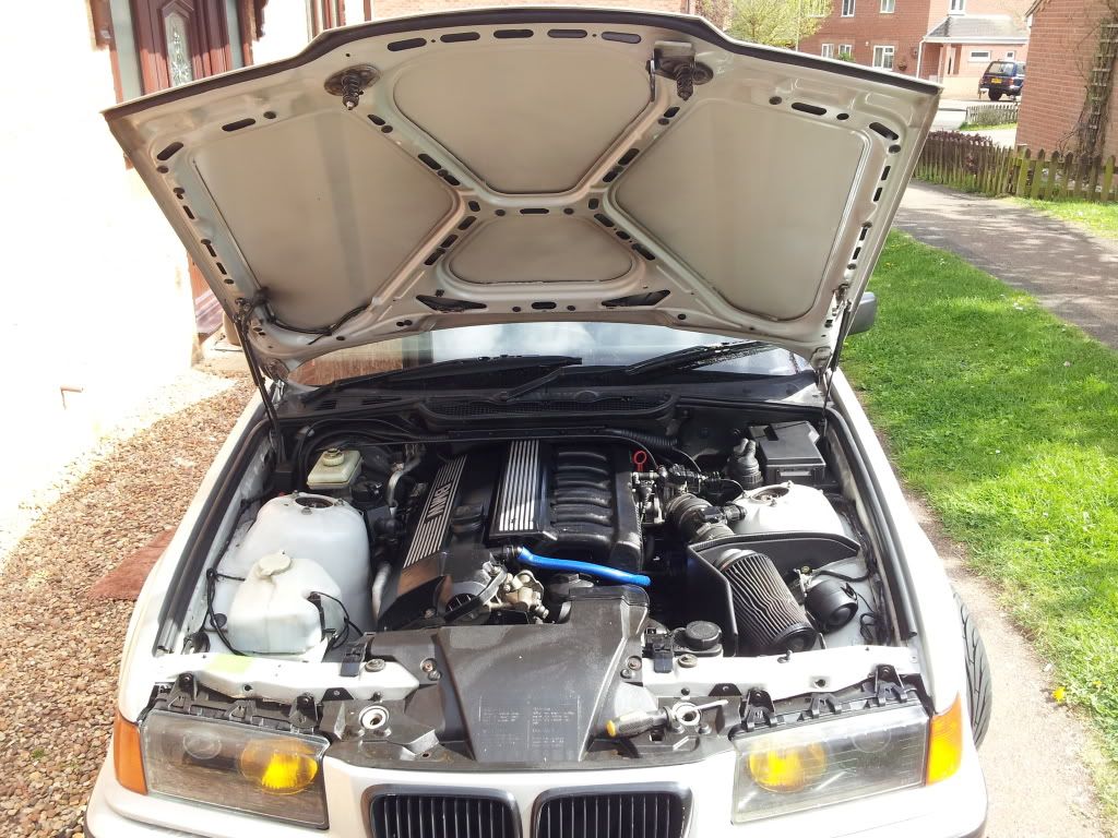

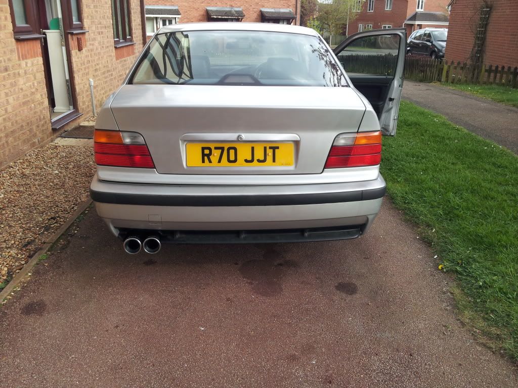

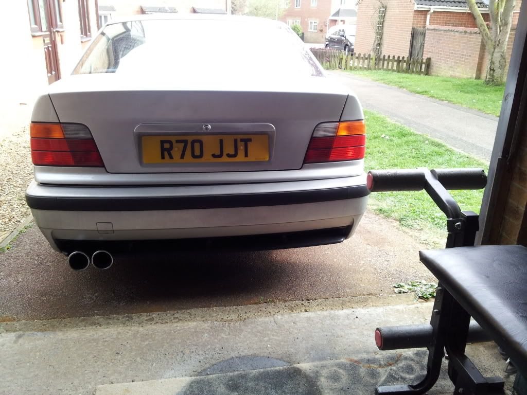

              • Quick pic from the meet yesterday. People who know the car will notice ccfls are gone and euro look lights now.car is lower than the pic suggest and getting more pics to follow.

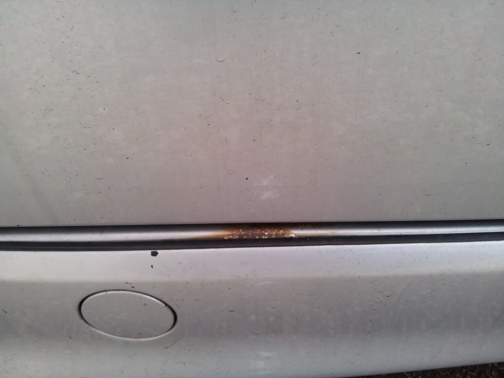

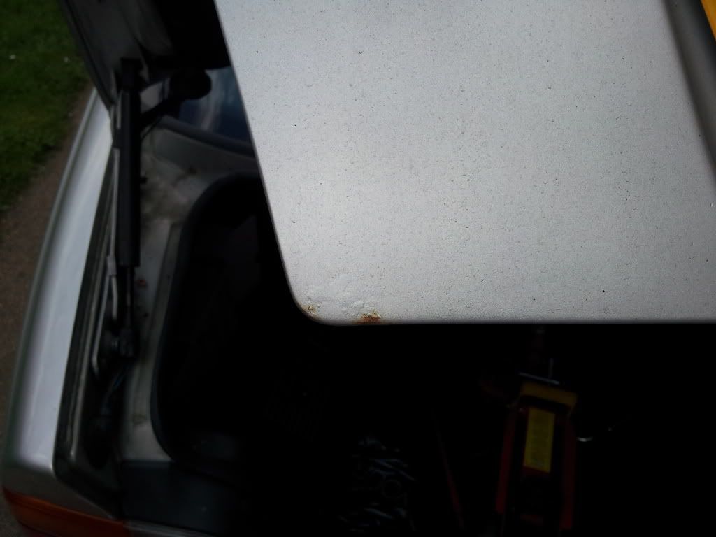

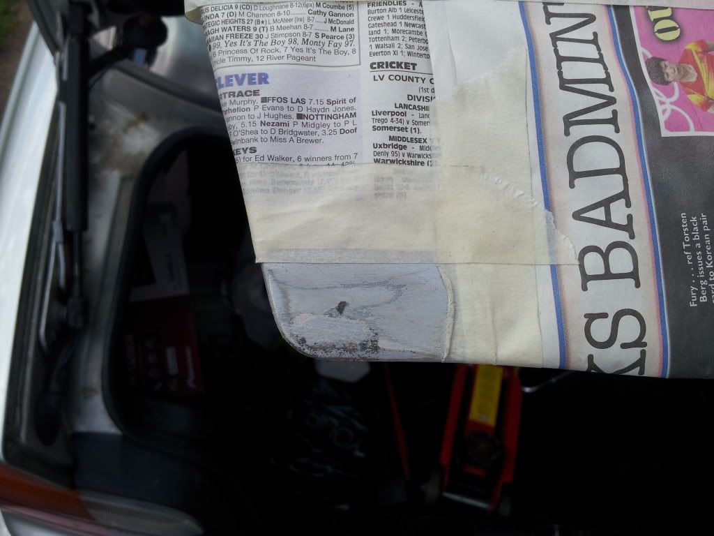

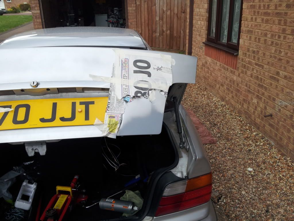

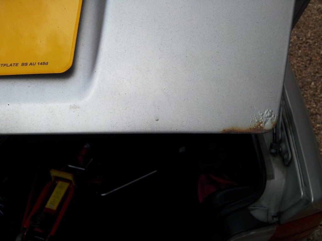

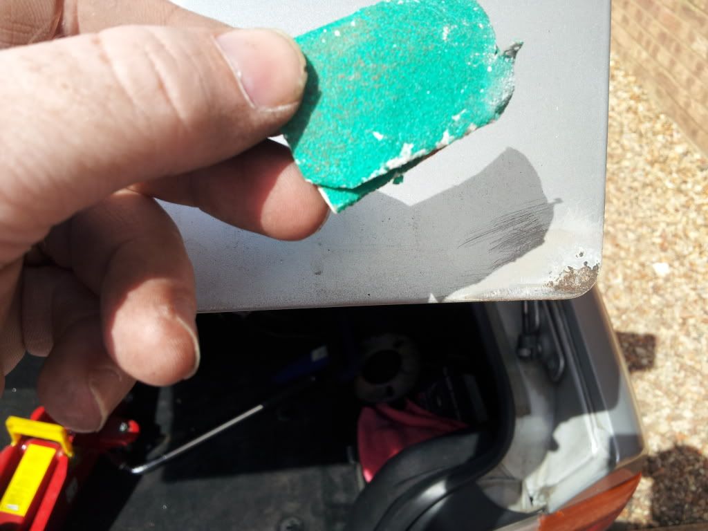

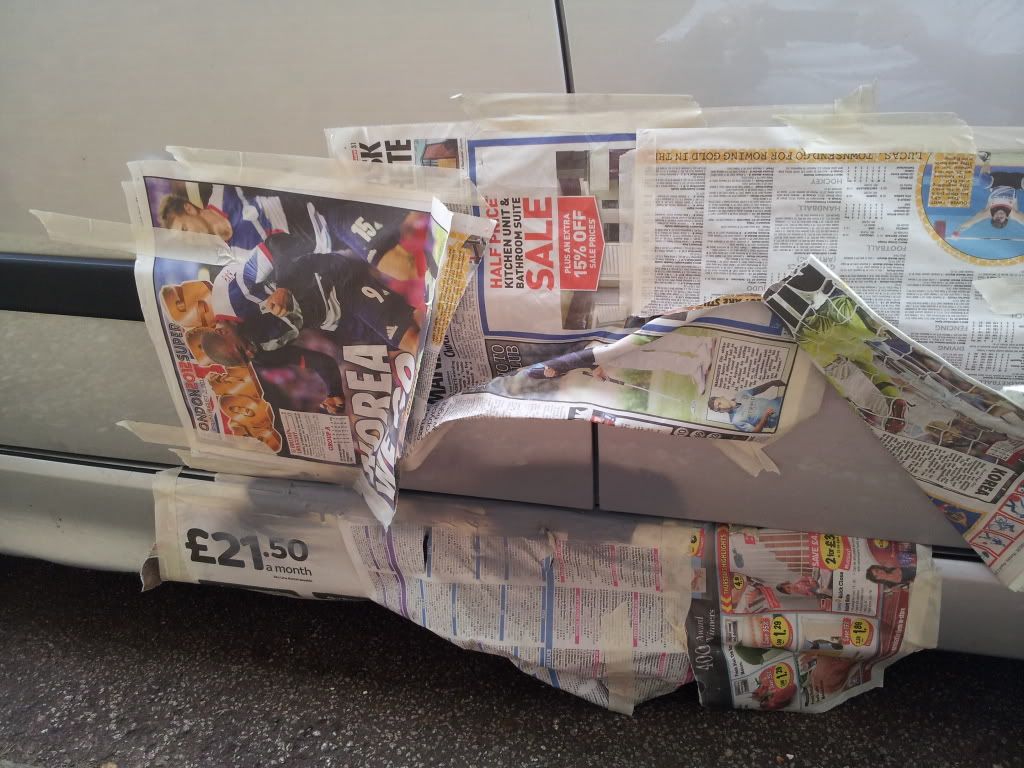

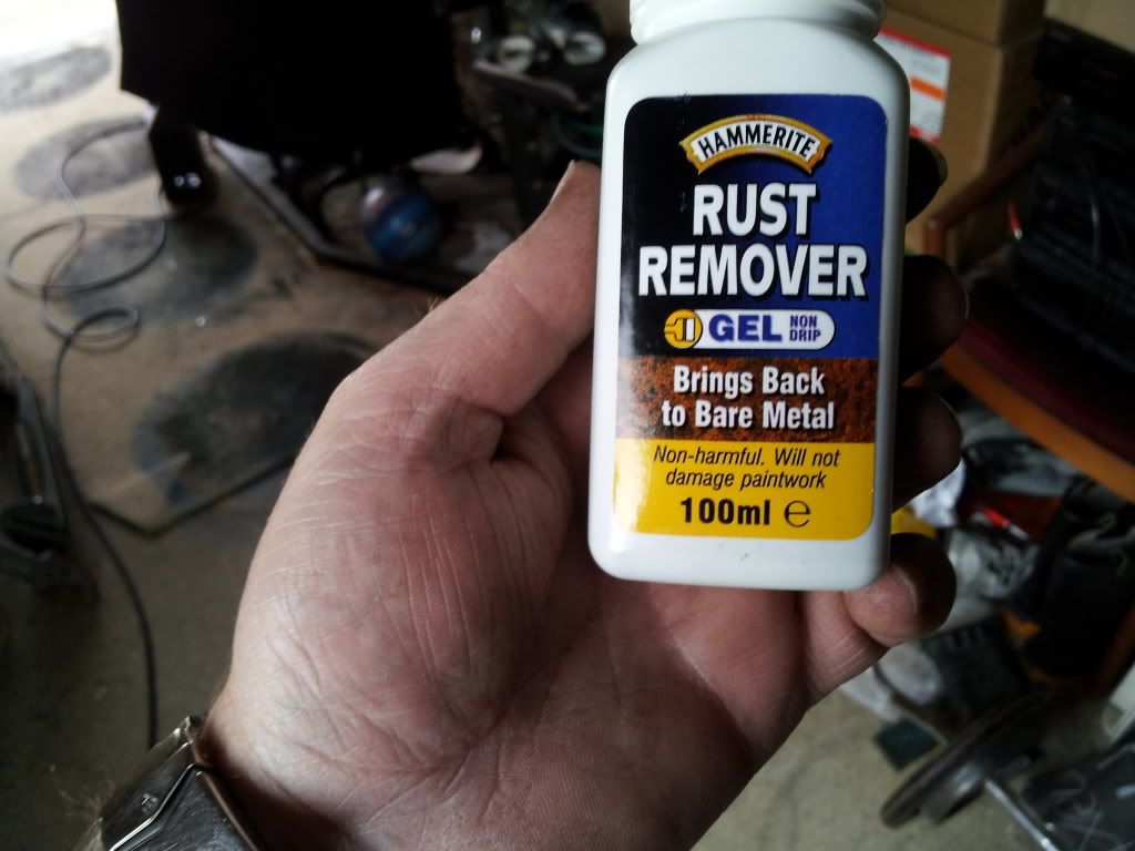

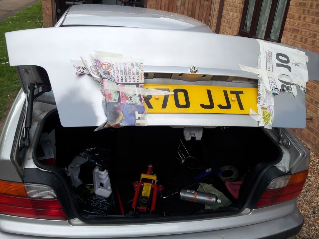

                    • Think today has made my mind up i wont be doing anymore bodywork or spraying unless its just grills and trim now im fed up being on the floor and other angles and rattle canning my car i just gonna get a pro have the hassle now and no more refurbing wheels either just gonna buy a refurbed set or a brand new set now im done with second best on this project as its all getting a bit much now but i did get a fair bit of work done inc fixing my m3 front bumper as some of you eagle eye followers might have noticed the gap on the drivers side,this now has been fixed but didnt take pics of this part i had too much stuff going on bodywork wise.
                      Anyway lets go and very pic heavy
                      infamous old number plate i keep as a memento

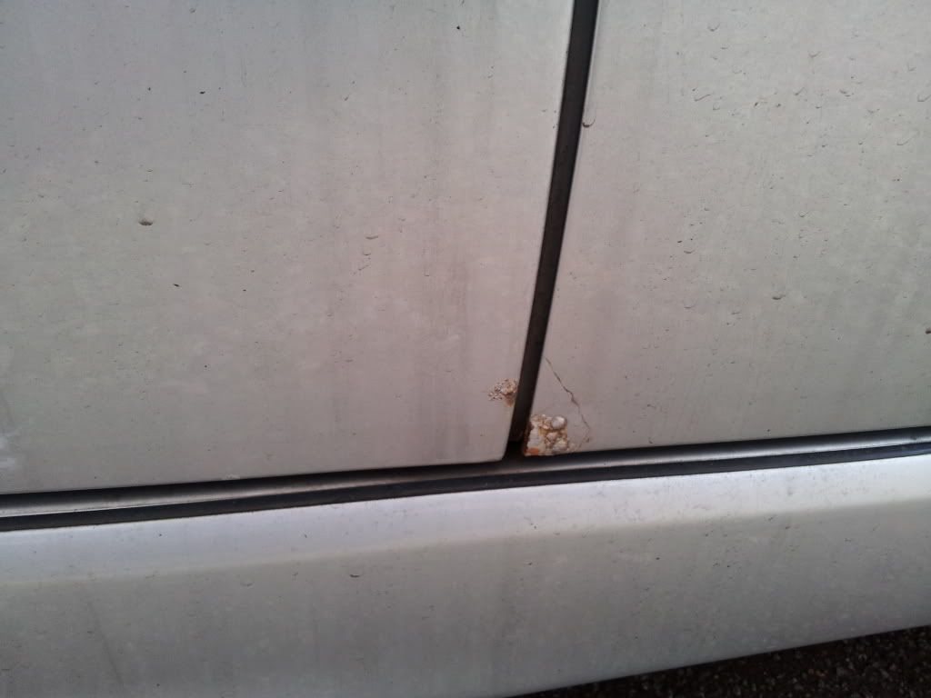

                      seriously lets see what we started withon drivers side ,remember passenger side i did last year

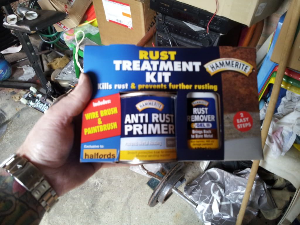

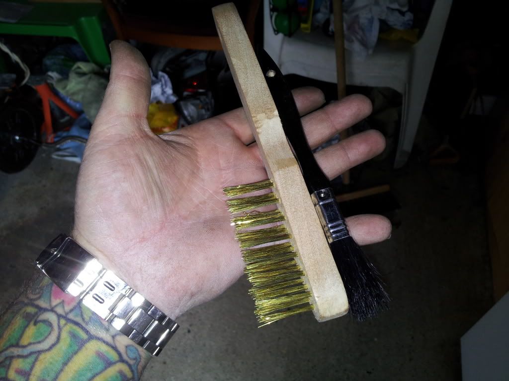

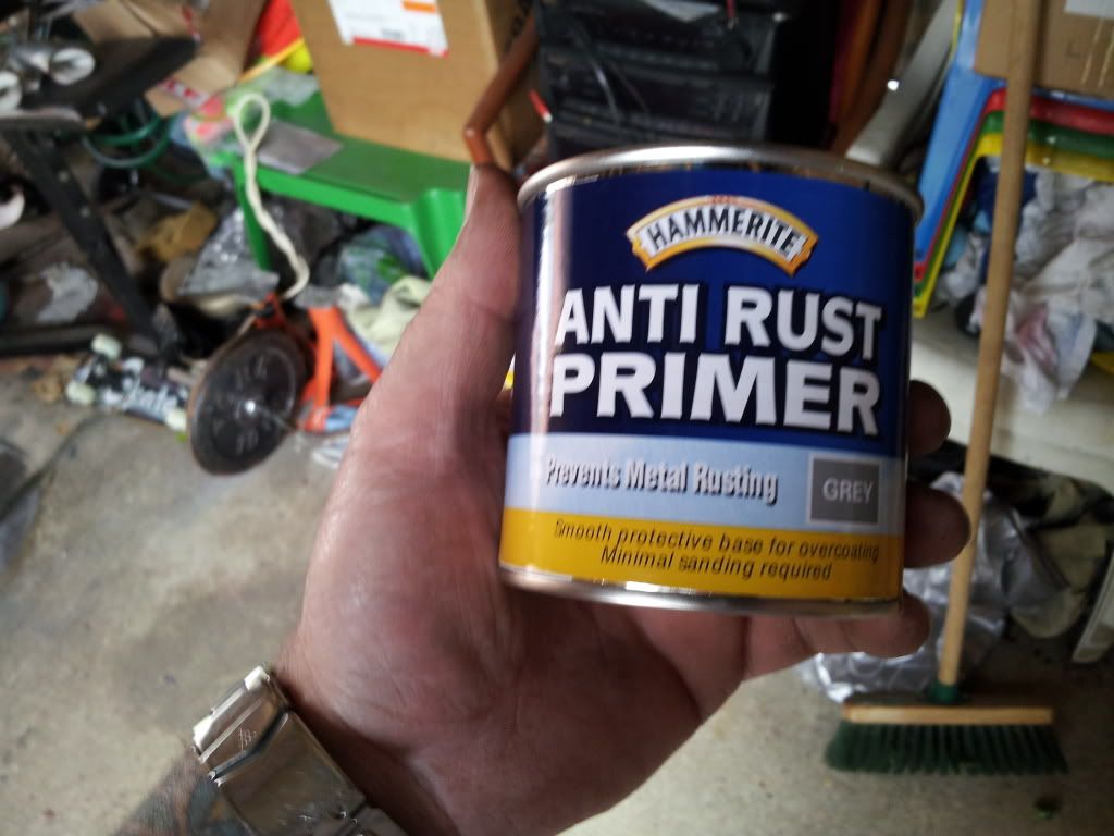

                      raided halfrauds for grey primer and some titan silver paint and bought the following kit also

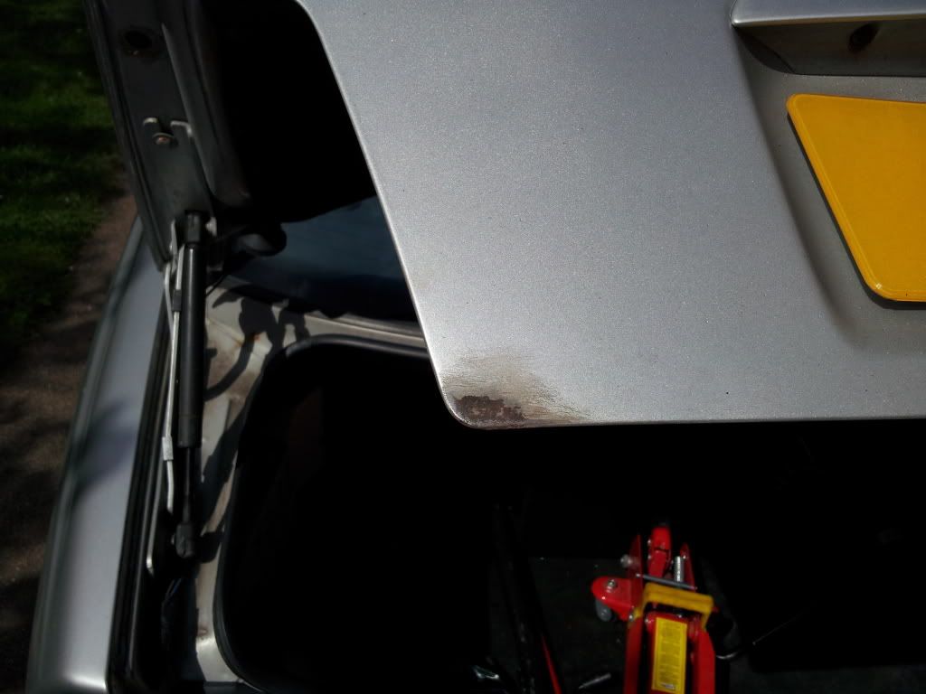

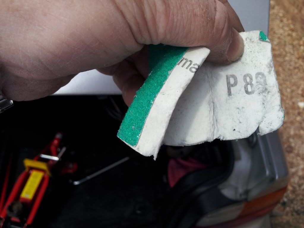

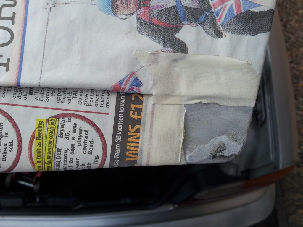

                      GOT TO WORK RUBBING DOWN WITH 80 GRIT AND USED THE GEL TWICE AND 30 MIN INTERVALS BACK TO BARE METAL AND THEN USED METALIK ON THE WORST AREAS FOR FILLING AND
                      SMOOTHING
                      TREATED THE AREAS AND SMOOTHED THEN BLENDED THE PRIMER IN
                      SOME PICS ARE MISSING AT STAGES AS THE WEATHER KEPT PISSING ME OFF RAINING ON AND OFF SO KEPT MOVING THE CAR EVERY FIVE MINUTES
                      I DID THE WHOLE FRONT SIDE AGAIN WITH SILVER AS I COULDNT BLEND IT IN RIGHT AS SILVERS A BITCH TO MATCH SO I WILL HAVE TO DO THE BOOTLID AT THE TOP NOW AS FRESH PAINT AND OLD PAINT DOESNT LOOK RIGHT BUT HEY HO THATS FOR ANOTHER DAY,THE DOOR AND SILL IS DONE JUST LASHED IT DOWN AFTER I JUST PUT THE FINAL COAT OF LACQUER ON SO I GAVE UP KICKED A DUCK AND WENT AND HAD A BEER AT THIS POINT AND GAVE UP ON PAINT DUTIES FOR TODAY SO NO PIC YET.

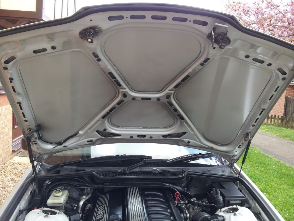

                      HAD A FEW WELL QUITE A LOT OF BEER AND FAGS AND THOUGHT FUCK IT CARRY ON WITH OTHER JOBS I SHOULD HAVE DONE SO LETS GO AND RIP THAT POXY ENGINE BAY COVER SHITE DOWN AND HEAR THAT DAVE F KIT AND STRAIGHT SIX MORE:thumbsup:thumbsup:thumbsup:thumbsup

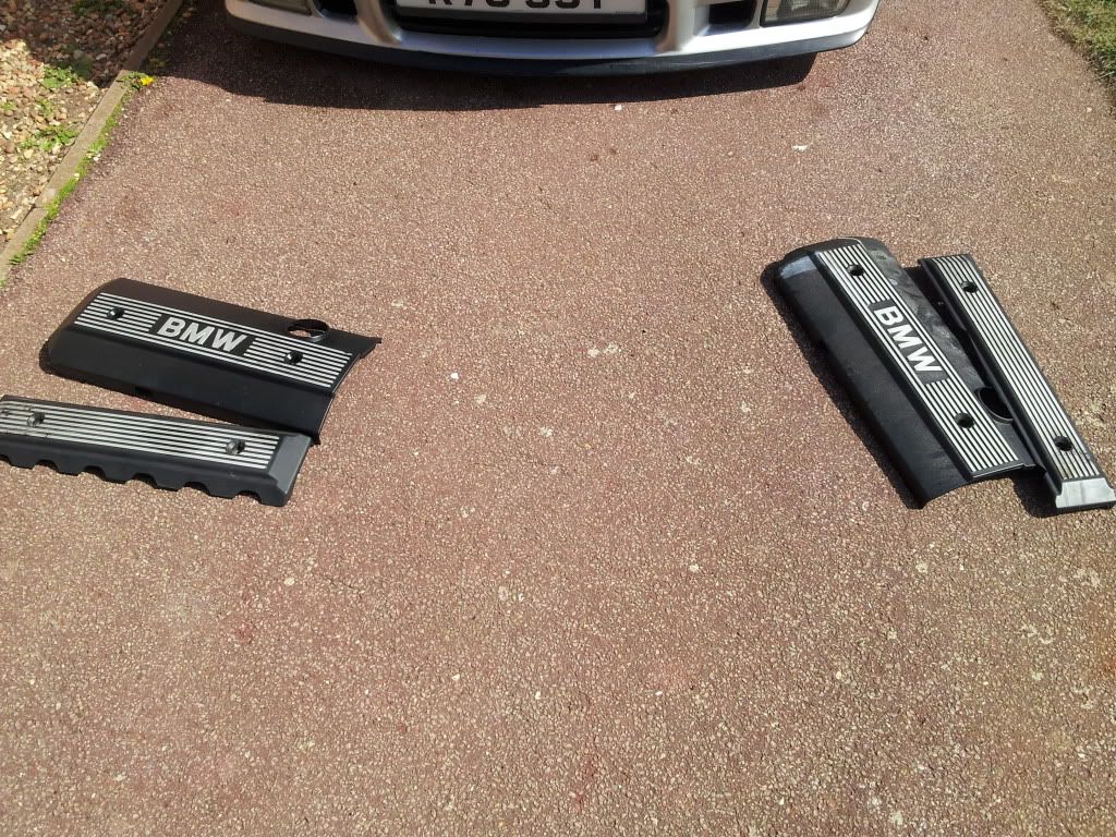

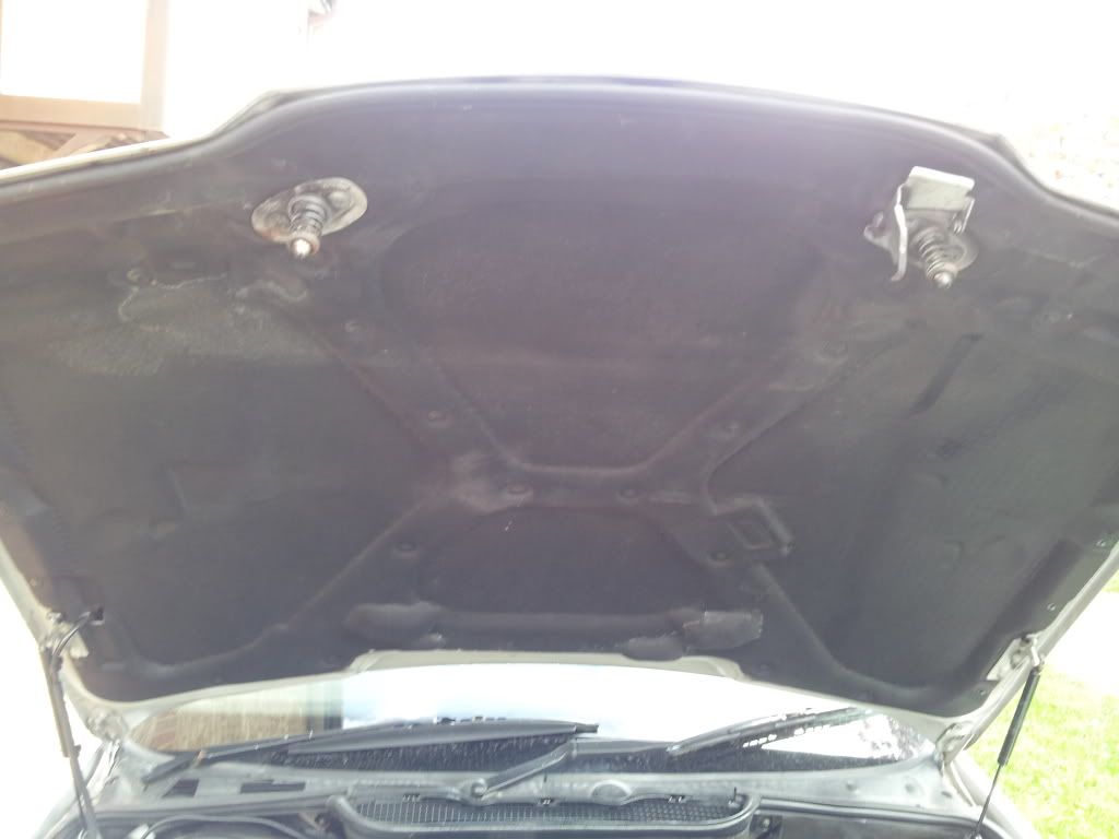

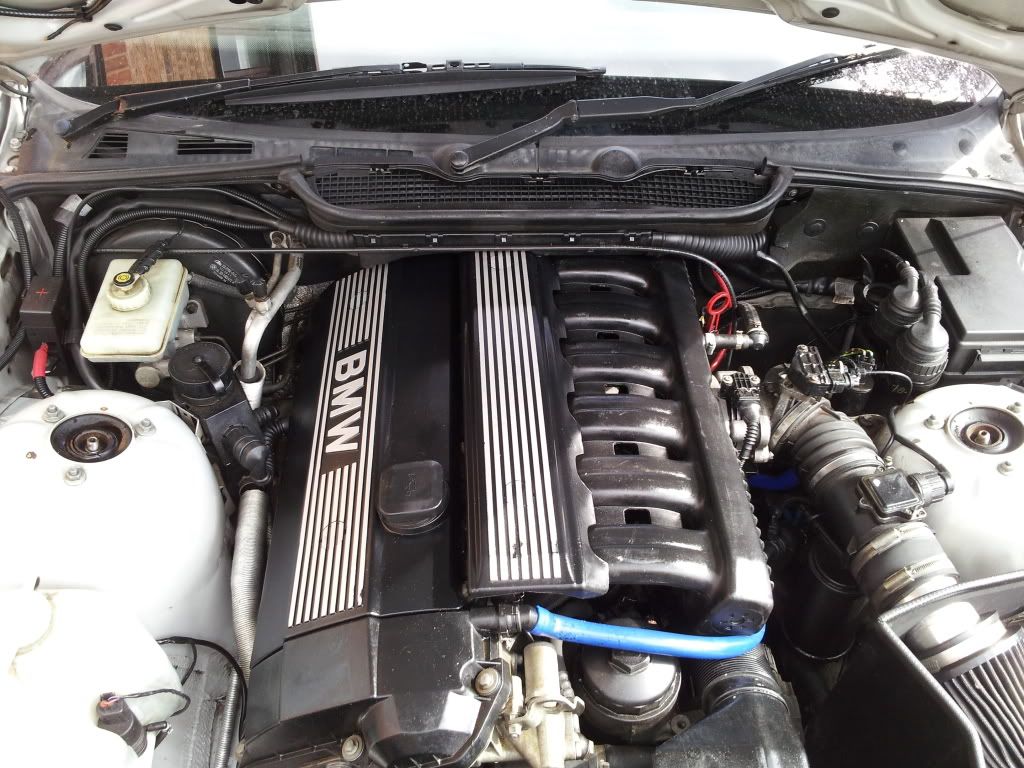

                      THEN MY AHEM OLD BATTERED TOP COVER HAD TO GO AND CATACLYSM VERY KINDLY GAVE ME SOME BETTER FITTING ONES A WHILE BACK SO SHIT GOT BINNED AND FRESH ONES ON:hihi:hihi:hihi

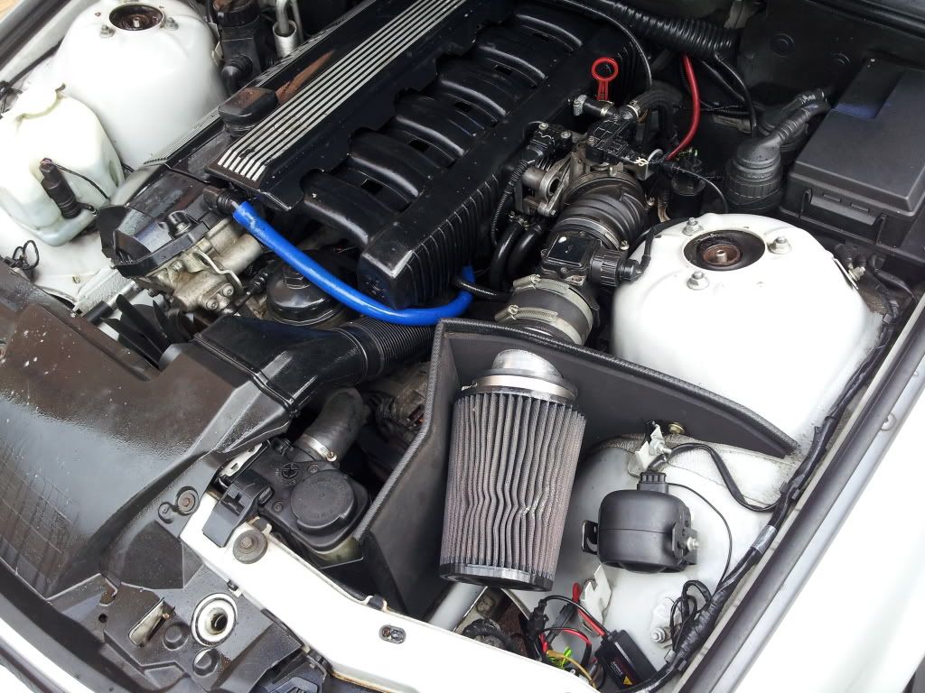

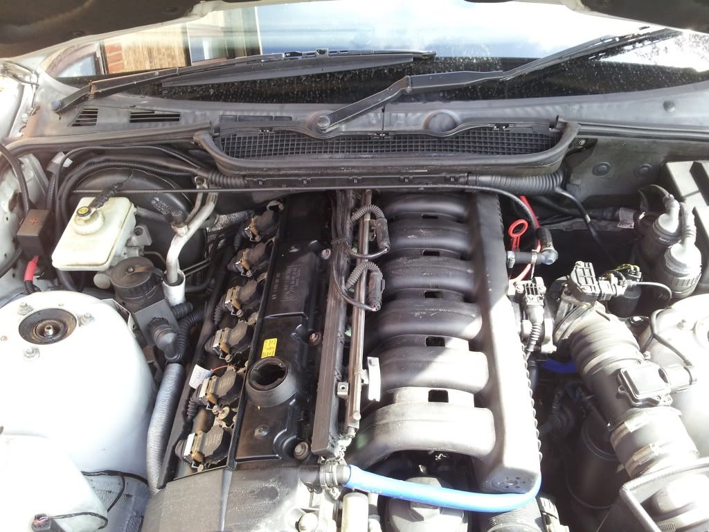

                      NOTICE M50 COVER FITS BETTER AND CHEEKY CLEAN TOO WHILST I WAS AT IT
                      8 HOURS VIRTUALLY NON STOP,ONE CASE OF BEER AND 22 FAGS AND SHIT LOAD OF JOBS AND IM PISSED,TIRED,ACHING AND FORCED TO WATCH SOME BLOODY MIDGET ANTY/DECCY SHITE AS WE SPEAK ON MY 42 INCH PLASMA BY THE WIFE
                      TO BE CONTINUED

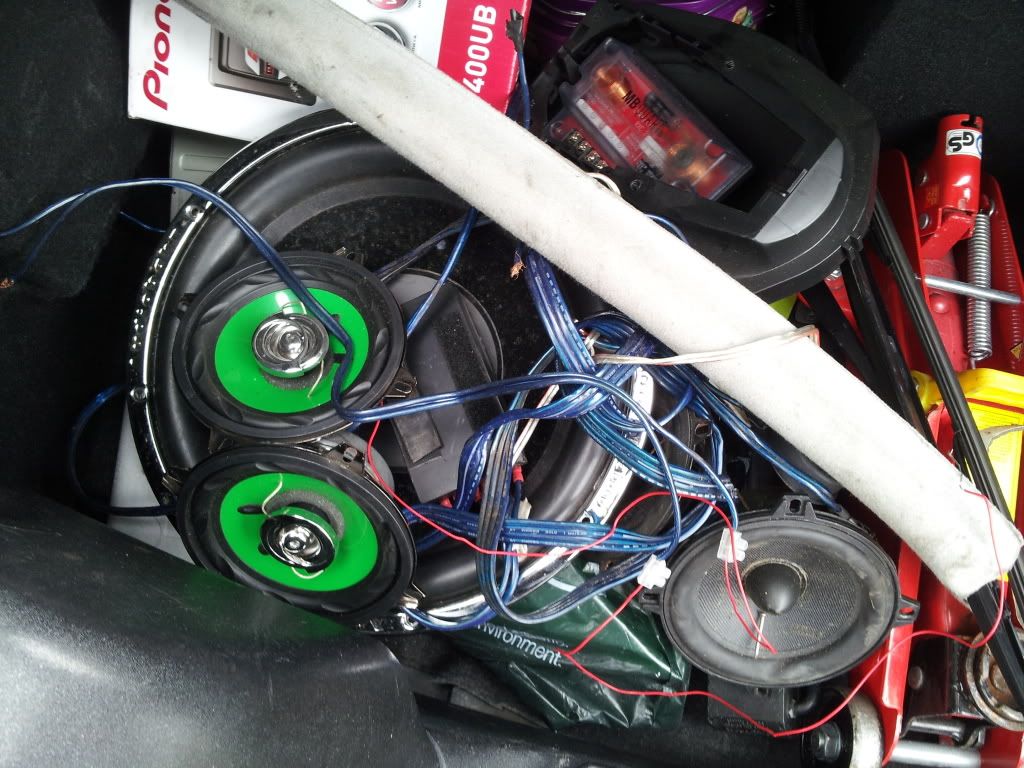

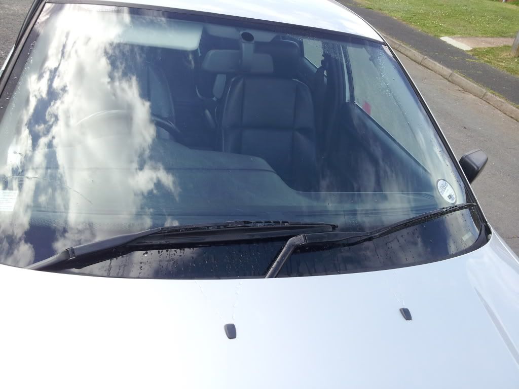

                      • More bits arriving to hotel de spirit off kevin rout and uber cheap as mates rates
                        so for 20 quid i got...

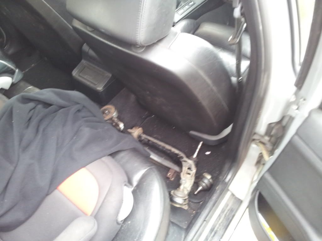

                        2 new wishbones kev bought but never fitted(remember i bought a drivers side brand new item not long back so passenger one can be replaced too
                        2 replacement window wiper arms off a coupe and we modded these to fit as they normally i led to believe are different size...well mine was now with bosch aero wipers(eagle eyed peeps will notice my old arms had some rust corrosion on so binned them as it bothered me

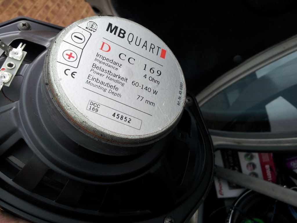

                        2 new spx 5 1/4 inch speakers-wont use these im selling them on again i think
                        2 focal 5 1/4 inch focal components with tweeters and one jbl as one of the focals has a slight split on the surround inc crossovers-focal
                        2 6x9 mb quart 6x9s inc hangers-will get these on a replace my 6x9s as they are quality kit
                        2 mb quart crossovers
                        various wiring
                        another 12 inch audiobahn 1400w sub-kev said it didt work but i think i know why:hihi:hihi:hihi:hihi:hihi:hihi

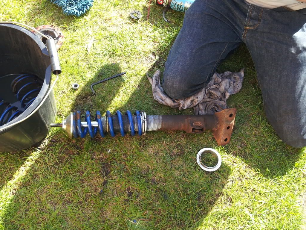

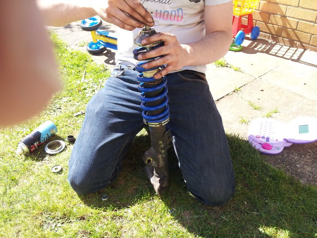

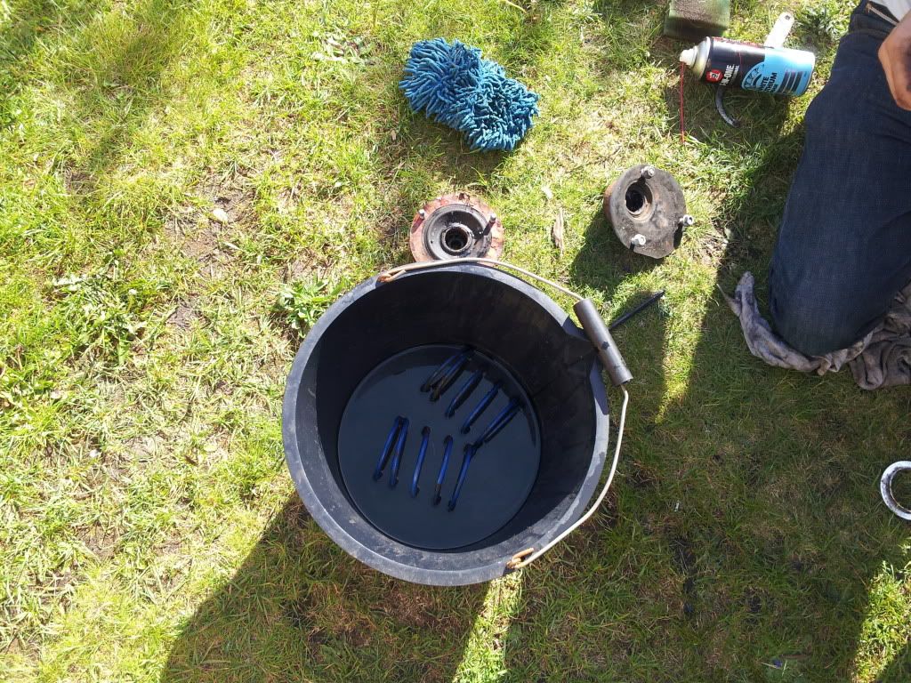

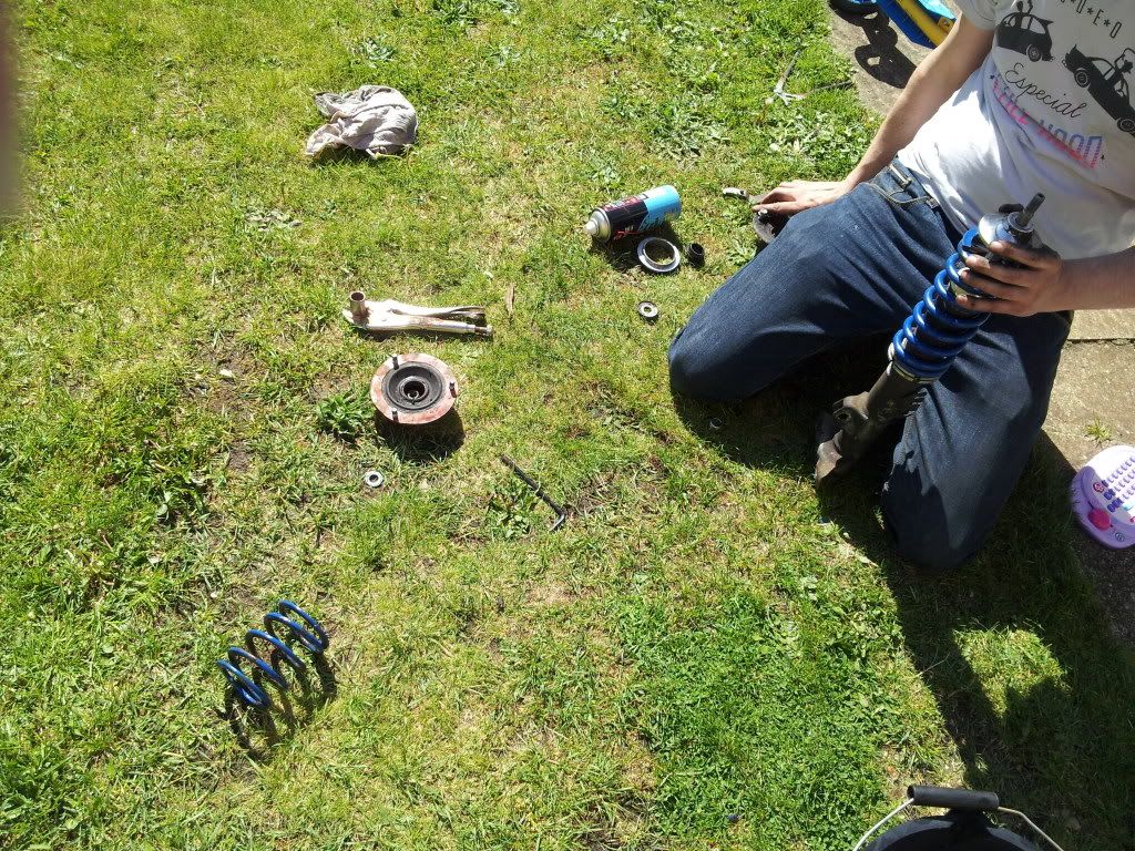

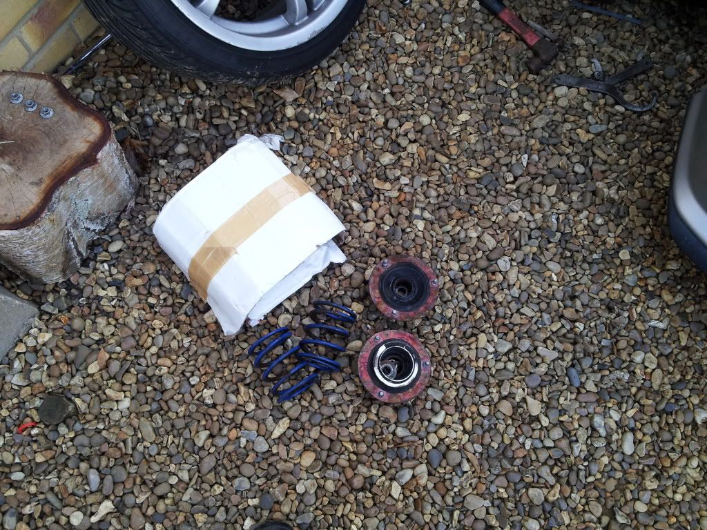

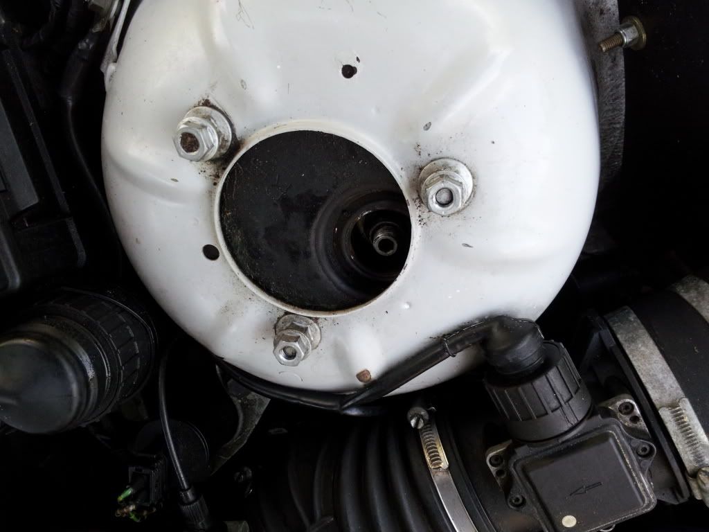

                          • Right an update and really really happy with basically a relatively easy mod namely -removing the helper springs and fitting m3 evo top mounts thanks to me old mate lenny with the stanceworks e36 328 on here and disco stu helping on the phone with excellent advise as always.

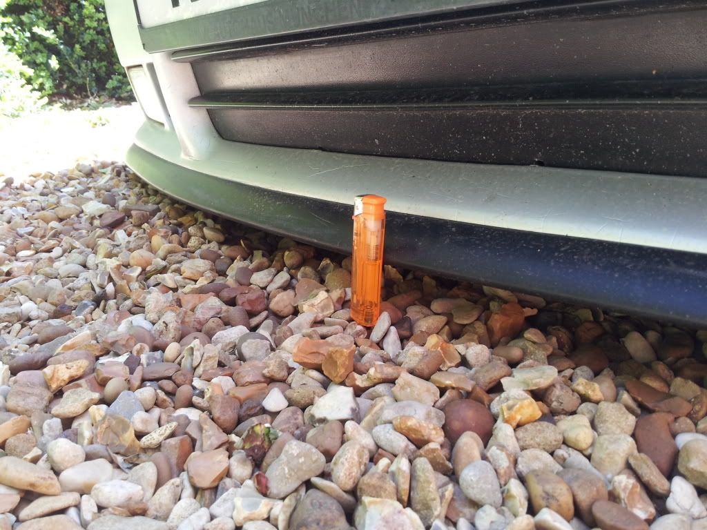

                            RIGHT THIS IS MINE AT THE ABSOLUTE LOWEST SETTING WITH THE HELPERS STILL IN-NO PHOTOSHOP THIS IS MY DAILY RIDE HEIGHT

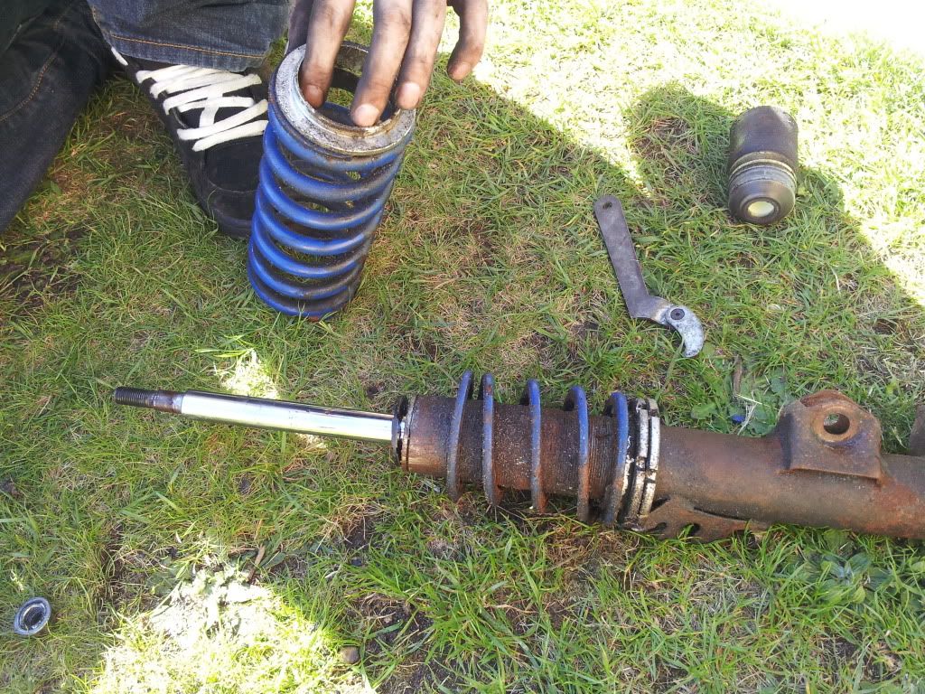

                            Recently i decided that i wanted the best of both worlds so slammed at shows and better everyday handling or track days yet always felt the front needed more lows to really get the look i wanted so as i raised the rear for more rake or nose down as some know it as and the only way to do this was dump the helper springs on the coilovers to give me the extra drop required(disco stu also has this done in the past)yet still have a safe ride and also better adjustability.
                            As i have bought some m3 evo top mounts we decided to reverse mount them(lenny was not sure at first but i persuaded him it will work)i took some pointers from drifting threads as they do for extra -3 deg camber and some castor for more front end grip and the car handles so much nicer now and seems quicker on turn ins:thumbsup:thumbsup:thumbsup
                            basically right goes on left and left onto right-hence reverse mounted
                            some pics
                            old top mounts were shagged and bearings destroyed so lets bin them for a start :hihi:hihi:hihi:hihi
                            lets split them coilovers and bin the helper springs
                            and the shits gone
                            and some shots of how the coilovers look without the helper springsso much more cleaner looking too and all cleaned up and fresh grease put on
                            final look in-didnt fit the covers couldnt be arsed if im honest
                            Car is actually 2 inches higher than before due to work purposes as ive started my new job and certain locations are proving too tricky to park so i will drop it before dc13 and show more pics but as said ride seems better and ride quality i think has improved and the front camber is insane compared to before but will leave the pics for now till im happy with the look
                            Thanks to everyone who has helped with bits,time, comments ,honest opinions and especially the norfolk crew who have always been there when ive needed it cheers guys really means a lot
                            will do some pics when i get time
                            Andy
                            • Have you thought about painting the coilovers? Ashame you left all that rust on them, especially since you had them apart anyway.
                              • Originally posted by Nixxon View Post
                                Didnt take pics but yes I treated the rust and cleaned them up.
