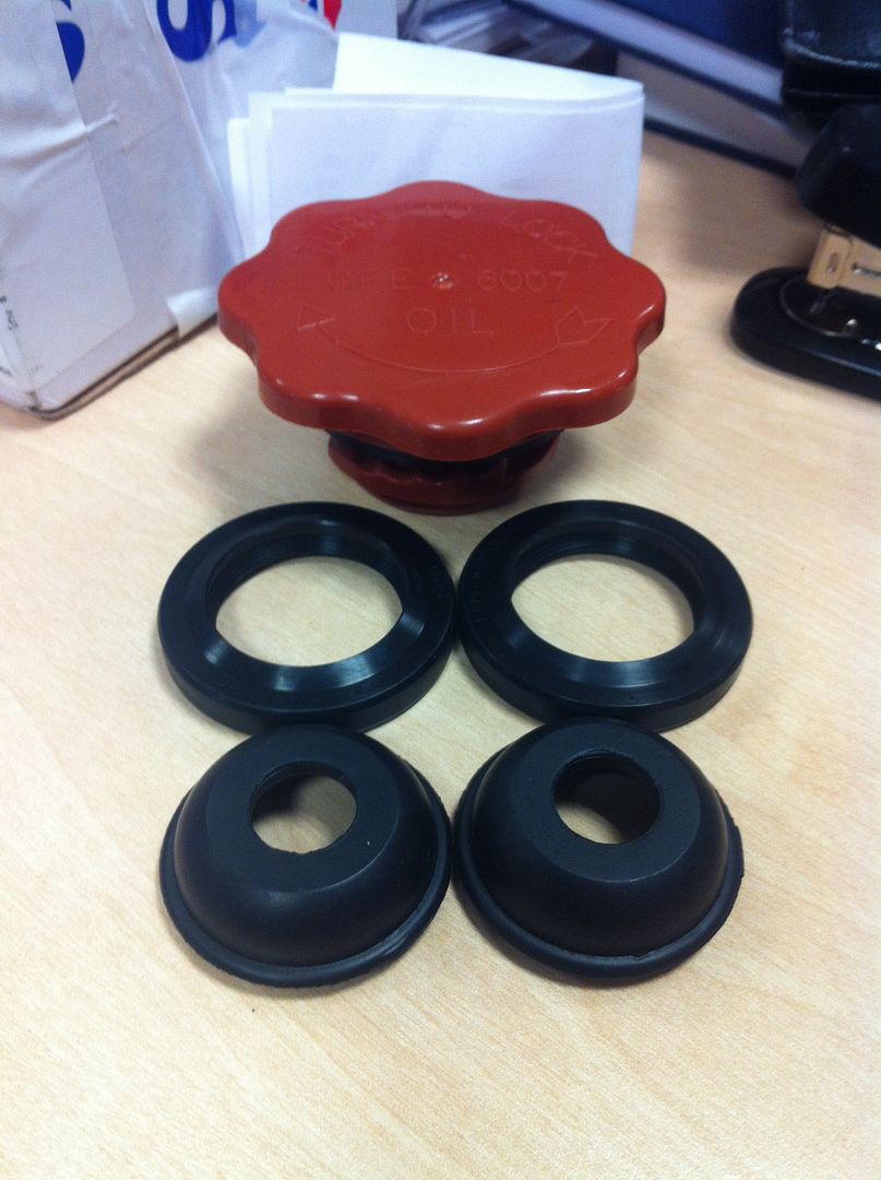

    MiniSpares order arrived. All fitted and working well. Diff to driveshaft seals, ball joint dust covers (old ones get destroyed splitting the joint on removal), rocker cover oil cap (managed to snap my old one by leaning on it) and out of shot, fibre washers for the oil pressure gauge line for the unions at the block and gauge.
    Fitted up ready to go. Old diff seal had a small split on the ID hence the leak. Hopefully this one will last a wee bit longer!
    To do tomorrow, fit a 12v socket for the sat nav/phone chargers, make sure all bolts on the suspension are free for the hunter 4 wheel alignment at Reidline on Friday morning and check fluids ready for the Thistle Run on Sunday!

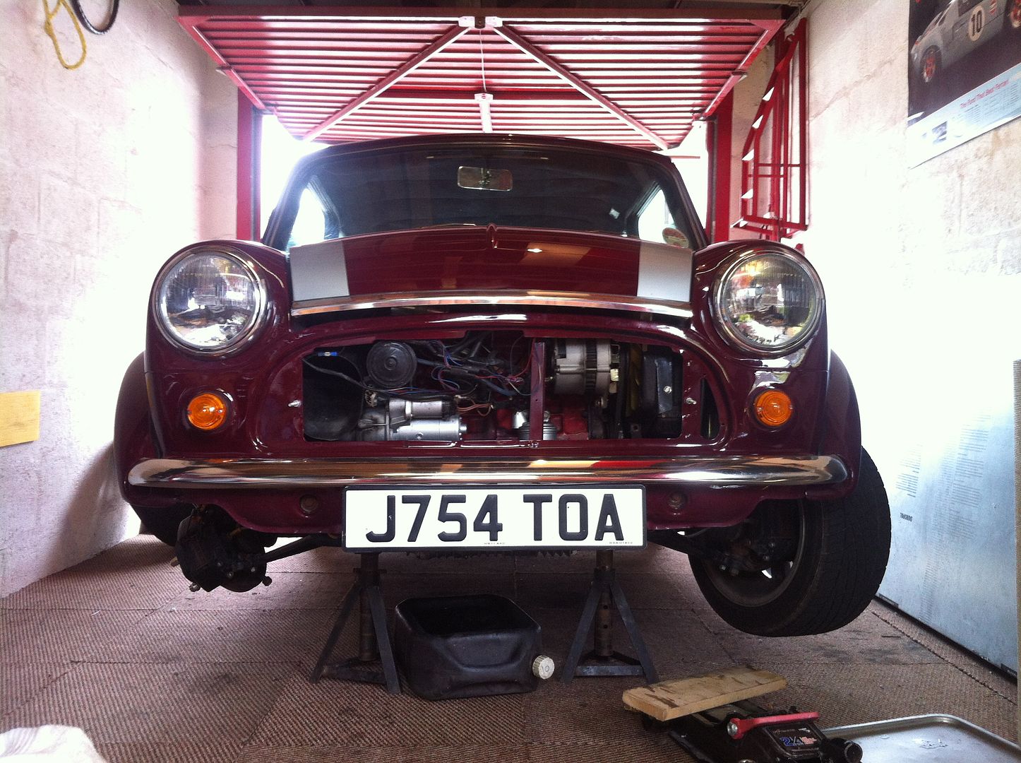

    Located a wee oil leak. Driveshaft to diff seal. Leaking onto the pot joint and spraying oil all underneath the car and up the back of the engine. Lovely! I needed to redo the engine bay ancillaries paint anyway but this has ensured that the bonnet stays shut for shows for this season as its a mess!
    Waiting for parts to arrive (few other bits and pieces thrown in for good measure) but got it ready for the change today. Split the ball joints to release the hub, split the pot joint from the diff and bungeed in place. Quick swap of the seal and back together in no time some night this week. Hopefully sorts it!
    Few other little issues. Bonnet catch refuses to close properly (easy fix) and found a fair bit of swarf on the sump plug. My guess is its coming from the gearbox. It crunches into third up and down the box so I think its starting to take its toll. Drained the oil for the diff seal anyway and fresh stuff will go in. Was going to be changing the box before IMM anyway but hopefully it doesn't damage the engine too (why did they have to make the A series share oil between engine and box again...?) If it does damage the engine, I guess it will be time to go 1293/1340 far earlier than anticipated :lol:
