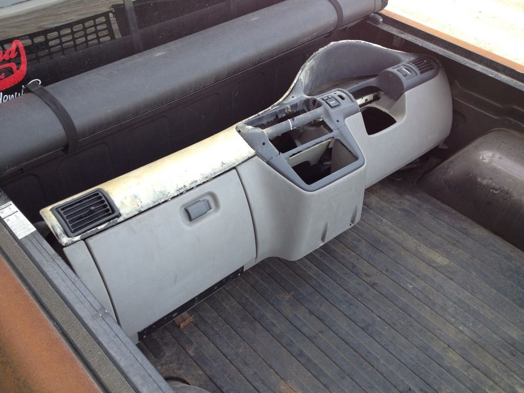

              I also dropped my dash off Sunday to be dealt with.
              Can't wait for it not to be an ugly piece of doody.

                    • You doing anything special with the dash at all??
                        The radio bezel is getting massaged pretty heavily, the dash and dash pad should look factory, though.
