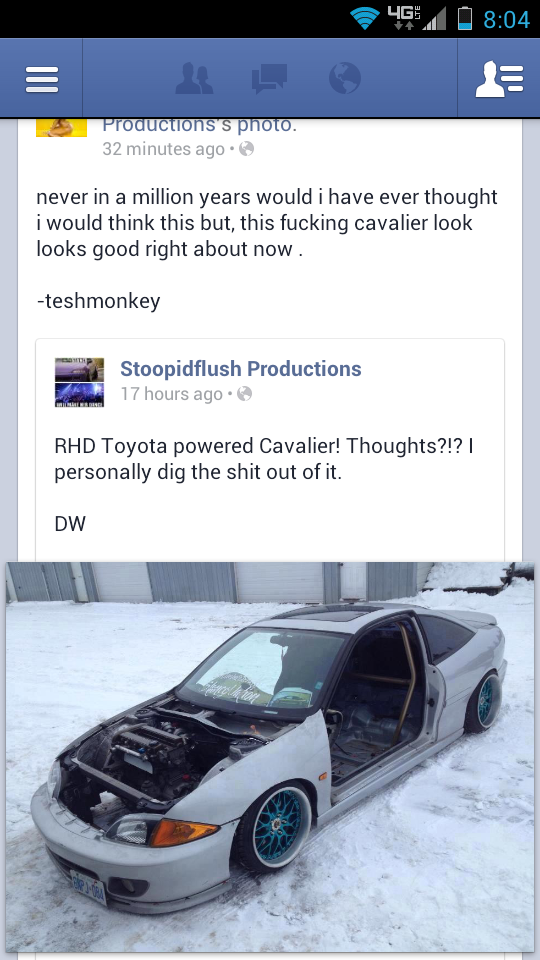

Originally posted by KielanWell dip me in shit and roll me in breadcrumbs...
lol. Toyota powered.

You and me both, man. I have a hard time putting the bumper cover on.Originally posted by andybob View Postlol. Toyota powered.
Looks really good man. Love how wide the wheels look without the bumper.
False.Originally posted by 244Brick View PostIsn't it a Toyota with a Chevy bow tie?
Could be true, stop yelling at me.Originally posted by Stupid Kid View PostIts actually full GM, it was sold as a Toyota in limited numbers in japan. It was sort of a trade for chevy rebadging the corolla as a geo prizim if i remember correctly. I think chevy got the better end of the deal haha.
What this guy said. hahaOriginally posted by Stupid Kid View PostIts actually full GM, it was sold as a Toyota in limited numbers in japan. It was sort of a trade for chevy rebadging the corolla as a geo prizim if i remember correctly. I think chevy got the better end of the deal haha.
Cavaliers were sold in Japan with a Toyota badge on them. XD
Kinda like how the Mitsubishi 3000GT in the U.S. also came in the form of a Dodge Stealth. :P
Proof:
It also states this on wikipedia. hahaha
