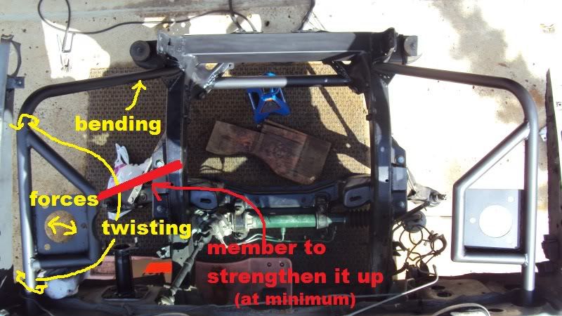

        so today was a great day, and i got the shock hoops completed!!!
        airel view
        hi, as with my earlier advice, please take this as constructive and in the interests of your safety and the longevity of your truck - please add more strength to your design, as this current setup looks like it will flex and probably won't last (in my opinion). at the very minimum, please add structure that ties the inside edges of the 'wings' (the strut tops that come inwards from the hoops) to the chassis, to prevent the twisting that will occur in the hoops under loading. doing the whole lot in larger diameter tube would have been more ideal, but adding strength to what you've built now, at least you won't need to re-do it again. also adding a strut brace will help with strength/stiffness too.
        also, is your body solid mounted to your chassis, or still rubber (oem) mounted?

        • hope this helps and you don't mind my input. here's how i see it:

          • Originally posted by 340i View Post

            got a little done in the fucking rain today
            gussets yet to be welded
            and the shock top hats are not finished they will have additional tube braces to support them with a bolt in cross bar over the motor tying the shock hoops together
            thanks for your concern but i already stated that i am adding additional cross bars over the engine.
            I'm no dummy
