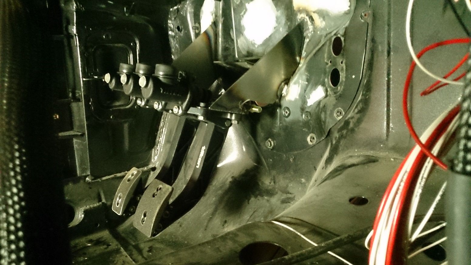

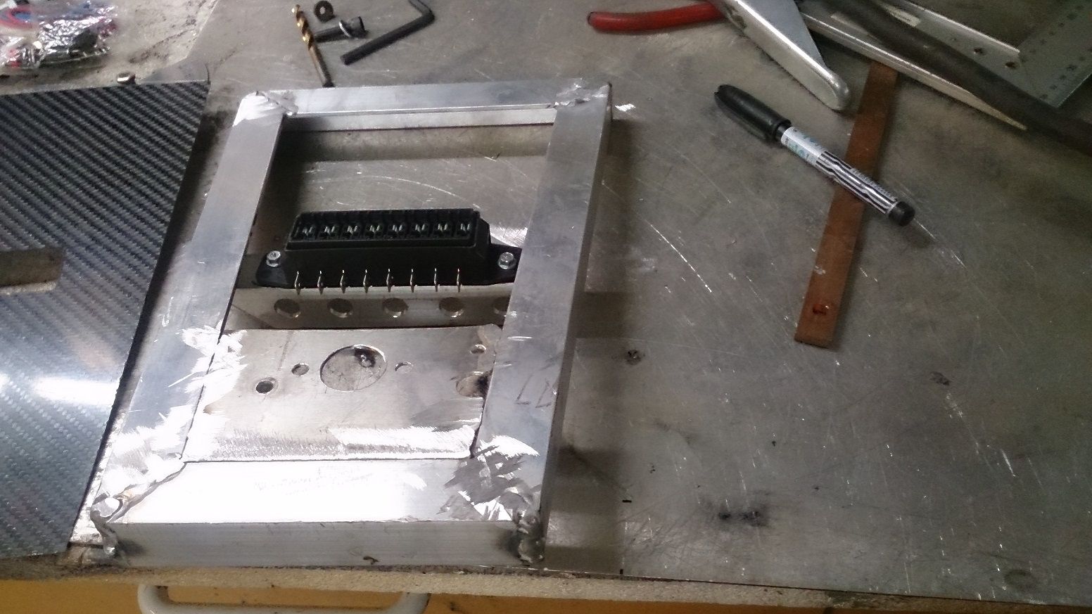

    • center consol made of a alu frame with a carbon sheet!

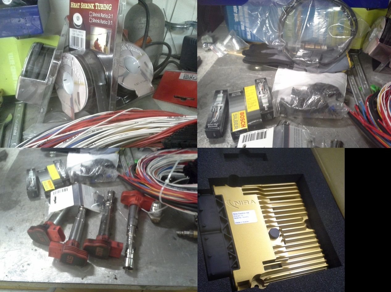

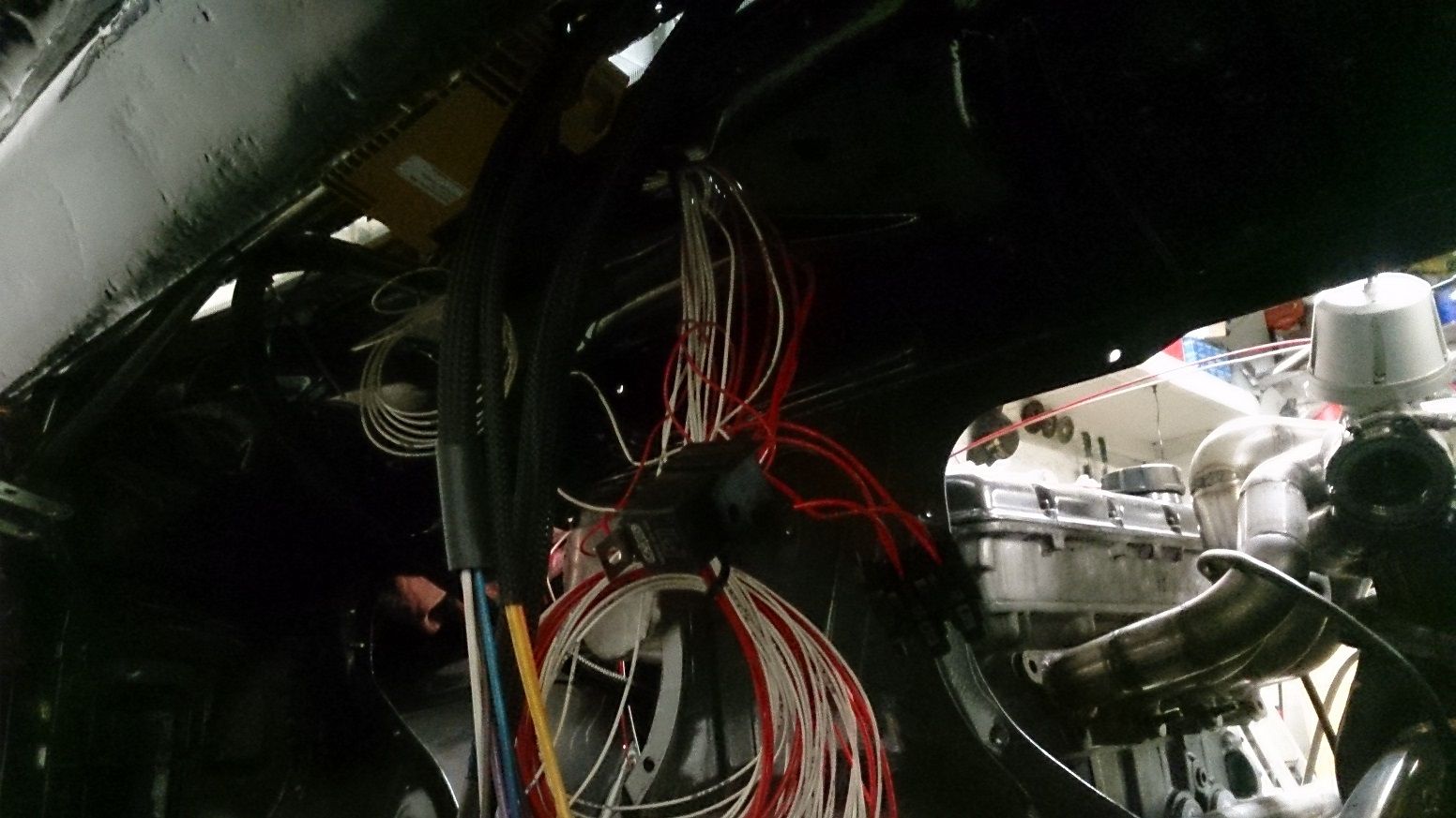

      also, finished laying out all cables for lights, fans, servo, waterpump etc! hope to get some connectors in the mail soon, i orderd some Superseal connectors from ebay a few days ago
      should probably go buy the NIRA ecu and get on with that wiring harness to..

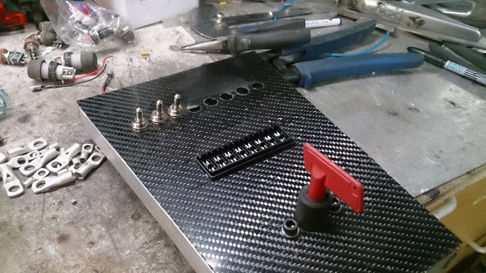

      • fuseses and switches
        and since i cant find anything to connect all the cables to, i figured i had to fix an solution myself ;P
        got my hands on a copper pice that i cut, drilled and tapped! its just mounted straight on the main switch

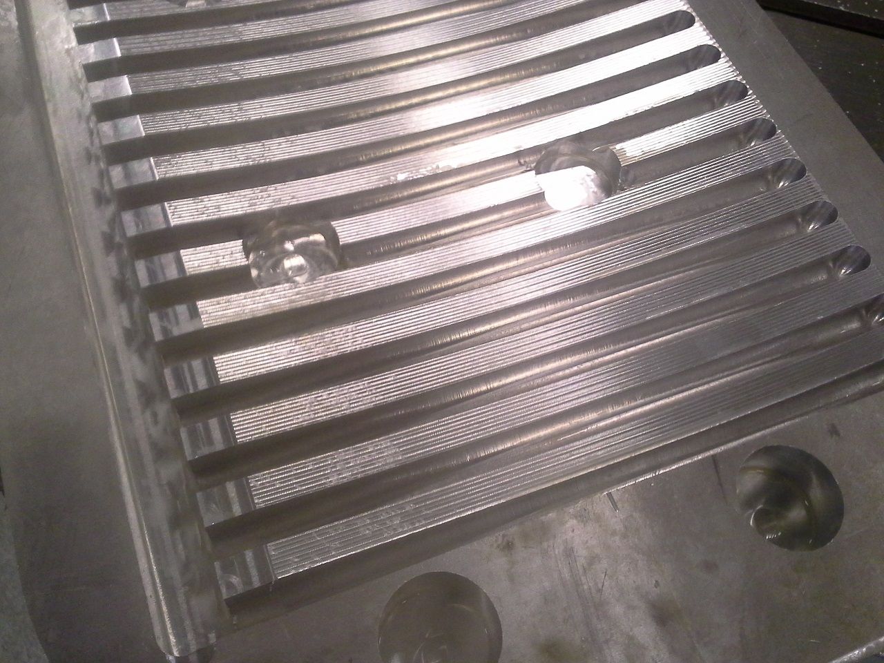

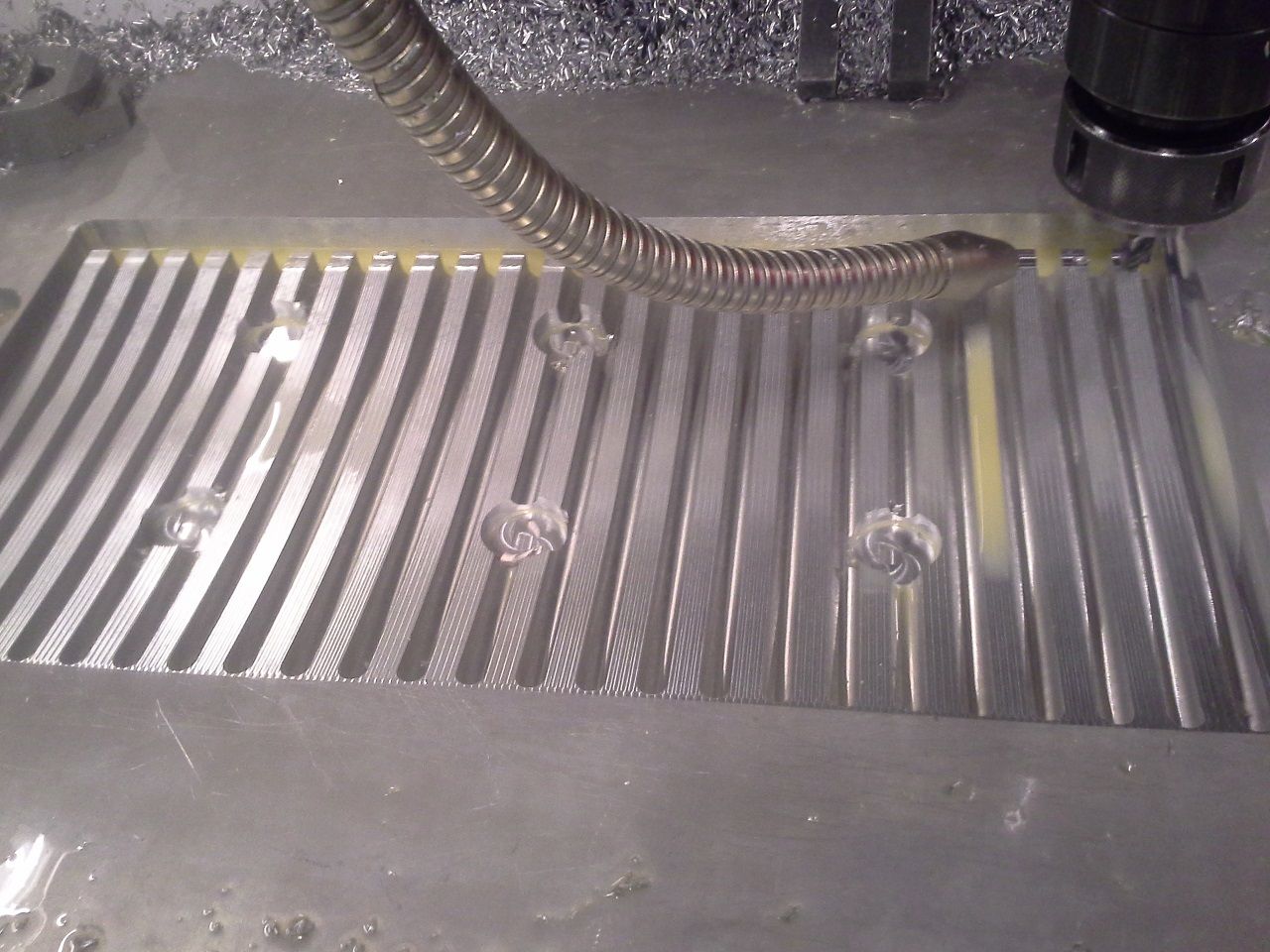

              and then i spent 12 hours looking at a cnc mill doing its magic ;P

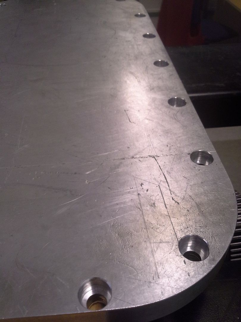

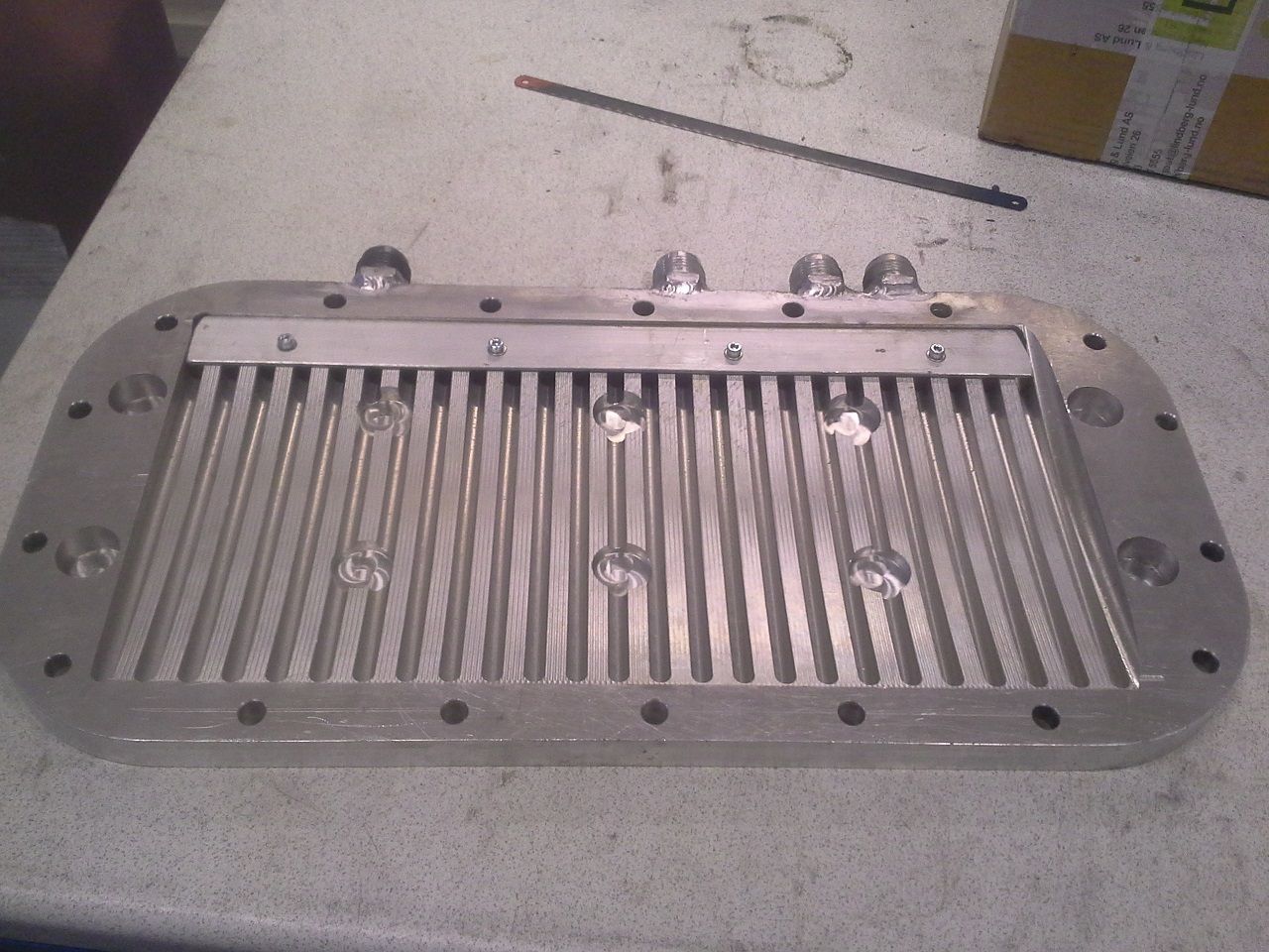

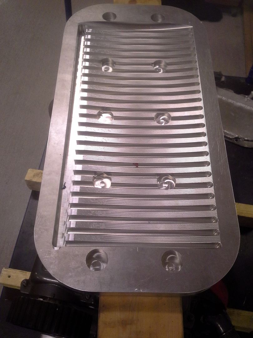

              me and a friend started making a new dry sump oil pan, only needs a plate welded in there and drill the mounting holes!

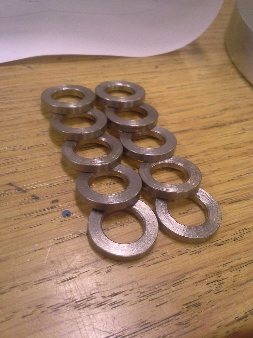

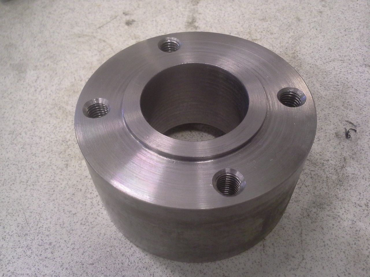

              • needed new washers for the cranckshaft bearings.. the one used was A4 steel, to soft..
                new ones was made out of some hard stuff that i have no idea whats called in english ;P
                other then that, the dry sump is finished! hope to get it mounted tomorrow

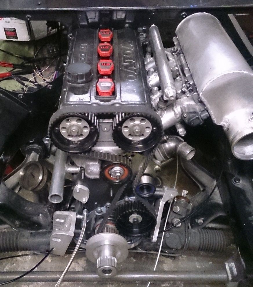

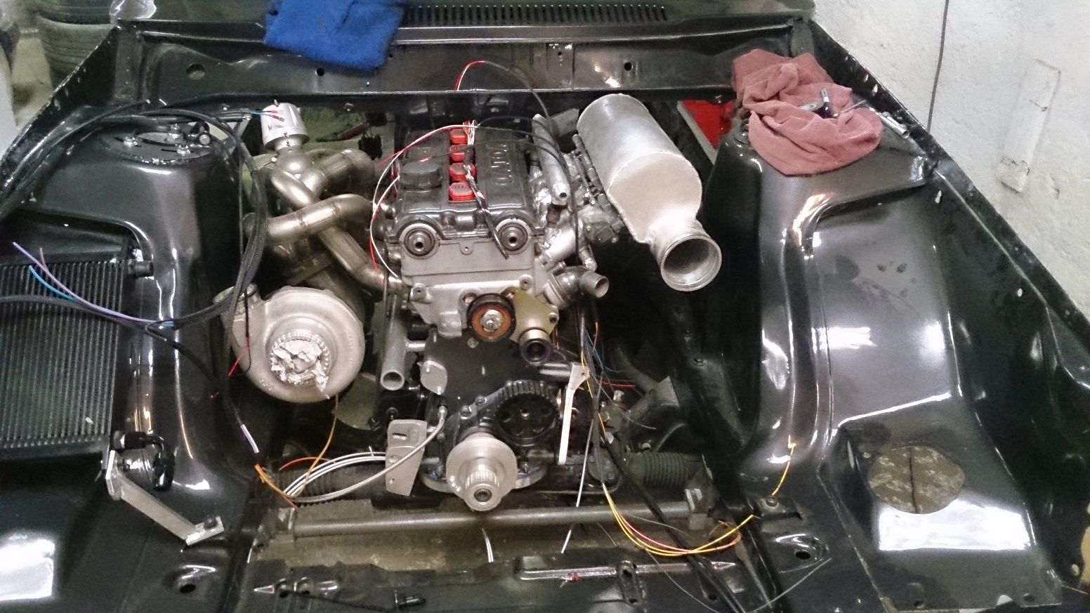

                    engine is back in the car! with the new dry sump mounted, re-tourqed head studs and i also mounted the cams etc.. pics later

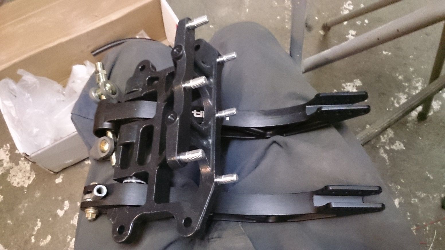

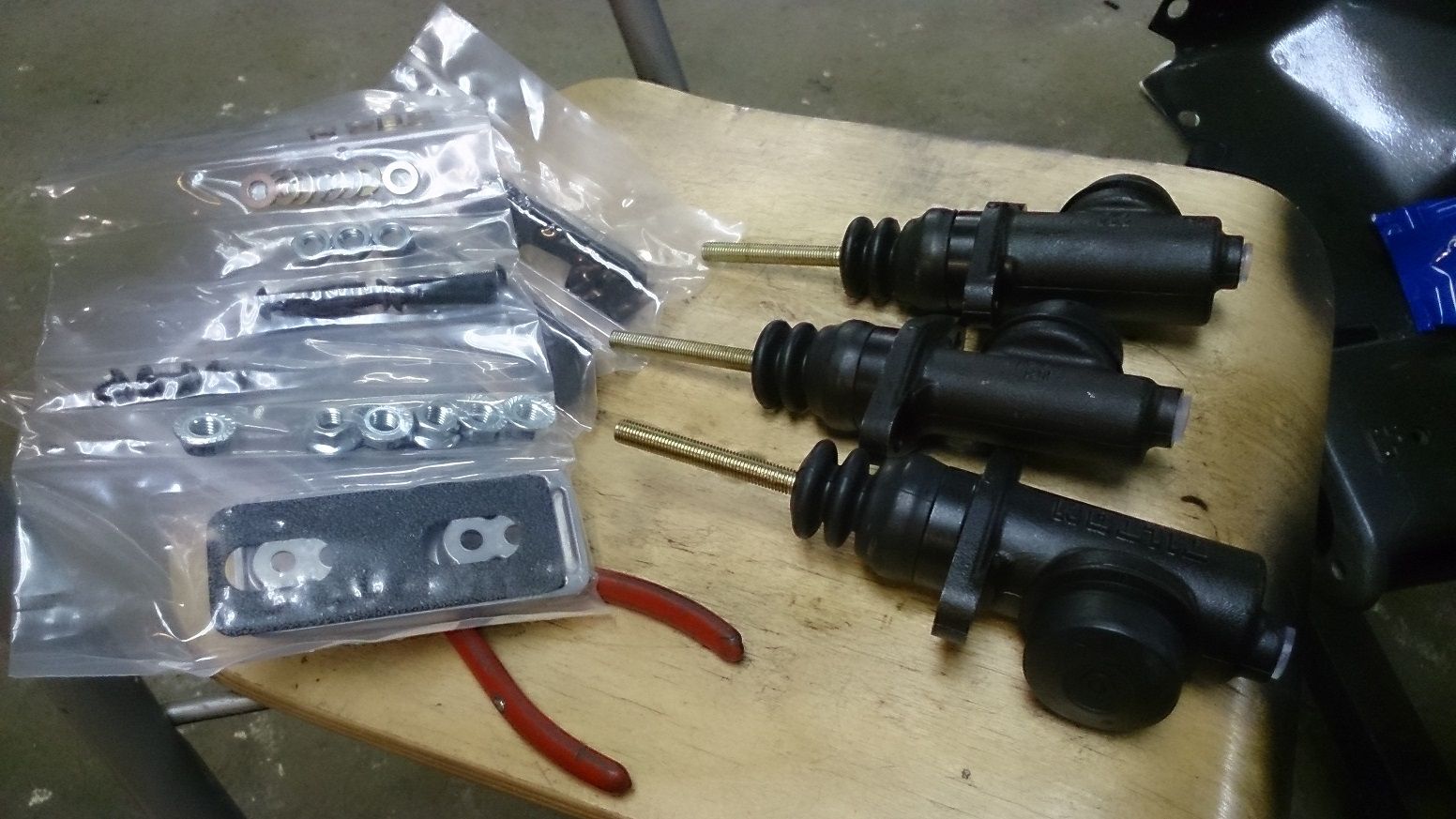

                    • came in today

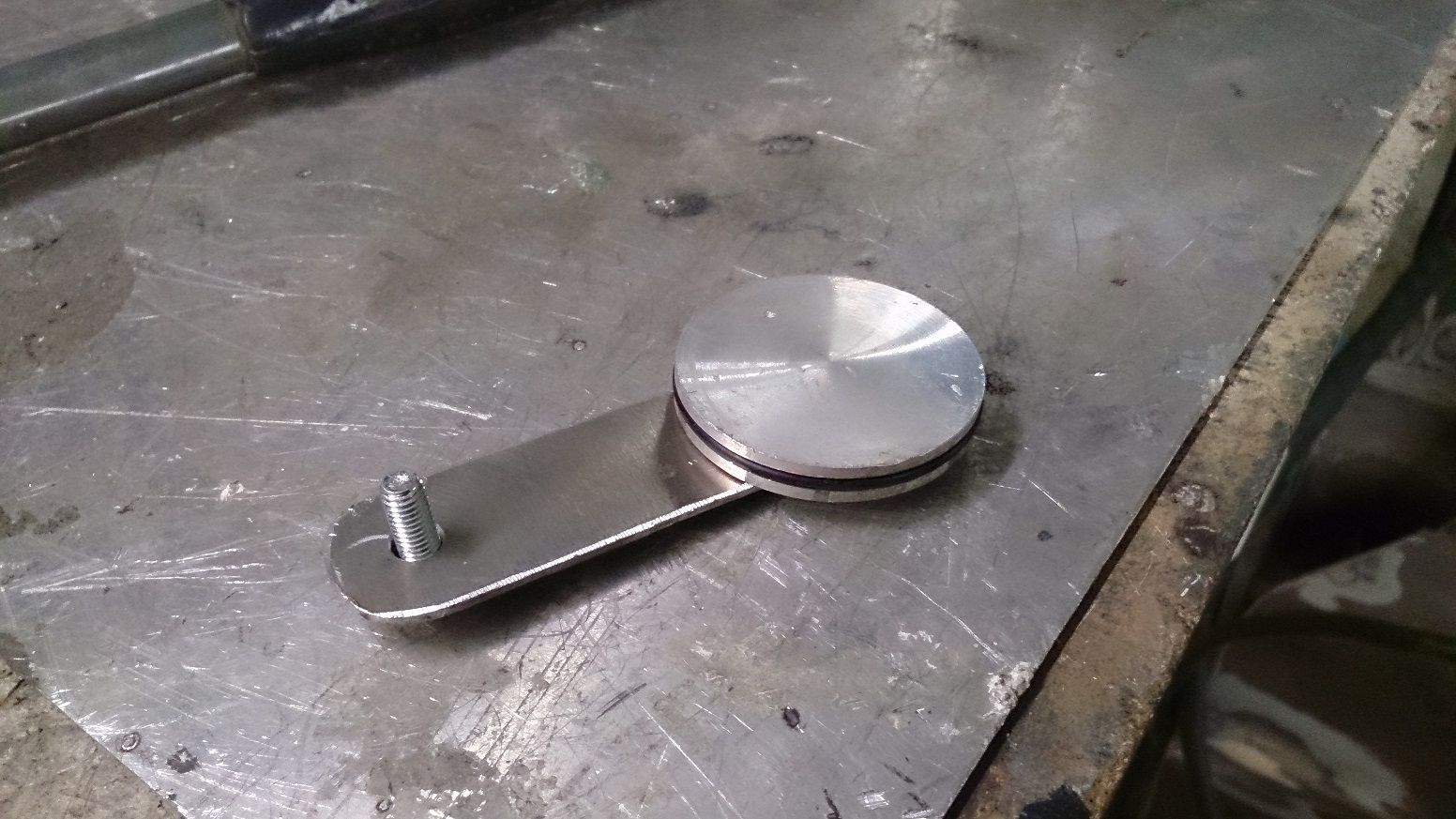

                      • had a friend make a plug for the distibutor hole on the head

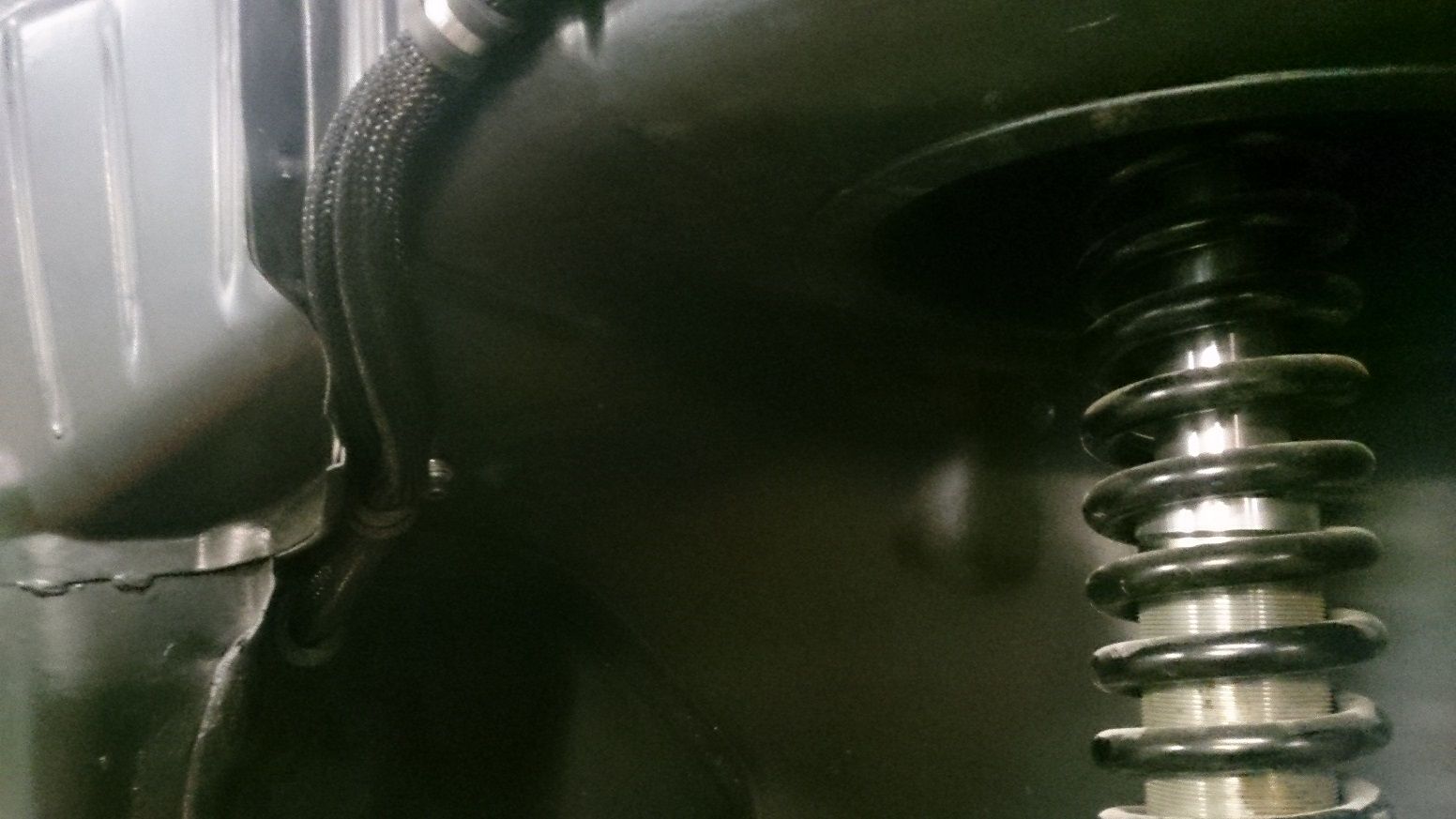

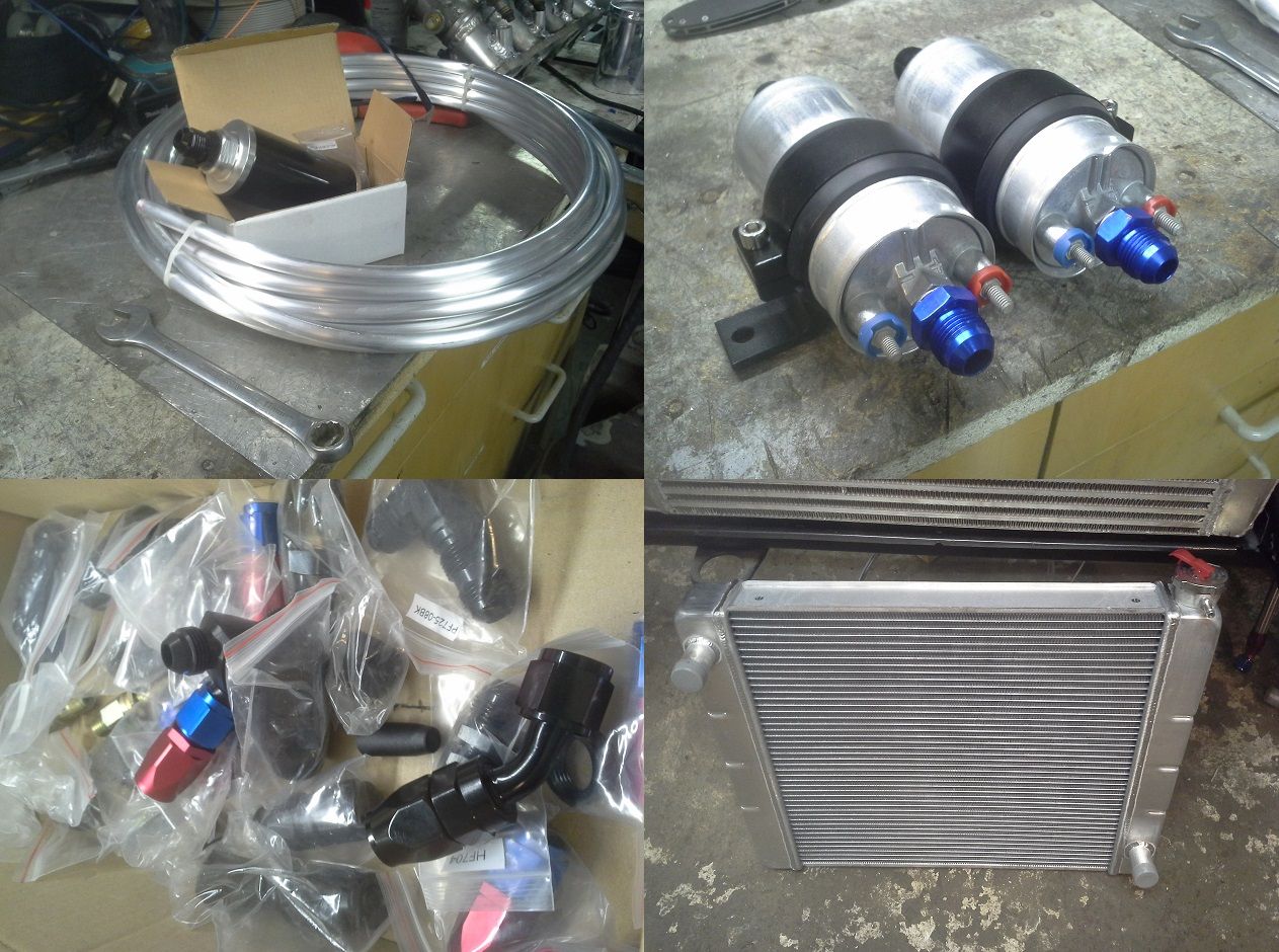

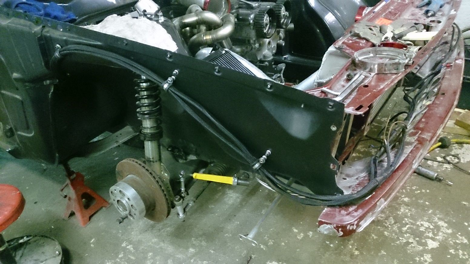

                        an other friend started on the fuel and brake lines

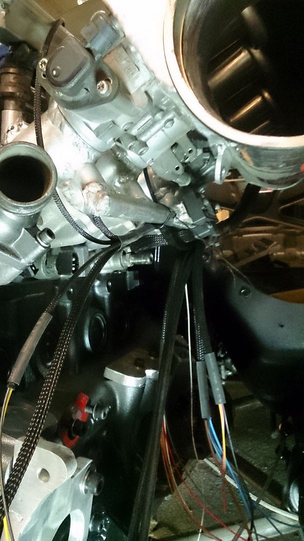

                        i messed around with the wiring harness, intercooler / radiator, mounted the head cover etc...

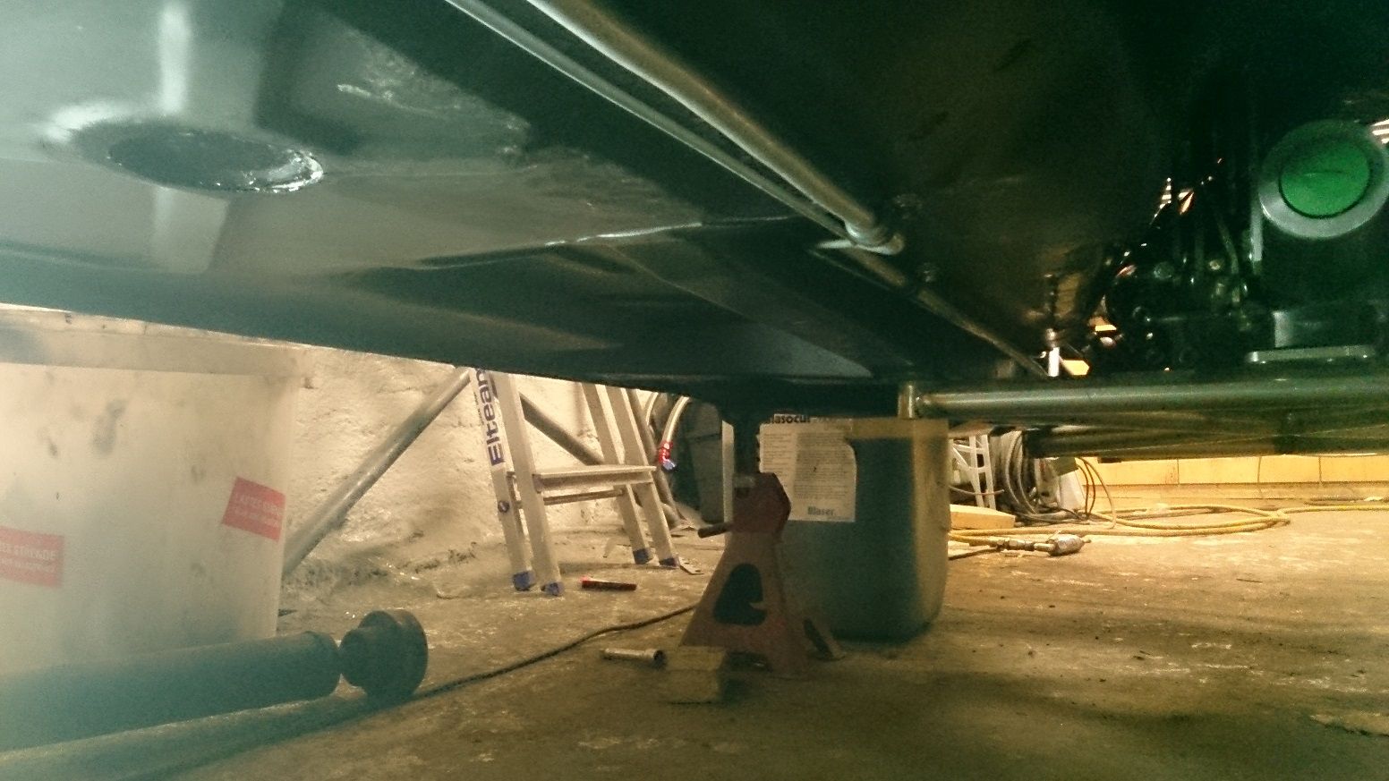

                        • so i was gonna change the head gasket on a boat engine this weekend! (not mine)
                          didnt get that far before i found the real fault ;P

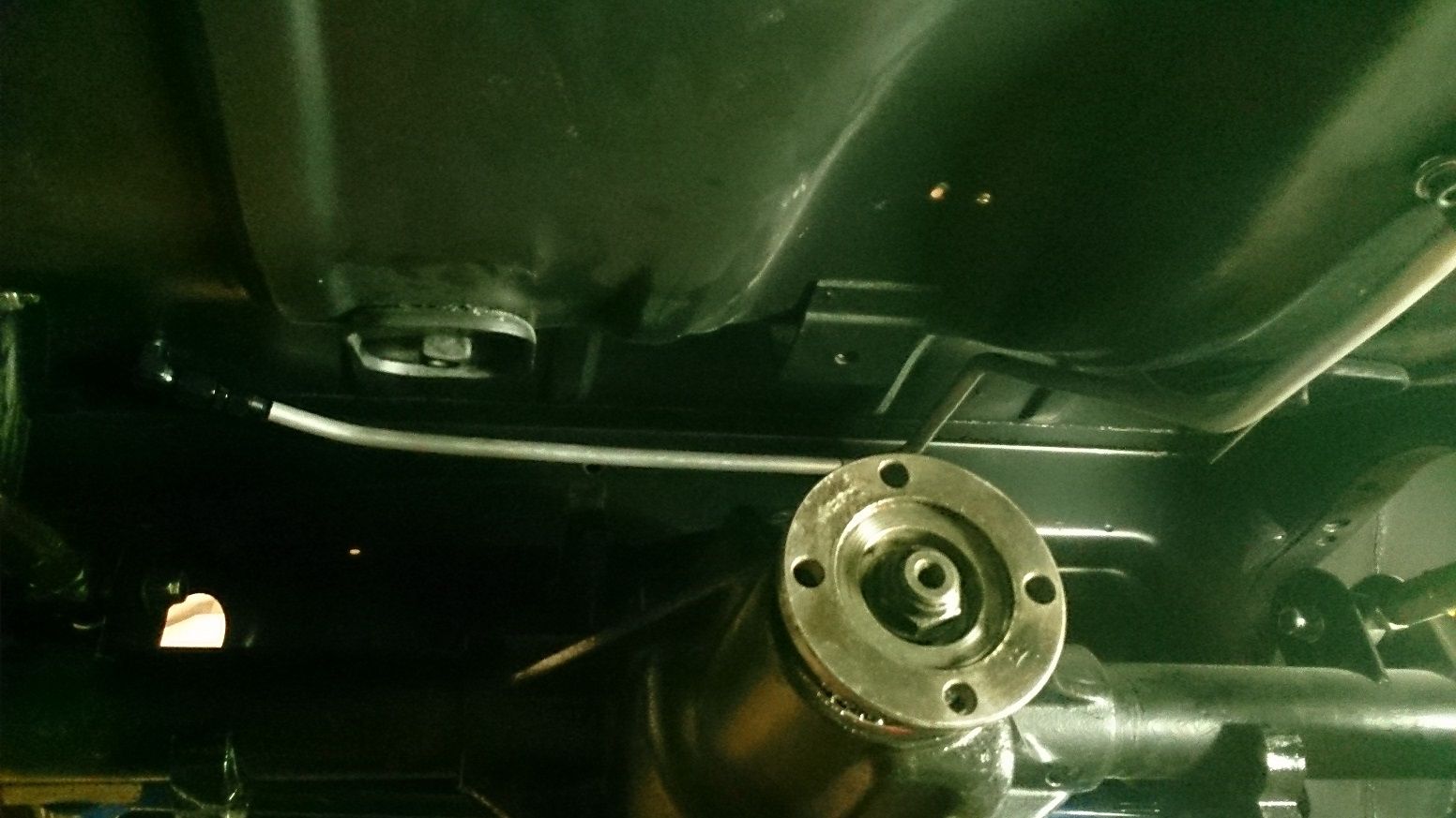

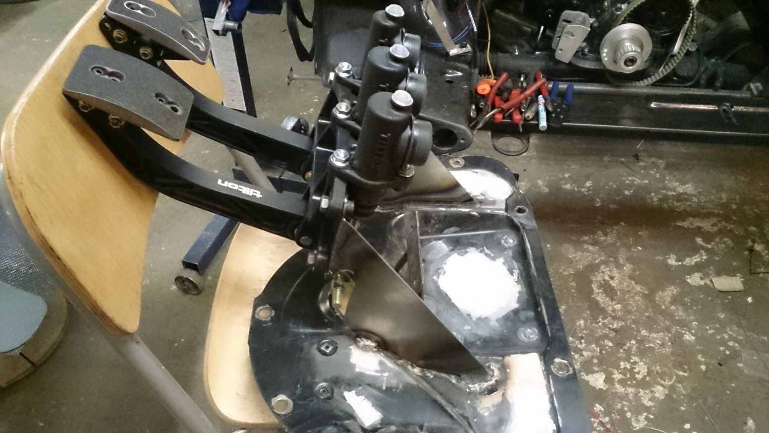

                          we made a spacer to bolt the audi driveshaft onto the volvo rear axle

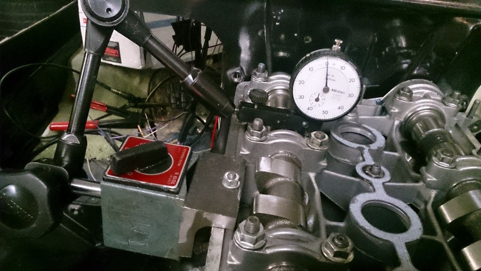

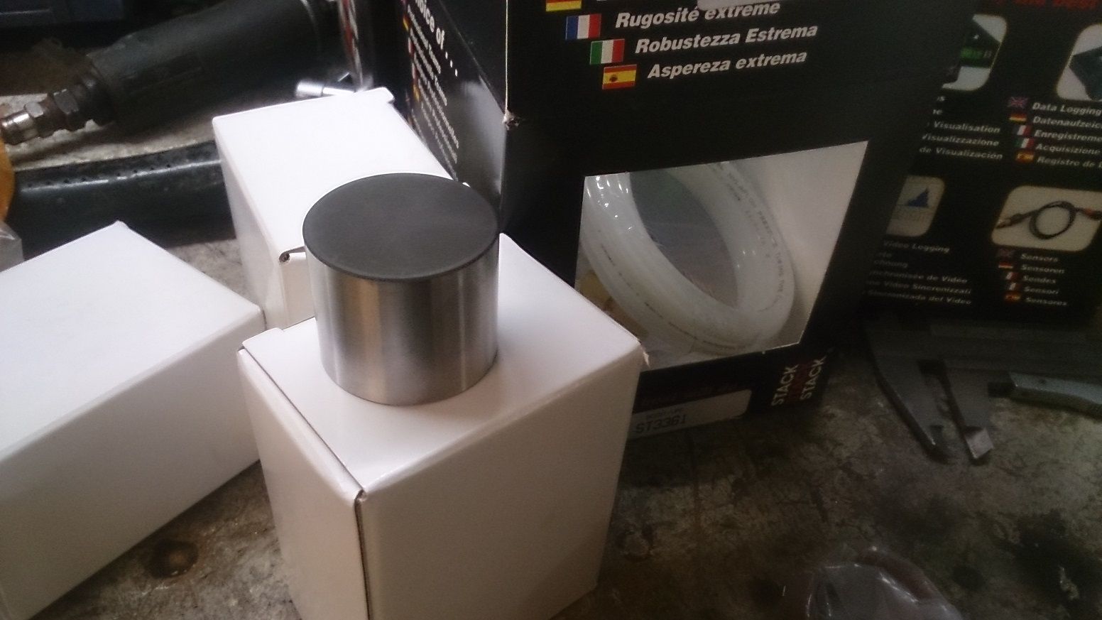

                              so, when i started to adjust the cams i noticed the cam picked up and launched the shim right out of the bucket!! So i guess there is enough lift on these cams then ;P
                              had to buy new valvebuckets, solid ones and shim the valvs with lashcaps..
                              btw, that was a lot of work o.O grinded the lashcaps to the correct clearing!
                              back on the cams
                              and on with the timing belt etc
                              also, the timing belt kit from yoshifab didnt line up with the cranckshaft gear.. had to make a 2,5mm spacer for the cranck so the timingbelt runs straight and free ;P

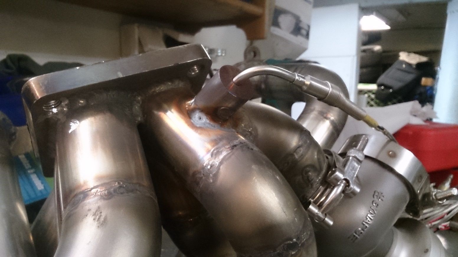

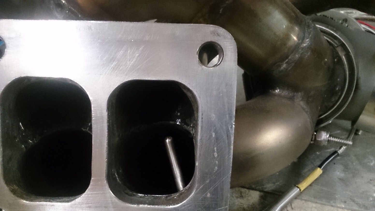

                              exhoust temp

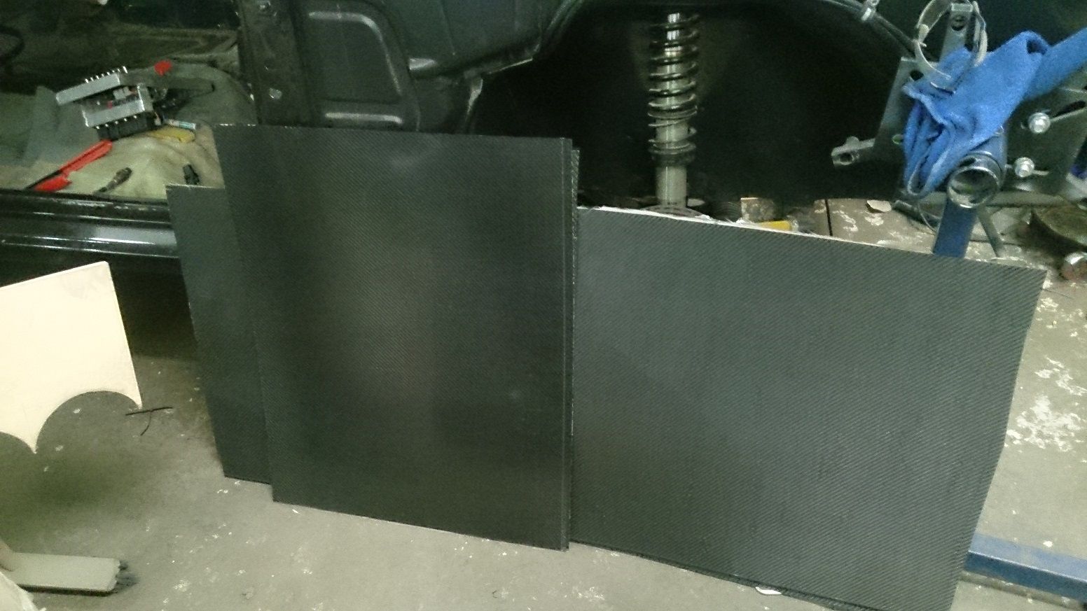

                              aaaand carbon plates for the interior
