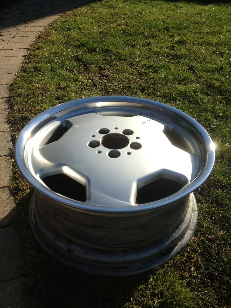

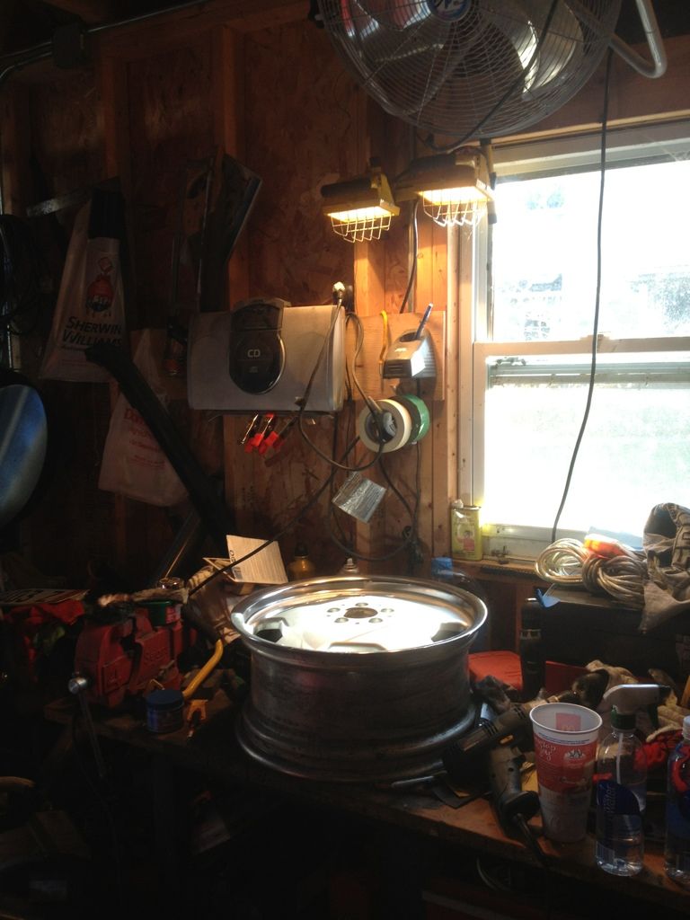

 Nice day out so I kept working on the wheels.

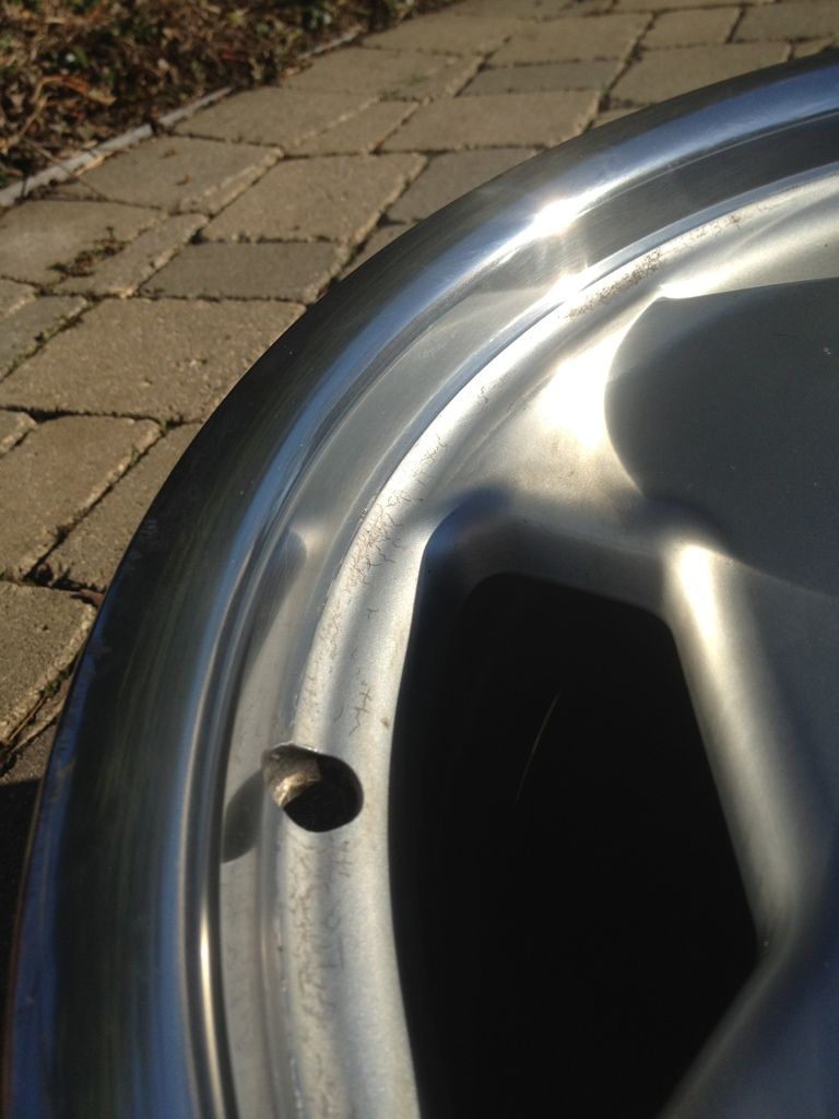

 Sanded out the majority of the rash, depending on how the others go I will likely go back and sand out ALL of the rash on this wheel, some of it is pretty deep so I'm hesitant to sand away tons of material.
 Steps
 400 dry
 400 wet
 1000 wet
 1500 wet
 rubbing compound on buffing wheel on drill
 metal wheel polish on a different buffing attachment on a drill
 hand polish using same wheel polish to get out any marks left by the machine polish
 and one of my wheel workbench, lights, polishing stuff, sandpaper, water, gloves and a lot of elbow grease!

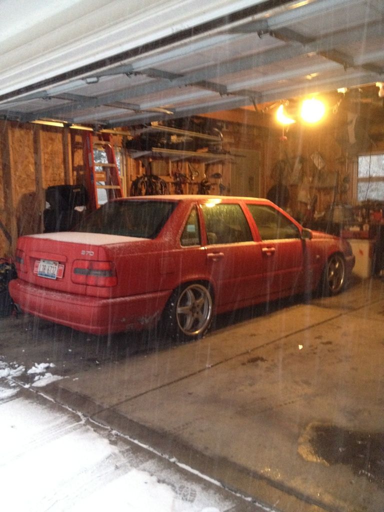

 Went to work, parked inside and got snowed on...
