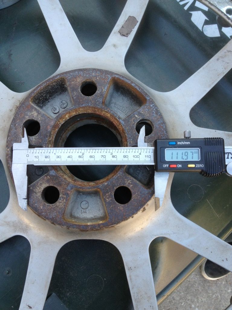

                  • Bad news... I had a feeling all along that these may not have been 5x108, the guy said they were and that they came off of a Volvo, but the idiot before my must have just had them crammed on there, not properly fitted.
                    Follow Me On Instagram! @jvc8790 #jvcphotography
                    • So they are 5x110? Won't wobble bolts work?
                      • Originally posted by DutchStance View Post
                        5x112, I don't believe wobble bolts are safe over 2mm of PCD variation. Also, wobble bolts aren't made in 12x1.75 thread pitch which is what Volvo uses.
                        At this point in time I'll probably sell them, or clean them up then sell them and save for something that is worth spending time and money on.
                        • Man, you have to measure PCD like this
                          Imagine line through all the holes and measure the diameter
                          Cheap ain't badass, badass ain't cheap.
                            That's why i said 5x110. Make your own wobble bolts, just use sum sturdy washers, use an old steel wheel, and thighten a bolt and washer with a air wrench. It will look like this \_/, and voila, wobble bolt build.
                            • I measured VIA this method...
                              Wouldn't surprise me if they're 5x110 either since these were factory options on Saab's...
                              • Re measured with your method, 5x110...
