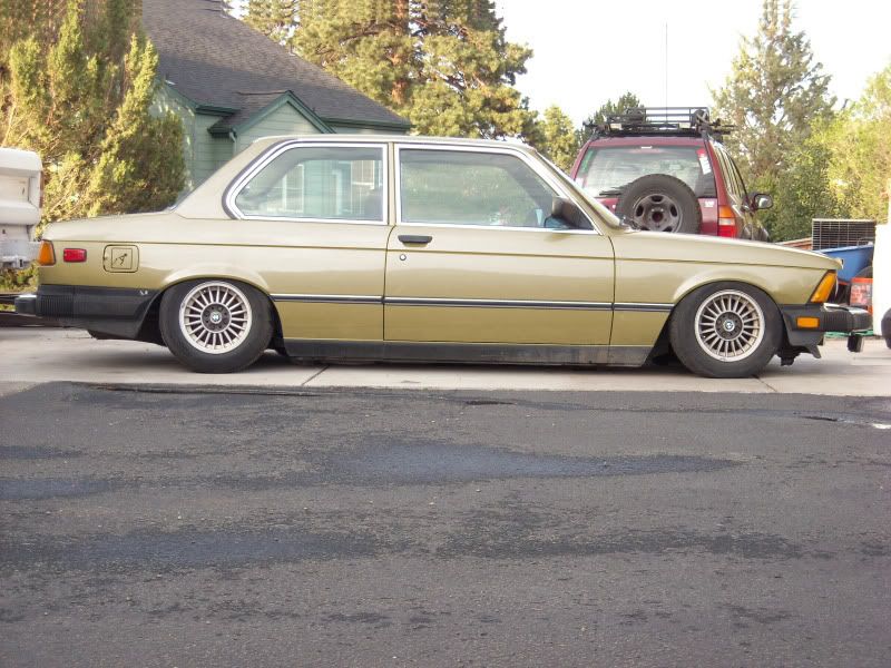

            Also, I want to change up the color. I think I'm going to paint the white trim black (kind of got tired of the white), and I was thinking of either a different shade of blue, or maybe a gold. the passenger side rear quarter panel has a ton of bondo on it that is rusting from underneath, so it's been chipping away and reminding me that I need to do a little body work. I guess that's the trouble with a totaled car.
            Here's a photoshop from a long time ago of my car to give you a feel of gold. My friend Alex isn't down with the idea, but I'm thinking it would look good, and my opinion is the most important on this issue.

            • gold could be awesome, u goin with a retro gold color?
              Floccinaucinihilipilification
              • I think anything earthy, gold, tan, brown with a satined finish and some red accents would be so cool. my $.02

                • I'm on board with those paint ideas, but I don't think red accents are for this car. I was kind of thinking of an earthy brown or retro gold actually. or maybe a greyish blue, sort of like the stock color of the car. that way my door jams and stuff would still match kind of.
