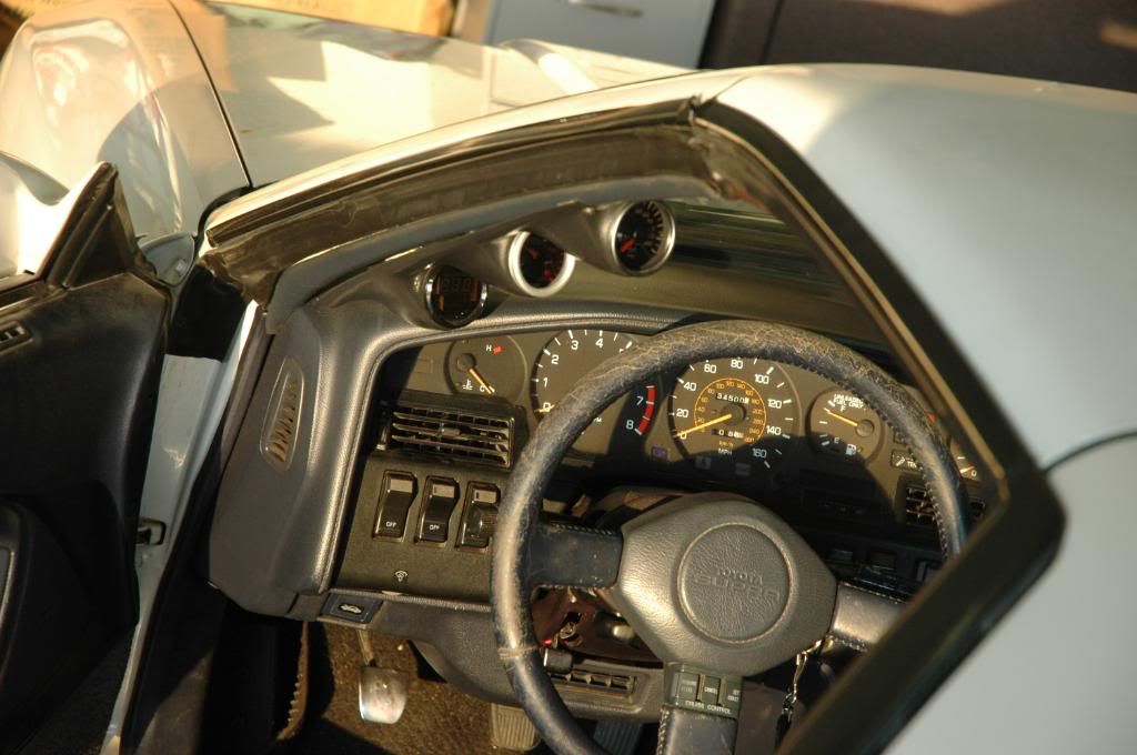

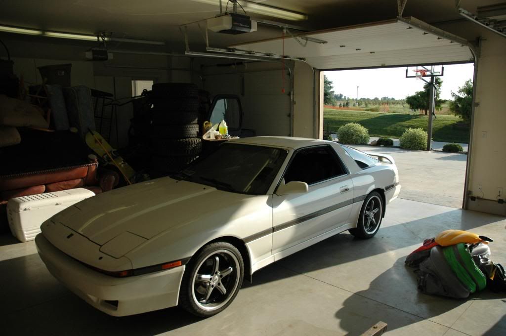

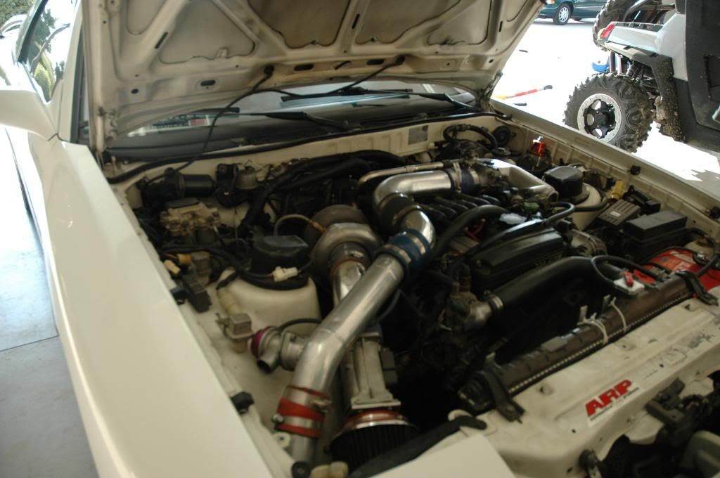

    what it was before the operation

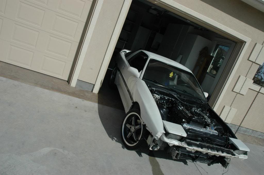

    heres the update. i tored insides up and am redoing it she will be stripped(done) and painted. and some other things as well. so far ive shed ridiculous amounts of weight from the car (ill be modest an say 200lbs) the car weighed 3300lbs when i first got it with a buddy inside...
    so the power to weight will be nice
    PICS (sorry kinda blurry )
    all HVAC and sound deadening material is gone ( she will be hot an will be loud, but its a track car an idgaf! )
    intercooler piping being mocked up by the guys at BLacklist aka (mike and jake)
    more updates this weekend

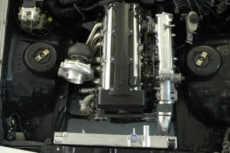

      3pce tails!
      fixen the ugly old trim on them
      playin with the turbo clocking and fittings
      blacklist motorsports Jake modified the turbo flange for me.
      the set up
      oil cooler setup
      HKS twin power via titan motorsports
      changed the interior to black!
      new intercooler piping setup curtesy of Blacklist and powdercoating by MODA metals
