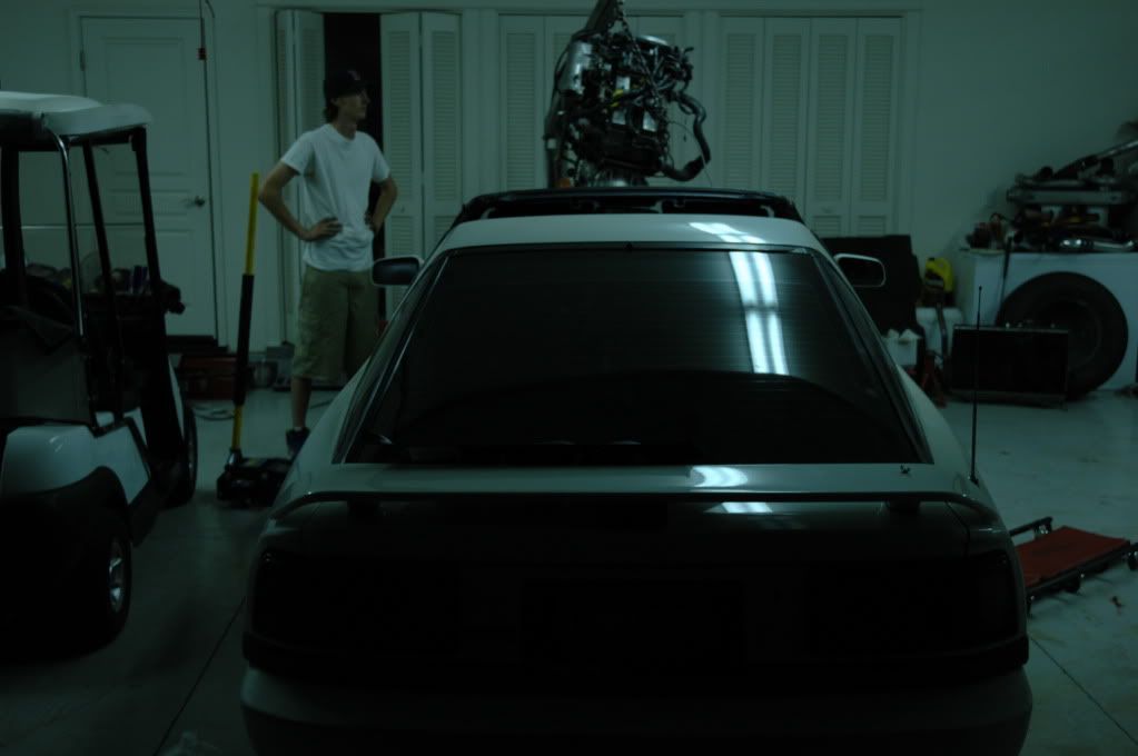

                          few days past the car now back home i decided to pull it and figure out what i was going to do.. .
                          so i go to a car meet where a friend tells me he has a built usdm 2jz-gte. he wantes a few grand for it and it made 500hp in his silvia. so i bought it from him and the swap began.
                          the hard thing was finding info on the swap. but after awhile i found things here and there. i bought the mounts and some parts and off i went.
                          after getting the motor in the car and having no piping. i contacted a friend by the name of Mike T also known as XmoshX. he told me he and a buddy would come out and fab up some piping for the car. later that week the boys came over they had a small business out of a barn/shop in kuna called BLACKlist motorsports. mike being a suburu guru and jake being the fab guy..
                          TO be continued
