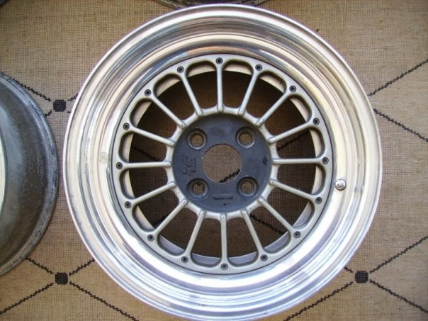

          • imo, rock a set of minilites/watanabes/SSR RS8's for daily duties then the Work wheels for stuntin wit da does open
            ps someone buy some a set of Hardy & Beck wheels plz

              • copper centers...
                • Went through every page of this build and your work is amazing. Love what your doing with it and the homemade paint job came out great. Can't wait to see how this ends up
                  • copper centers is interesting. Been sanding a few hours everyday.

                          • Very inspirational thread man! A lot of great work going into this car. Don't cheapen it up with cheap wheels, you owe it to yourself to give it something worthy of your work.
                            • Originally posted by Moose View Post
                              Could not have said it better myself.

                              • He has Work wheels for the car but he doesn't want to DD those I don't see what is the problem with that.
