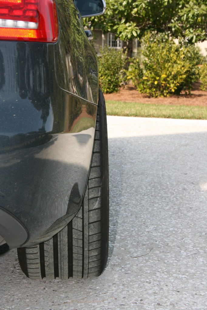

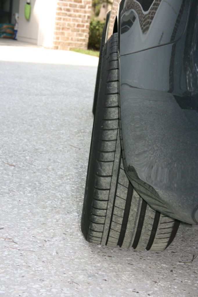

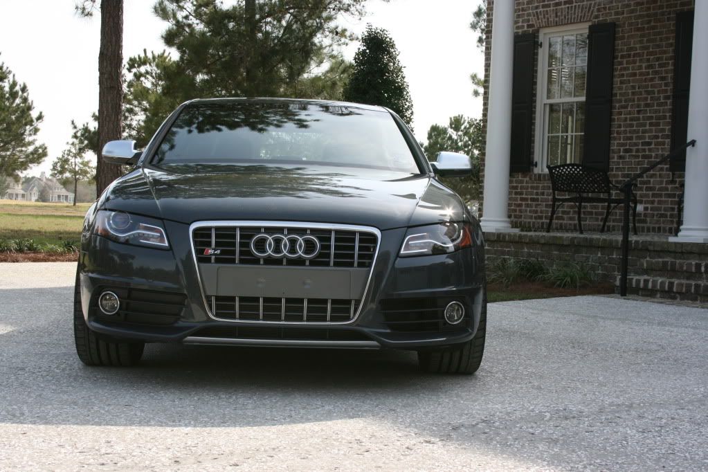

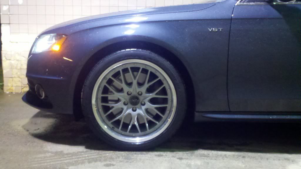

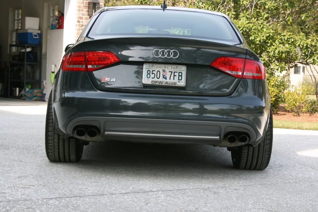

    Well not to anyones surprise the 19x9 et33 fit up front with no issues, now in the rear where I have the 19x10 et34 the wheels are catching on the calipers. I"ve ordered at set of 5mm and 8mm spacers Just in case 5 isn't enough. My only worry at this point is that the tire looks almost to big to be on this style of wheel especially once my KW V2's are installed so my question now is what are some lower-profile tire options...maybe something with a little bit of stretch.. here are a few BAD pictures in the meantime...sorry for the poor phone quality.
    The rear
    The front with the odd tire fitment

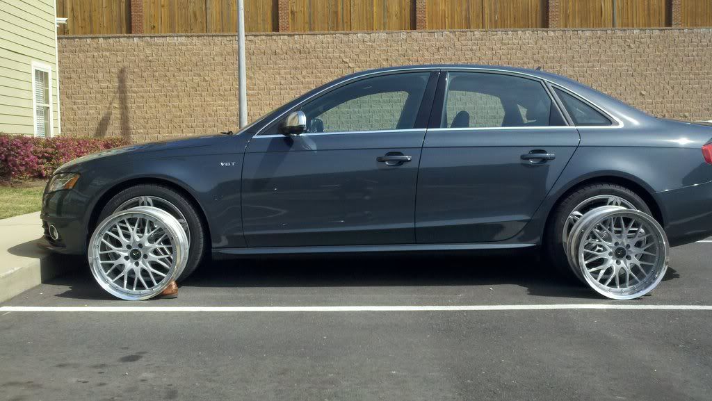

      well another update guys, the 5mm spacer weren't enough so I'm turning to BFI because they are the only company that make 10mm spacers for the rear. I must say that have the rear mounted and on the car only to have them lock up and have to be removed for the second time is extremely frustrating.
      • #18

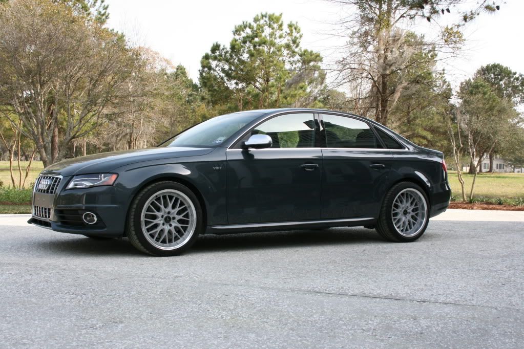

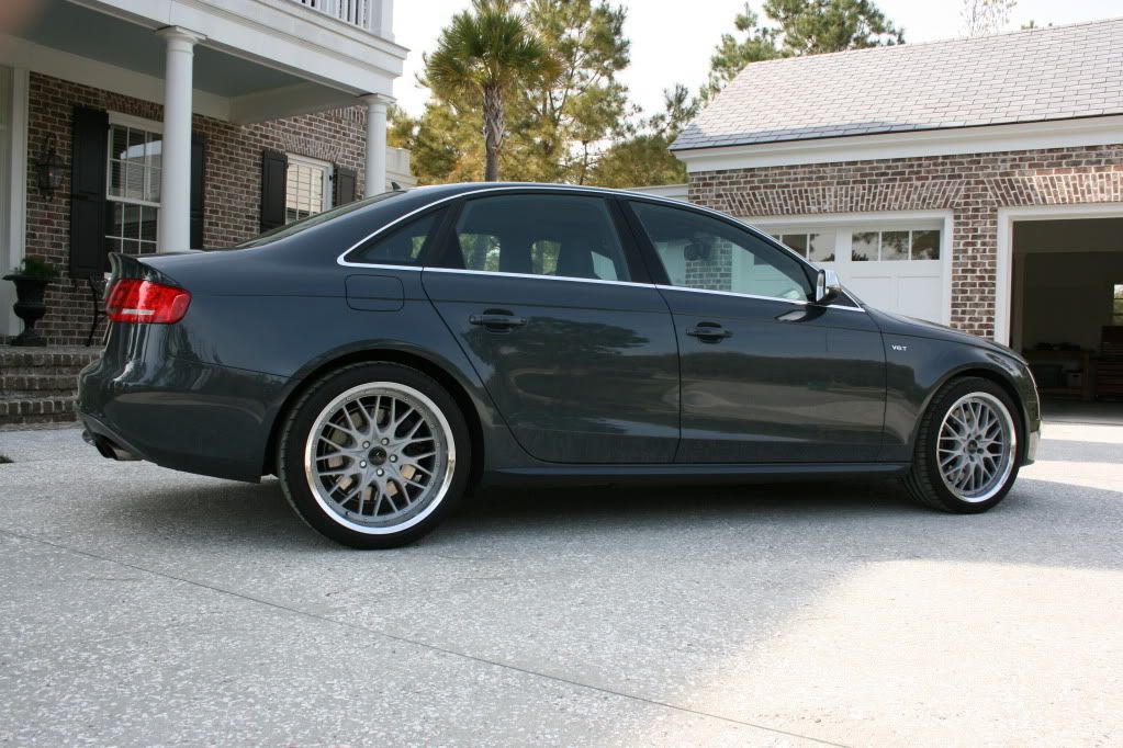

        Alright so the 10mm allowed the rear wheel to clear the caliper and I finally got to bolt up the wheels and snap a few shots. Now hopefully the coilovers will show up here in a few days so I can drop her to the ground, because lets be honest it looks like my car has a lift kit on it.
        • #19
          you need alot more low to pull those wheels off. sorry dude
