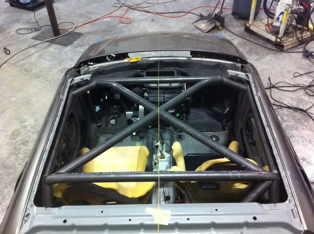

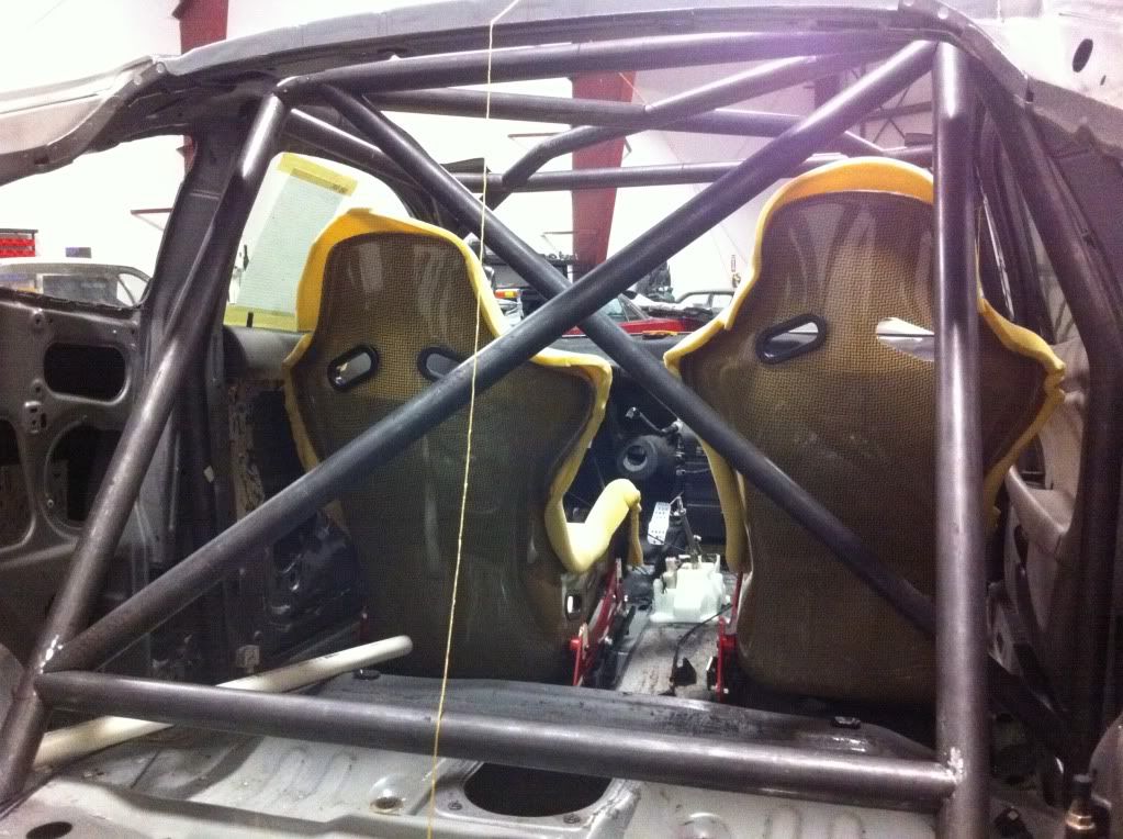

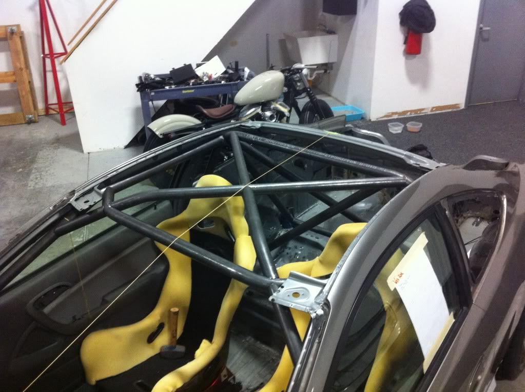

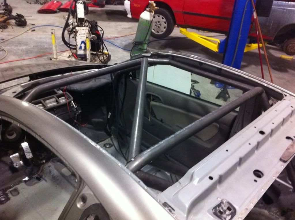

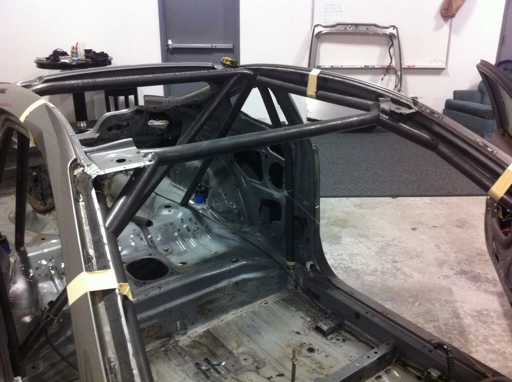

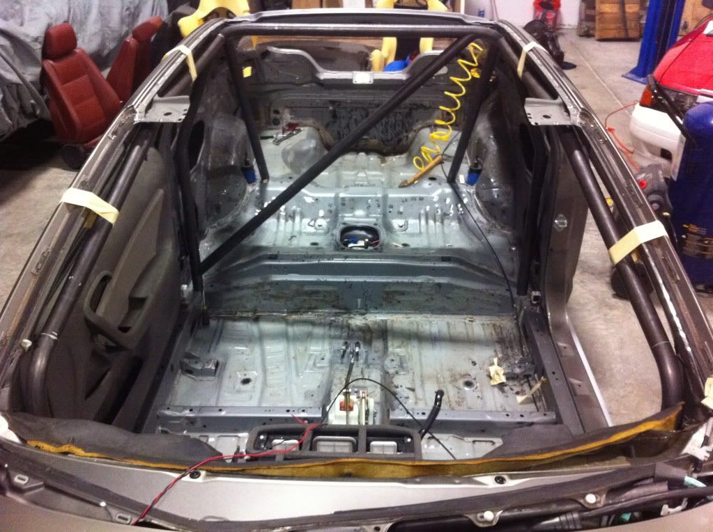

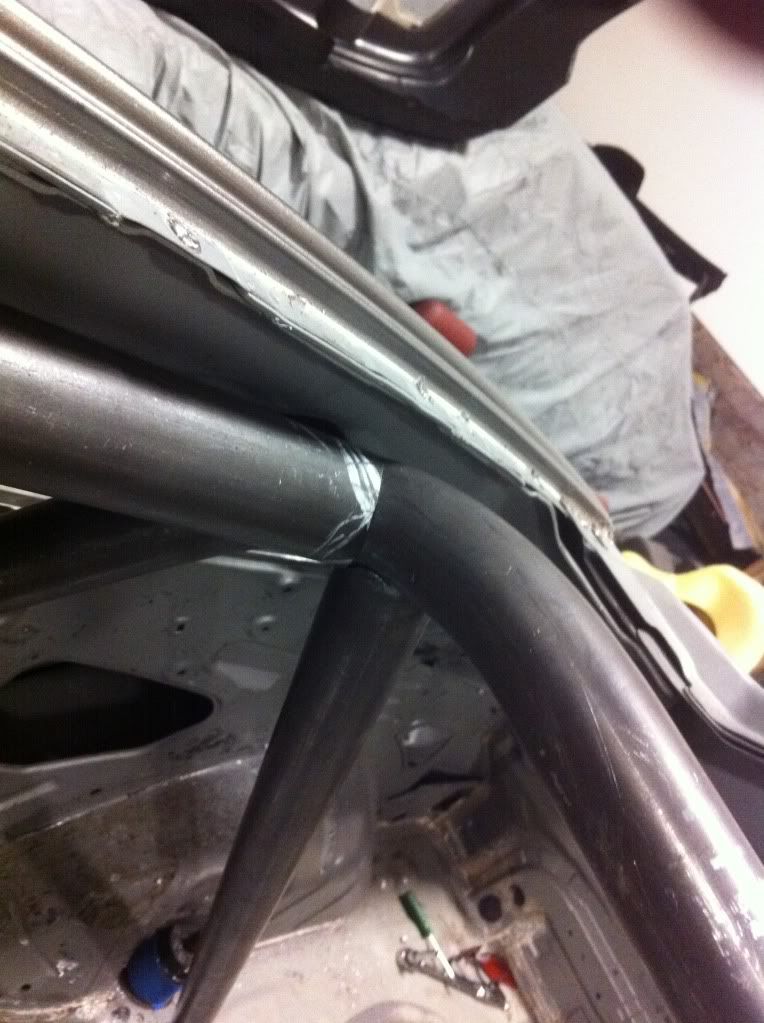

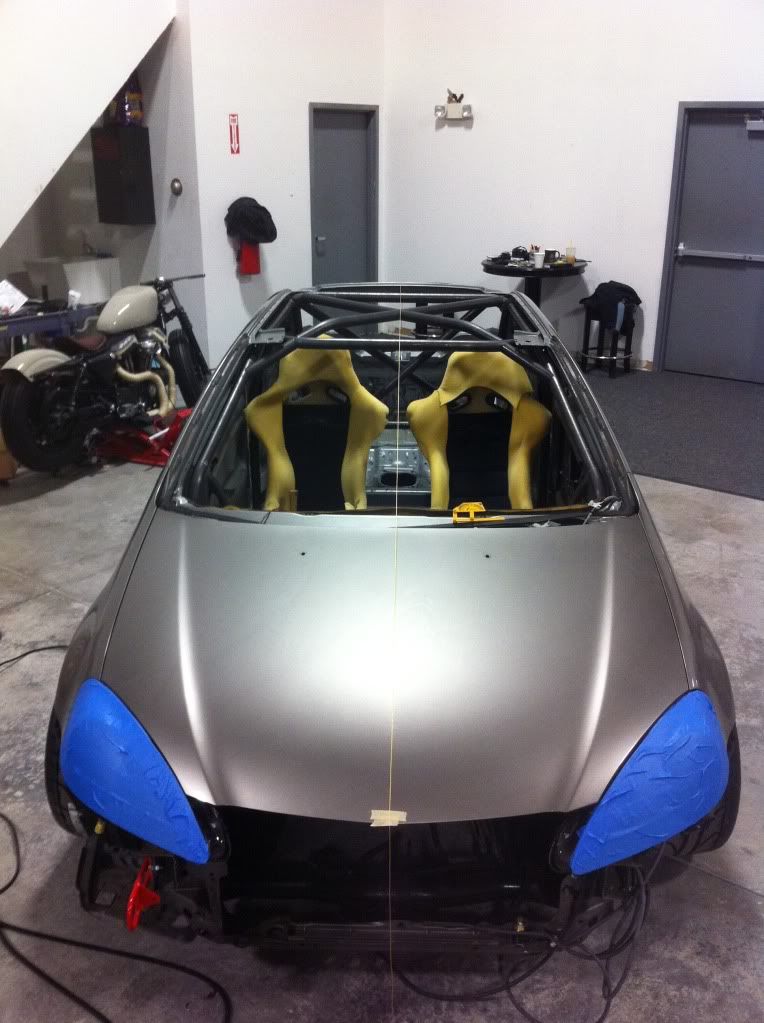

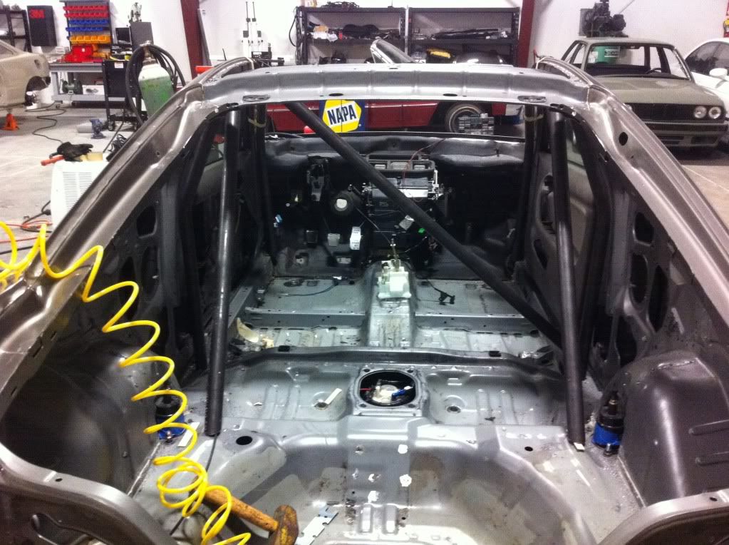

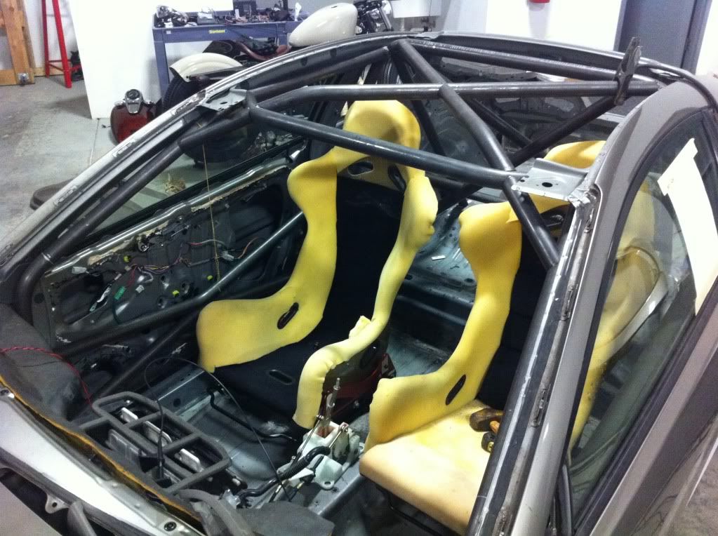

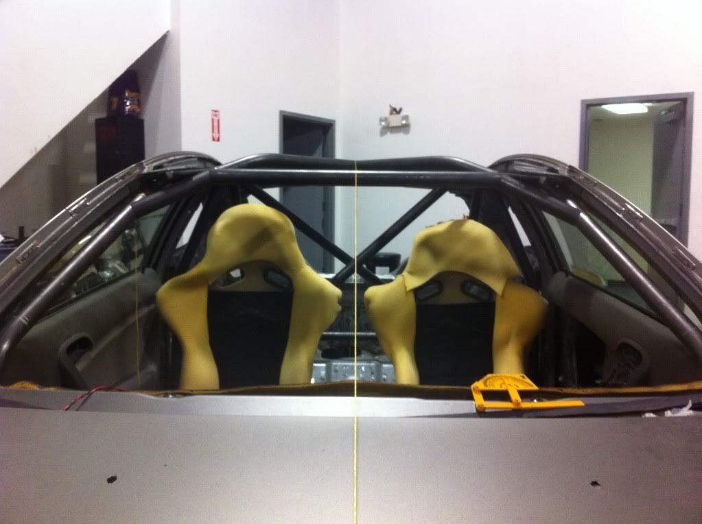

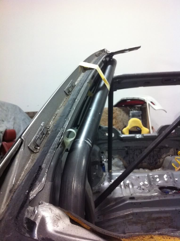

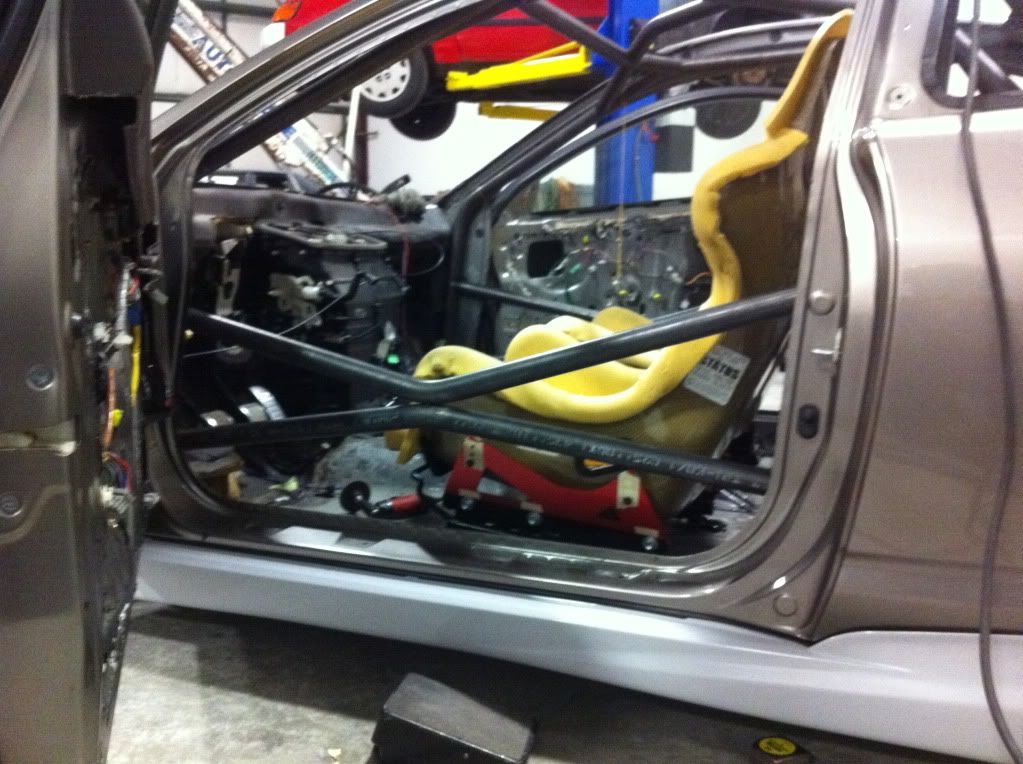

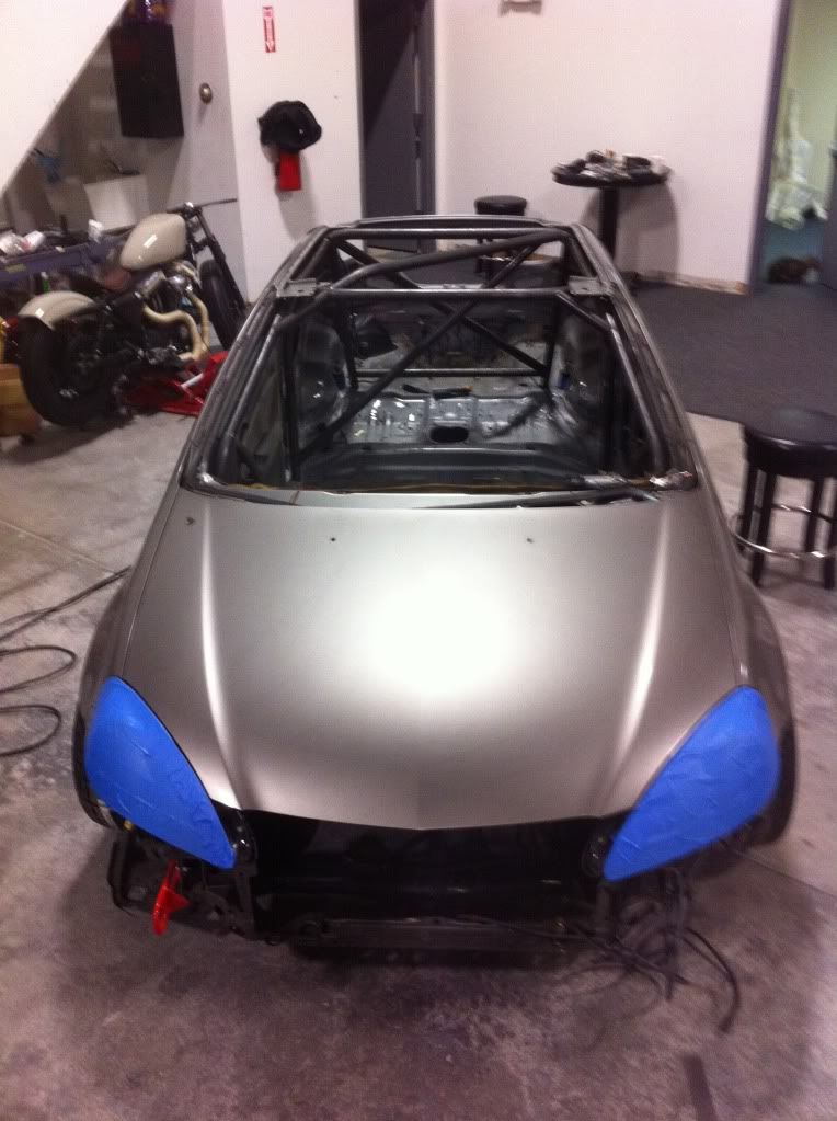

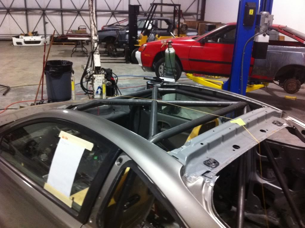

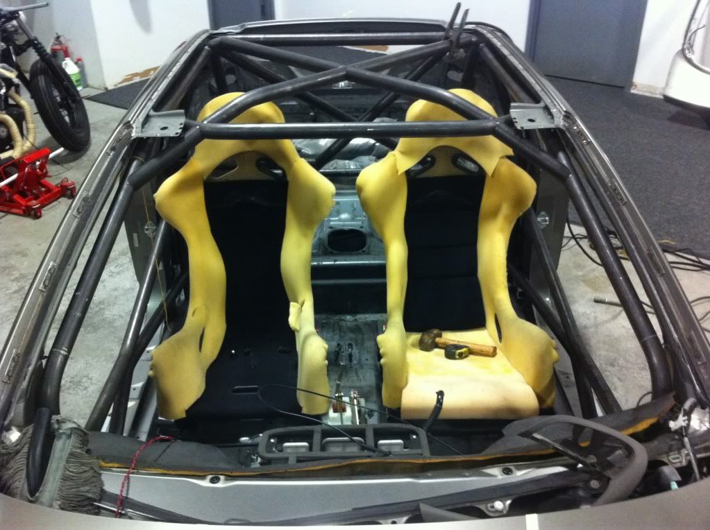

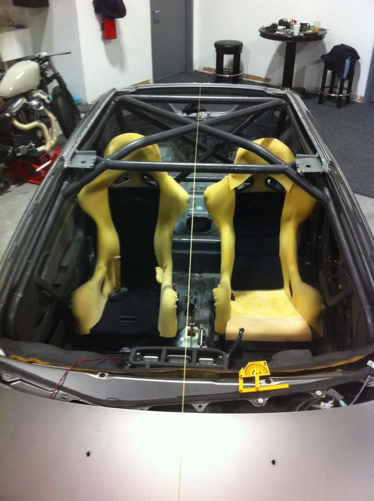

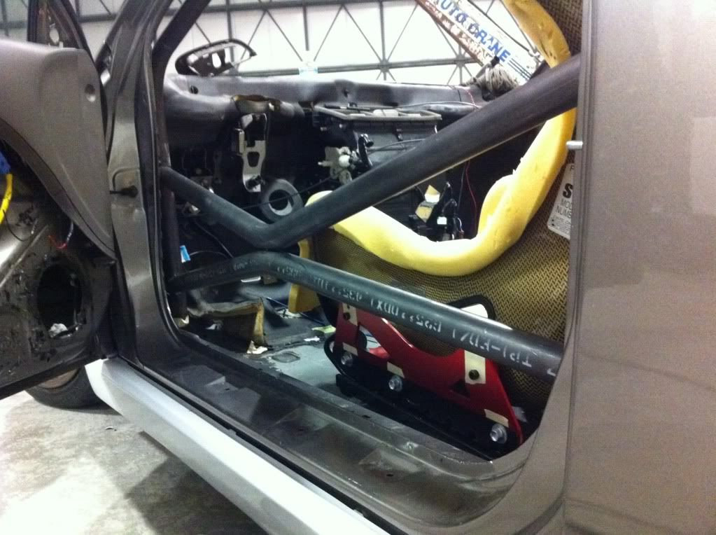

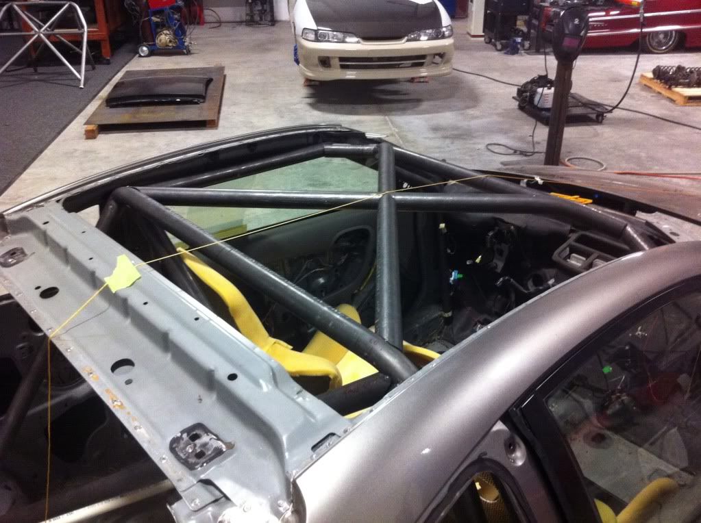

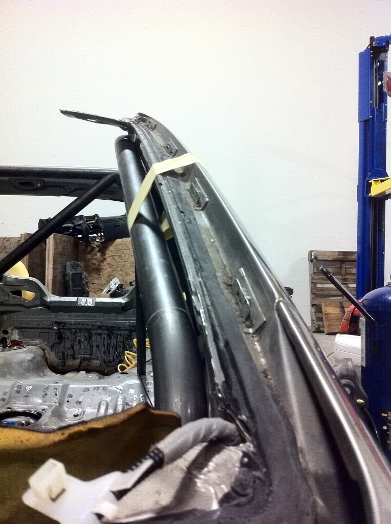

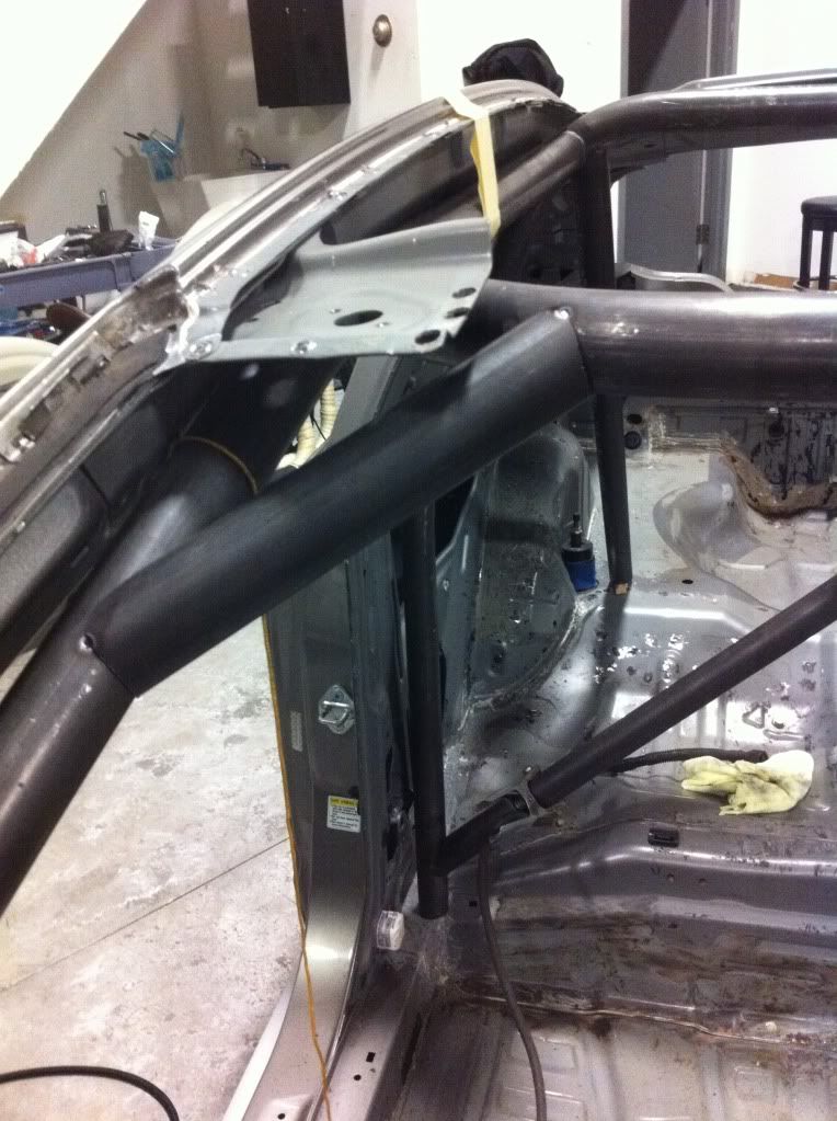

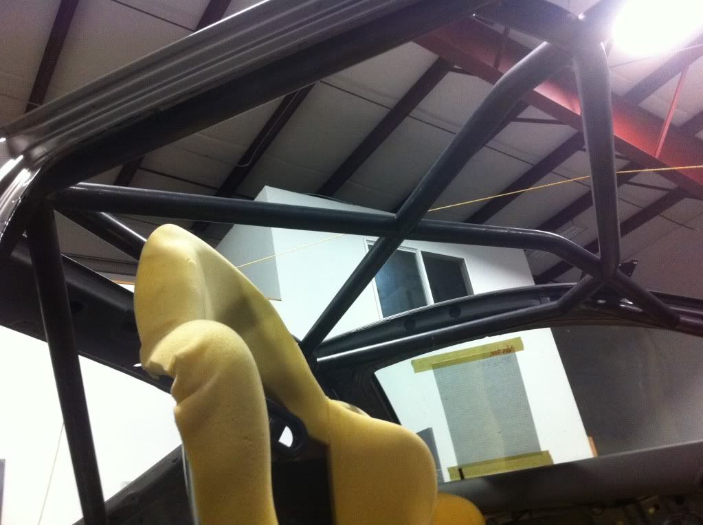

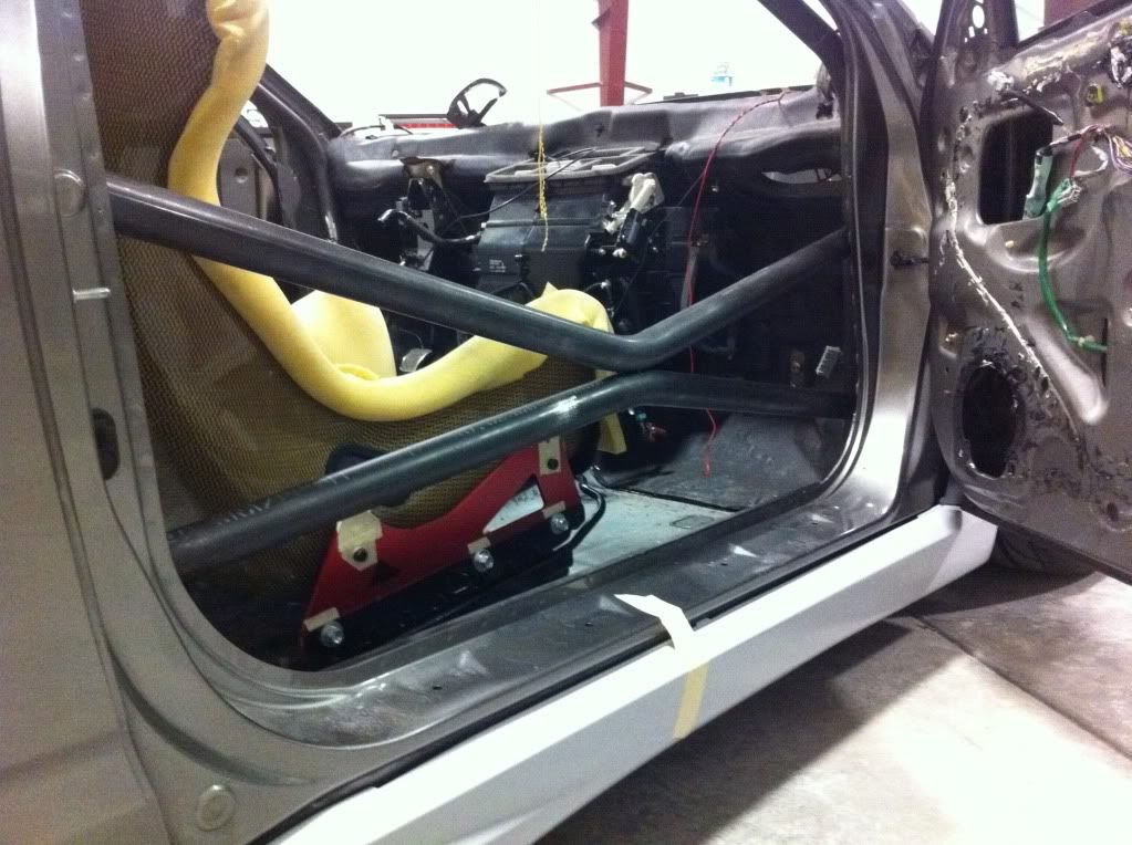

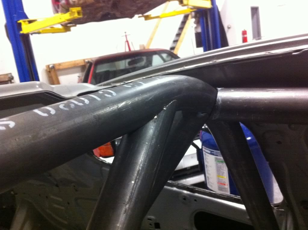

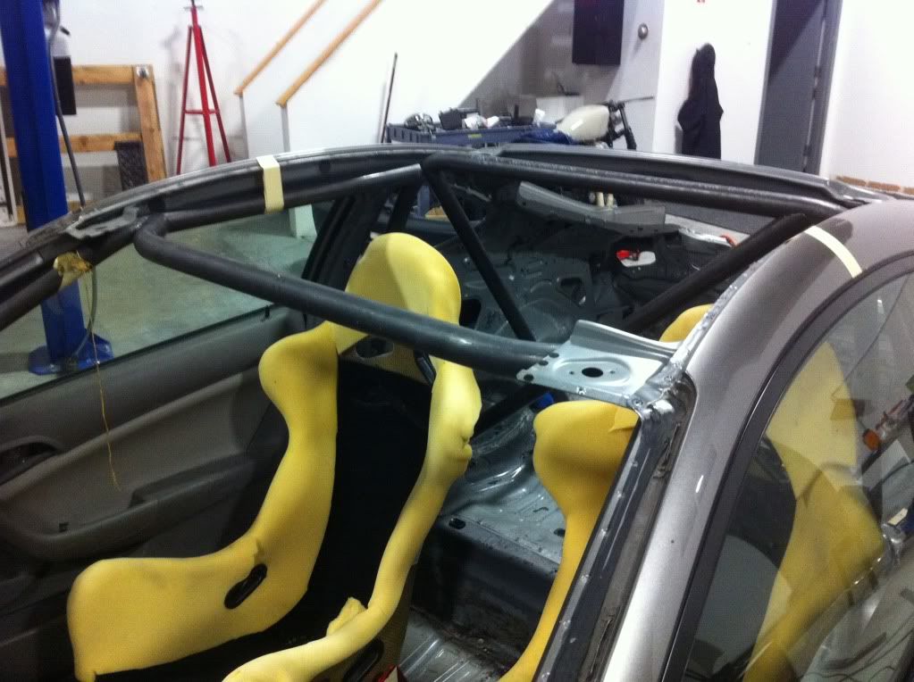

    Here is a cage in an RSX that I just finished up fabbing. Still needs to be final welded but there is a lot more work that needs to be done to the car before I can final weld the cage. Enjoy and stay tuned

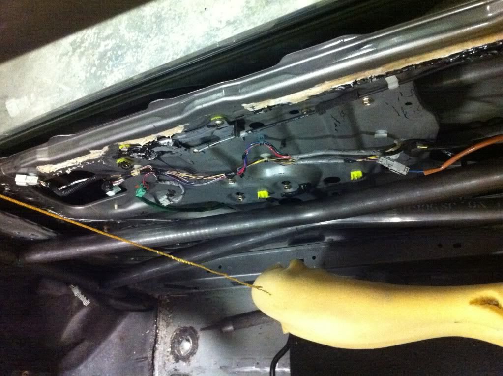

    1/2" from the door
    Cage is being built with 1.650 x .095 wall DOM and will be TIG welded together
    Ryan

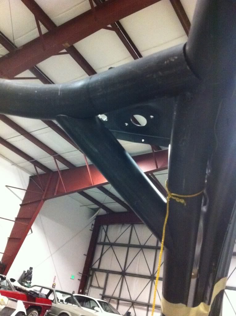

    nice! looks good so far. are you going to be making plates under the bars?

            looking good, I wish I took of the roof when doing mine.

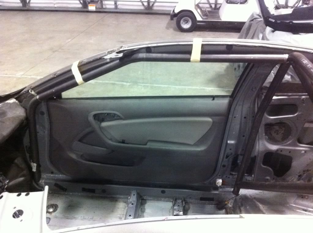

              What are you gonna do with the door cards? I can't see the stock ones fitting without being cut or something.
              Very nice looking cage, by the way.
              Stance-less
                Base plates still need to be made. I am waiting on parts for my bandsaw. Door cards def wont fit so I am making custom ones. They are going to be really cool so stay tuned.

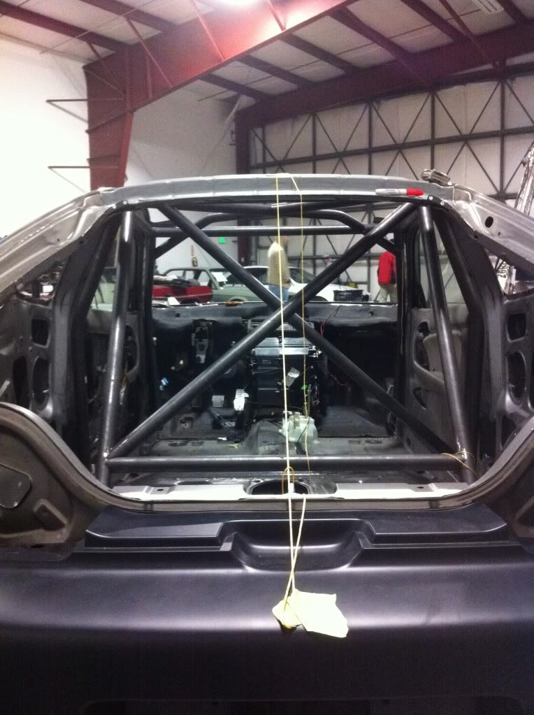

                    no bar across for the harness?
                    Insta Mintyhinrichs
                      That's one thing I noticed. I know it may not be done yet, but are you guys doing the harness bar? Looks sick so far, though.

                        Harness bar is done and def wouldn't leave it out.
