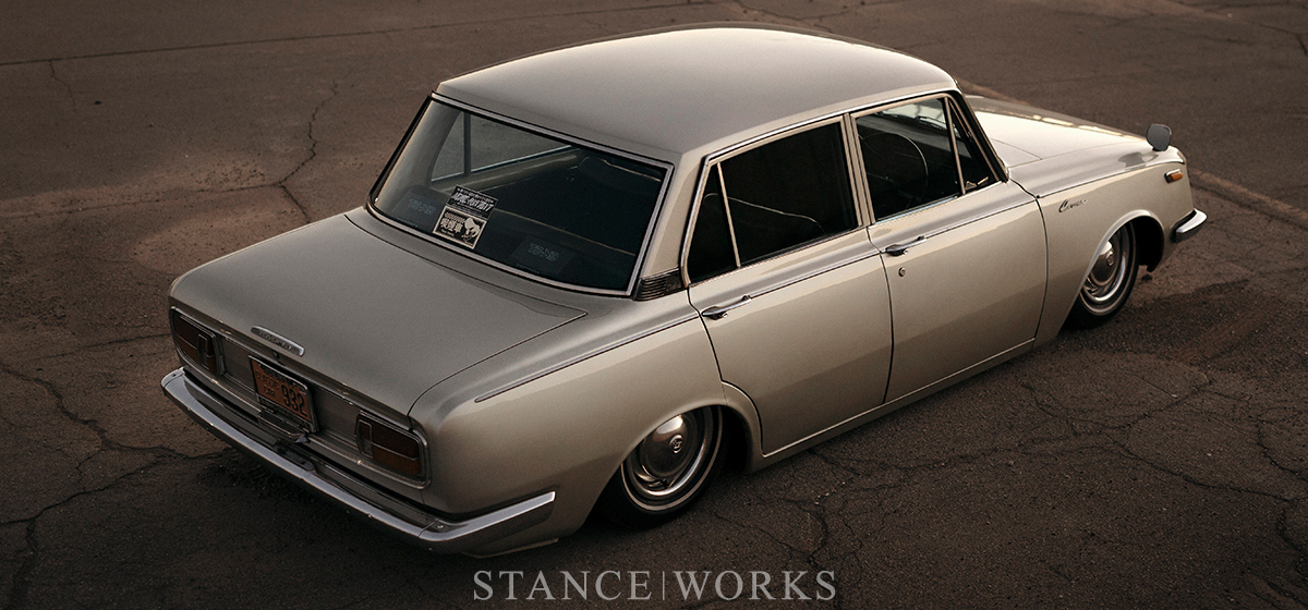

Getting the car to lay out required a serious bit of fabrication. It took no time before the car was practically cut to pieces. The sedan’s floor boards, trunk, and driveshaft tunnel were all removed, as were all the original suspension mounts and links. The factory frame rails were cut and notched, allowing the stock solid axle to tuck high up into the body of the car. Components like custom four links, a panhard bar, and of course, mounts for all of the hydraulic components were needed to pull it off.
At the front of the car, the control arms needed to be notched and Z’d to allow for enough drop, and the wheel wells needed tubbing to get the body of the car to land on the tarmac.
To do the heavy lifting, Keith turned to Hydrohaulics for components, which includes one Hydrohaulics pump and two 3-dump manifolds. 10″ cylinders run the rear end, and 6″ cylinders are perched up front, with 4 accumulators use for damping, allowing the car to have a reasonable and usable ride quality. Two batteries provide the power, and for control, an 8-switch panel sits on the front seat, allowing for front, back, side to side, and individual corner control.

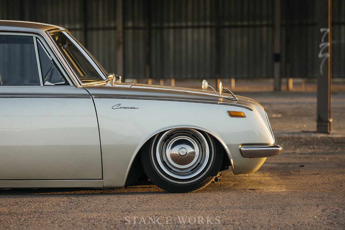

A few wheel choices were given a go on the Corona, including a set of 13″ SSRs to really play up the vintage JDM aesthetic, but in the end, fitment proved very difficult, despite the slim widths. The Corona was never built to house anything other than its tiny 13×4″ steel wheels. For tires, Keith turned to classic lowrider tires measuring out to 165/80/13, some of the smallest tires available, period. The only finishing detail for the wheels are the incredibly rare factory Toyota center caps, which help enhance the OEM+ styling of the car.
