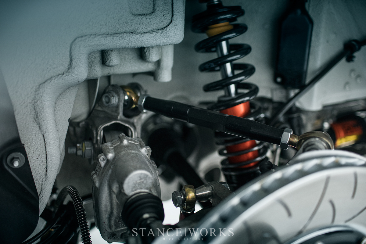

Joey kept the client informed and educated throughout the installation and suspension tuning process, and it didn’t take long before the customer was eager to kick things up a notch. “Stage 2” brought solid spherical bushings and adjustable radius arms to the car. “This rids the car of any unwanted rubber deflection under load and allows me to position the wheel anywhere in the wheel arch I want, in order to optimize wheel clearance and front track.  This allows me to widen the front track as much as possible without rubbing, and the result is sharper steering response and a better front platform that enhances rear grip,” Joey explains. To balance out the front, the lower control arm and the rear toe steer arm were upgraded with spherical bushings, too, all in the name of reducing deflection under cornering loads.

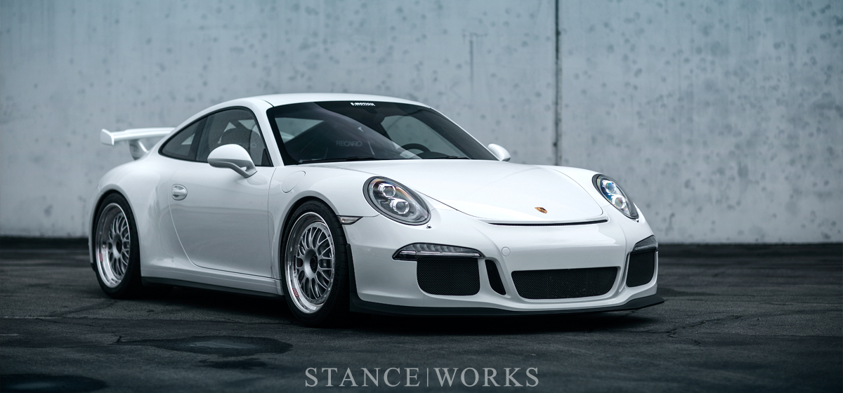

E88s were an obvious choice for the car, both for their obvious motorsport heritage, and also for their rigidity. With so much effort invested in minimizing suspension deflection on the GT3, it was important not to skimp on wheels and negate the benefits earned thus far. Reduced unsprung mass plays a key role too. The width and offset of the wheels required some finesse to fit: thanks to substantial suspension adjustability, and lots of experience, Joey was able to easily fit 911 GT3RS tire sizes under the stock fenders.
To complete the Seely Setup, they ditched the stock dampers and fitted Moton 3-way Motorsport dampers, which were of course matched to Joey’s hand-selected spring rates that were installed at the project’s start. Remote reservoirs can offer a few challenges to mount, so Joey opted for his own custom-designed and 3D printed mounts. As a lighter option to the more common aluminum mounts on the market, they eliminate the possibility of over-torquing the reservoir, a massive benefit that will keep the units from failing, should anyone service the car with less care. The front units are mounted under the car’s hood, and the rears are mounted directly inline with the air flow path of the rear wheel well, ensuring it stays cool despite its proximity to the exhaust manifolds.
